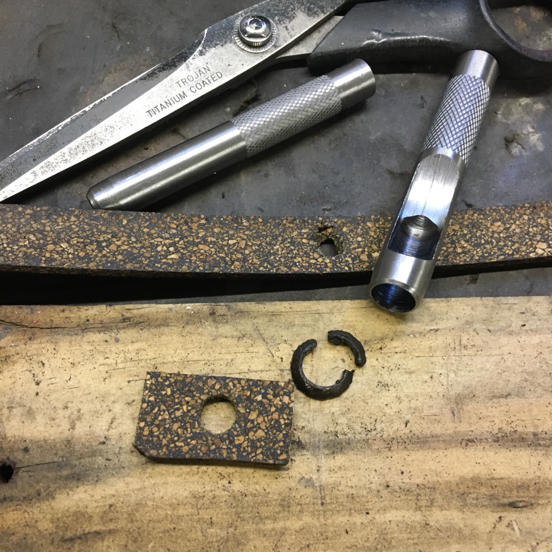

Replaced 1x rubber gear selector shaft seal and made up a new cork seal for the other one. Also re-checked the gearbox oil with the car level and it’s spot on.
