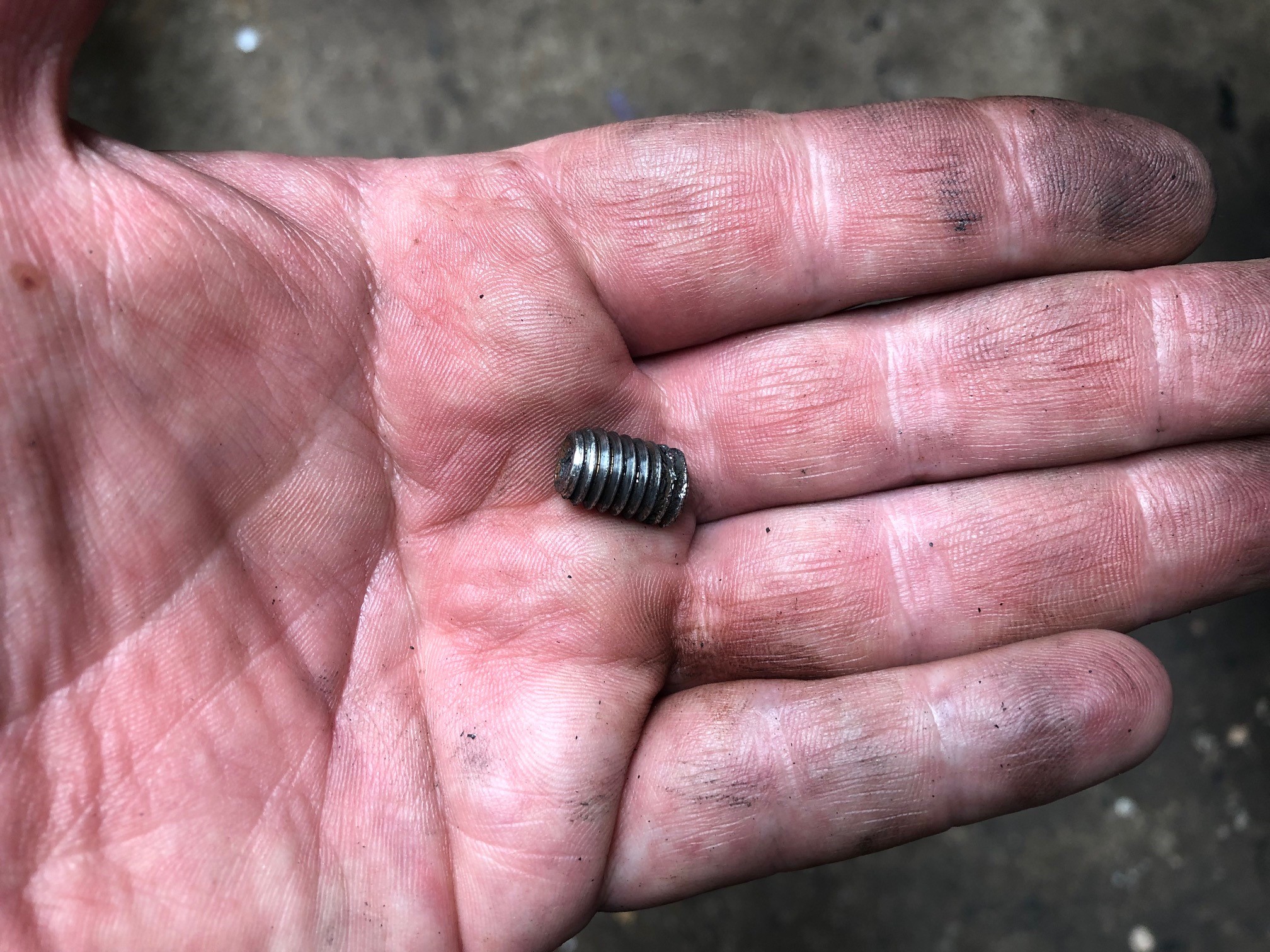

Removed my Macguiver alternator repair, and unbolted the alternator. As suspected, I had snapped off the lower mounting bolt in the block. I had visions of having to try to drill the thing out, after removing the radiator. For once, I was lucky... it had snapped off leaving 2-3mm protruding from the block. Said a few thanks to the man upstairs, got the little vicegrips out and removed the bolt end.
I had ordered a standard SBC alternator mounting kit, and it arrived in the post. Dummied it up, and now remember why I made my own. The standard alternator mount moves the alternator about 2-3" outboard of the mounting bolts. When I swing the chubby 140A alternator, it hits the subframe.
Will have a rethink over the weekend. Perhaps modify the standard brackets, or worse comes to worse put my homemade brackets back on and upgrade the bolts from Grade 5 to Grade 8 (50% higher shear strength).

Made some measurements, and come to realise there is not much better I can do bracket-wise than my home-made alternator brackets. Ordered some Grade 8 bolts, and will screw it back together once they arrive.

Nah, its more a geometry issue than a fabrication one. Alternator must be mounted flush to the block to align the pulley. To use a traditional-type bracket, the alternator needs to get out past the vee of the block... then it hits the subframe.

Harv,
Is it mounted up high or low ? I know mine sits pretty snug but it does fit low mount, meaning passenger side below the water pump.
You can buy all the brackets to do this, unless your alternator is physically to big to fit.
