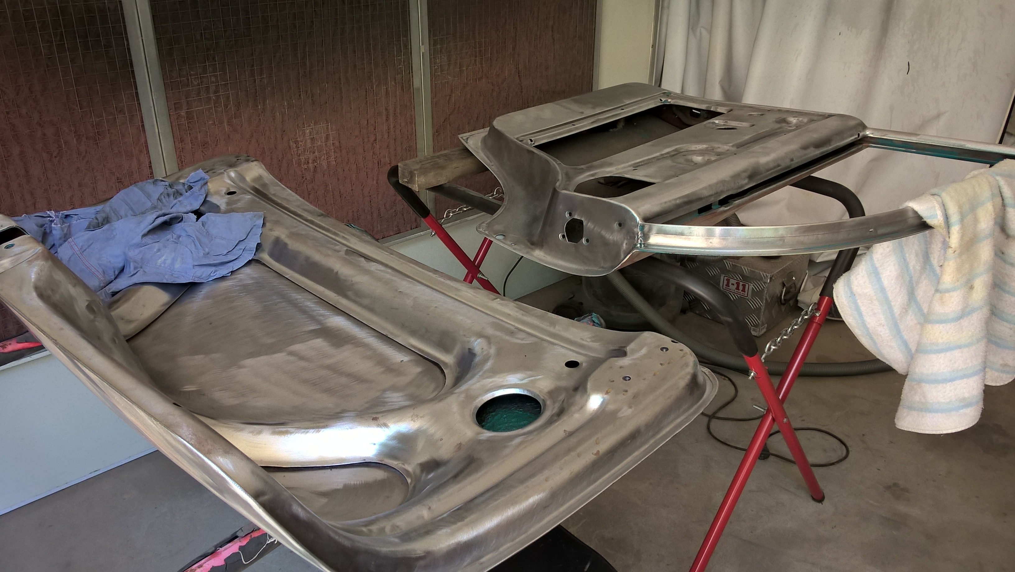

Thanks guys, I might polish up the jellys in the coming months but I think I will use the prostars initially.
Stripping the paint back by hand is a very tedious and time consuming job but 2 panels down 6 to go !!!!

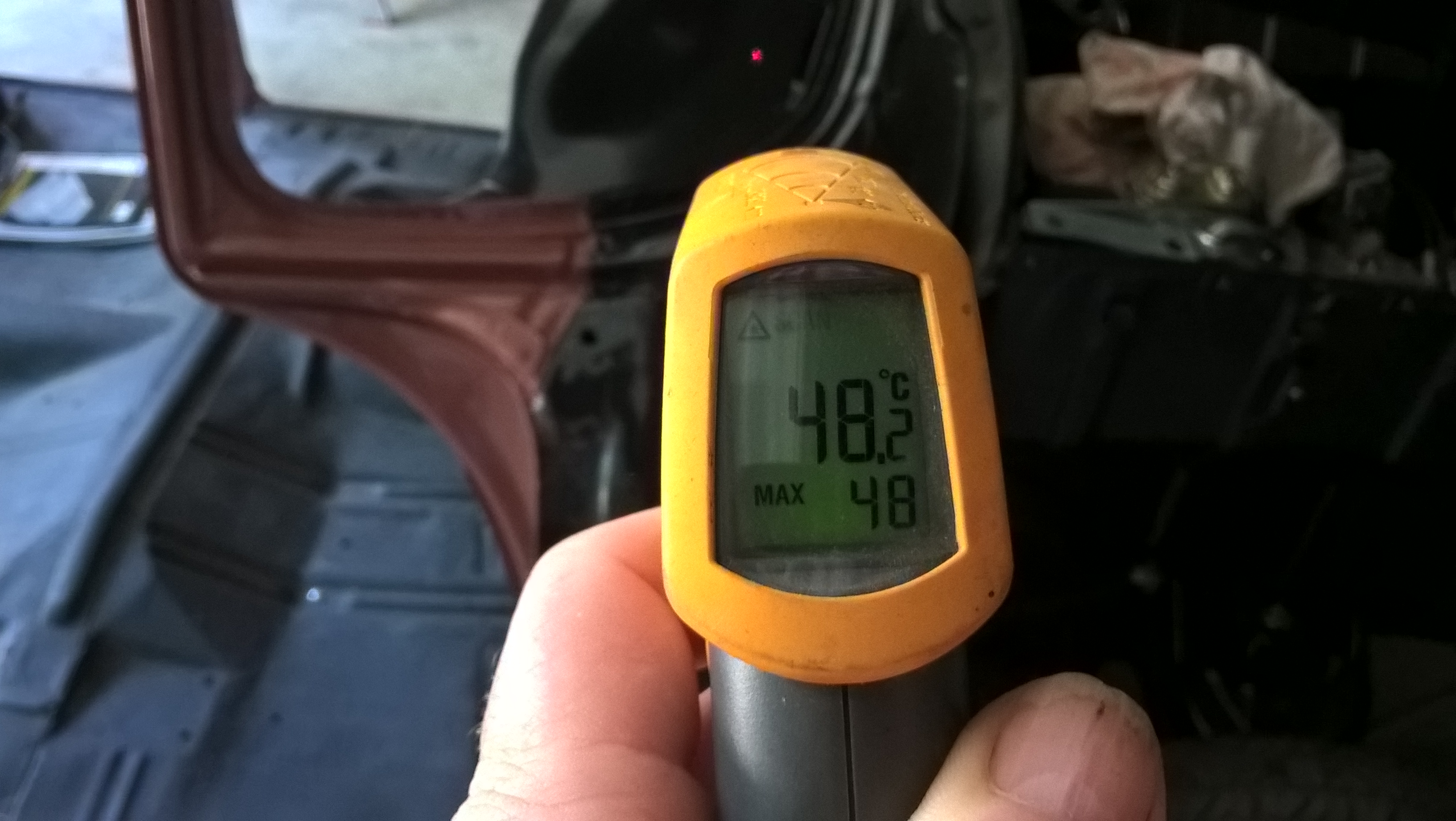

Bloody hot so have slowed down on the painting !!
Shed roof was 71 degrees and everything else over 40 !!!!!
Got epoxy on so now can relax until it cools down a little.
59wagon
Posts: 645
Location: Shoalwater, WA
Re: Chev EK
Post by 59wagon »
Who needs a paint baking oven when it's that hot? Better crack a coldie and watch the paint dry Greg.
Good work mate.

WesternWagon
Posts: 1056
Location: Mandura WA
Re: Chev EK
Post by WesternWagon »
EK283 wrote:Thanks guys, I might polish up the jellys in the coming months but I think I will use the prostars initially.
Came up a treat Greg
paint stripper and sanding?

59wagon wrote: Sat Jan 05, 2019 3:08 pm Who needs a paint baking oven when it's that hot? Better crack a coldie and watch the paint dry Greg.
Good work mate.
John
Thanks John a coldie or seven did rehydrate me !!!!
Posts: 2688
Re: Chev EK
WesternWagon wrote: Sun Jan 06, 2019 10:10 am
Gazza
Hi Gazza,
I actually used a wood chisel and scratched the old paint off, it was the original and tends to chip away to the red primer. I then finished it off with a disc abrasive pad attached to a buff that strips the paint down and the surface rust as well. It took me 3 days to get it like that !!
The problem with being hot is you sweat and drip all over the steel, the next day it is rusty again so its hard work.
WesternWagon
Posts: 1056
Chev EK
Awesome job mate
One of the painters at work informed me that it’s also good to ware painters gloves when sanding as the moisture from your hands will cause rust and other imperfections
Keep them pics coming gets me motivated to finish the ute
