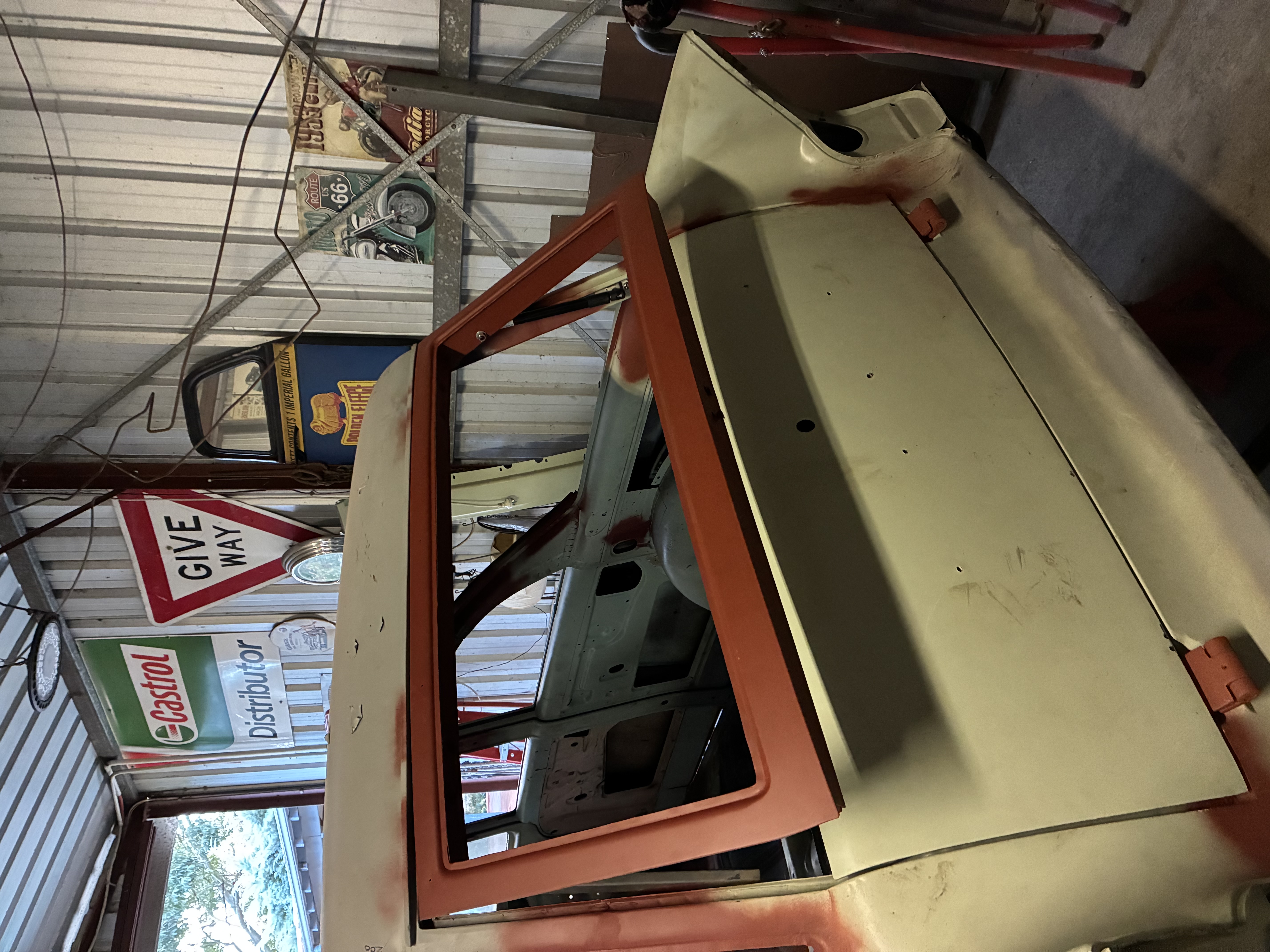

Fitted the tailgate, playing with a gas strut but may stay old school
Re: Neil's FB Station Wagon
Posted: Sun May 25, 2025 10:48 am
I have struts in the wagon - they work well.

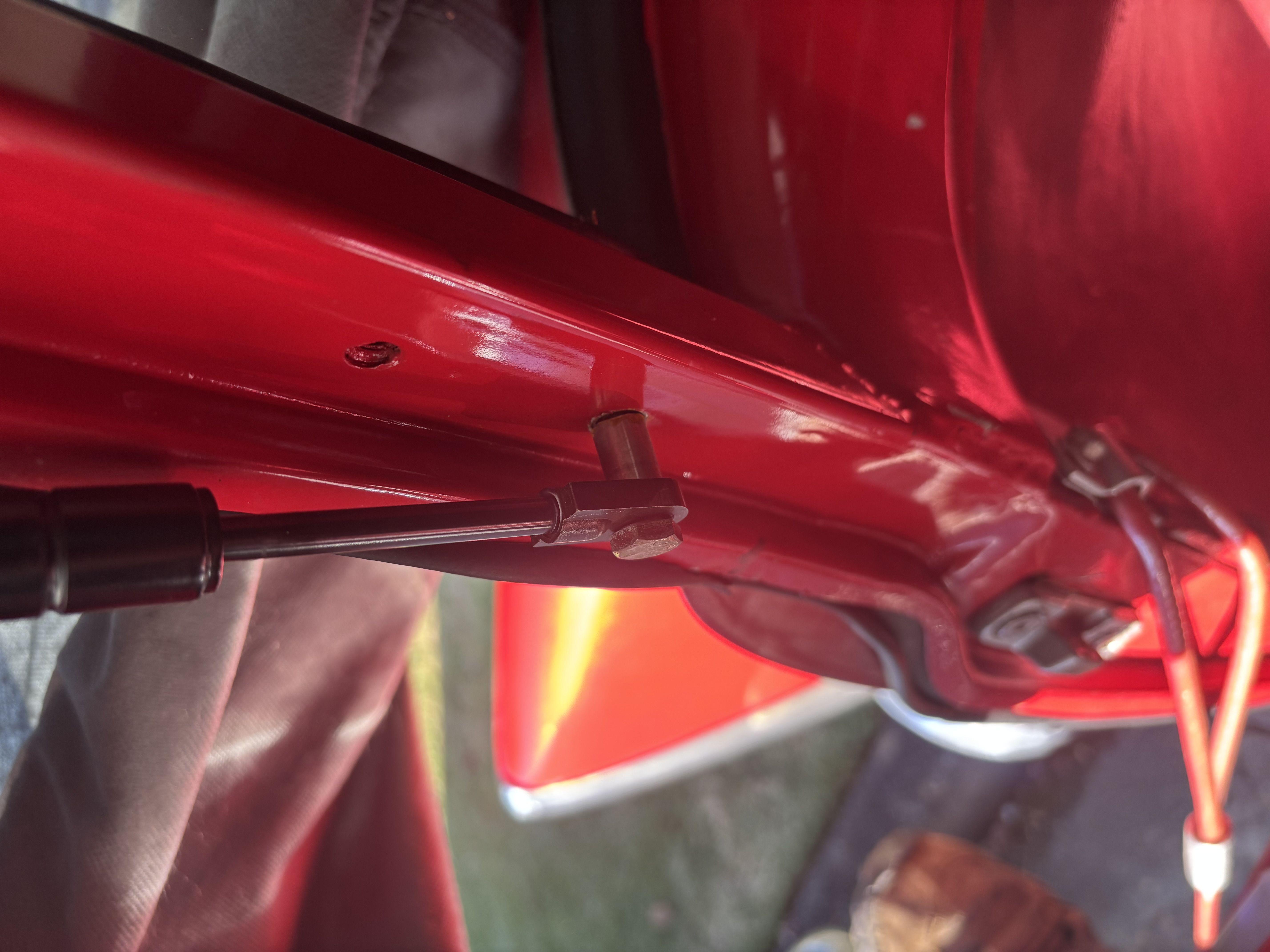

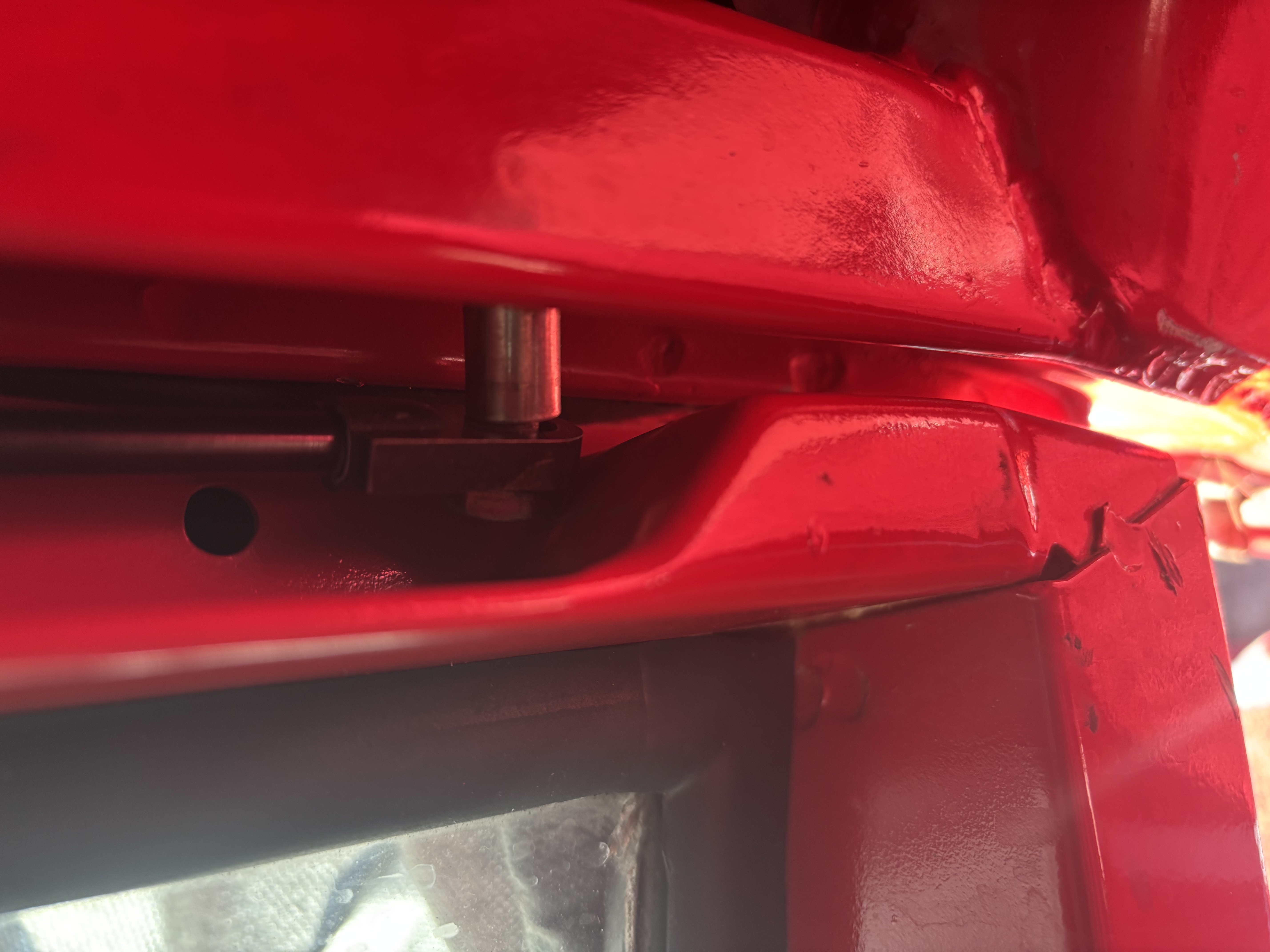

I replaced the original tailgate latches with gas struts on my EK wagon as I only had one working latch, and the little clicky locks were painful to use routinely. I did some measuring using this as a guide:
Strut_Length_Selection.pdf
(68.66 KiB) Downloaded 370 times
I took that to one of the local truck spare parts places. They sell gas struts, and can fill them to whatever pressure you need. I measured the tailgate weight using a "hanging fisherman's scale", divided the weight by two and that's the weight they were filled to hold. My tailgate can be lifted up by hand, and stays wherever I put it... it doesn't go pssssht and raise up on it's own, which is OK by me.
A word from the wise... I had images of driving around with the front windows open and the tailgate upper lifted. It's raucous (I like raucous :)) and dangerously fumey. Won't be doing that again.
Mine bolts into the existing tailgate bolt holes on both the window and frame side. I moved the strut ends around using some steel brake tube offcuts as spacers. I used simple bolts rather than the ball-end ones you see on modern cars... they work OK, but there is a slight sideways load that the ball-end would take care of. Hasn't failed in 12 years of daily use though :)

These pictures probably show what I did better. I used the “lower of the two” lower tailgate holes it fits when closed with room to spare, albeit with an eye end rather than a ball end.

Hi Harv;
That's my thought precisely and tes the ball ends are a bit bigger will maybe look at eye ends thanks for the info it really helps mate

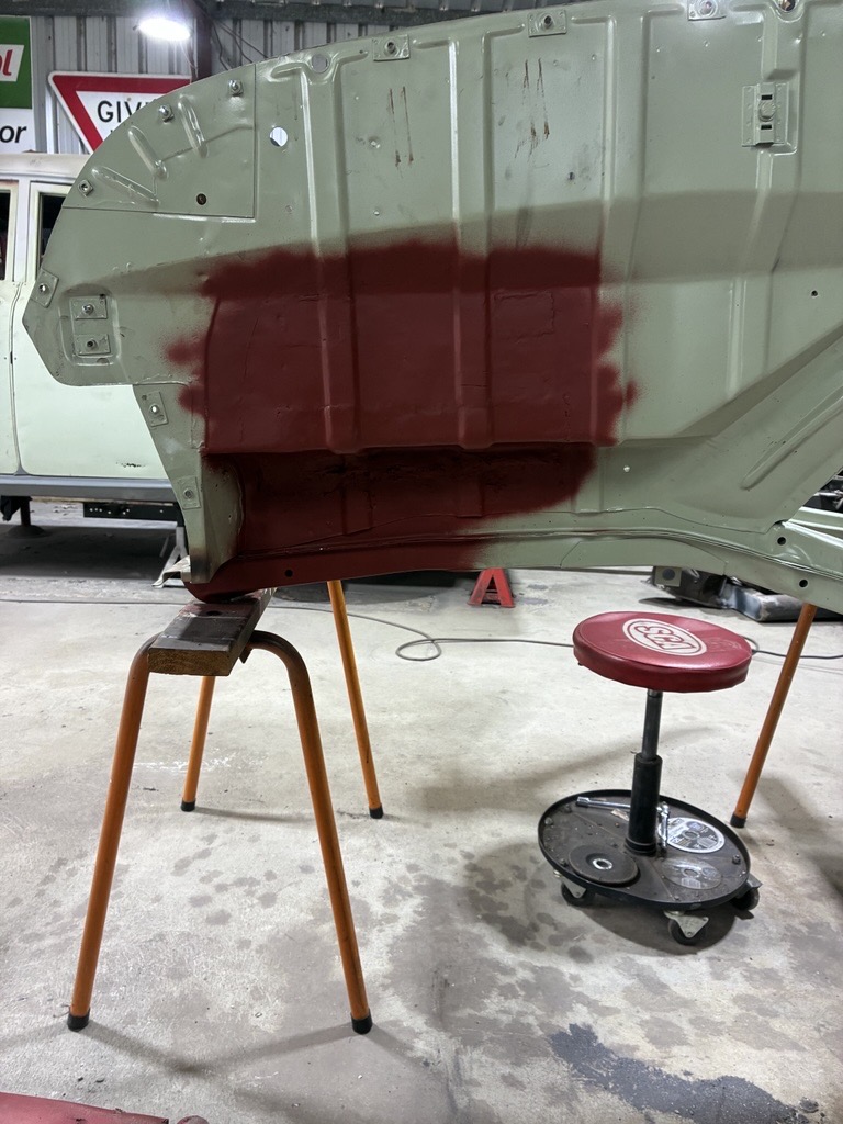

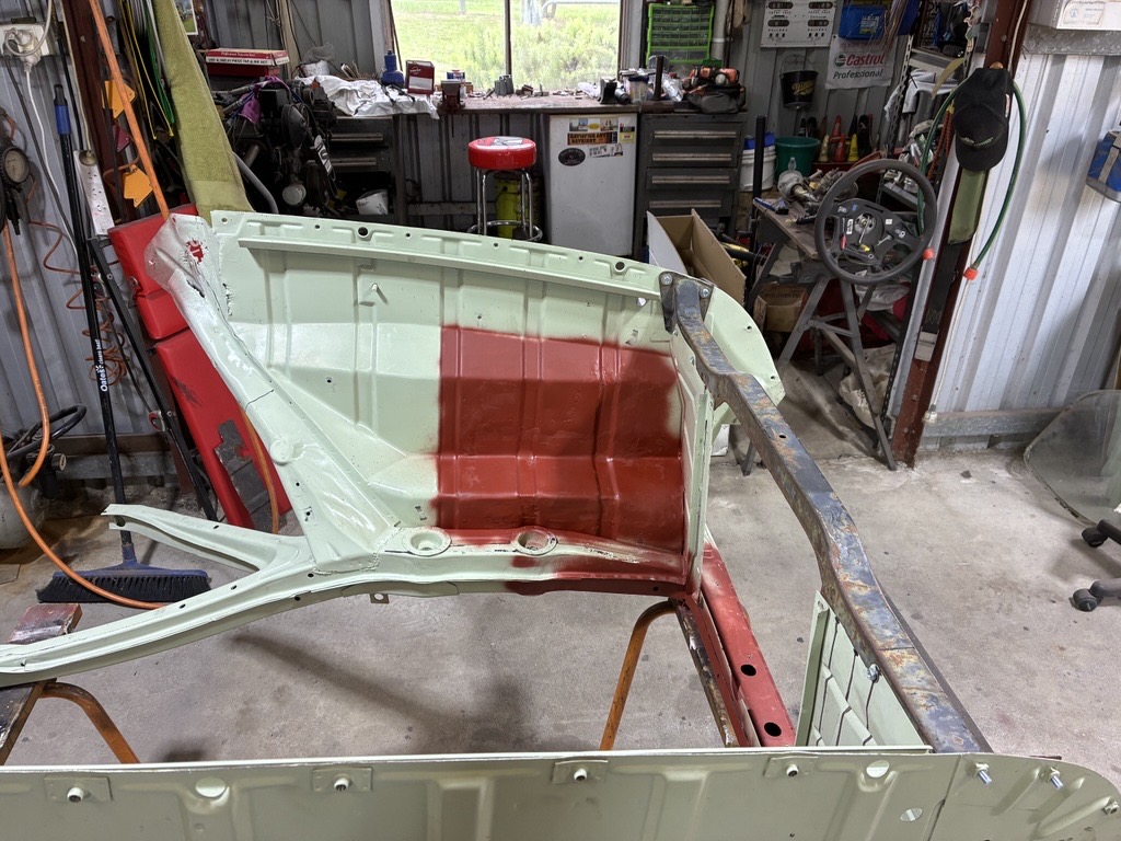

Posted: Tue Jun 03, 2025 3:55 pm
by FireKraka
Finally got the large repair done to the old battery area of the subchassis, still have the wings to do that bolt to the fire wall and then modify the area where the radiator goes to sit is down a bit and open the area up.
