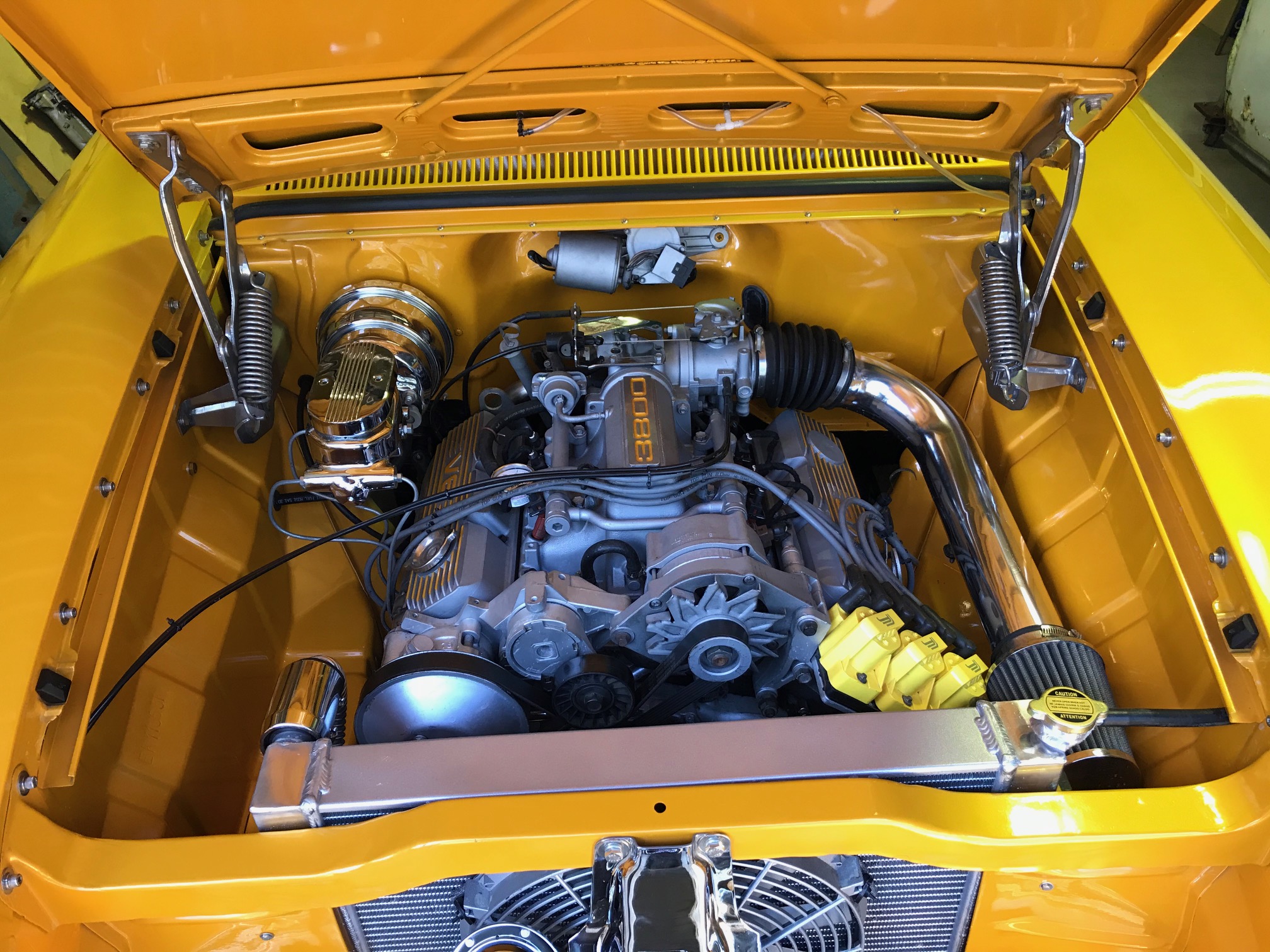

Brett027 wrote: Wed Dec 01, 2021 9:17 pm Anyone tried these? Thinking about how to get 7" booster in 5" spaceπŸ˜€
I have Brett, they create a lot of room.
You do have cut about 300mm of the drip rail away to fit them, also they flex a bit side to side when the bonnet is up.

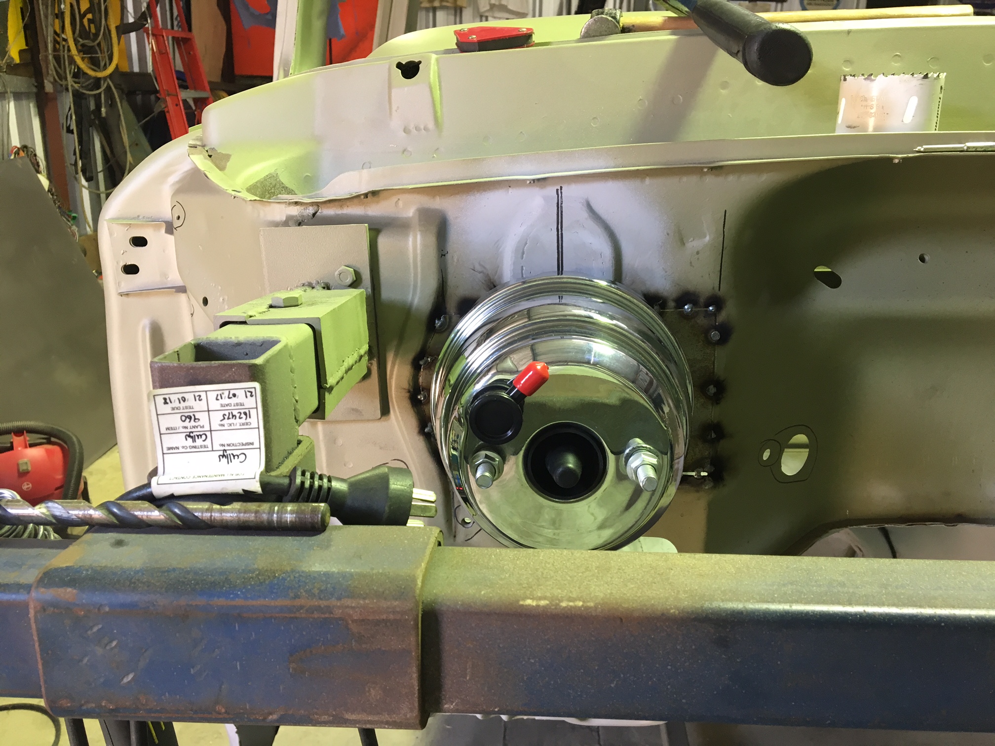

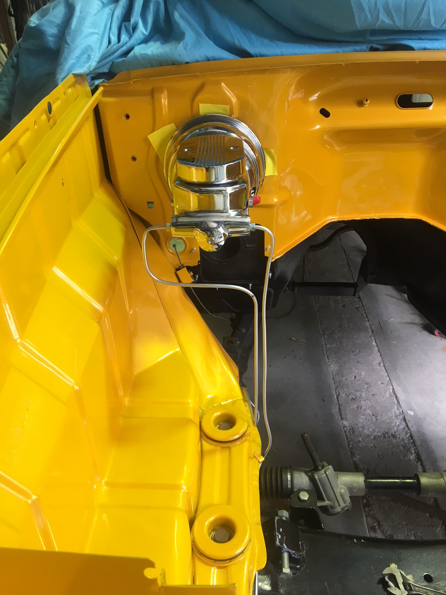

Re: Project 2.
Posted: Thu Dec 02, 2021 1:15 pm
by FireKraka
Hi Brett, the photo I sent you of the firewall mod I did to fit my 7" booster means that you don't have to do anything to your bonnet hinge.
Photo of mine installed
Re: Project 2.
Posted: Thu Dec 02, 2021 1:36 pm
by Brett027
Thanks Greg, much appreciated.
Yes Neil, your set up is very neat and with the drawings you sent I am all sorted to do it. I have a complication in that I also have a clutch to deal with- either hydraulic or cable. So i'm still in the mastication phase. Must admit, I'm starting to think about my Powerglide as a possible option.
