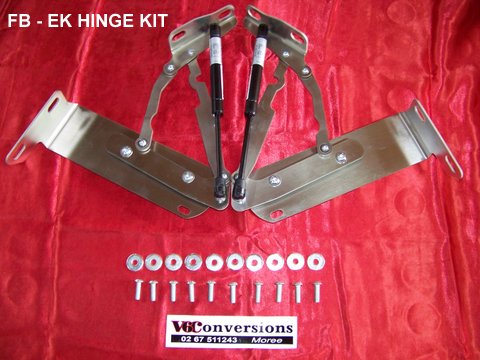

Anyone tried these? Thinking about how to get 7" booster in 5" space😀

Brett027 wrote: Wed Dec 01, 2021 9:17 pm Anyone tried these? Thinking about how to get 7" booster in 5" space😀
I have Brett, they create a lot of room.
You do have cut about 300mm of the drip rail away to fit them, also they flex a bit side to side when the bonnet is up.
viewtopic.php?f=11&t=882&start=825

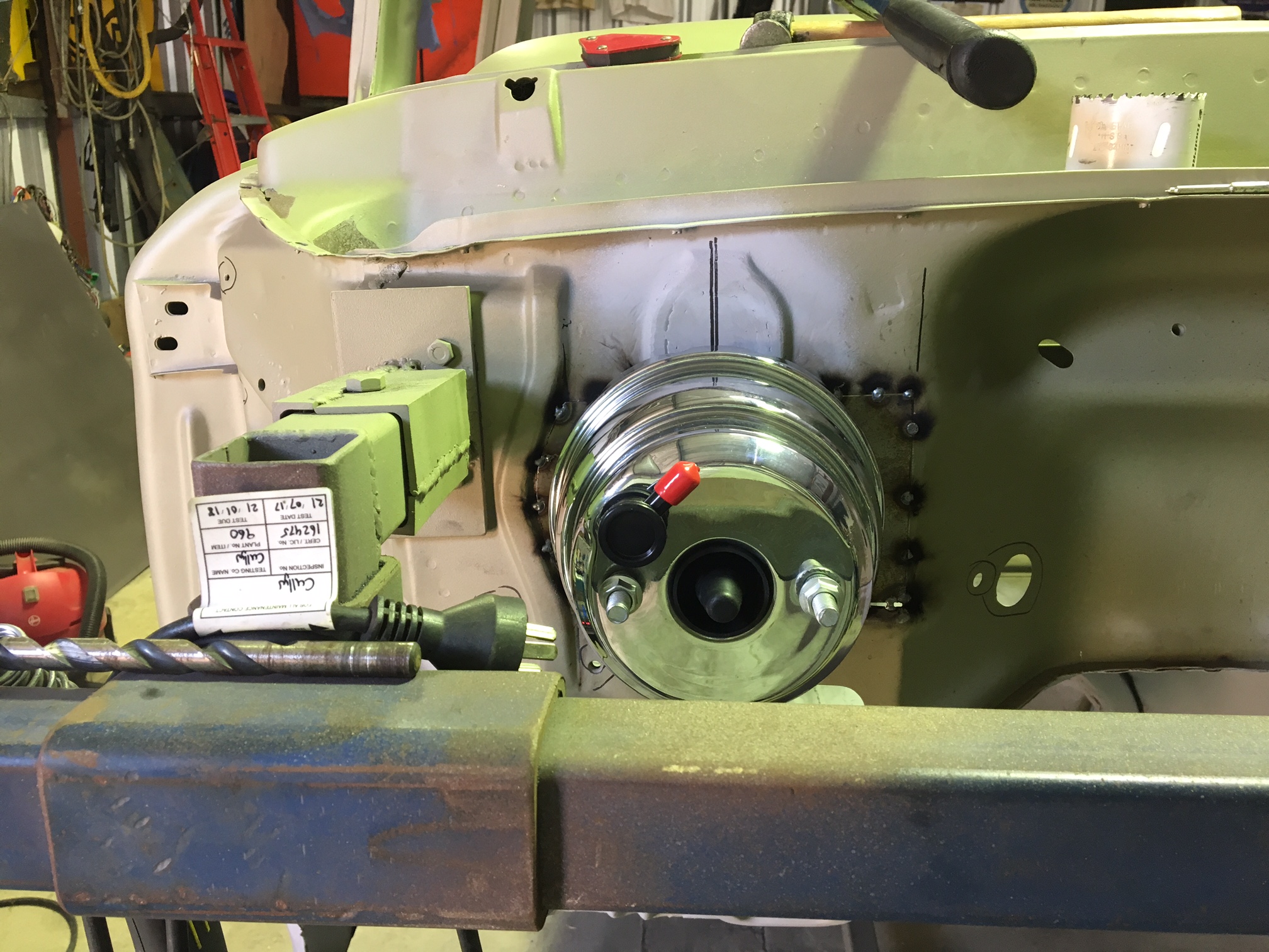

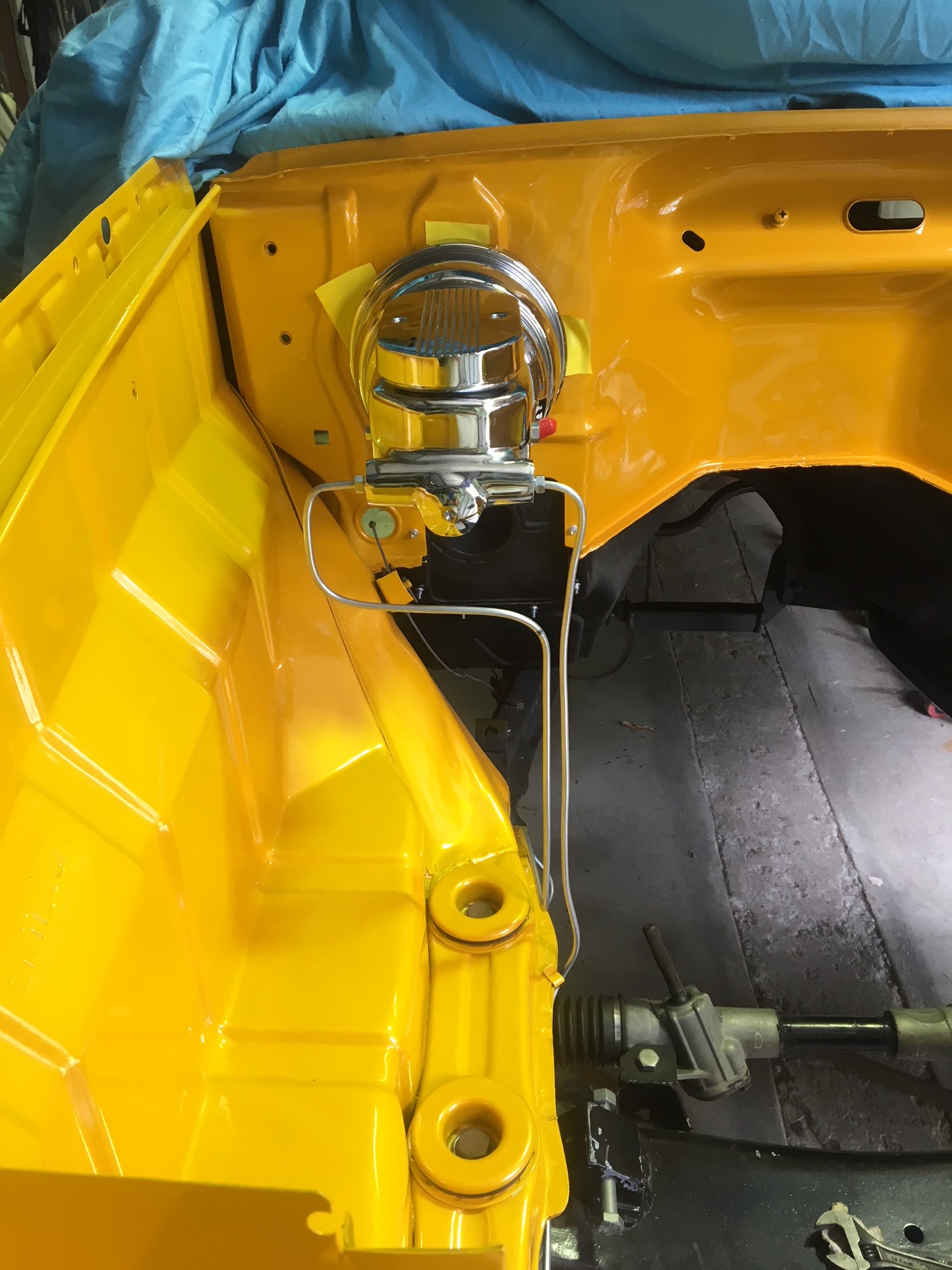

Hi Brett, the photo I sent you of the firewall mod I did to fit my 7" booster means that you don't have to do anything to your bonnet hinge.
Photo of mine installed

Thanks Greg, much appreciated.
Yes Neil, your set up is very neat and with the drawings you sent I am all sorted to do it. I have a complication in that I also have a clutch to deal with- either hydraulic or cable. So i'm still in the mastication phase. Must admit, I'm starting to think about my Powerglide as a possible option.
