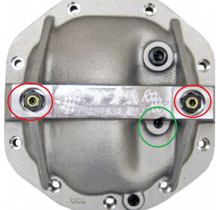

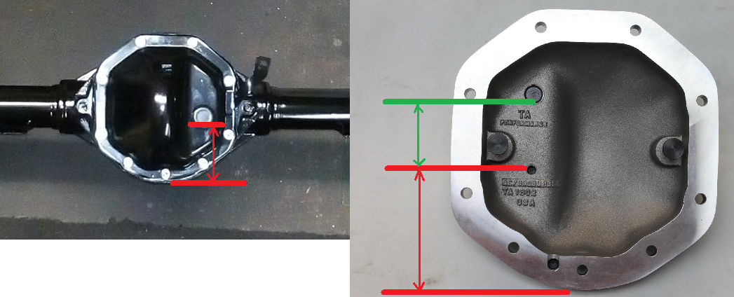

Some more thinking on my diff overfilling. The image to the left is the standard BW78 cover. You fill that till it overflows (red line). The image on the right is the TA Performance cover, which I filled until it overflowed (green line).
Me, being dumb-dumb-not-so-smart ignored the little overflow allen-head plug at the correct level (green circle). I was worried it was part of the stud girdle adjustment (red circle) so didn't touch it. Should have looked harder at the internals before sending it to the diff shop for the overhaul. I followed the TA Performance instructions and filled to overflowing... just not at the right location.
Ta performance cover.png (964.3 KiB) Viewed 2516 times
Waaaay overfull. Looks like I need to pull the little allan plug and drain her down.

just a tad overfull :lol: :lol: :lol: , should be able to decant the excess and do your next 2 diff oil changes for free !!
