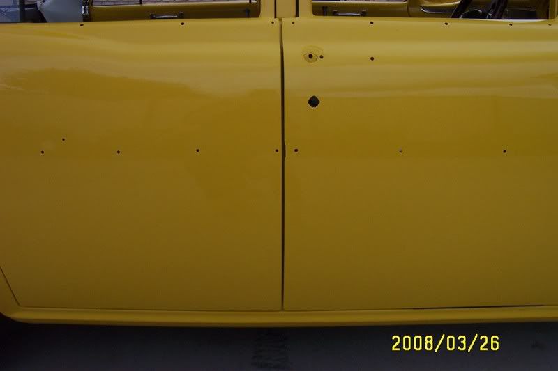

looking the goods now Mal, but whats the go with all the bullet holes in the sides of the car :wink: :lol:

Sammy, it does have a bit of that look about it thats for sure.

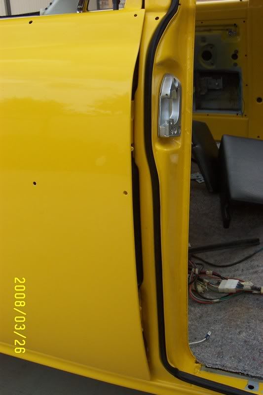

Matty, getting rid of that annoying center section between the doors is really not that hard to do. Ive added
a picture of the doors when shut without the panel
This one is of the center pillar with the section removed. Its really only the rear of the rubber area that your
getting rid off. The rubber still fits as per original

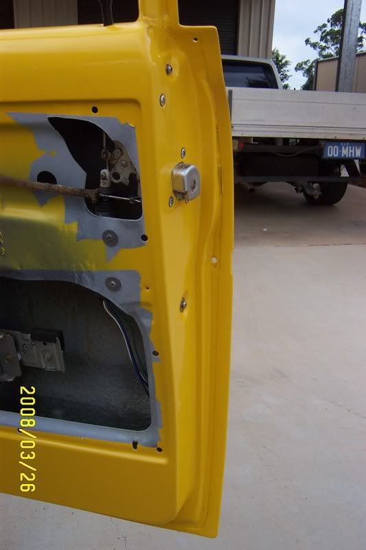

This one show the door how it looks from the inside when extended. All you really notice is the folded lip
on the rear of the door is about twice the size of the original one.
