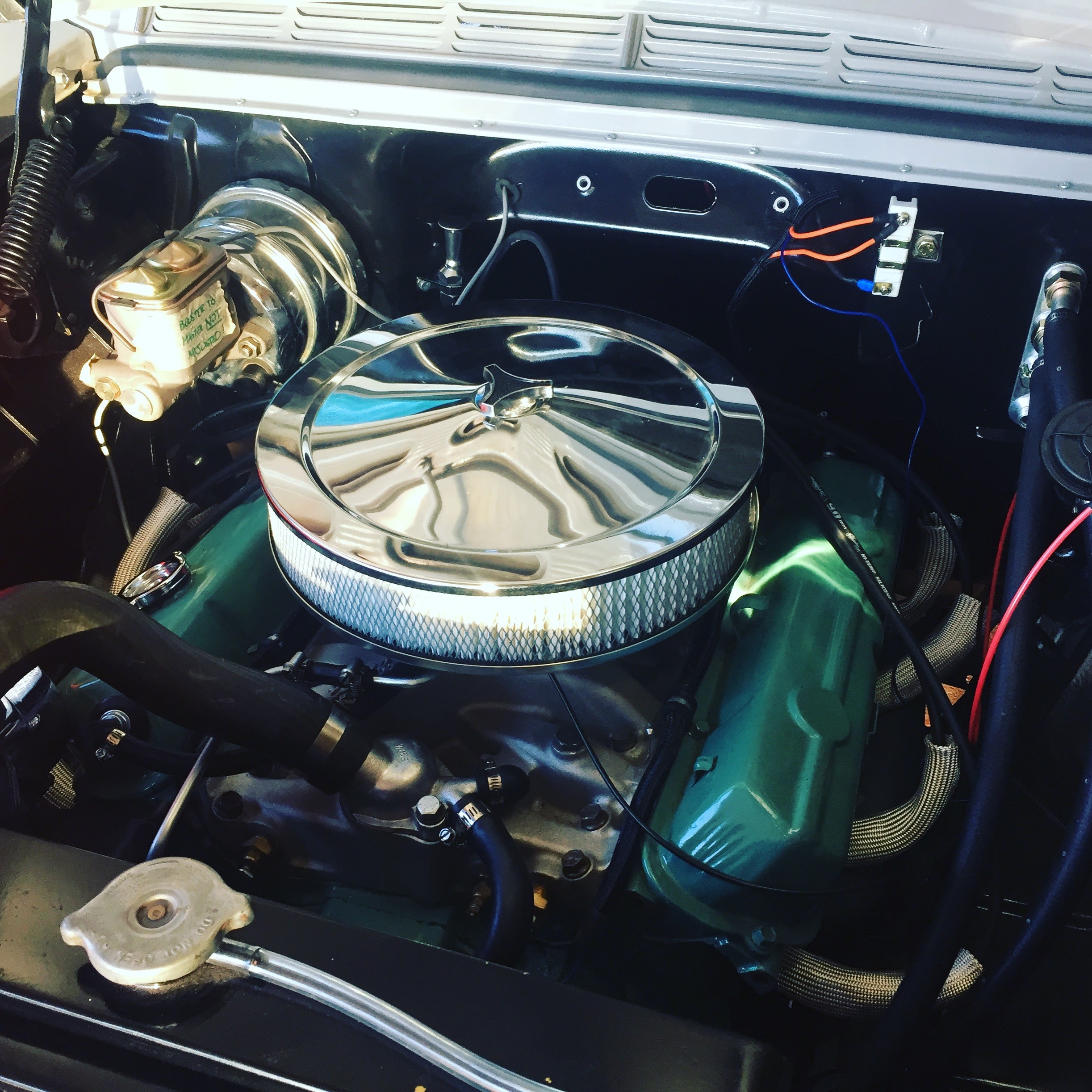

Well its full steam ahead... finally... next weekend is time to fire up the motor...
it did its best to piss me off and thwart my plans (water pump not fully seated, just enough room to get it out between the rad) but i wasn't giving in... just needs an alternator belt and a temp fuel line and its go time!
Still some tidying and stuff but good enough for now!

Nath is you brake booster 7 or 8 inch and did you use the original brake master position of have to go over to the clutch side to clear the bonnet hinge?
Neil H
Re: NoMAD's Kustom FB Sedan
Posted: Mon Jul 10, 2017 1:00 pm
by NoMAD
its a 7 inch mate... with the brake mounting moved to the center on the pedal box (cut out and plated up the original spots) and a HQ pedal bent around the steering column.
