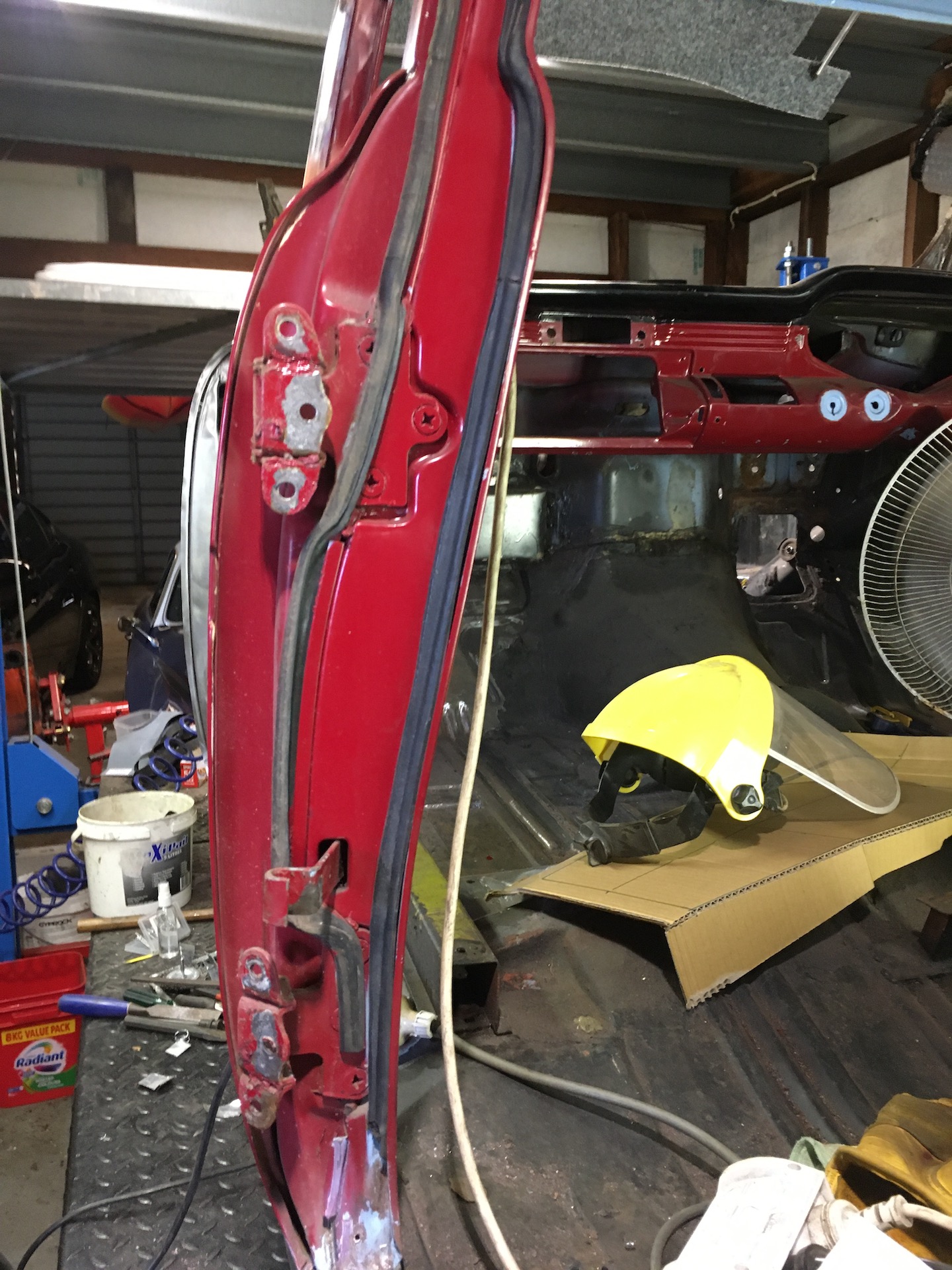

Has anyone got some photos that show how the sedan rear door outer rubbers are installed? Just want to be certain about where/how they pass the hinges. I took this one before disassembly but it doesn't show me much. Many thanks

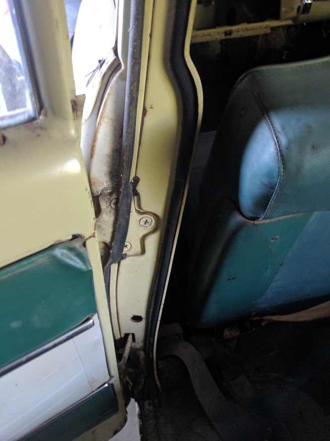

Looks like mine Brett and this was not removed when it was last resprayed.
Not sure about the bottom hinge - looks like I already removed part of it?

Scott's photo is good. As a final guide, the B-pillar face of the rear door has recesses for the hinges. You need to route the rubber so it goes around the inside of the recess. Particularly important for the lower hinge.

Many thanks for the picture Scott and advice Rob. Still not fully clear about route over/around bottom hinge- anyone got something closeup of bottom hinge rubber route?
