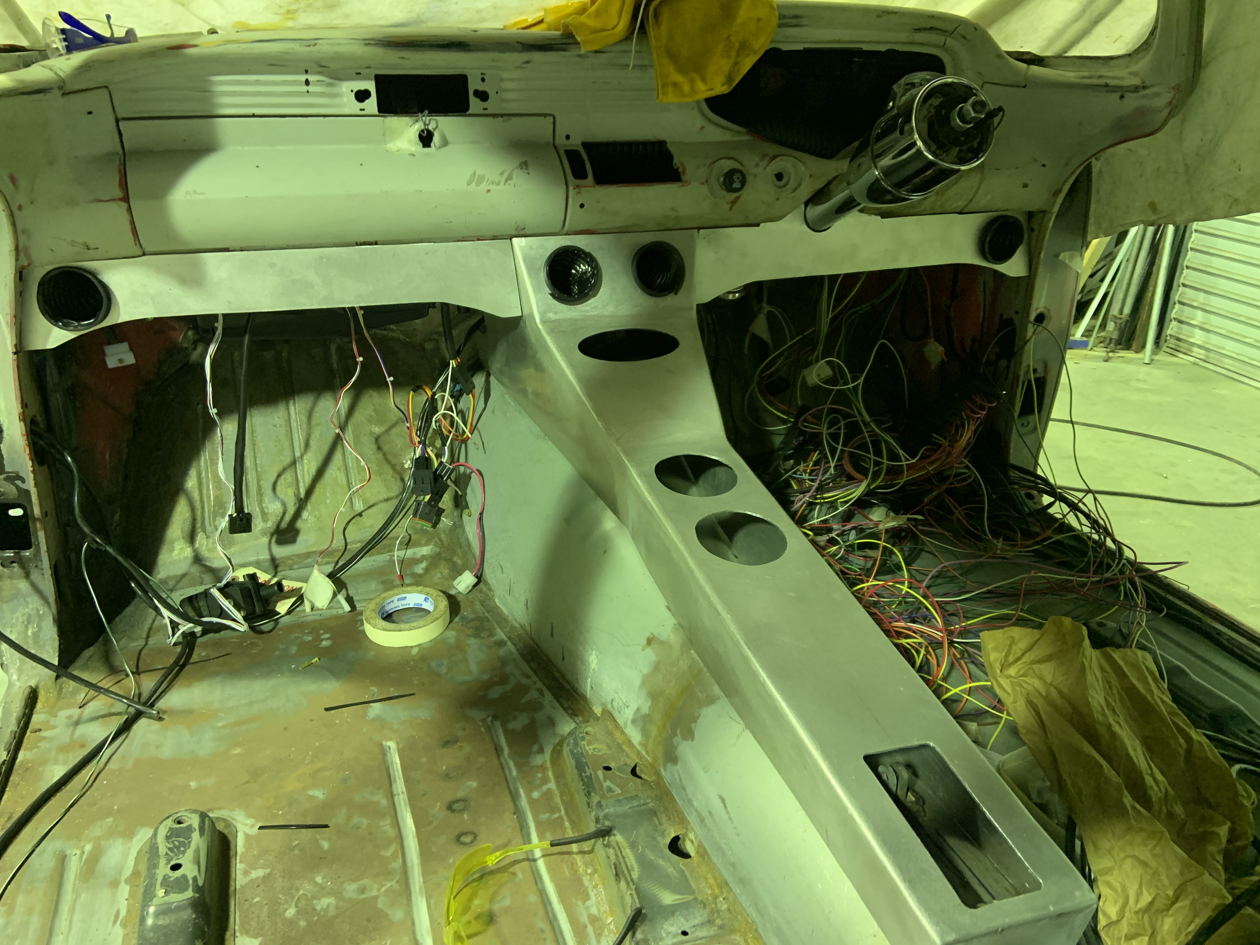

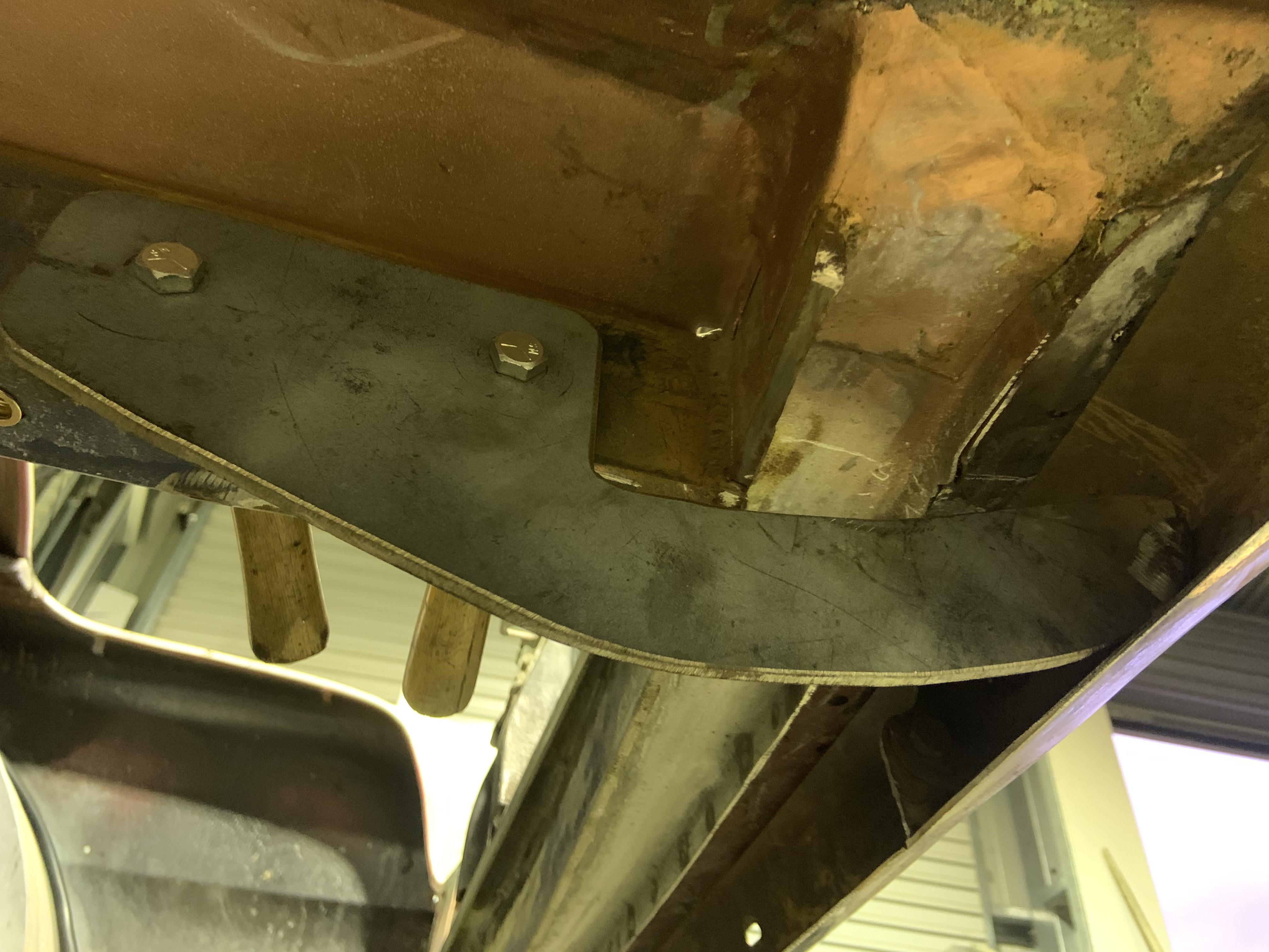

Does anyone have any pictures of how and where they mounted the break away for the collapsible steering column? I had mine mounted but had to cut it back out to clear the light switch. Not much room underneath the dash.

Hi Taz,
Have a look here this is how I did mine.
http://www.fbekholden.com/forum/viewtop ... &start=300
Posts: 5744
Re: LS1EK
I’ve got an LH Torana column. The original breakaway mount is a piece of plate that bolts to the column. I kept that, and trimmed it down a little. Two new bolts went up through the alloy breakaways, which are swaged into the plate. The bolts picked up the factory under-dash column holes... lucky LH Torana is just the right spacing. Engineer did not like the bolts sitting cockeyed (under the dash is rounded), so I made some small ally wedge washers to true it up.
In a smackcident, the bolts stay in the dash, as do the alloy breakaways. The column and steel plate move, tearing out the breakaways from the plate.

All good, I realised it was not going to fit above the column so mounted it underneath.ImageImage

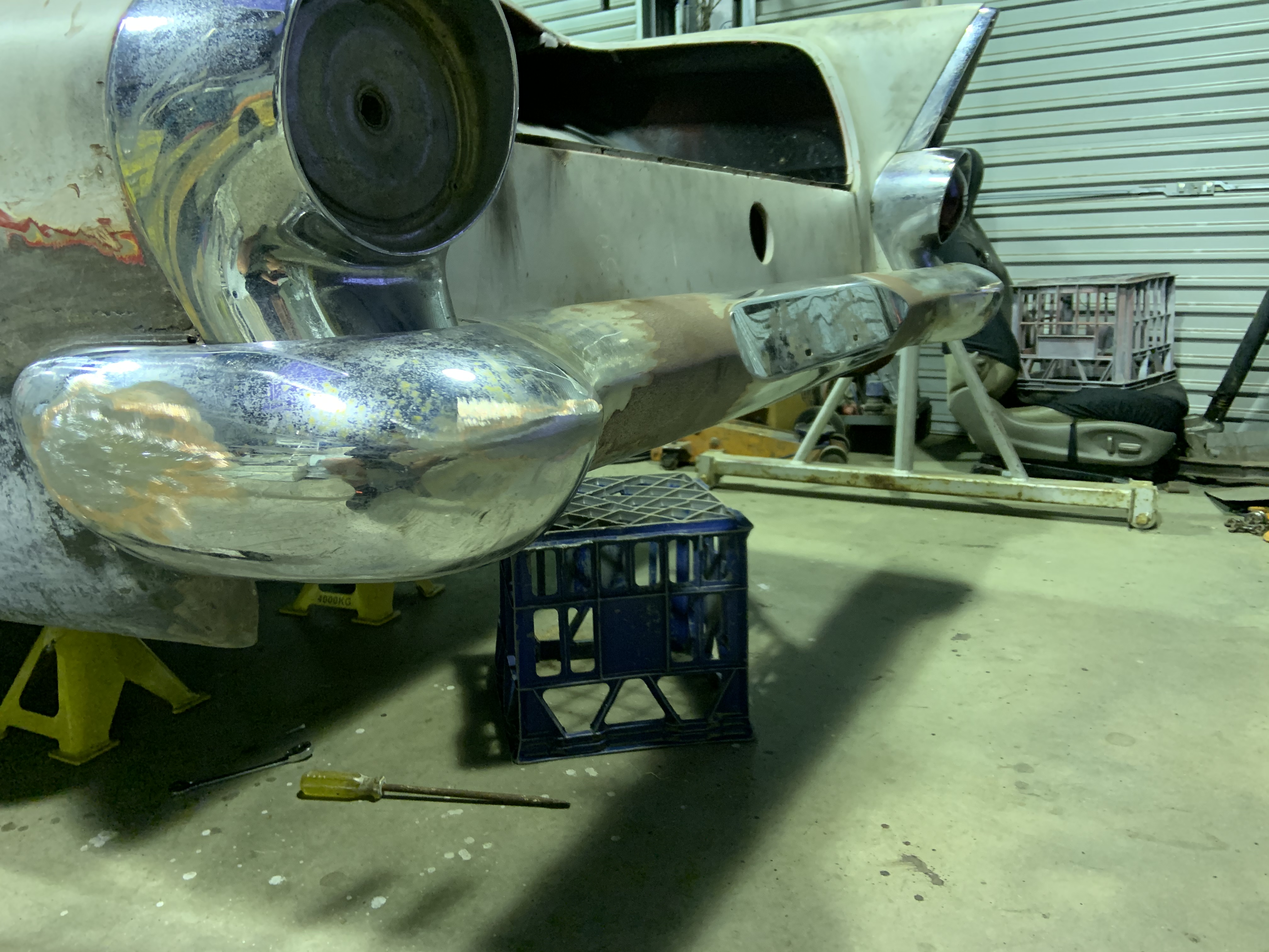

Post by TAZ »
So, things are at a snails pace down here. But I did finally finish mounting the rear bar, now one piece and put some holes in for the heater outlets
