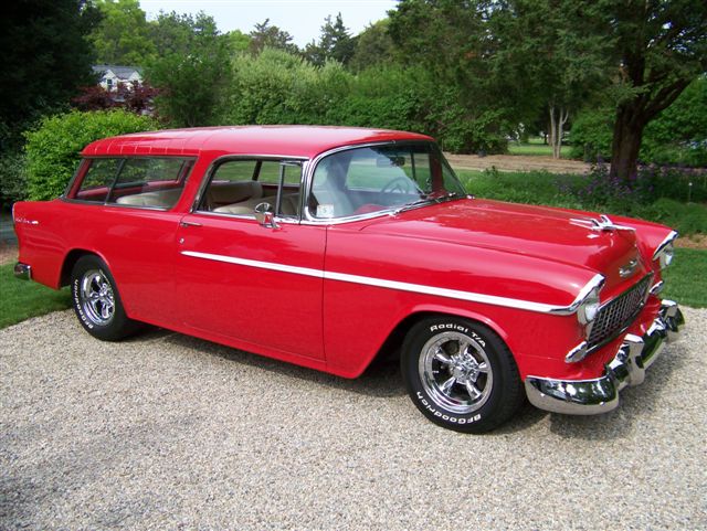

This was supposed to be a simple project, 15 years ago. Loved tri-five Chevs, absolutely adored Tim the Tool Man's Nomad, but couldn't afford one.
Home Improvements Nomad.jpg (89.03 KiB) Viewed 1137 times

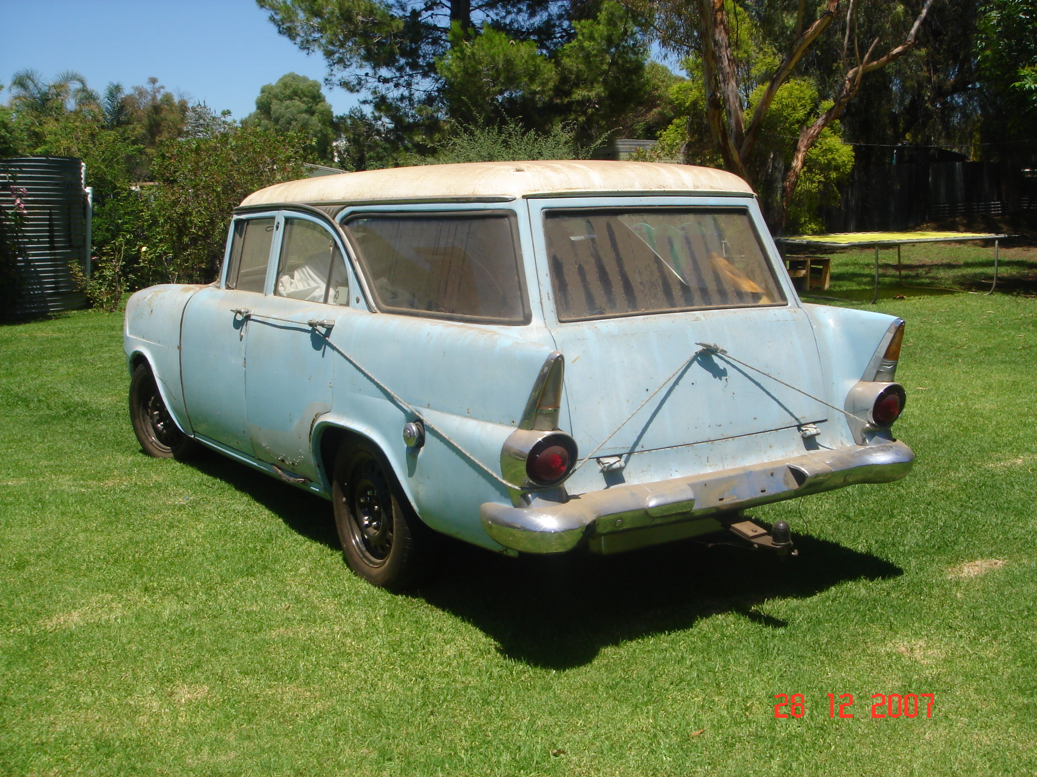

Buy an EK wagon, basic rust repairs, bolt in a Chev, maybe bigger HR brakes, and go.
EK wagon rear stored at Duri.JPG (1.47 MiB) Viewed 1137 times

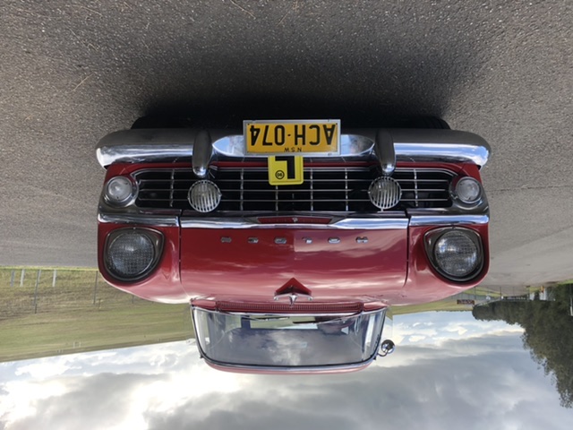

This can’t be good...
Re: harvs ek 327 wagon
Posted: Fri Oct 30, 2020 8:04 am
Greystanes Hell Driver. Upsi' down Miss Jane.
Posted: Fri Oct 30, 2020 9:14 pm
Errol62 wrote: Fri Oct 30, 2020 8:04 am Greystanes Hell Driver. Upsi' down Miss Jane.
I hope thats not an omen Harv ......... :esad: :shock: :shock:
