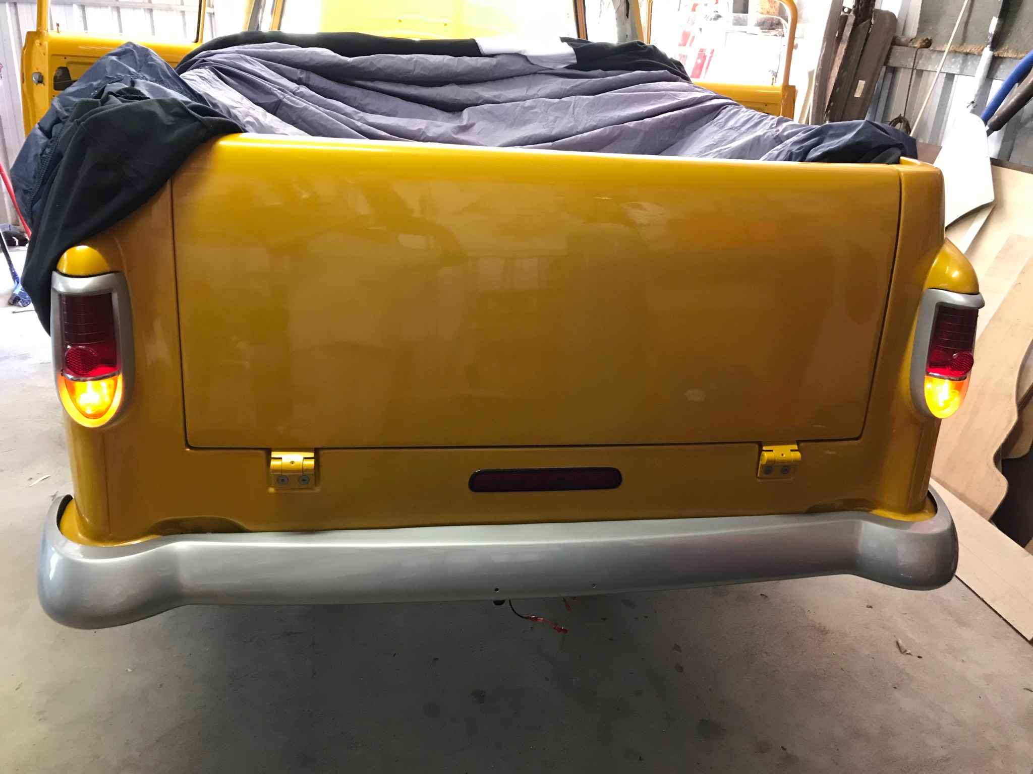

Reverse lights work
I'm at a real impass with the wiring just can't get my head around the column wiring for the wipers and lights and the VT headlight switch everything else is working, gauge wiring is simple, engine starts from ignition etc better get a hold of the wiring diagrams and nut it out. :crazy: :crazy: this is when you need a son-in-law that is an auto electrician :roll: :lol:

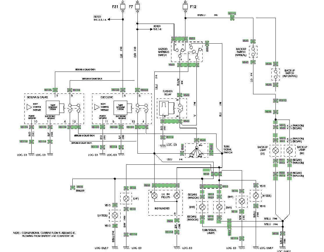

Hi Neil
Turn signal.PNG (56.49 KiB) Viewed 556 times
This may help circuit diagram for VT turn signal
Regards Keith

Really appreciate it Keith I also went and purchased a VT manual yesterday but your diagram is a good one thanks.

I appreciate the offer Keith but think I will be ok now, I had a pretty reasonable day yesterday and using your diagram and the manual I have purchased I was able to get the wiper motor working in both speeds from the column (no interrmitant yet or park) and the rear blinkers turning on and off on the correct sides.
I am back at work today :silent: :esad: so have to wait until the weekend; need to run the headlight and front blinker/park light wiring now and get a blinker flasher and I might then be able to get that side of things finished.
