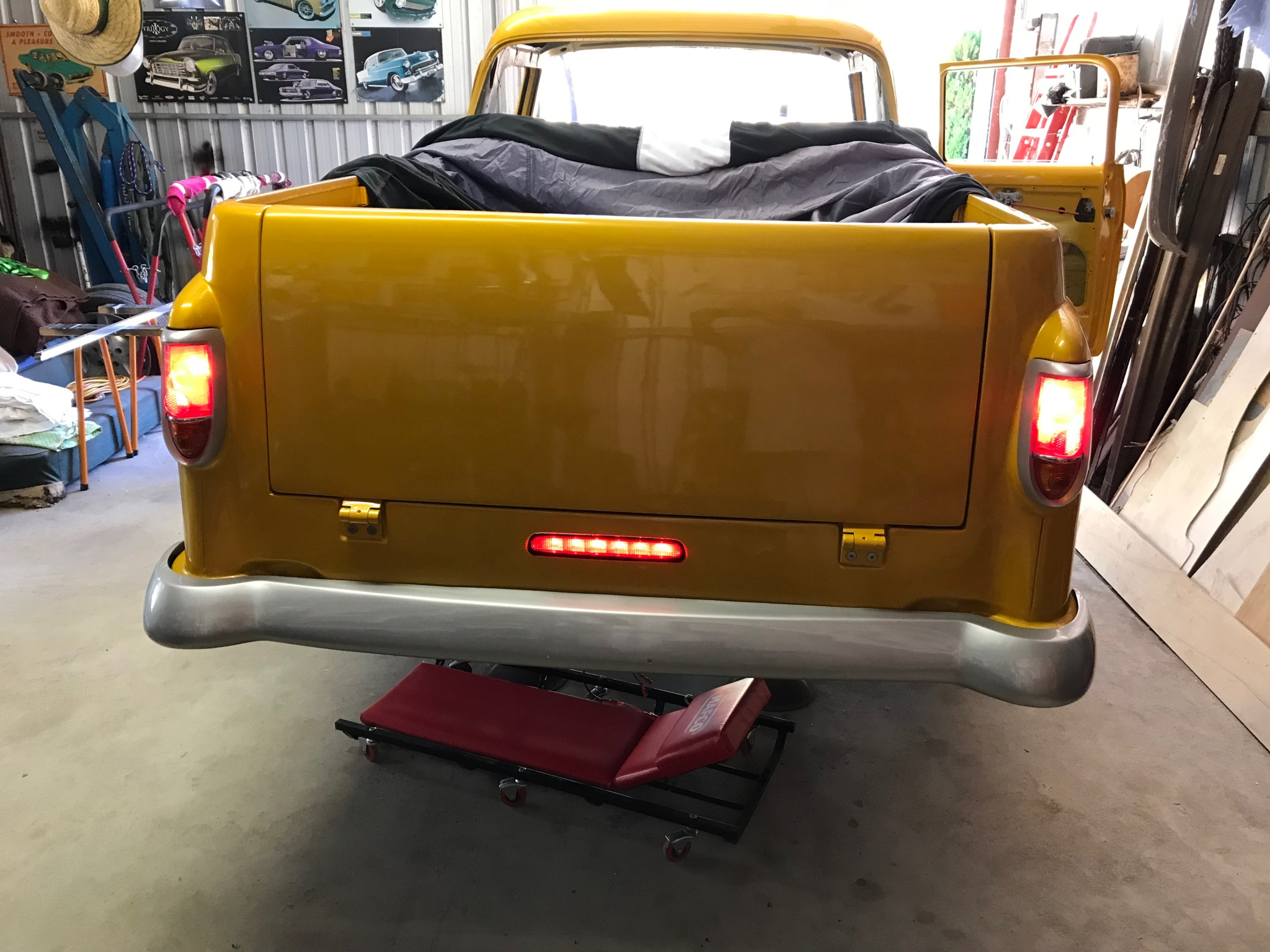

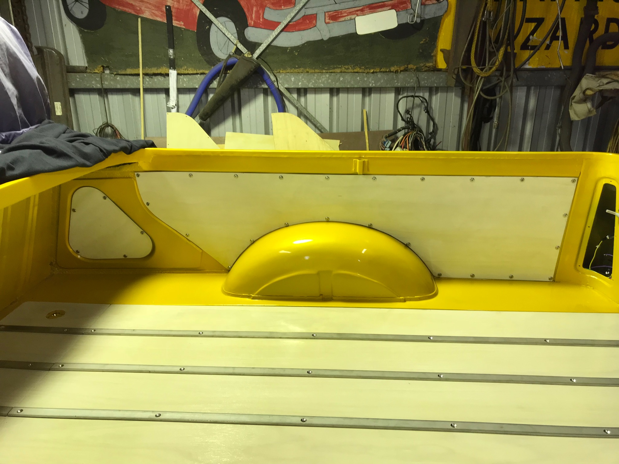

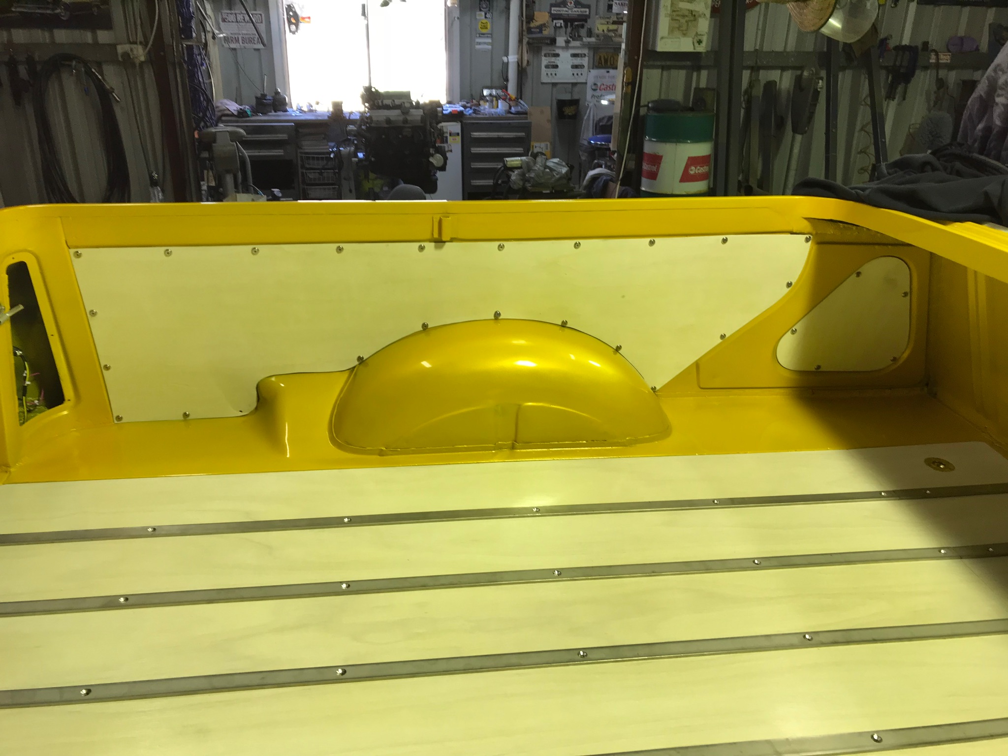

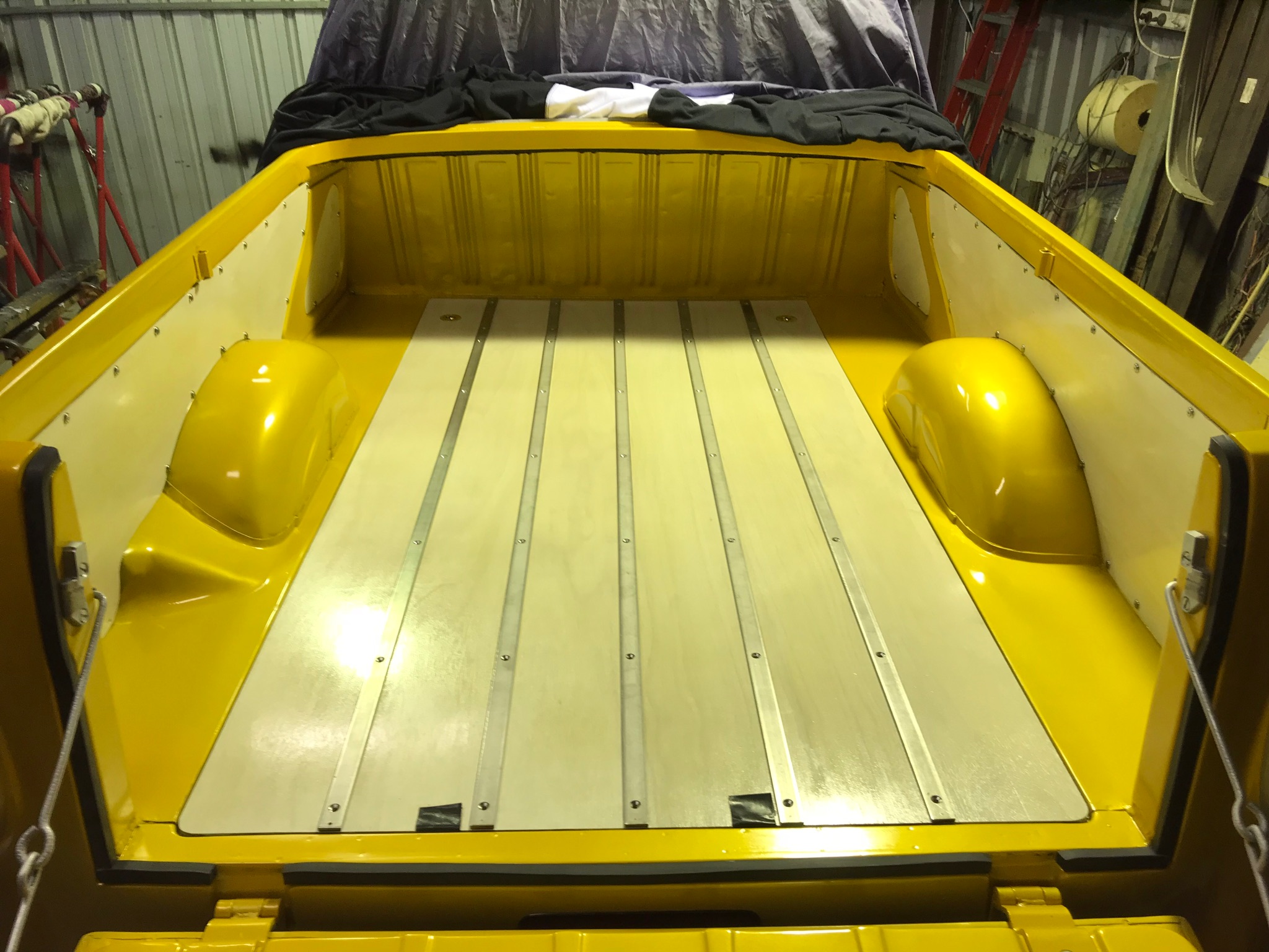

Soooo I wanted to try to finish off the tray including the wiring before going up front, I had originally planned to upholster the side boards of the tray but after using the lime wash on the floor decided to do the same, I can always change my mind later. Run the rear lighting and using my battery charger powered them all up and checked it all worked. Finished modifying the engine harness that I have fully wrapped and the where it runs under the passenger side exhaust I have wrapped it in exhaust heat wrap, installed it onto the engine, fitted the radiator and the rest of the water piping that I had put off until the harness was in. Then I was doing a spa project for the wife and I and had an argument with my angle grinder

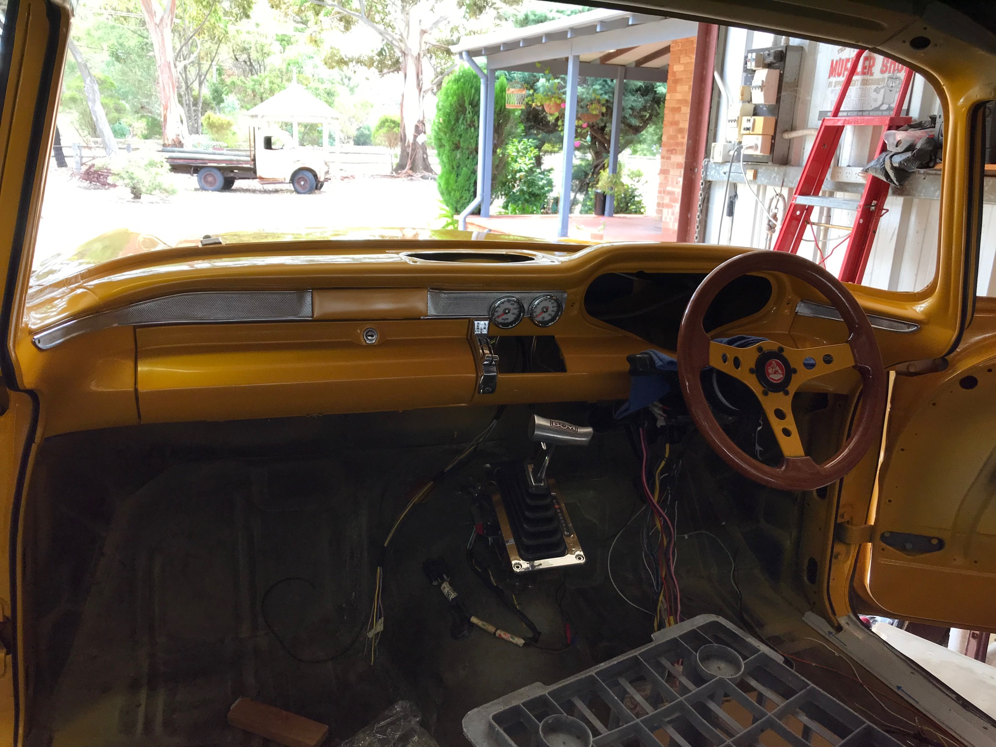

Anyway played around inside the cab where most of my work is left to do, I had a nice set of dash trim so adapted it for where I had to fill the 2 previous gauge holes and fitted up an original radio blank.

Your rear end looks good Neil. Having the side panels match the floor seems to work.

My that tub looks purty Neil.

You making good progress there. The side panels in the tub tie in nicely with the floor

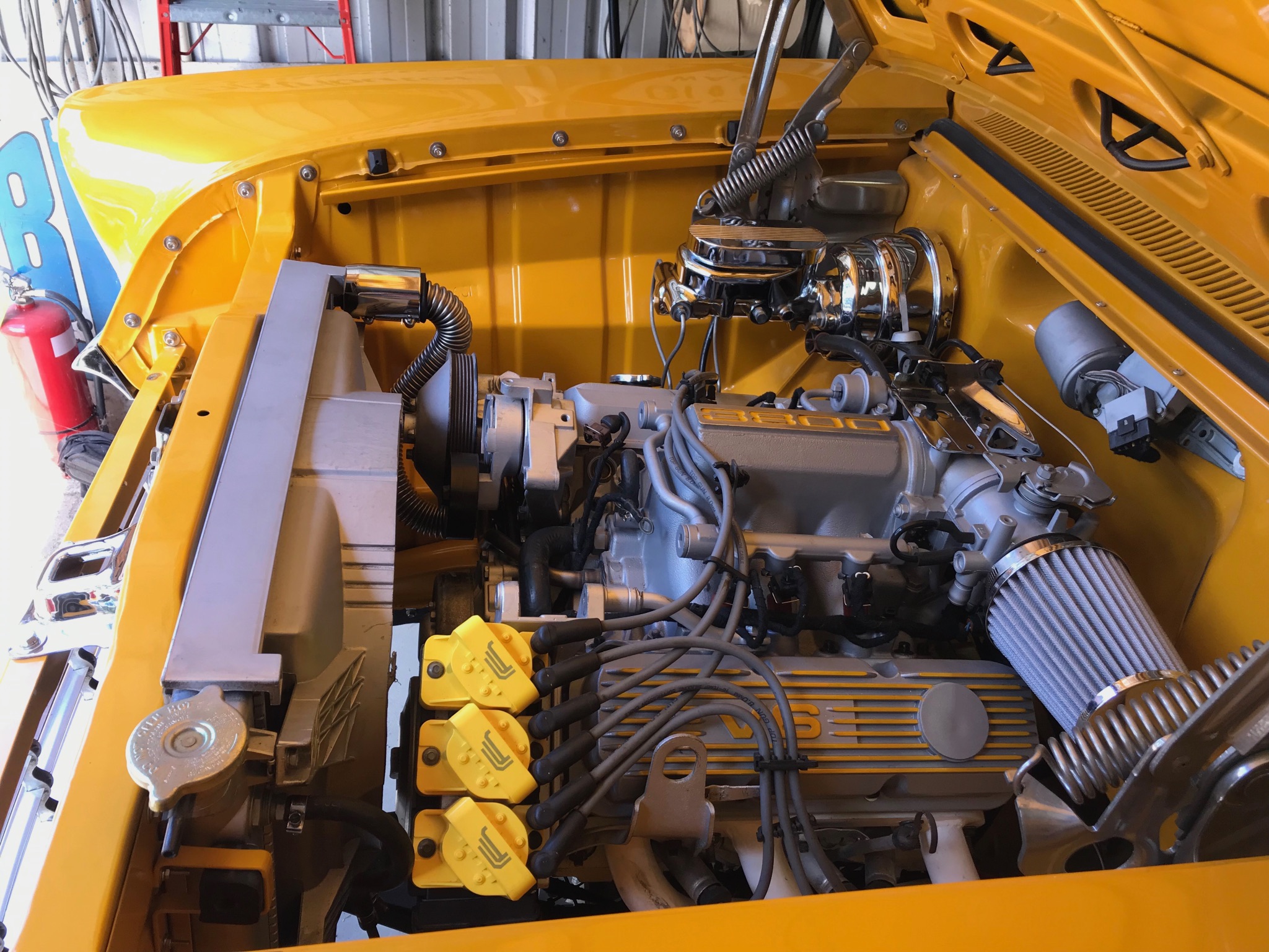

Filled the radiator with water to check for leaks and all seems good, fitted and connected the alternator and serpentine belt.
Still playing with wiring, I powered up the wiper motor yesterday, sort of through the VT column switch, and with cable tie wiper arms it looks like they are stroking really well, also connected power through the column ignition switch into the engine harness including the computer and the fuel pump, pulled the spark plugs and have been able to turn the engine over trying to get oil pressure, no success as yet.

Couldn't help myself yesterday, put temporary power to the oil pressure gauge and cranked the engine it was telling me we had 50psi so I threw the plugs in, 20 litres of fuel in the tank fired it up, no exhaust just the headers, took a bit to get going.
I haven't sorted the accelerator yet so was just pulling the cable, engine sounds fantastic for a fairly warm little V6. I think I had a sexual moment
