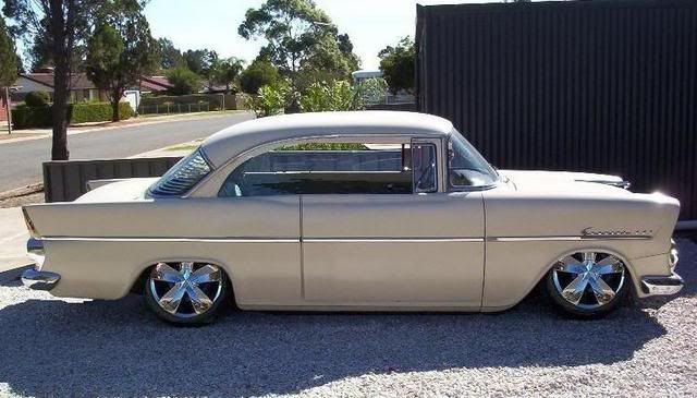

Harko, I reckon the "planning" photo image, looks absolutely awesome!!! :twisted: :twisted:
Can't wait to see the progress.

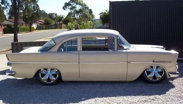

heres a photo chop i did on mine a few years back just after i got the ek 8)
i was just playing but i did start on a old shell but had too much on at the time i think stinky still owns the ass of it now 4 a lounge
i know bad tast in wheels but ya get that :D

Harko, looks good except I'm not sold on the yellow stripe down the side....

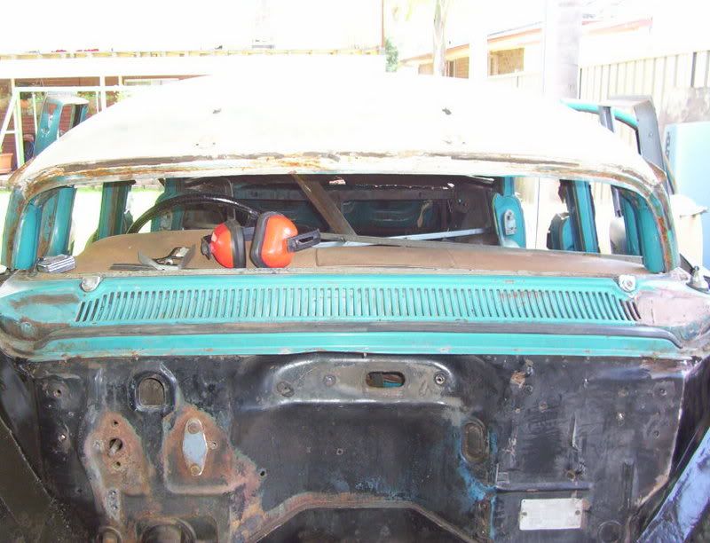

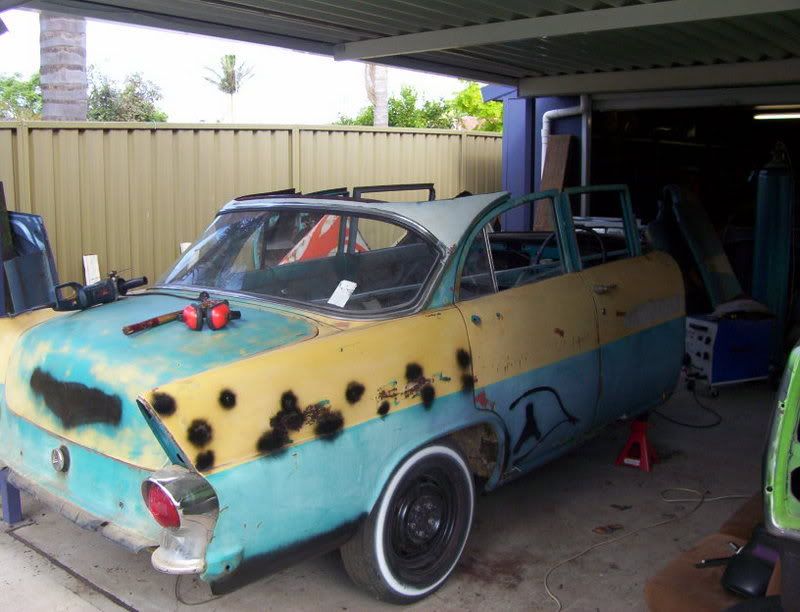

Heres the update ,

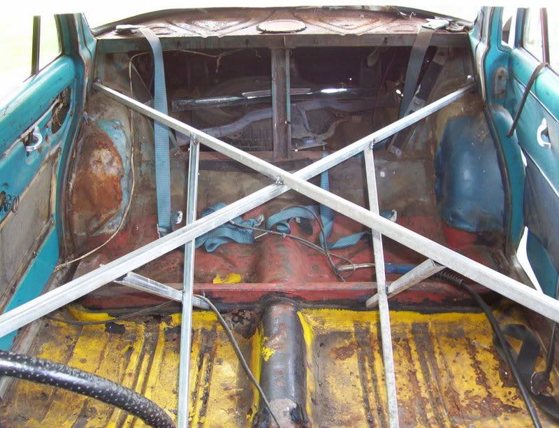

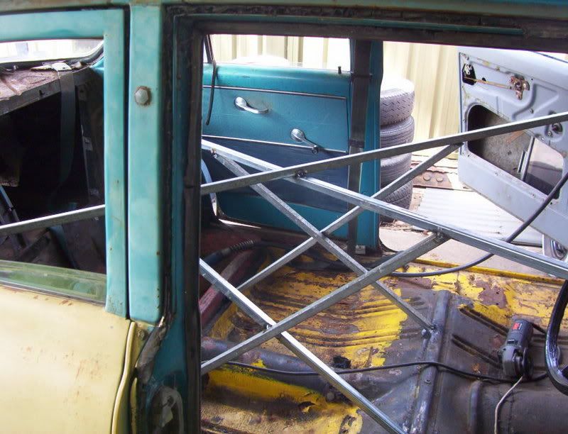

The body got some bracing,
Then lopped off the main roof section ,
I hopped in the boot on an old Jazzersize mat (from when I used to keep fit :) :roll: ) and started to look for a good line to divide the parcel shelf ,boot hinges ,and all the bracing thats factory fitted so I could get the rear screen free ,But it must of either hurt my brain or been real comfy because when my daughter tapped me on the leg I realised I was shleeping :roll:
Tomorrow I will set it free but I'll have to maneuvre a spot weld bit in there and try to pick apart those boot hinge braces from the parcel shelf ,weld a little more bracing in to support it so it stays put and go from there, stay tuned on this same bat channel
Are you sure you have enough bracing there Harko :shock: :lol: :lol: :lol:
I'll be surpised if it moves, you look like you have done this a few times before.

When I did the panelvan I didnt put diagonal bracing in so it took me about four hours of trying to pull two points into line with the roof and tack it with the third hand :?
This aint movin....

Thats what I see in EK Jays avatar with the green paint "blacking" out the pillar areas and it looks very 57 pillarlessy :D .
Im on the right track , but to compensate for the curves Im going to lay the rear screen over 1 inch which Im guessing wont be noticable but will seem a little sleeker .
I set this one up for Thomo :D Some competition for lowest chop.
