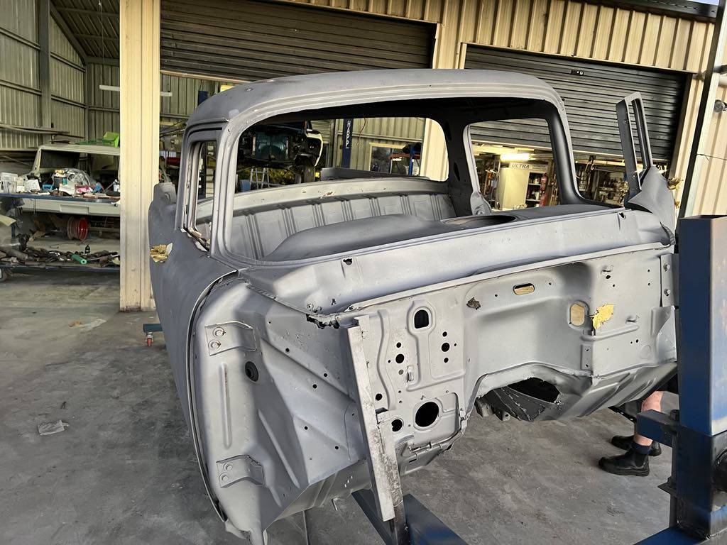

The tray section is a bit worse for wear but nothing that can't be fixed . Meeting with the panel beater this afternoon to workout what we need to order , any pointers on different places to get patch panels would be great.

Hey Sneezy nothing really out of the ordinary there mate the utes always suffered there in the tray I have a subchassis replacement are if you want it for postage I’ll check which one it is and let you know.
As for panels we are pretty restricted Rare Spares are probably your fist stop but there are other sellers on say EBay check them out.
Posts: 11675
Re: Family Affair Ek Ute
Thompson chassis at Traralgon make the rear ute floor now. Otherwise you can cut up a panel van like I had to do. Some parts I used on my ute and some went to other forum members fairly recently. Front and rear floor panels are readily available, generally through rare spares. Thompson chassis or someone may Sven be making the “rear seat” under panel, but the diff hump will have to be donor or fabricate.
That is a lot of work there in that floor. I would be looking for a sedan floor for the rear seat and diff hump section.
There were patches available for the rear lower quarters from Retrospares, but there isn’t much to them. The wheel arch section is pretty poor. I would just fold something up on the bench for those bits.
Rear of passenger sill may get away with a patch, depending what the inside looks like. Long road ahead.

Errol62 wrote:Thompson chassis at Traralgon make the rear ute floor now. Otherwise you can cut up a panel van like I had to do. Some parts I used on my ute and some went to other forum members fairly recently. Front and rear floor panels are readily available, generally through rare spares. Thompson chassis or someone may Sven be making the “rear seat” under panel, but the diff hump will have to be donor or fabricate.
Hi Errol
Thanks mate
I have seen Thomson's online and sent a message. Do you know if his floor pans incorporate this section

Rares rear sedan floor pans are that section
Posts: 2536
The bit you cant buy new is the hump part where the rear shock mounts are. It's a tough bit too because its multiple layers. All these repairs are in Project 2 and others. Unfortunately your rust was our rust😀.
What are your A pillars like at the bottom?

Brett027 wrote:The bit you cant buy new is the hump part where the rear shock mounts are. It's a tough bit too because its multiple layers. All these repairs are in Project 2 and others. Unfortunately your rust was our rustImage.
The left side is good the right side is pretty gone
