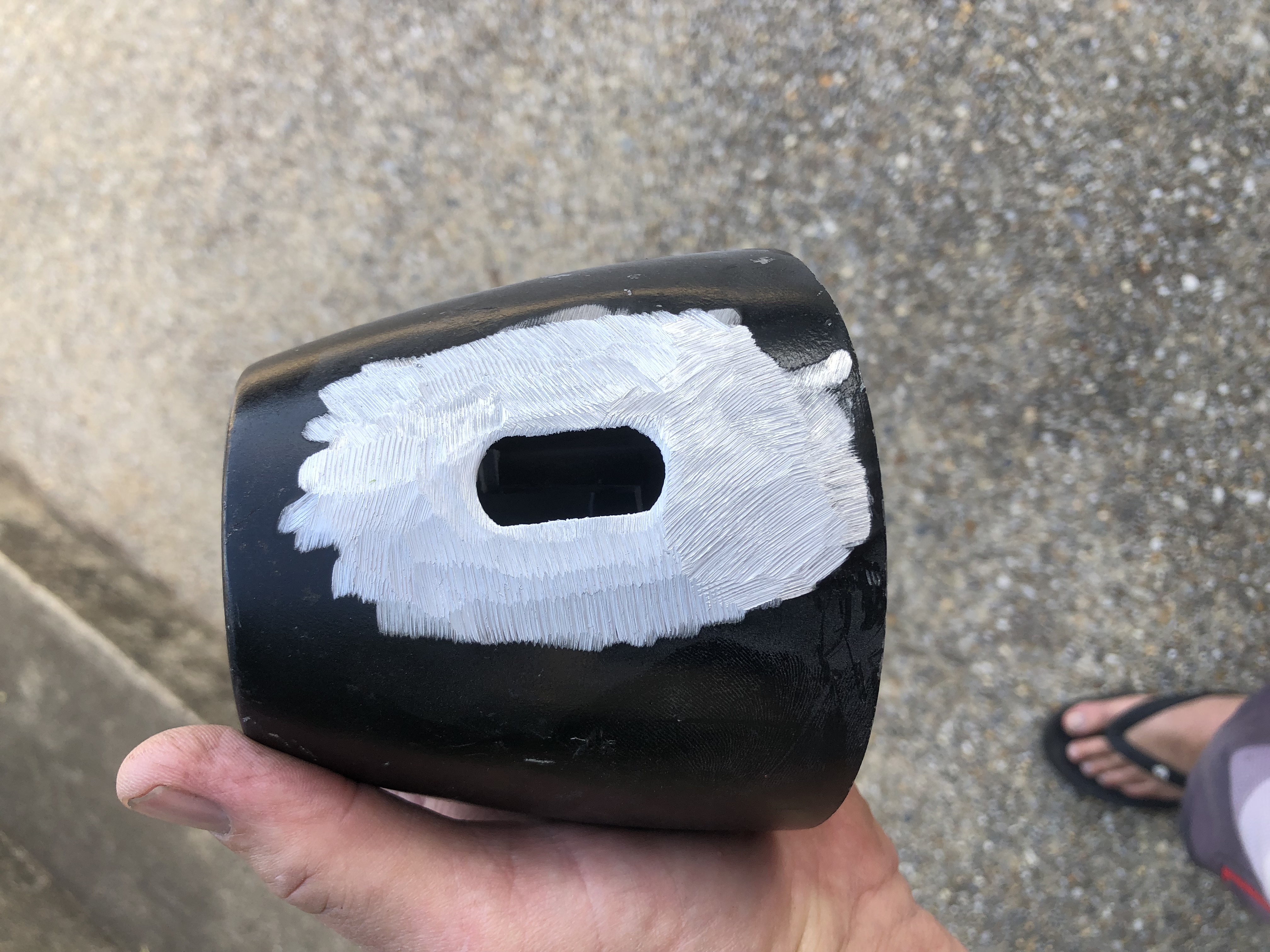

Cheers Blacky👍can make the distribution block work but those rigid to flex line brackets are gone. Front mounted calibres so will have to work out another bracket setup and butcher some more welding. The wiring is coming along well and been trying to tackle some of the little things that need doing. As I said, my welding is shit but I can still use fibreglass
quick rub back and another coat of paint should be good. Had a crack at some ally work too
see what it looks like when I do the final install and get the protective sheet off then decide whether to paint it or not
