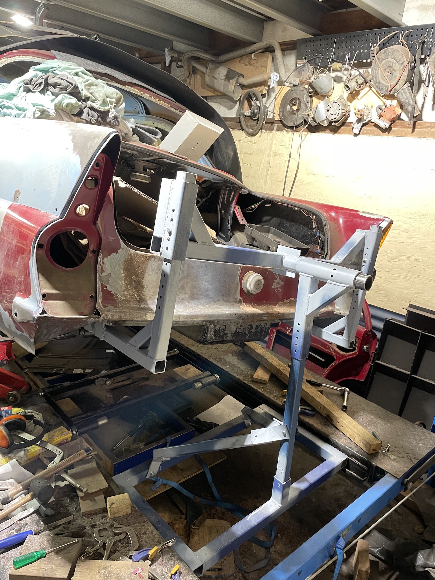

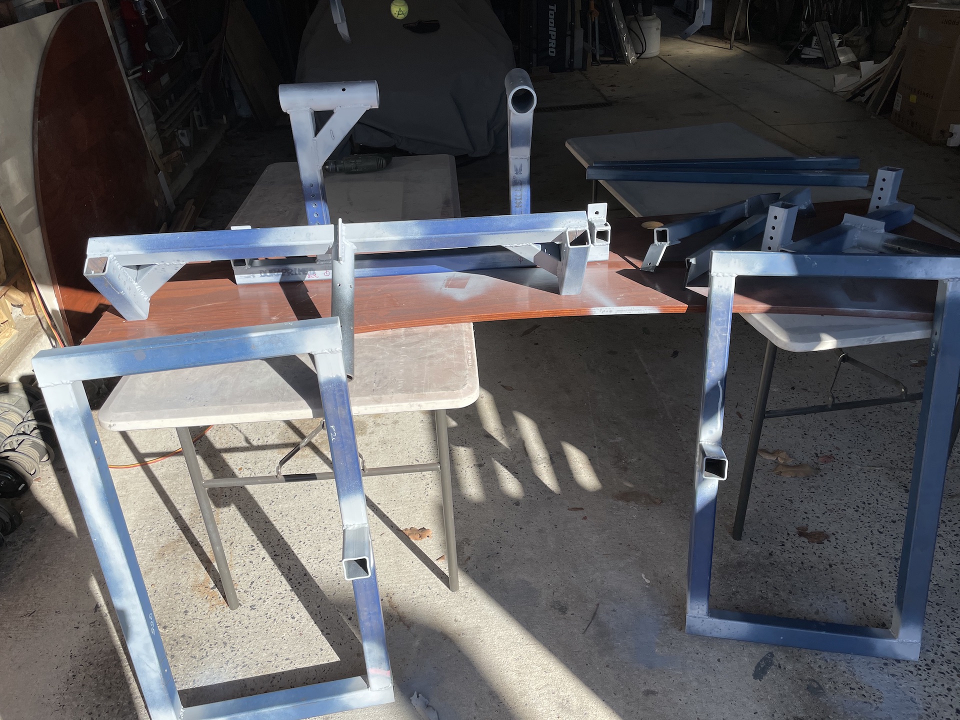

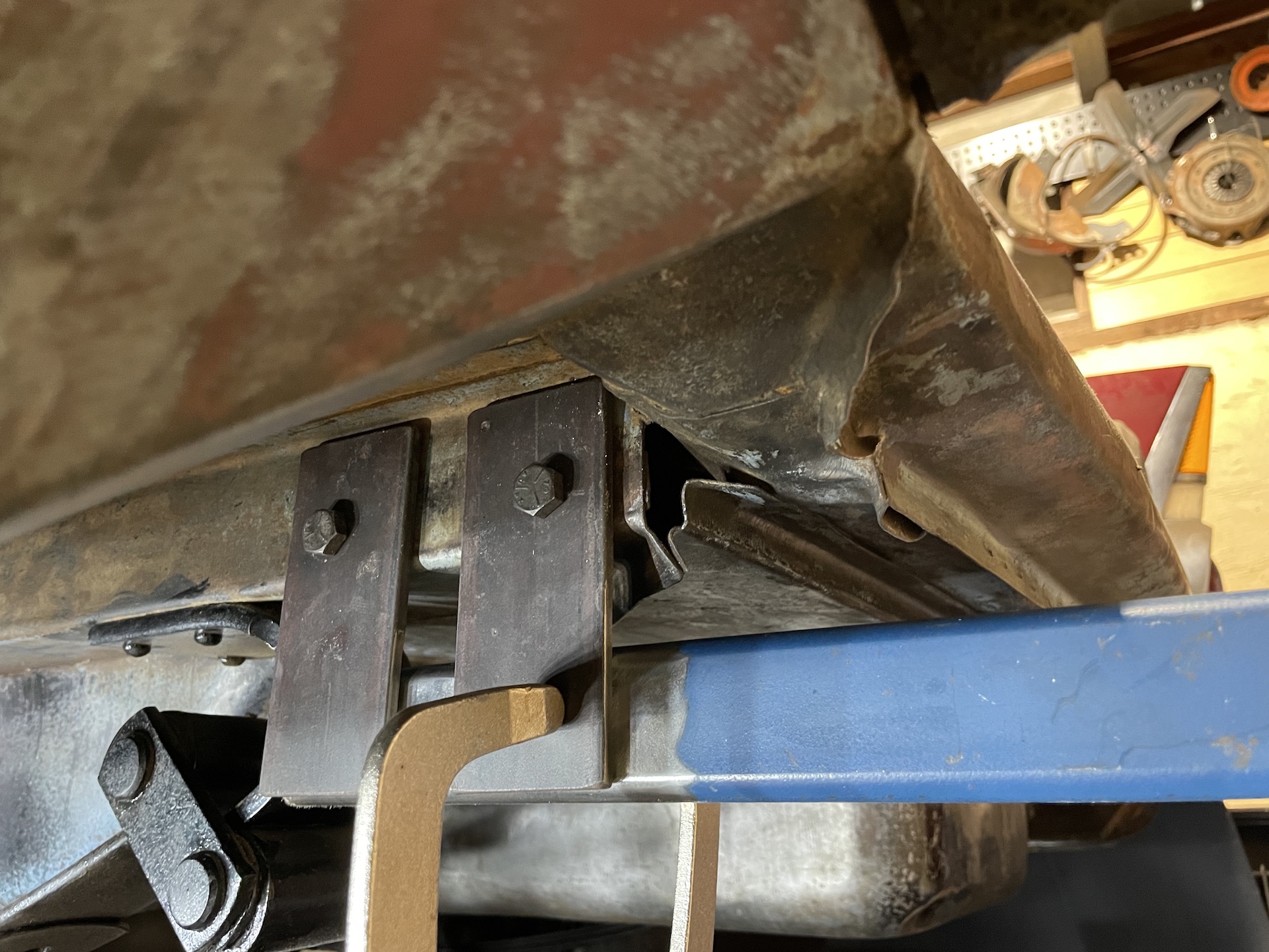

Okay - nearly there.

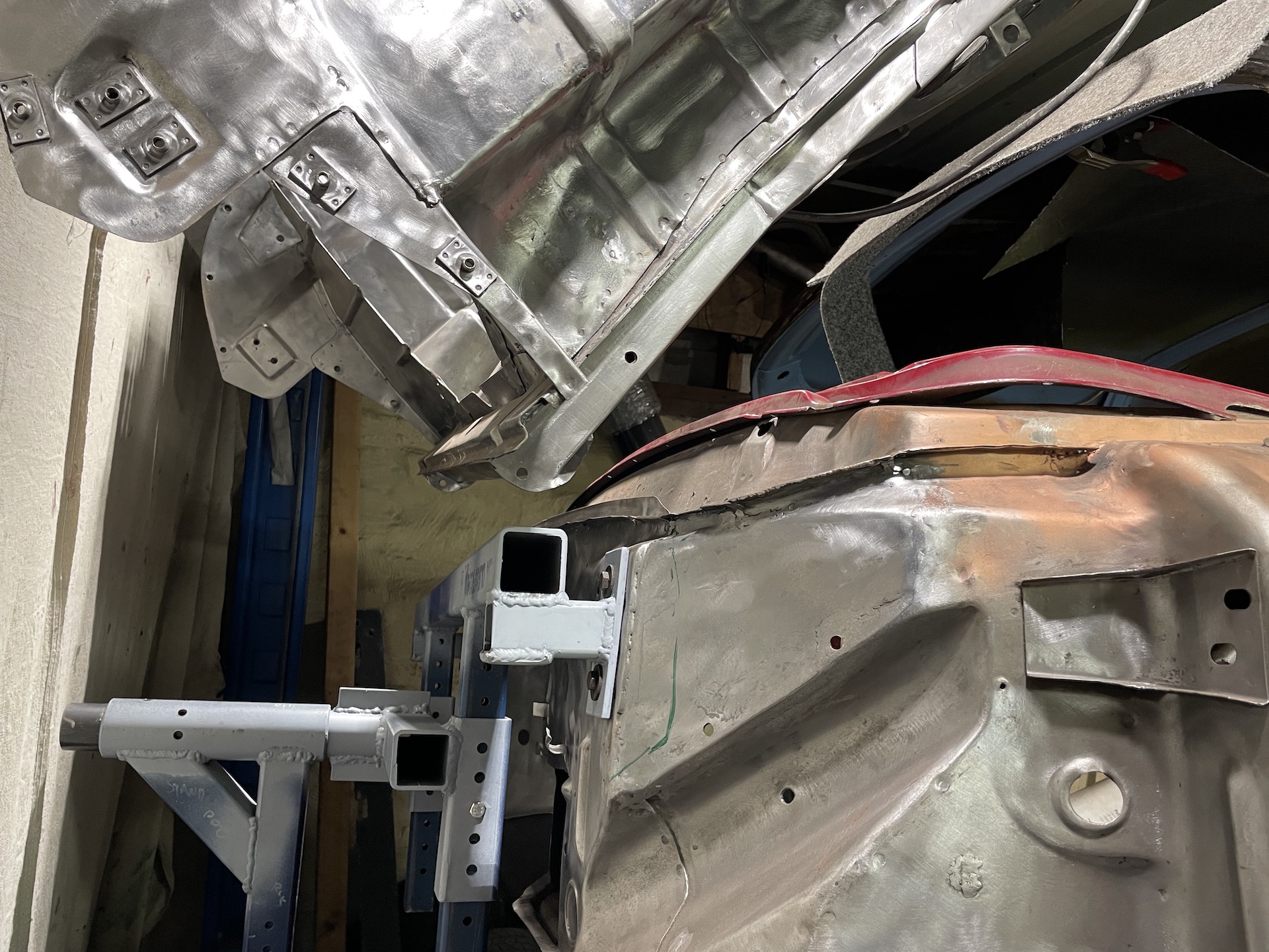

Bolted the plates into the rear bumper mounts and tack welded. Lots of lining up with level and builders square to get as close as possible. There is enough play in the bolt holes for any furthrer adjustment.

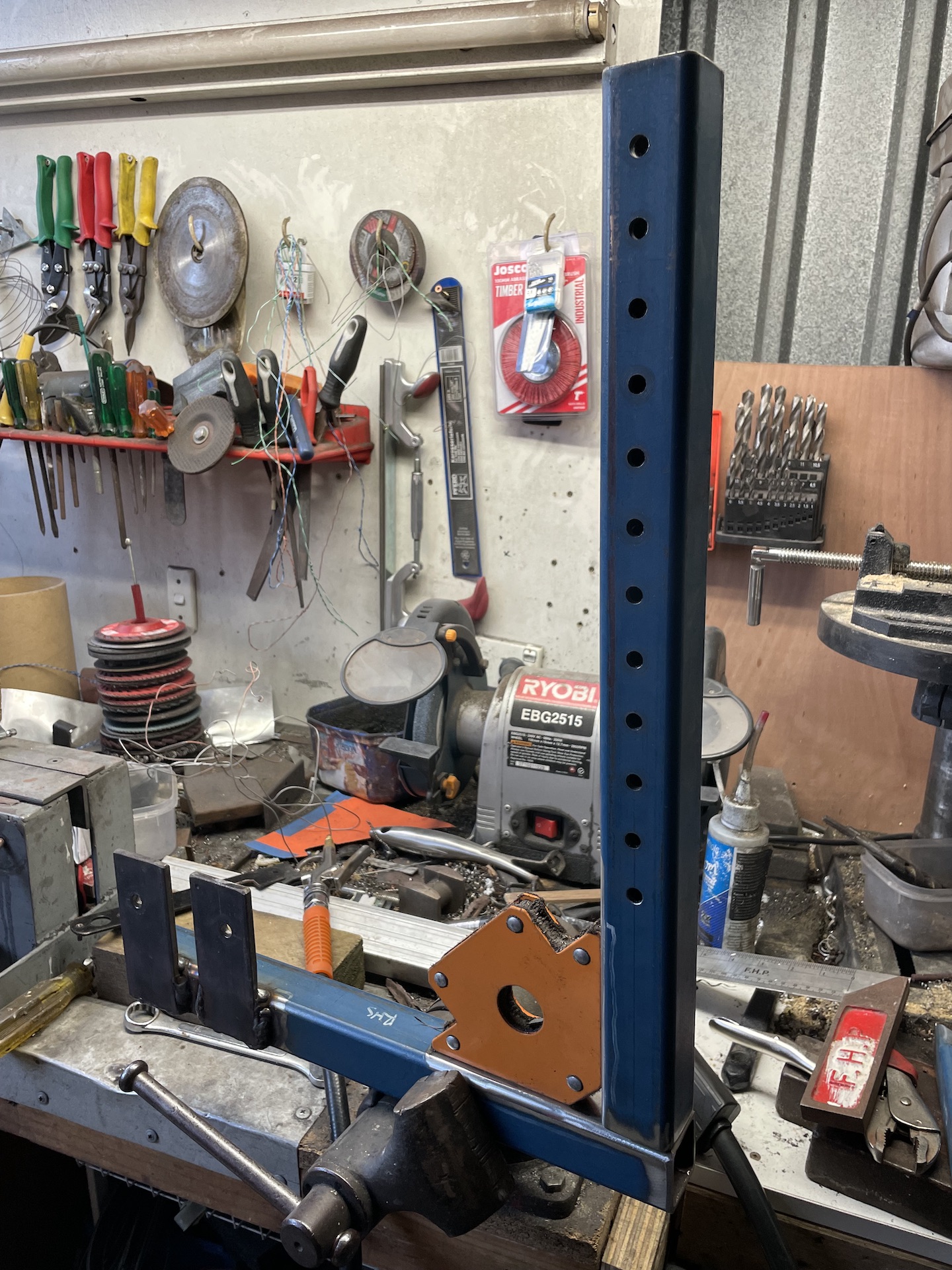

Out into the vice to finish welding each leg.
Bit of art. Both legs welded up and in place.
Next I bolted the cross beam to the legs and tacked it to the centre shaft. Back out to the vice to finish the welding in relative comfort.
Time for a bit of grey primer to finish the job.

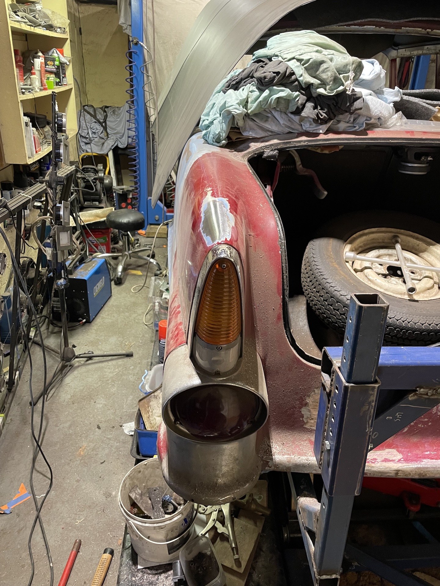

Reassembled and started to balance - and ran out of room. Need to move the subframe, the car, or both.
Fully floating. Need to take the diff out to get it balanced but it moves pretty easily. Will also slide the car back as far as I can to try and clear the sub frame. A bolt in each inside corner of the base, through into the rail of the hoist and I'll call it done. That nine months just flew by.
