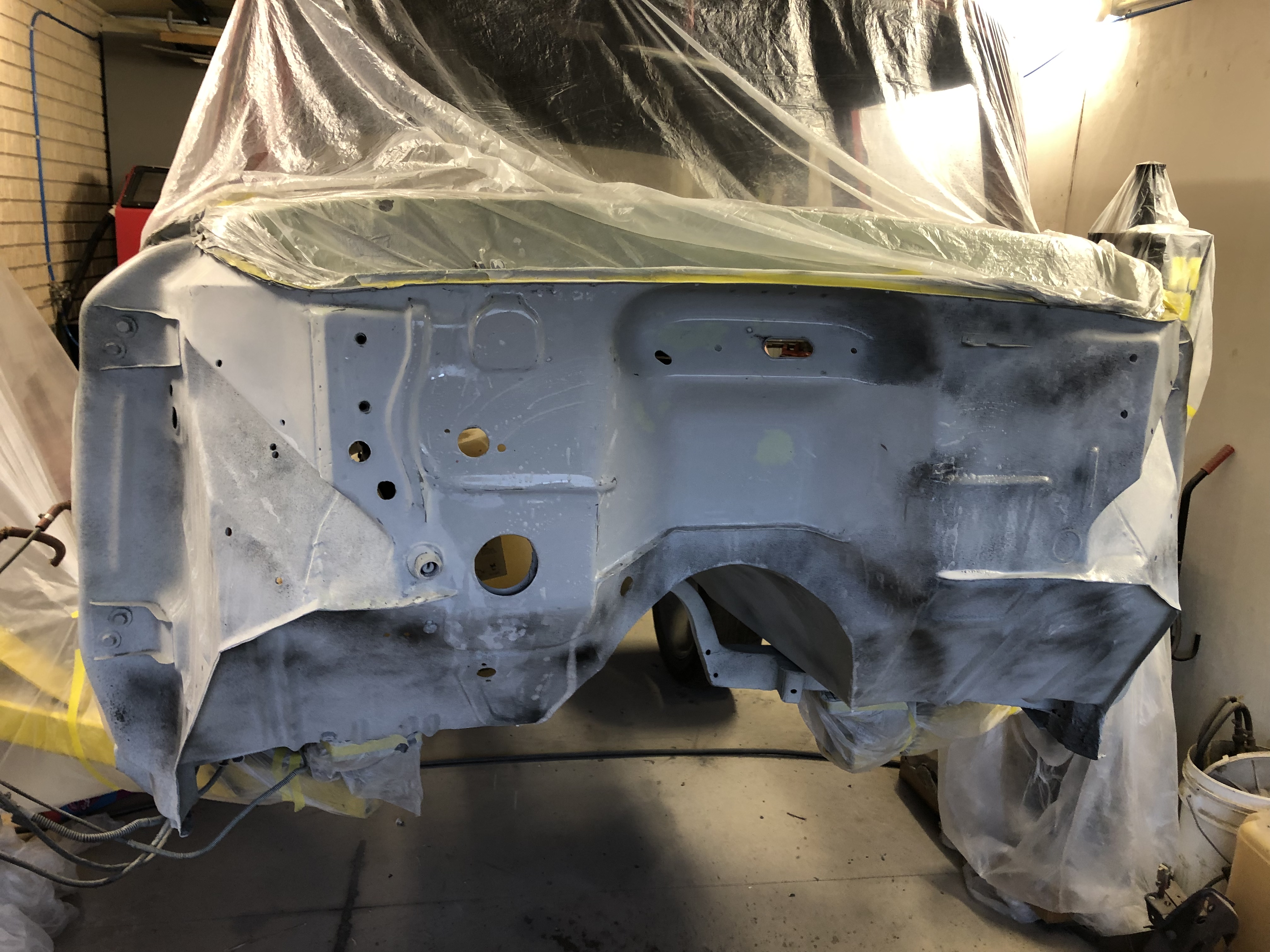

Re: Dave’s EK supercharged v6
Guide coat and some wet sanding has begun

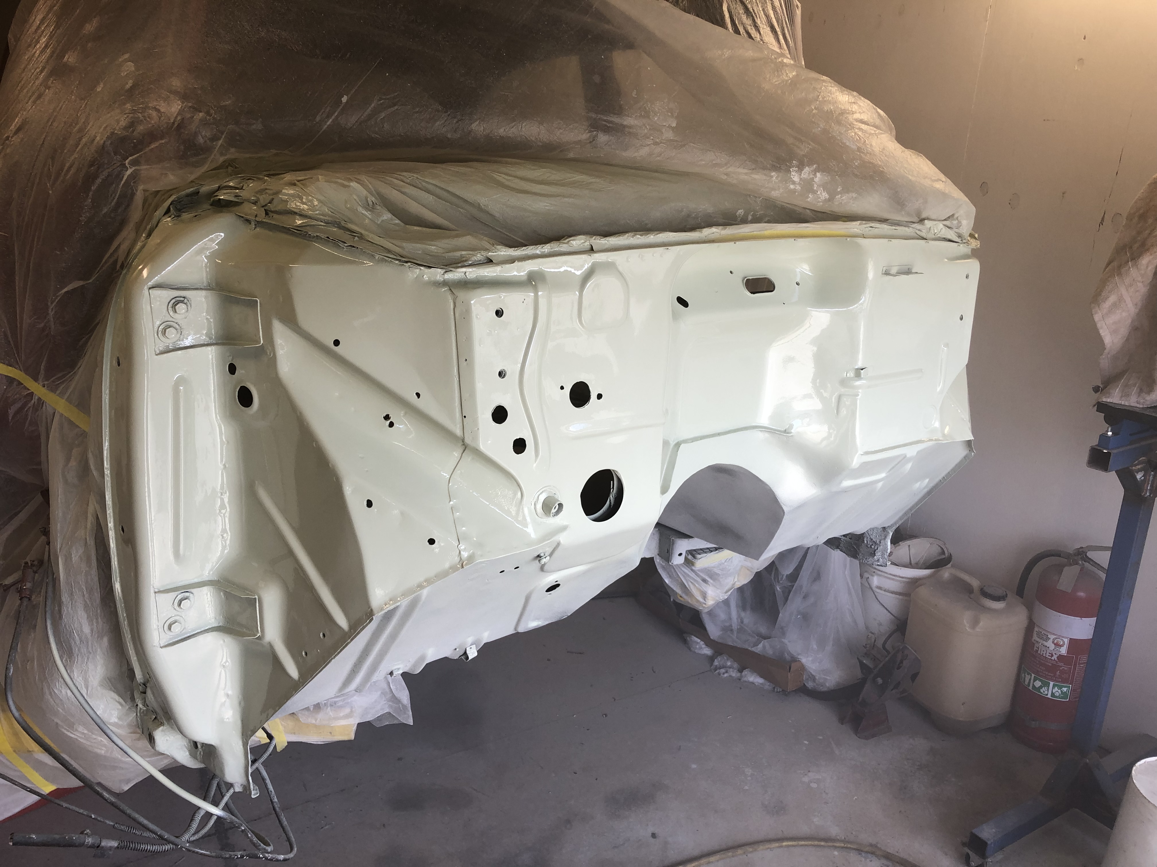

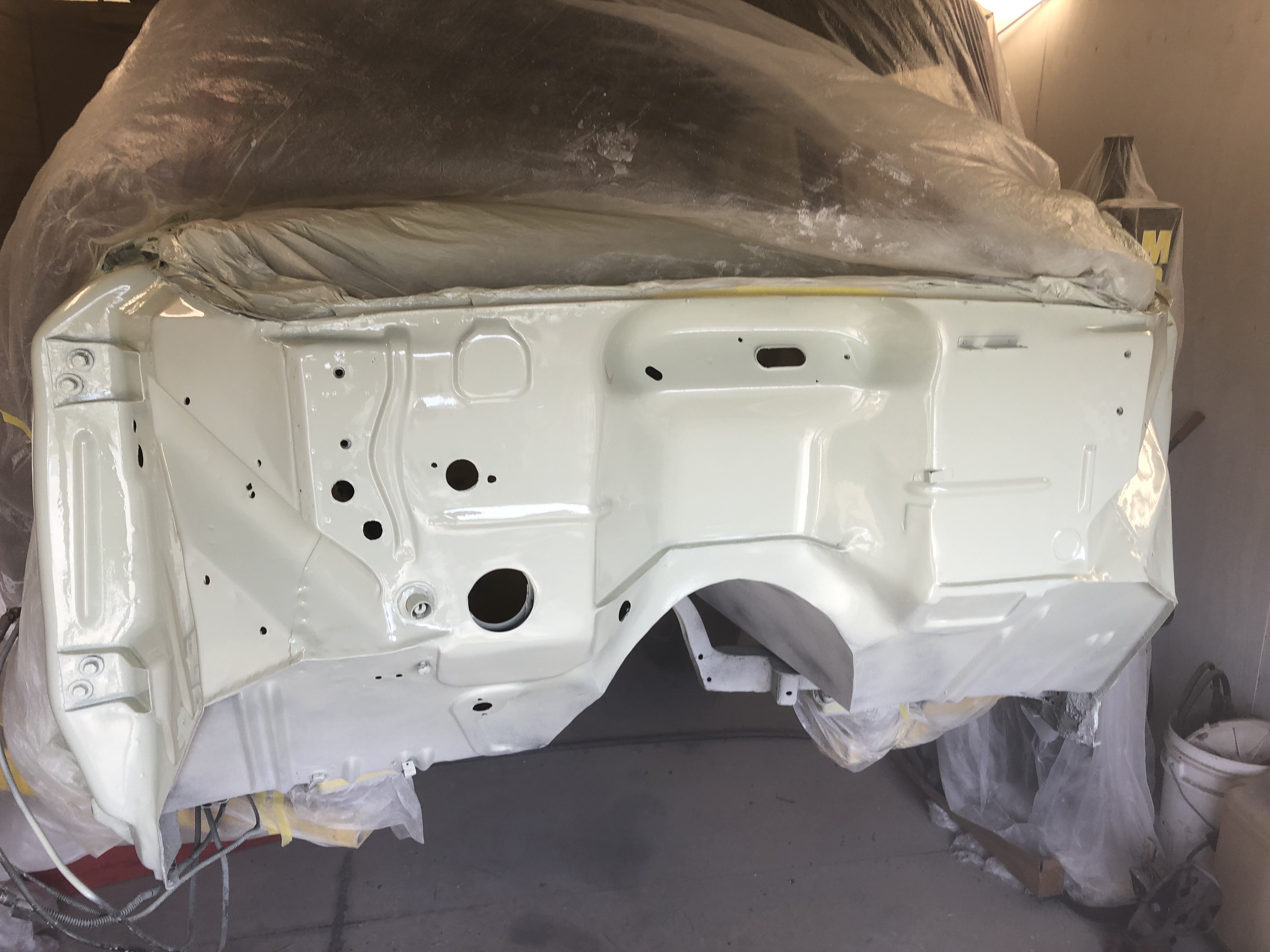

Rubbed through some spots so re epoxied it . Light scuff and ready to paint
