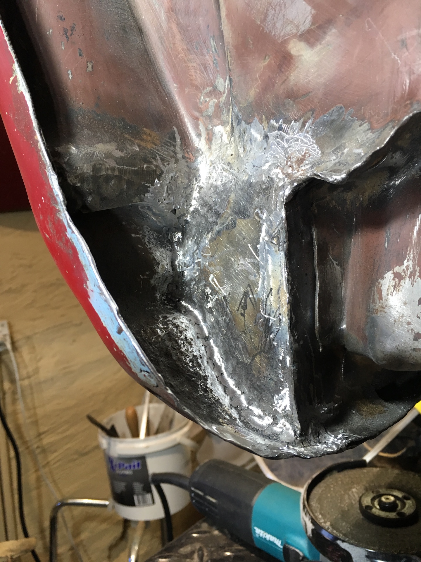

Found a bit of rust passenger side sill in the rear wheel arch. Previously repaired. Cut/ground out the old patch

Made up a template with a bit of aluminum. Decided to have a crack at mig welding. Figured no one will ever see this.

After a couple rounds of weld/ grind with gasless 8mm wire. Couple of blow throughs in both the sill and my patch. Not easy working in this space and getting the MIG torch in all the right places.

A few more rounds of weld/grind (after stepping away for a week). Dremmel has been my friend in here.

Finally hit it with some primer. Will leave for now and tackle the other side.

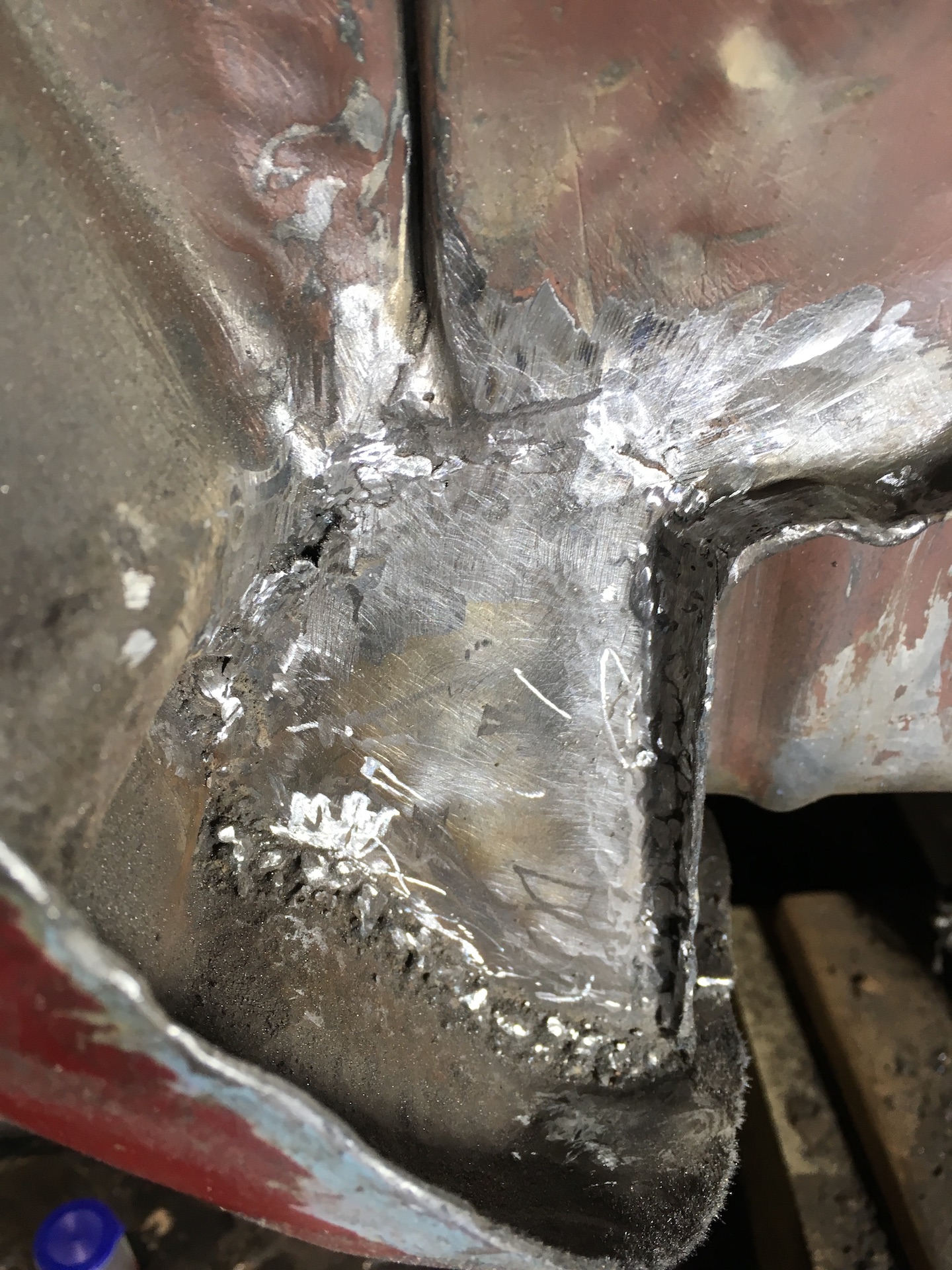

Okay. So not as simple as the passenger side. Noticed a few bubbles in the sill but when I attacked it with my sharpened screw driver it pretty much fell apart. Went to work with the angle grinder to check the inner sill. Looked ok under the car.

Very tidy. Yes it is a tricky spot. Do yourself a favour and get some gas.

Not so great. Lots of little pin holes. Sigh. Did some reading and the outer sill ‘seems’ relatively simple to repair.

The paint was all that was holding the shape. Usually passenger side is worse.

Then I got to the A pillar. Both inner and outer A pillar sections need work, as well as the subframe bracket. There is also a bit of rust in the floor around the A pillar that has been badly patch over.

It is a big job but the replacement panels help. Inner can possibly be saved? Patch from the inside and paint and protect well.
