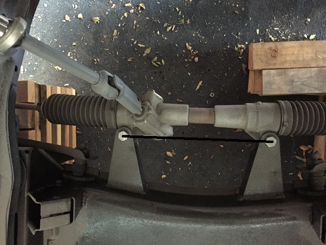

Firstly I did not measure the rack before shortening but a quick measure this morning show it is 925 mm from thread tie rod to threaded tie rod.
The distance from bolt hole to bolt hole is 285 mm

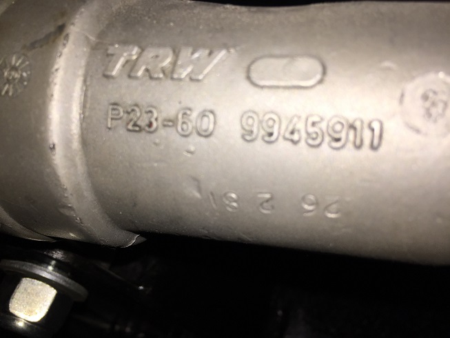

I do remember being told to get the correct rack, part number ending in ***** 911

The mount were supplied by Rod Tech and although they appear some distance from the cross member, the rack lines up with the steering arms.

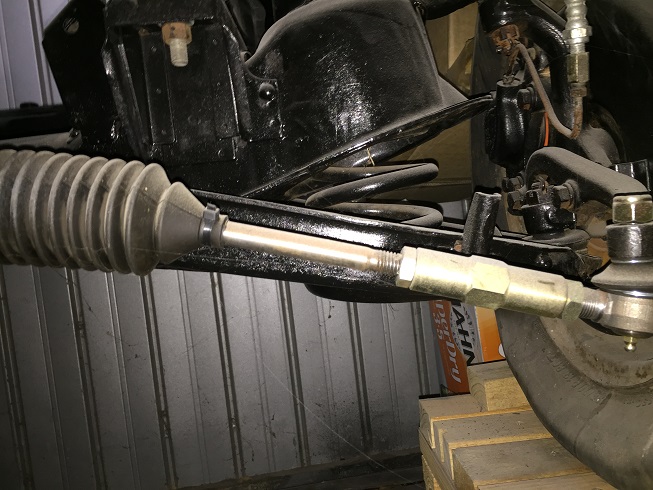

Steering 8.JPG (117.62 KiB) Viewed 895 times
Very important to maintain the same angle as the lower suspension arm.
steering 10.JPG (133.58 KiB) Viewed 895 times
The angle from the column was too great so I added the mounting.
I needed to position the column, not play with the length or collapsible area and have it so Anne-Marie and I can drive comfortably.
First uni joint is basically just inside the firewall so not sure I could have done it differently.
Trust me, if I did not need the mounting support I would not have used it but It does eliminate the binding.
