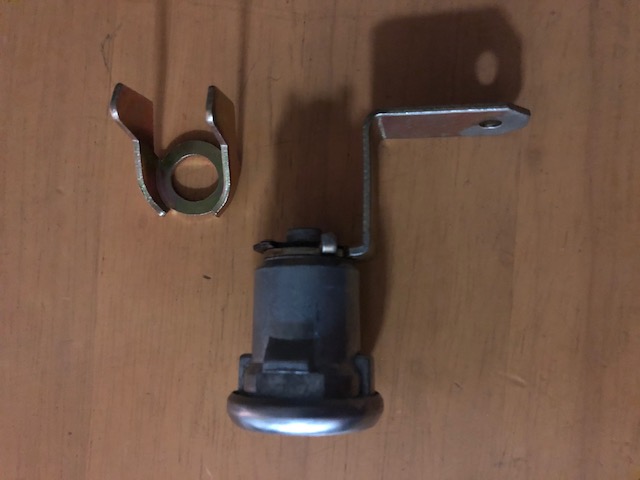

Dumb HR question for today. I am keen to put a drivers door lock in. The MasterParts says that most early Holdens have the same door locks, but that HD/HR are different. Rares sells the door locks as common for nearly every pre-Commodore Holden. The Rares kits have two "end tangs" that are interchangeable - the two legged version like FB/EK (to the left in the photo below), and a bent flatbar version (shown to the right fitted to a door lock):
Rares door lock.JPG (46.1 KiB) Viewed 12217 times
I'm guessing that the two-legged version is for pre-HR, and that the bent flatbar version is for post-HR? The MasterParts reckons that the sliding lock-retaining plate is different for HR too.
Can I take an FB/EK door lock, use the FB/EK retaining plate, and make up a bent flatbar "end tang"? That way I don't need to buy a new Rares door lock, and only have to get one of my spare FB/EK ones recut to suit the other door.

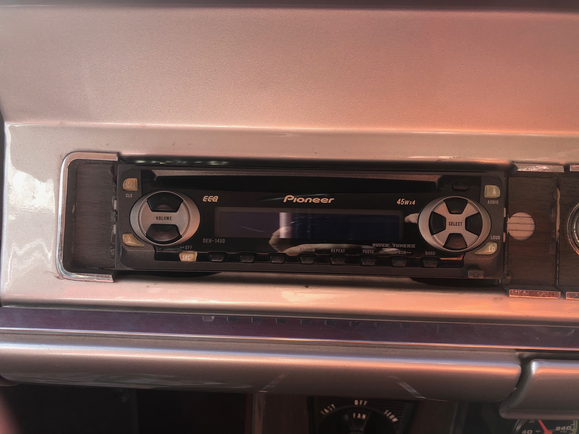

Errol62 wrote: Sat Feb 15, 2020 8:42 amLook forward to seeing some piccies of the radio and fascia Harv
Only have a photo of the existing one for now:
It makes my soul hurt every time I get in the car. Will take some photos once the new one is in place. Need to keep my eye out for a roll of woodgrained Contact self-adhesive book covering to cover the new insert.
