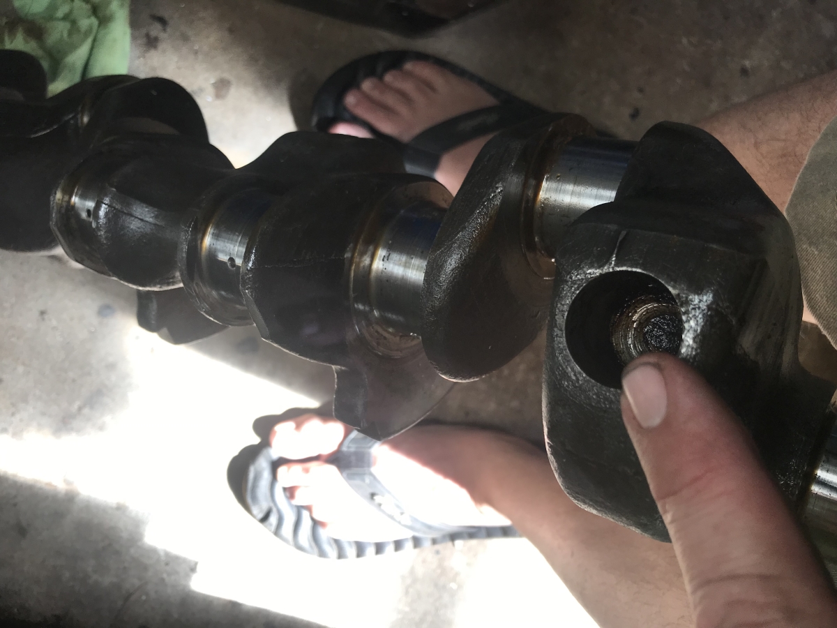

Pulled the EJ block out, and stripped it down. Motor looked pretty good - 30-thou over, fairly clean bores. It had been stored under cover before I bought it, then the seller left it in the rain for a while (perhaps a fortnight). I had drained some water from the sump years ago and topped it up with oil. Some pitting on the inside of the oil pan, but mechanicals all above the tide mark and OK. One sump bolt boss had snapped off and was in the bottom of the pan - someone has tried to put a long bolt in instead of the short sump screws. No major drama, though the thread will want some sealant to keep the oil in now that it is not a blind hole. Some very large holes in the crank - presume they are balancing holes, though can't remember them being this large in the last crank I pulled out.

Posted: Mon Apr 08, 2019 11:57 am
Not sure if this is normal, a reco job, or a lightened crank (?).
Holes in the face and edge of the counterweight - holes are 1" diameter and 1.25" deep (rough):
Optimized-Counterweight end.JPG (528.59 KiB) Viewed 1320 times
Optimized-Counterweight face.JPG (654.51 KiB) Viewed 1320 times

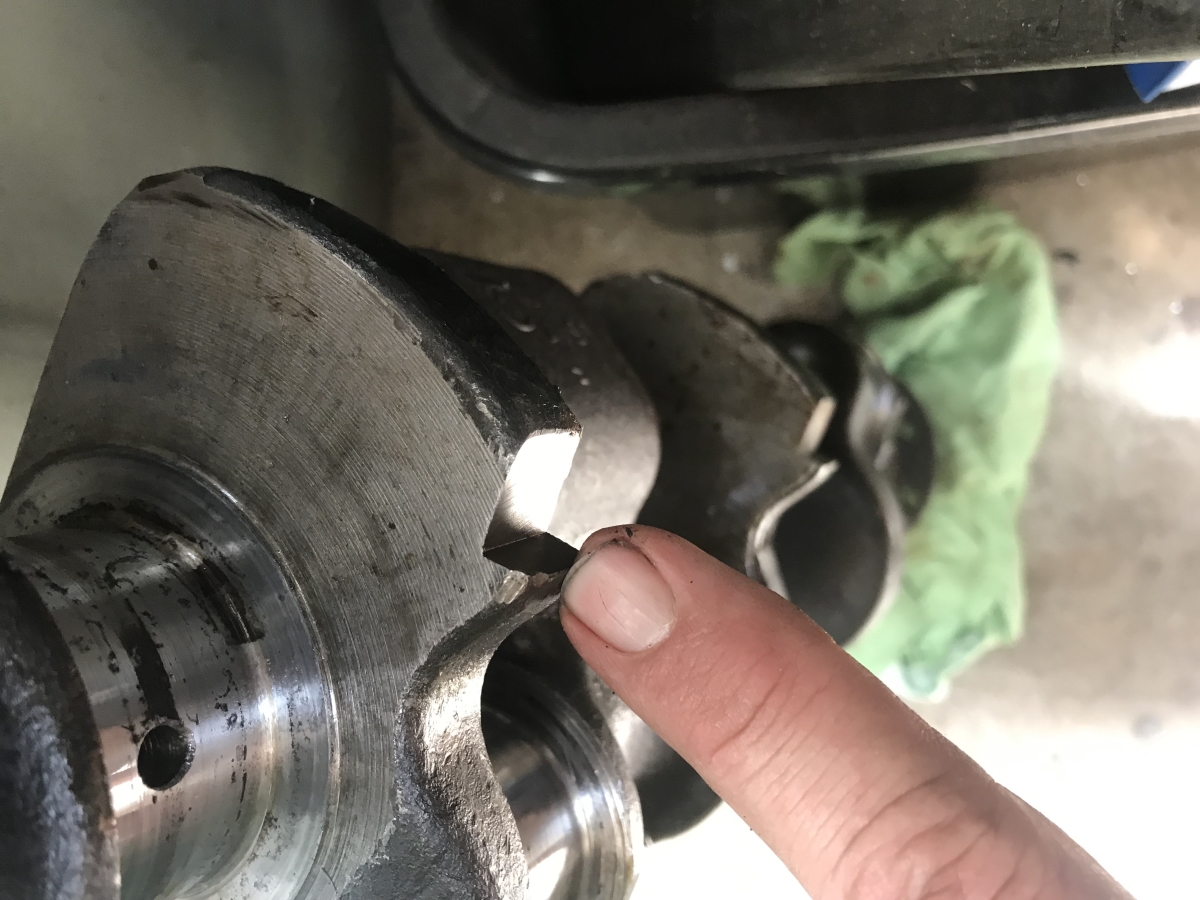

Notched throws:
Optimized-Notched throw.JPG (597.62 KiB) Viewed 1320 times

Posted: Mon Apr 08, 2019 12:47 pm
by FireKraka
Not sure about the notched throws Harv but the holes do look like balance holes but yes look pretty big from the photo.

by ardiesse
Harv,
I reckon the notches are index marks to define "zero degrees" when the crank was being machined in the factory. They seem to line up with nos. 1 and 6 crankpins.
