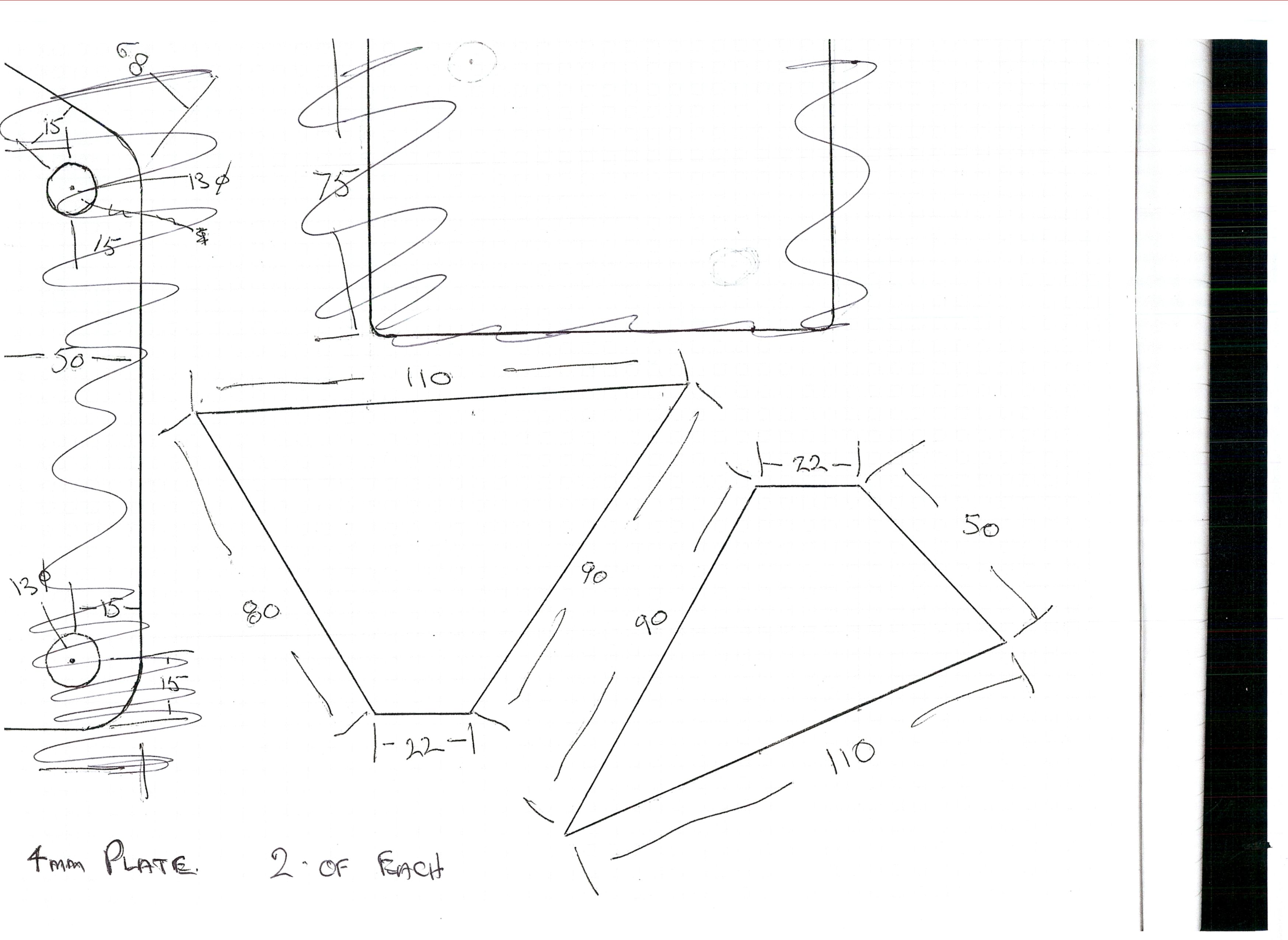

by FireKraka
Just chop the old mounts off Clay and buy a new set from Pete Mallaby on Ebay, he made them off the drawings I sent him a few years ago.
Always better to dummy fit I think, just my two sense.
Re: HD/HR disc front end - re-conditioning.
Posted: Thu Aug 14, 2025 8:10 pm
That’s funny, I saw Pete claiming he drew and coded the mounts himself on Facebook the other day. Easier than trying to explain to the masses.

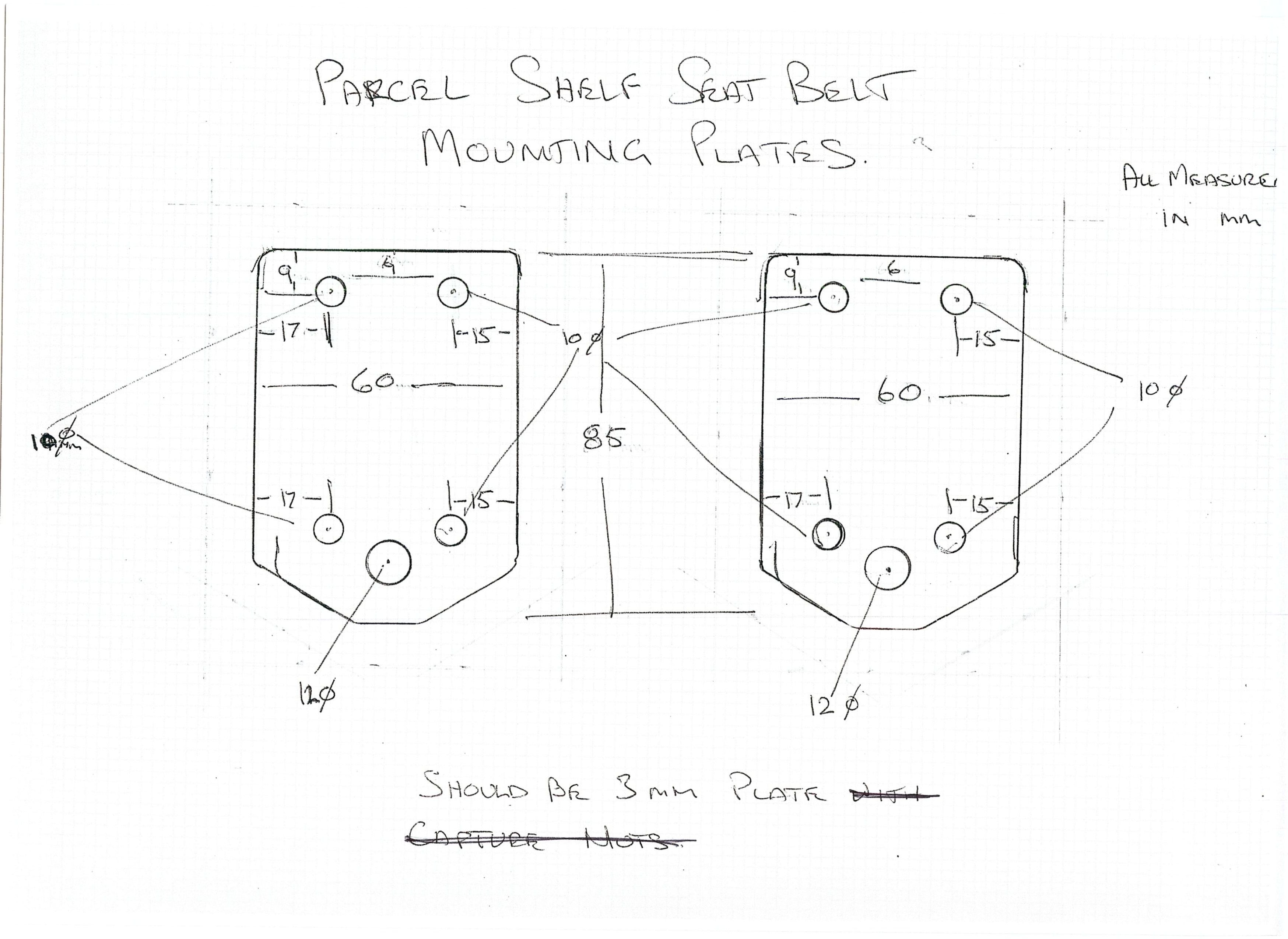

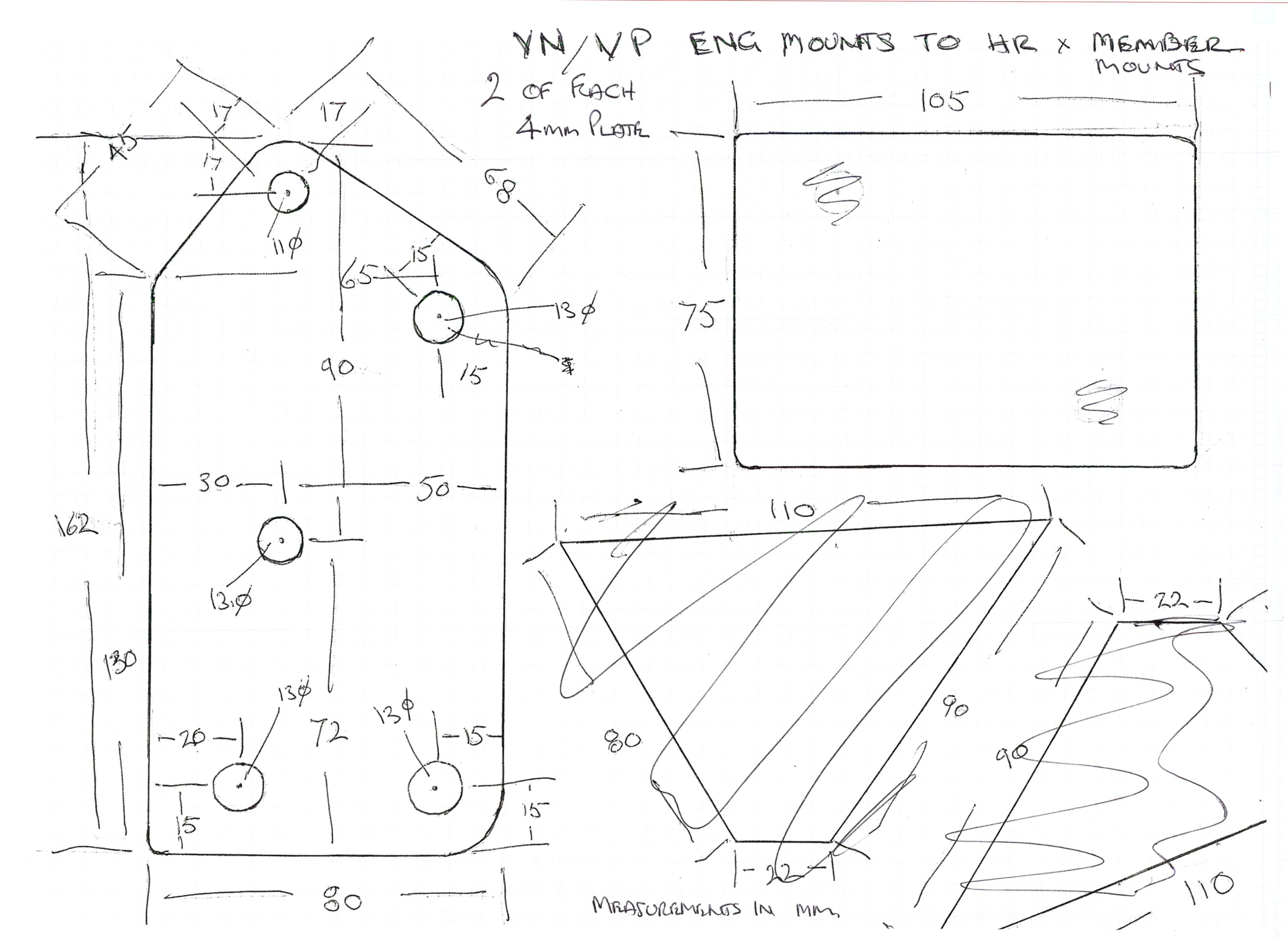

My original drawings that were sent to Pete feel free to use them guys
Bracket Drawings_0001.jpg (428.54 KiB) Viewed 8089 times
Bracket Drawings_0002.jpg (374.79 KiB) Viewed 8089 times
Bracket Drawings_0003.jpg (309.12 KiB) Viewed 8089 times
Posted: Fri Aug 15, 2025 11:57 am
If you can convert that to a DXF file I can have them laser cut Neil :thumbsup: :thumbsup:
Posted: Fri Aug 15, 2025 12:42 pm
by FireKraka
I'll see what I can do Blacky have an acquaintance that is pretty handy with CAD the drawing of the mount unfolded needs to be cleaned up a bit.
These were the other drawings I sent, these were for the engine side mounts for my V6 in to the Ute which I welded up and used, this time for the wagon I have bought CRS.

Not trying to be a smart arse just showing not all you read is true :wave:
Posted: Fri Aug 15, 2025 1:01 pm
Those drawings are excellent, though I did think you might have done them in CAD. Only a select few of us are privy to your genius mate. Never mind all those poor mugs that try and get by on Facebook.
Posted: Fri Aug 15, 2025 1:49 pm
by FireKraka
Never used CAD mate (the actual program that is) unless you mean cardboard :lol: :lol:
I'll clean them up and get them into CAD by a friend
