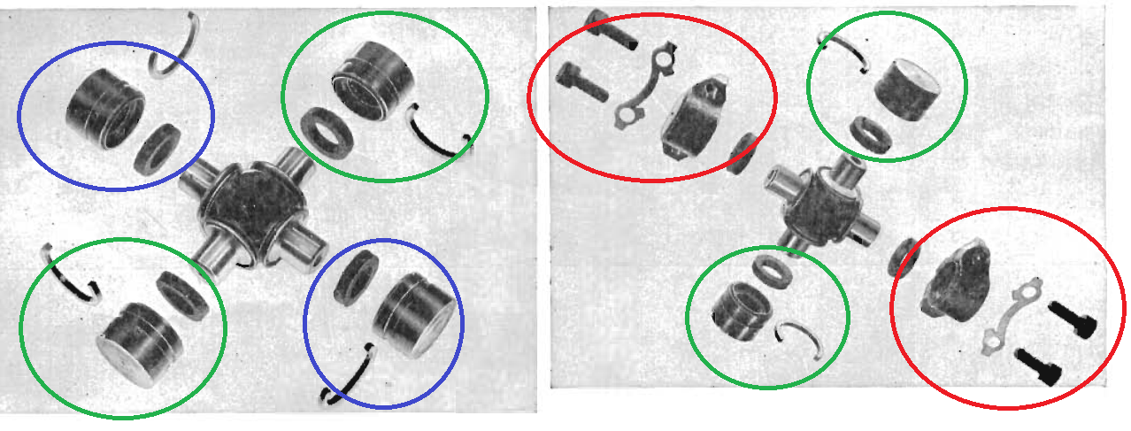

From the discussion above, I learned that to swap in a later banjo centre to a grey motor diff housing you had to use a "red motor" rear universal. I didn't really understand why until doing it myself.
The image to the right below shows a grey motor rear uni, whilst the image to the left is for a red motor. The green-circled bits fit into the tailshaft, and are pretty much identical so the red motor uni slips readily into the FB/EK tailshaft.
red versus grey rear universal.png (606.59 KiB) Viewed 11020 times

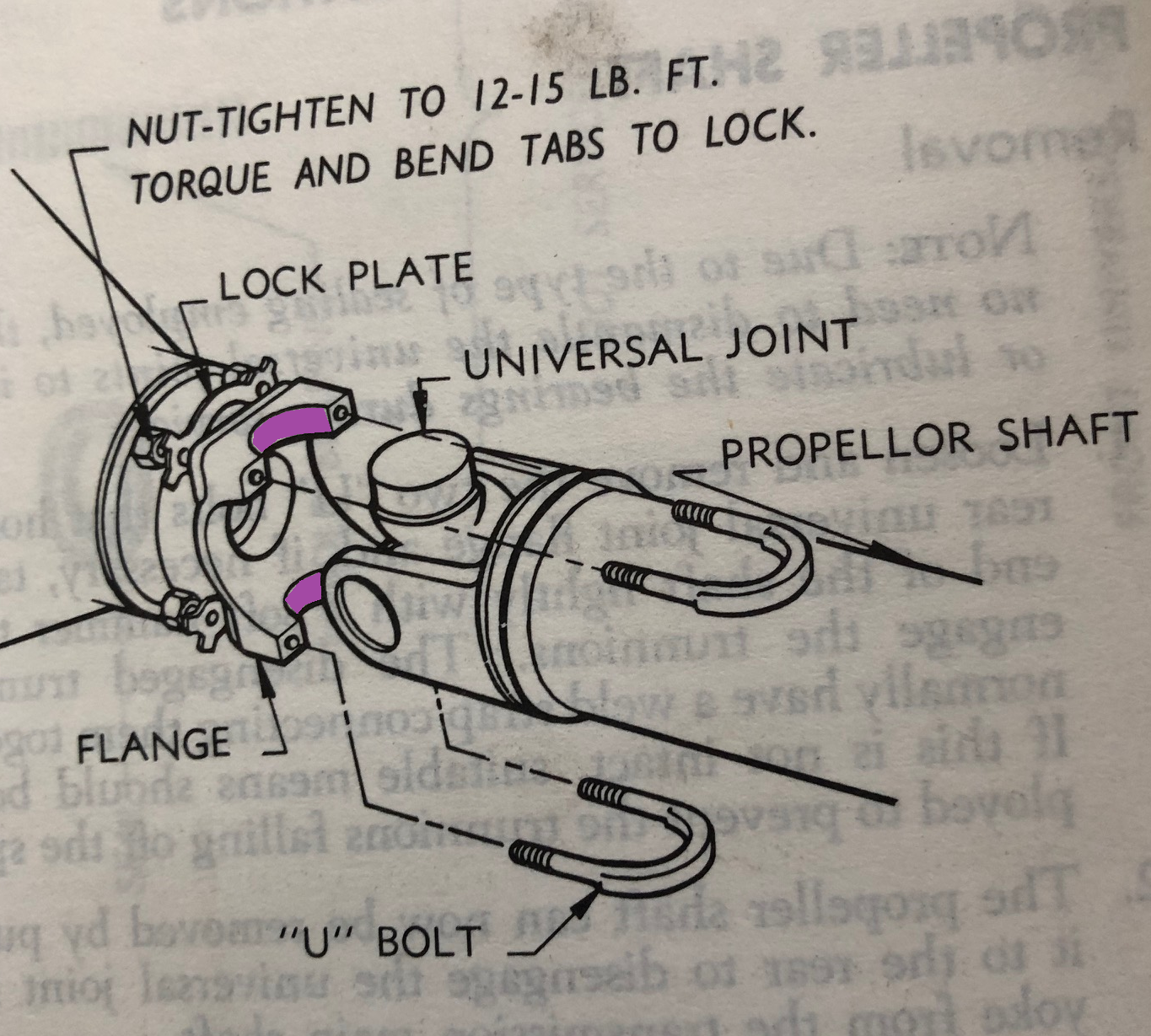

The trick is in the part of the universal that connects to the diff centre. The grey motor part is circled above in red, and is a bearing cap that bolts to the diff centre. The bearing cap has a lug that locates on the centre, and helps to take some of the torque load (along with the four mounting bolts). The red motor diff centres do not have the machined slot for the lug. Instead, they are machined round to take round red motor universal caps, as shown circled in blue above. The round slots are shown in purple in the diagram below, which shows how the red motor universals are mounted using u-bolts instead of the grey motor bolt on caps.
red motor rear universal joint.png (1.91 MiB) Viewed 11020 times
From some rough measuring, the u-bolts are 3/32" wider than the old grey motor universal bolts.
So if you try to use the grey uni, the lug will not take up load (so bolts may snap) and the bolts may not line up well (so the grey uni bearing caps would sit cockeyed).
