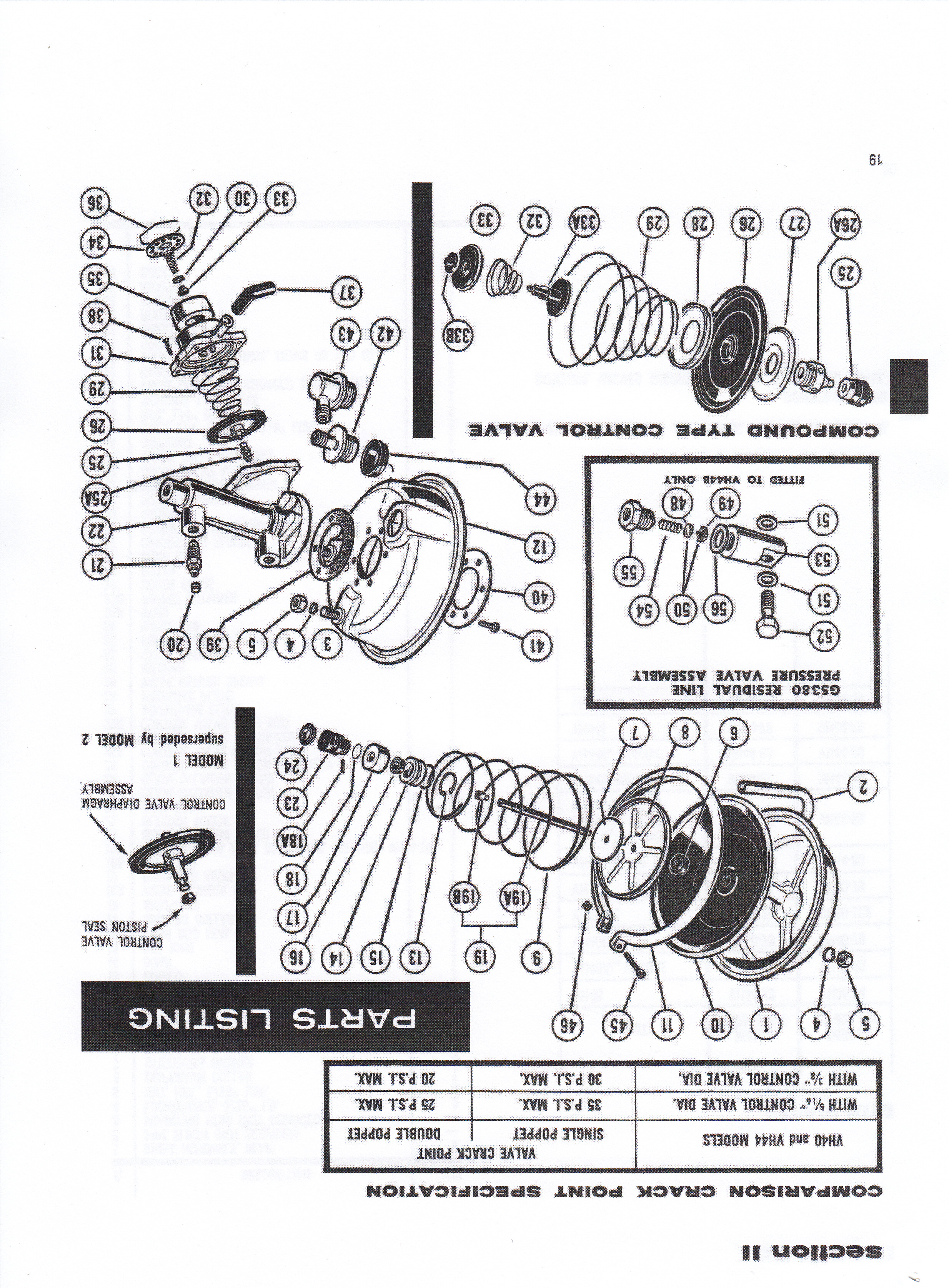

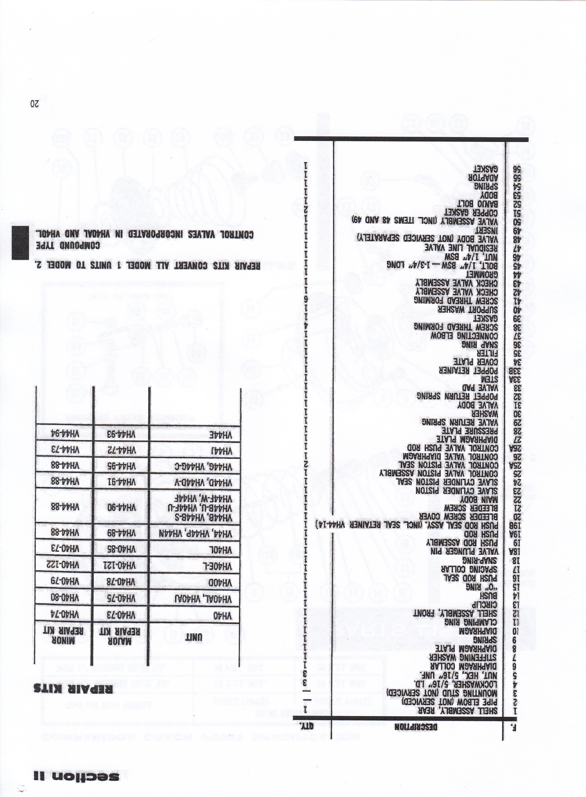

I ended up swaying out some bits from the VH44 I recently took off. Power Brskes seem to have given me to number 25 5/16" cups, instead of a 25 and a 25A............
Posted: Fri Apr 19, 2024 8:09 pm
A thousand words:
VH44 Service Manual page 20.jpg (3.29 MiB) Viewed 3364 times
VH44 Service Manual page 19.jpg (4 MiB) Viewed 3364 times

Thanks Harv. 40 and 44 are identical in the control valve construction.
