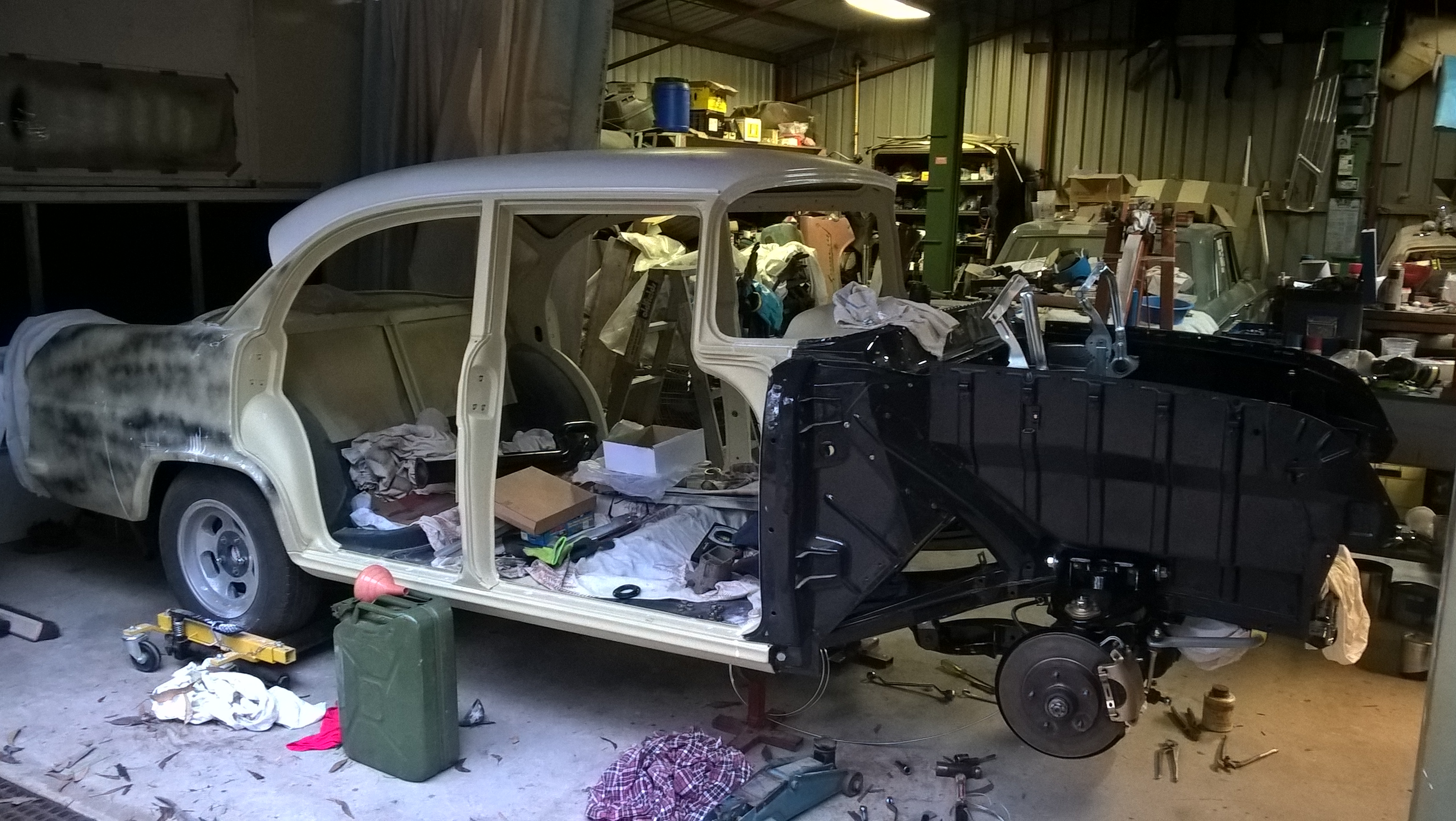

So I have not posted for a while because the winter just gives me the craps.
The car has also given me the shits especially the front end, It was all finished and I dropped in on the ground to have a look at ride heights etc.
What I noticed was a lack of castor which I didn't even think about until now. I have come to the realisation that the front chassis rail of the EK is level with the ground but a Torana is not, it actually rises from the back to the front in the engine bay area, giving the front end natural castor. ARGHHHHHHHHHH !
So I hunted down another cross member and started again, this time I have created the same castor as the Torana. I am now using UC upper control arms, ball joints set back and Harrop steering arms. Nothing like doing the job twice !
The attachment WP_20180908_17_24_34_Pro.jpg is no longer available
Also started the brake lines and will be doing the fuel as well then engine in hopefully !!

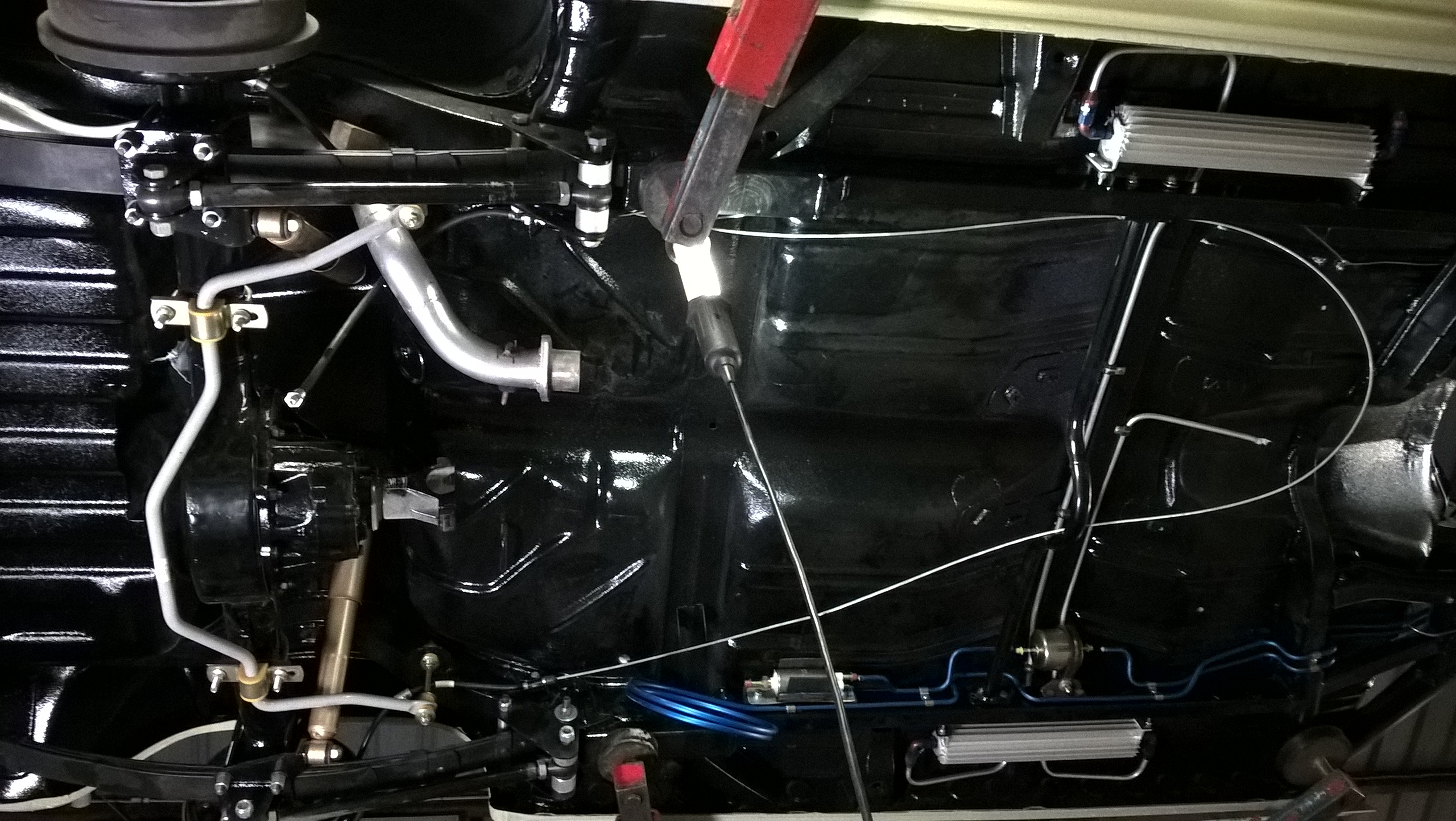

Brake lines in and todays effort will be the fuel lines.
Still waiting on some extended top ball joints to fix the torrie front geometry real good :D :D
So maybe Sunday part E (bottom left) will be go into part C (Top middle) if not it will be very soon :shock: :shock: :shock:

So as usual ran out of time so no engine in !
Made up most of my fuel lines and couldn't find my grommet box so I had to stop. I will run the remainder through the floor then into the boot space.
Getting busy underneath and running out of room !!!! Cant believe the dust that collects even underneath.

Amazing work Greg! Can’t believe you had do the front end again... good persistence.
Cheers, Joe

Nice work Greg did you use a straightener the lines look very tidy
