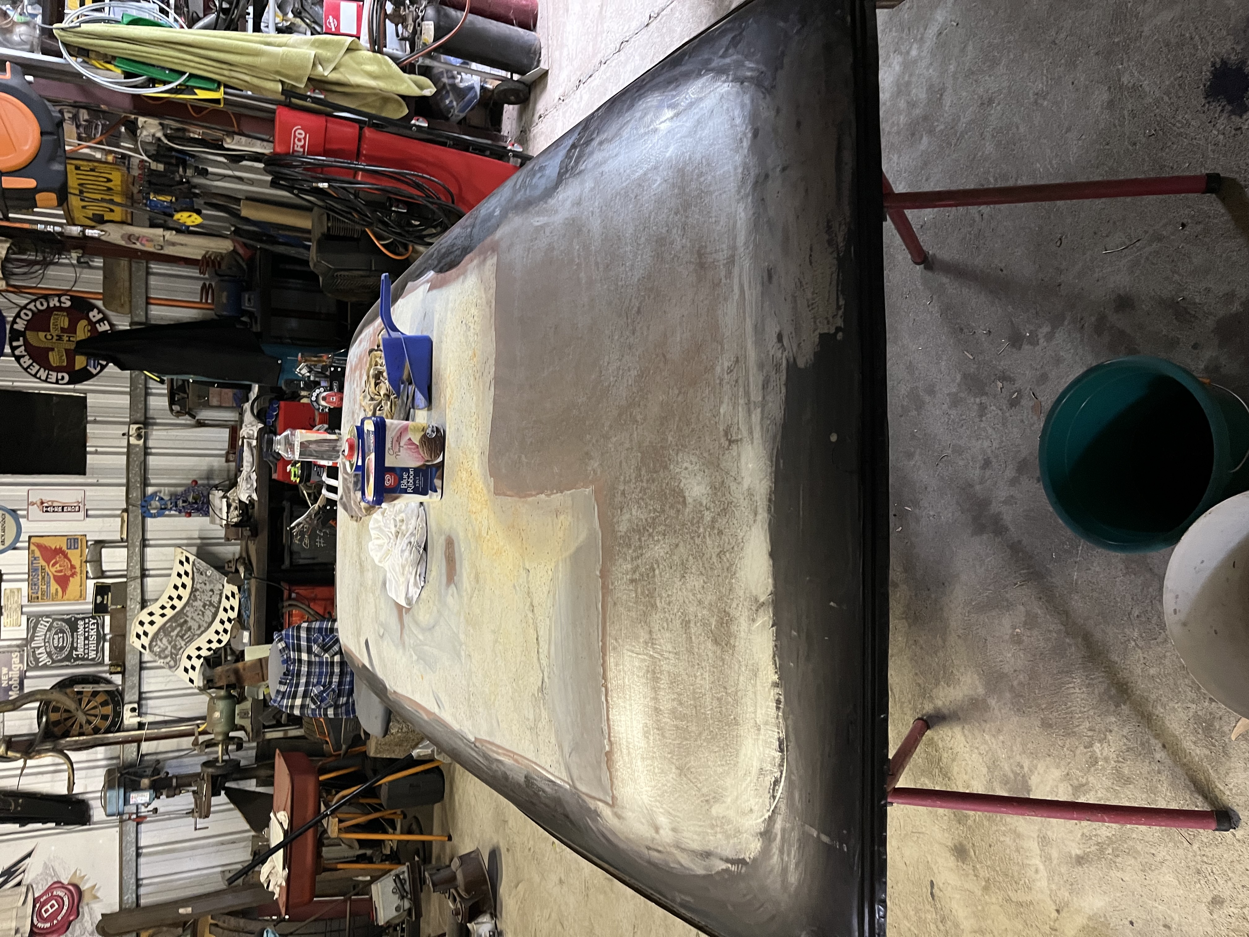

So I've found out that Keith is a perfectionist :roll: :roll:
I am too impatient and just want the roof on the wagon but Keith wont let it anywhere near it until it is prepared properly so yesterday he came and we cleaned up the sides etc. so now we have moved the roof into my workshop so that I can strip the rest of the roof with paint stripper then I have to turn it over and clean the underside kill rust.

Most older tradesman are perfectionists, Neil it will be worthwhile because it wont rust again in a hurry.
Your wagon roof supports will most likely need the same treatment, depending where and how you cut it off.

Started stripping the rest of the roof today, there’s a heavy coat of red oxide under the paint it’s a shit to move but getting there :roll:
Re: Neil's FB Station Wagon
Posted: Thu Mar 13, 2025 10:23 pm
I’m very familiar with that red etch prime from stripping my ute. Paint stripper didn’t seem to affect it, and it went through many strip discs.
Posted: Fri Mar 14, 2025 7:31 am
The modern red primers are largely zinc phosphate based. I suspect the early Holden ones may be lead oxide "red lead" based. Mebbe wear a mask, and don't lick your fingers.
