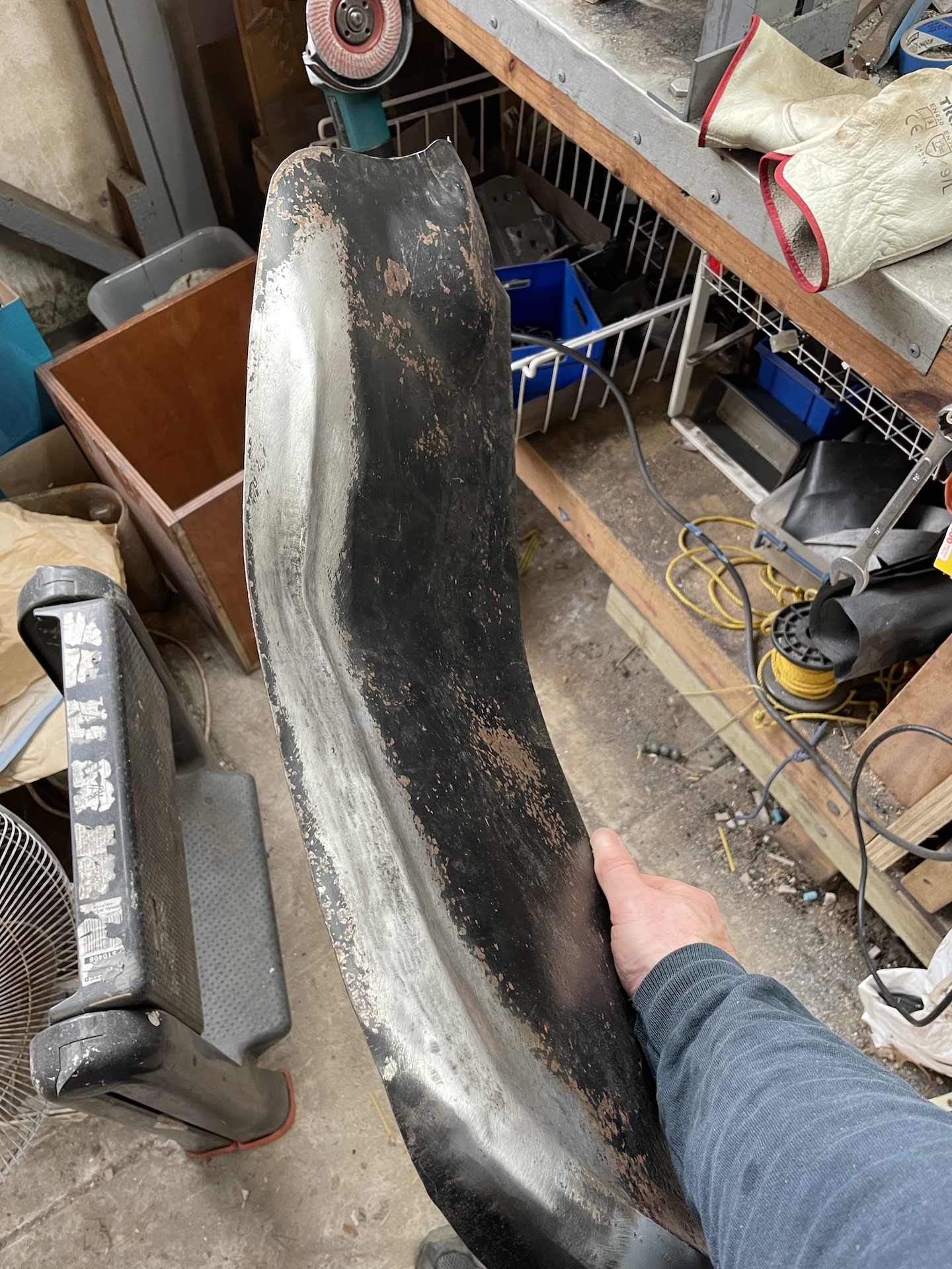

Finishing off the drivers side rear quarter - this one has less work needed than passenger side so should be easy. Well read on... and on.

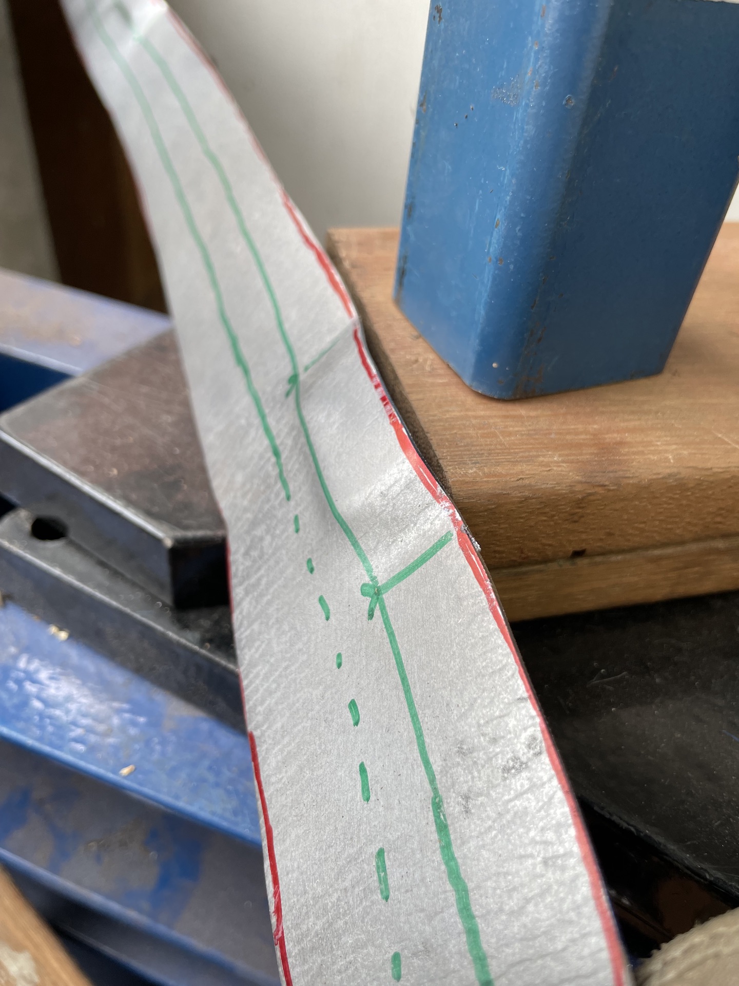

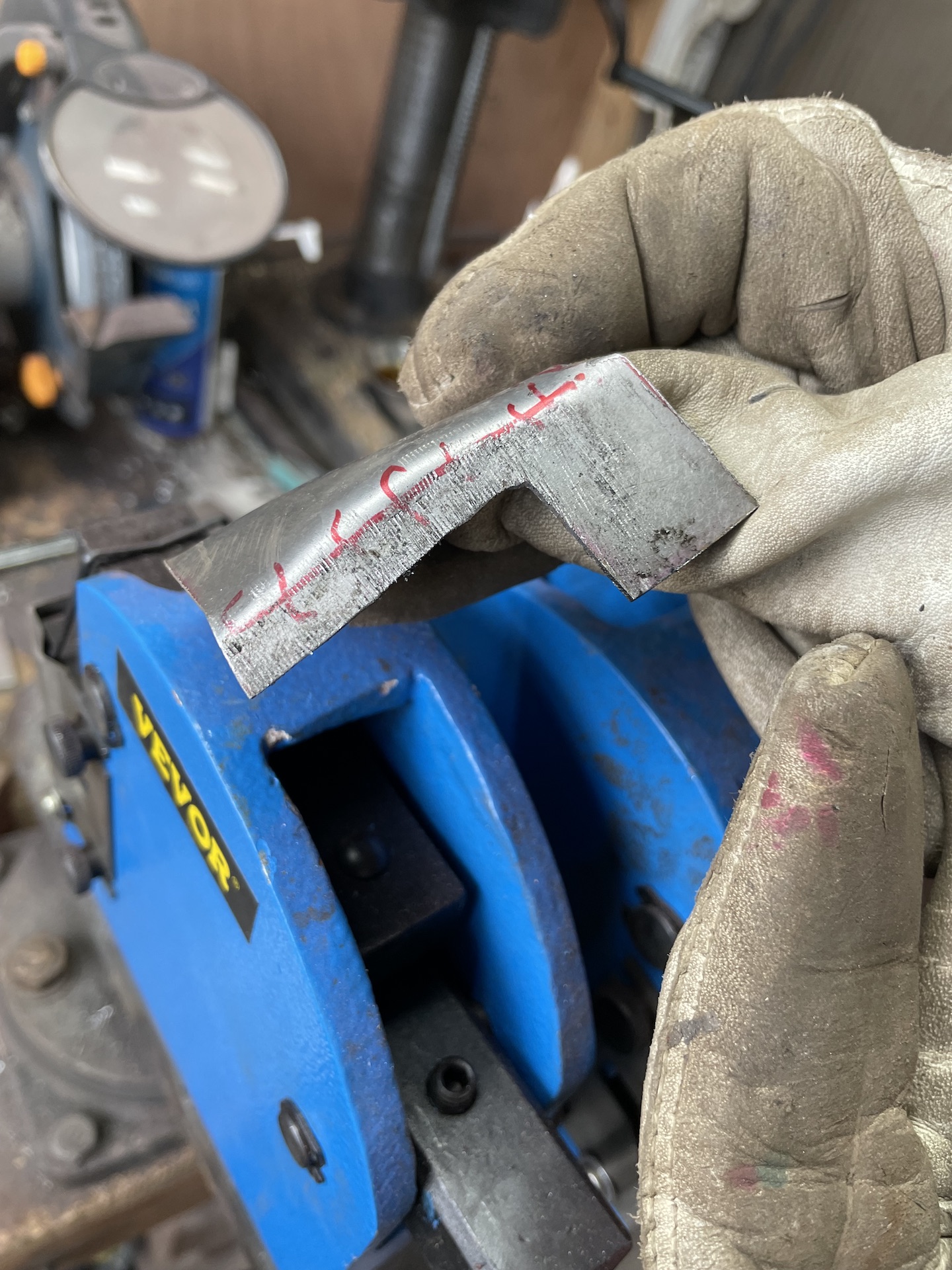

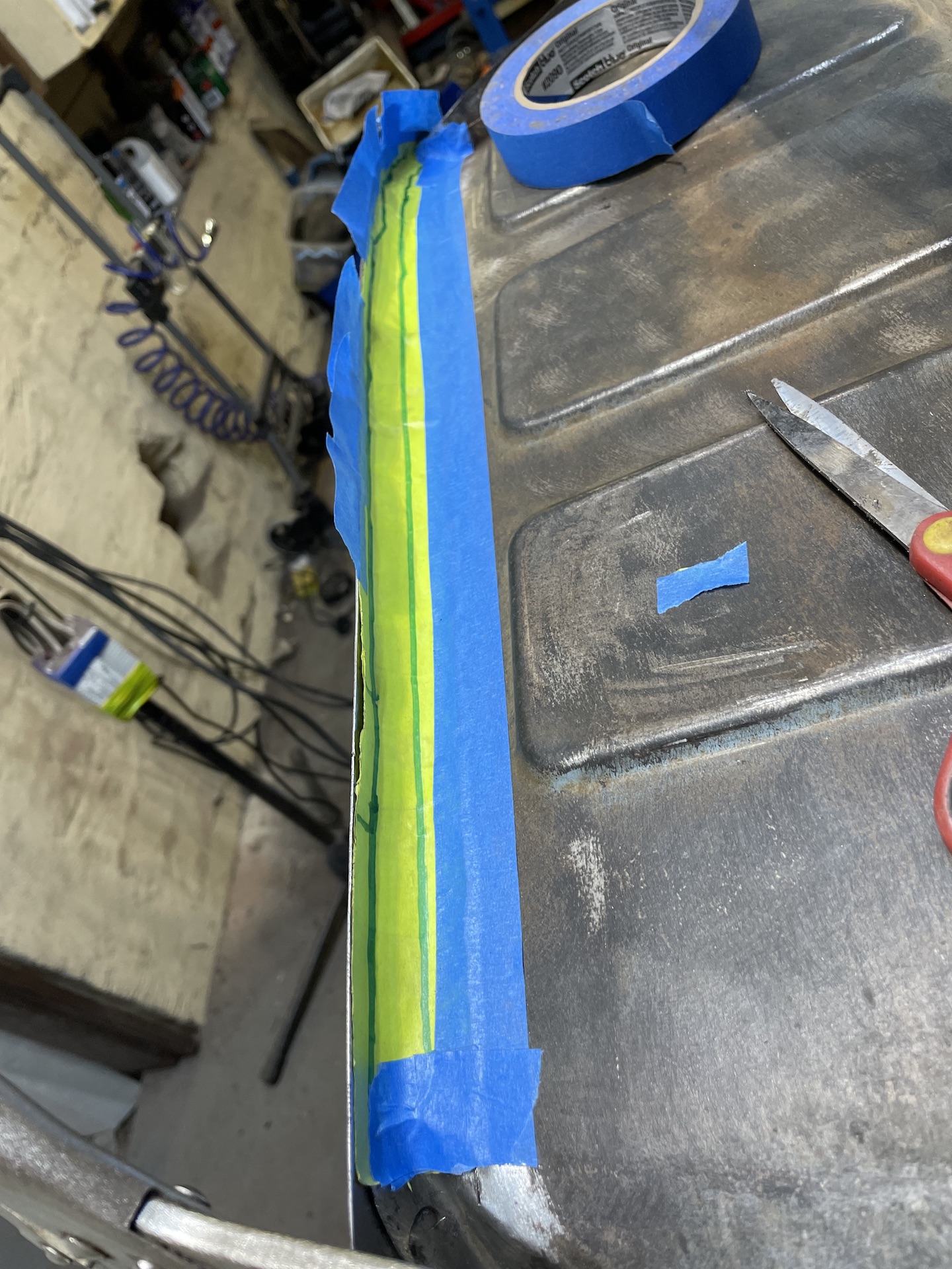

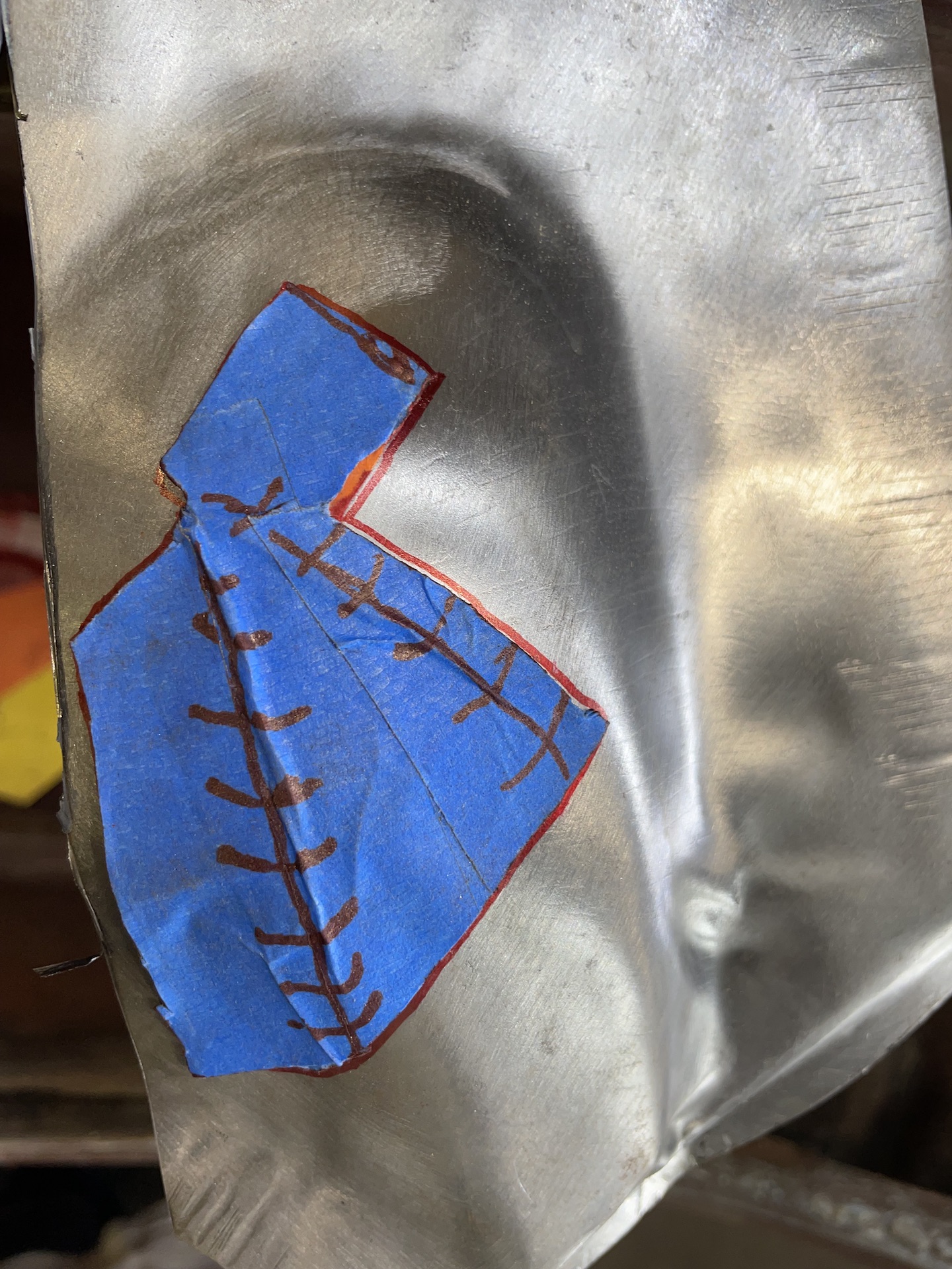

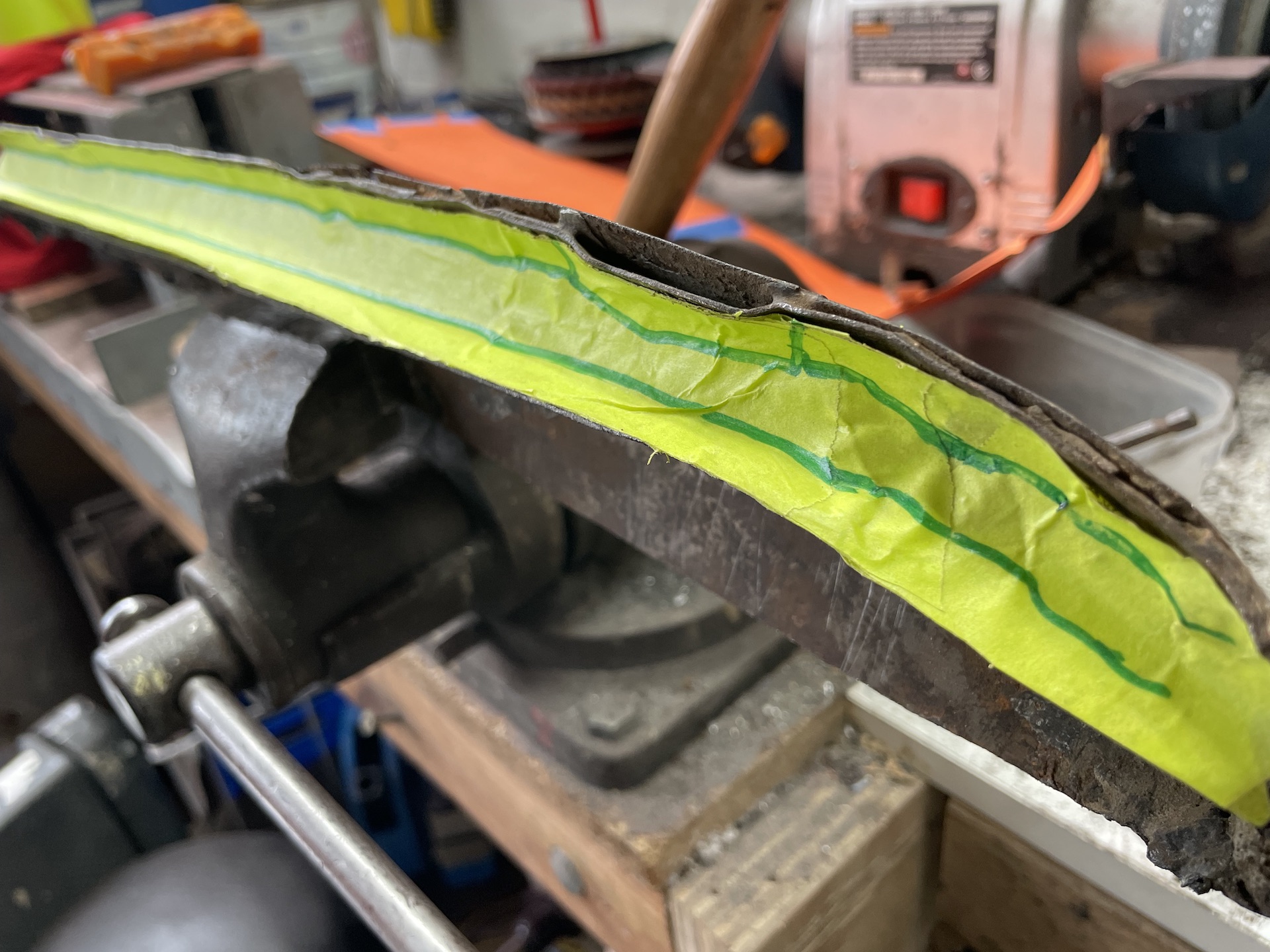

Same deal as other side - bit of rust bottom where the wheel arch joins the inner rear quarter. Instead of paper template, tried a different trick I learnt from YouTube. Masking tape template.
Transfer onto unused passenger repair panel bumper mount.
Cutaway tape to mark curves and its already looking like it was meant to be there.

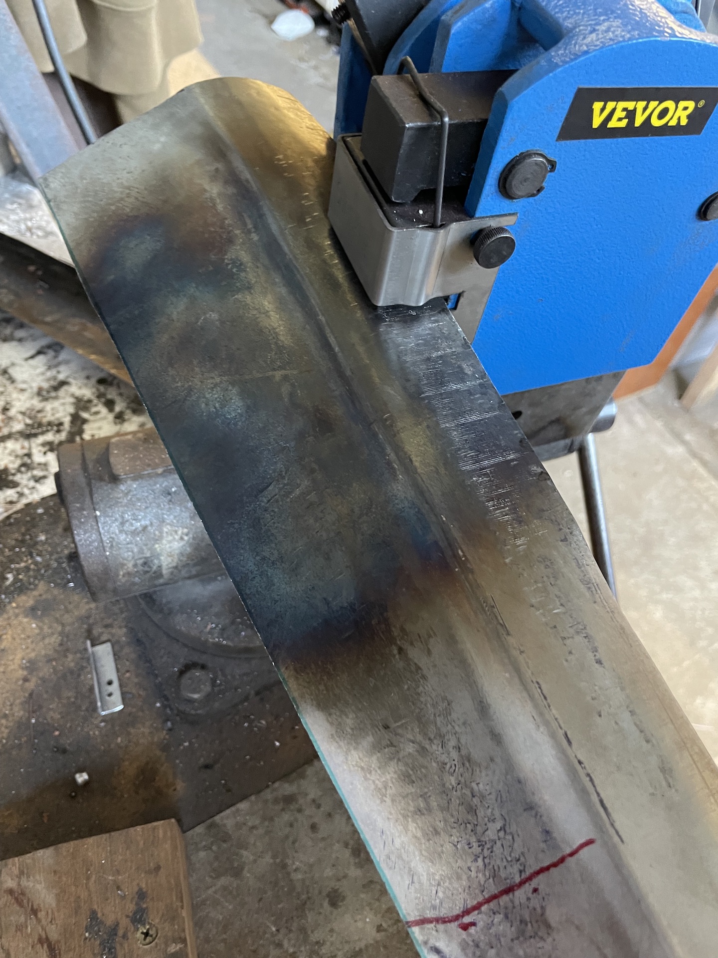

Build profile with shrinker.
Weld grind and done
Scott

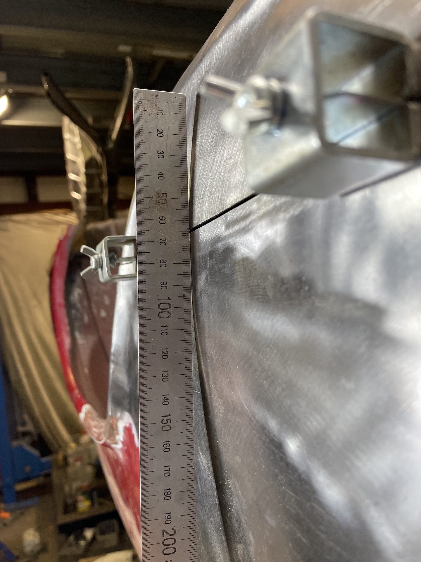

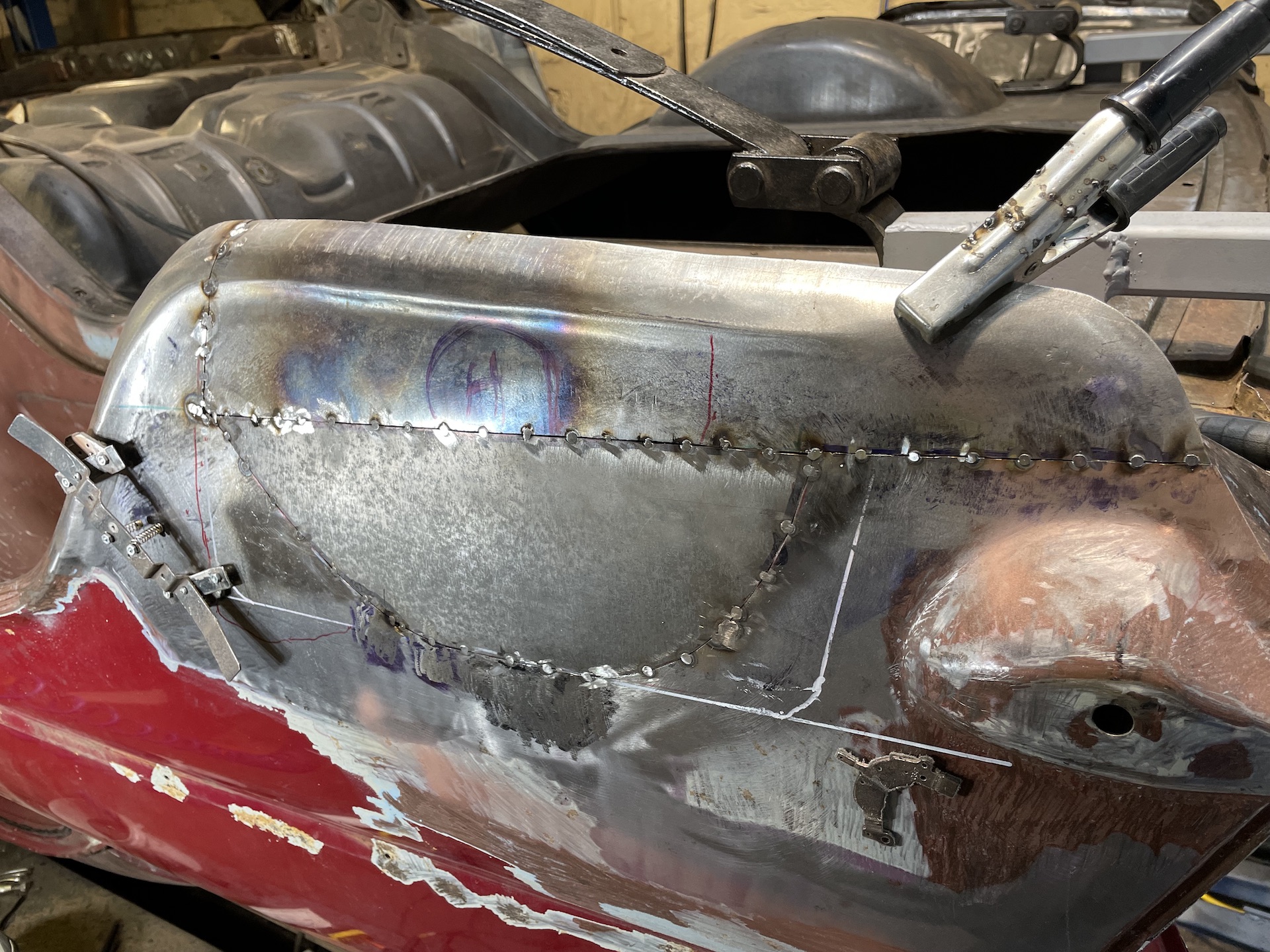

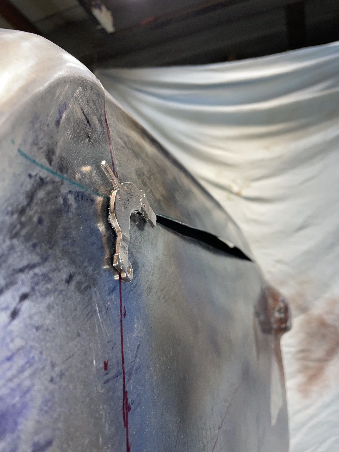

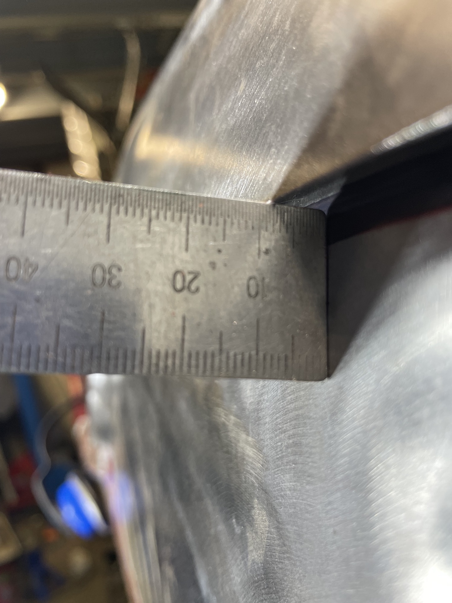

Scribe and cut new repair and test fit. Slight difference in profile in the middle. Well 8mm difference.

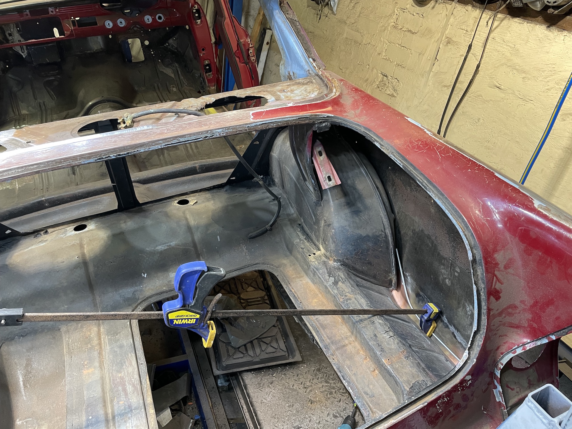

When I cut out the rusty section I took this pic - shows that the panel when relaxed wanted to pull in. Remember that now.
Also you may remember that the repair panel was bowing out slightly when I originally test fit it a few pages back. This was my first attempt to bend it in slightly with my knee. Took lots of wearing and hammering to get it back in shape after this. Remember this also.
Anyways, put clamps on and it all pulled up fine and basically lined up

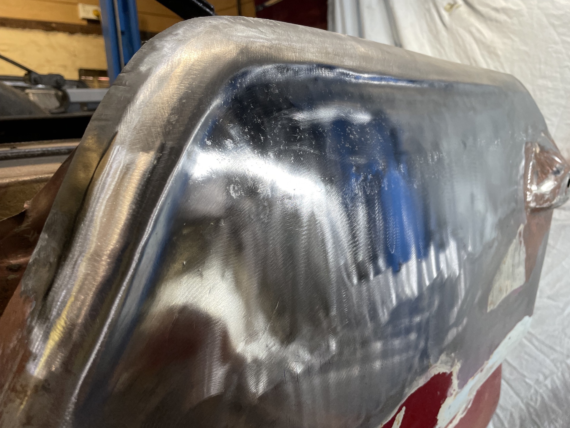

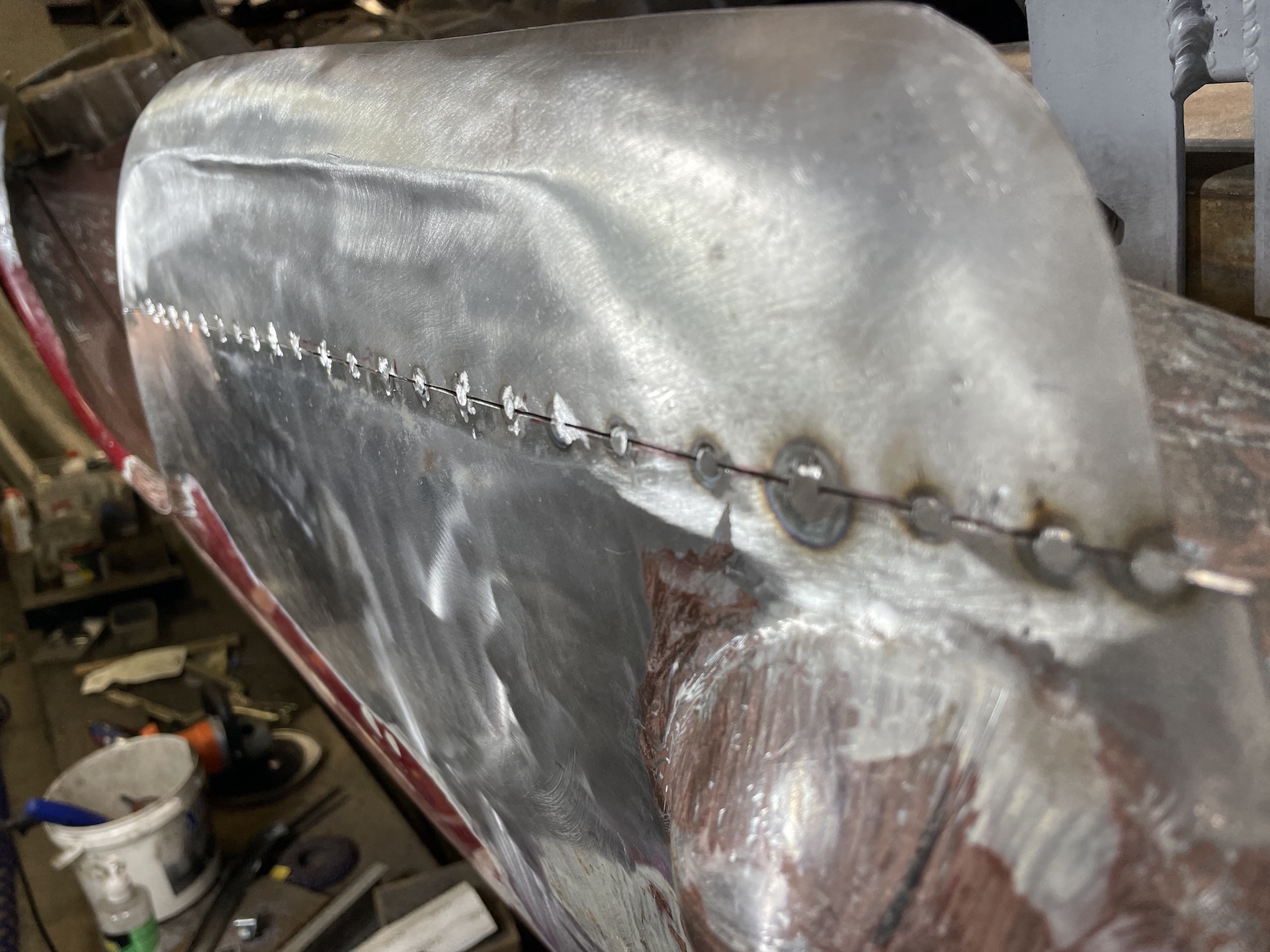

Tack/Cool/Tack/Cool/Hammer etc the dress down so I can weld without too much extra build up
Grinding etc and looks pretty good.

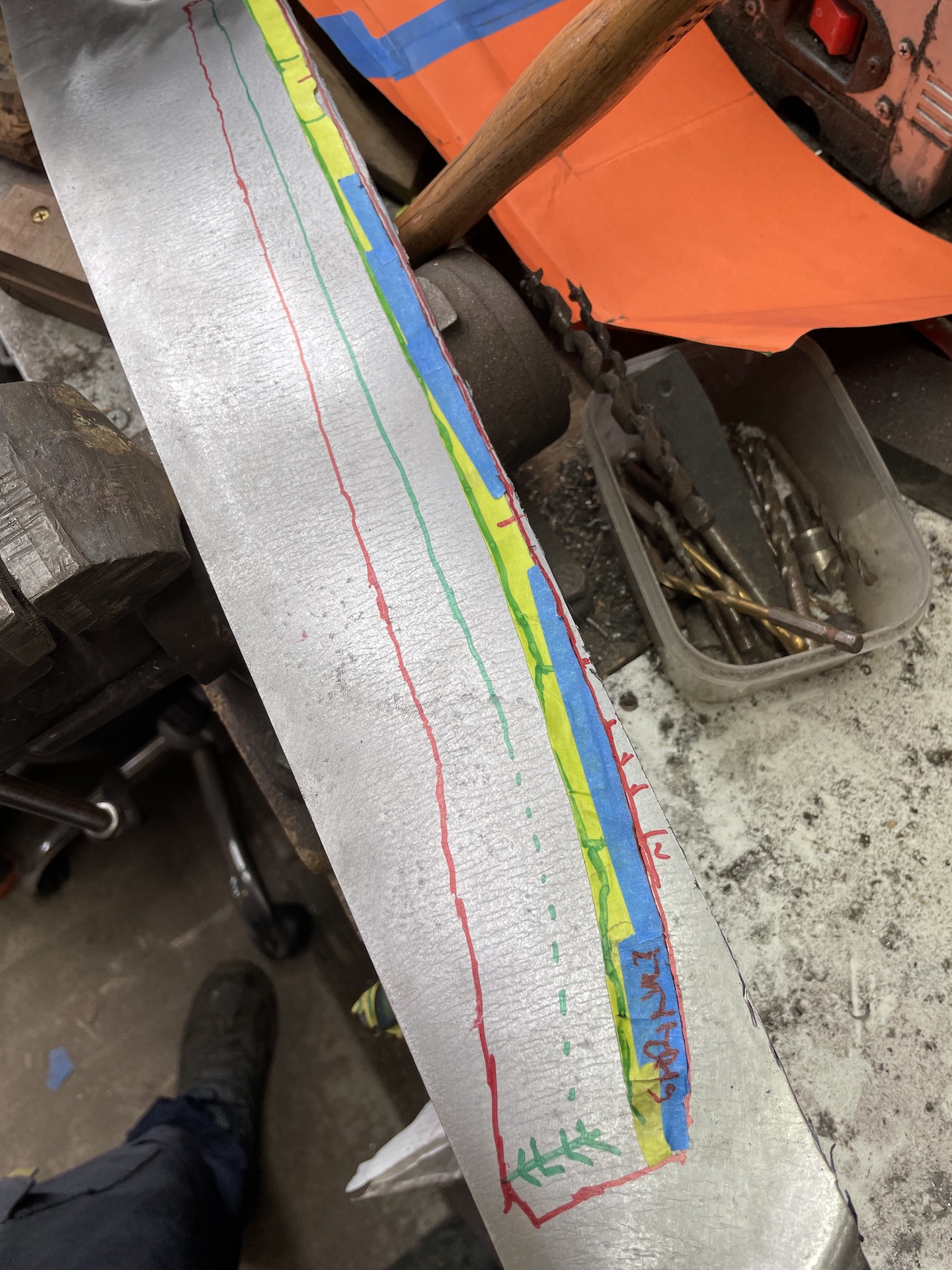

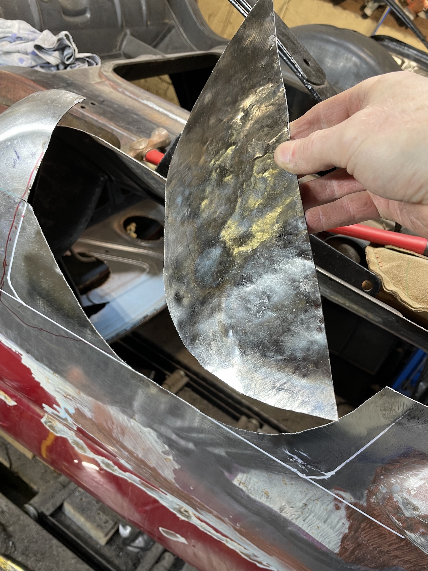

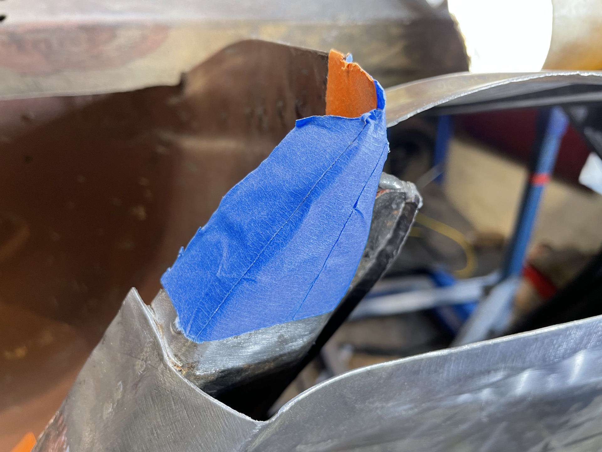

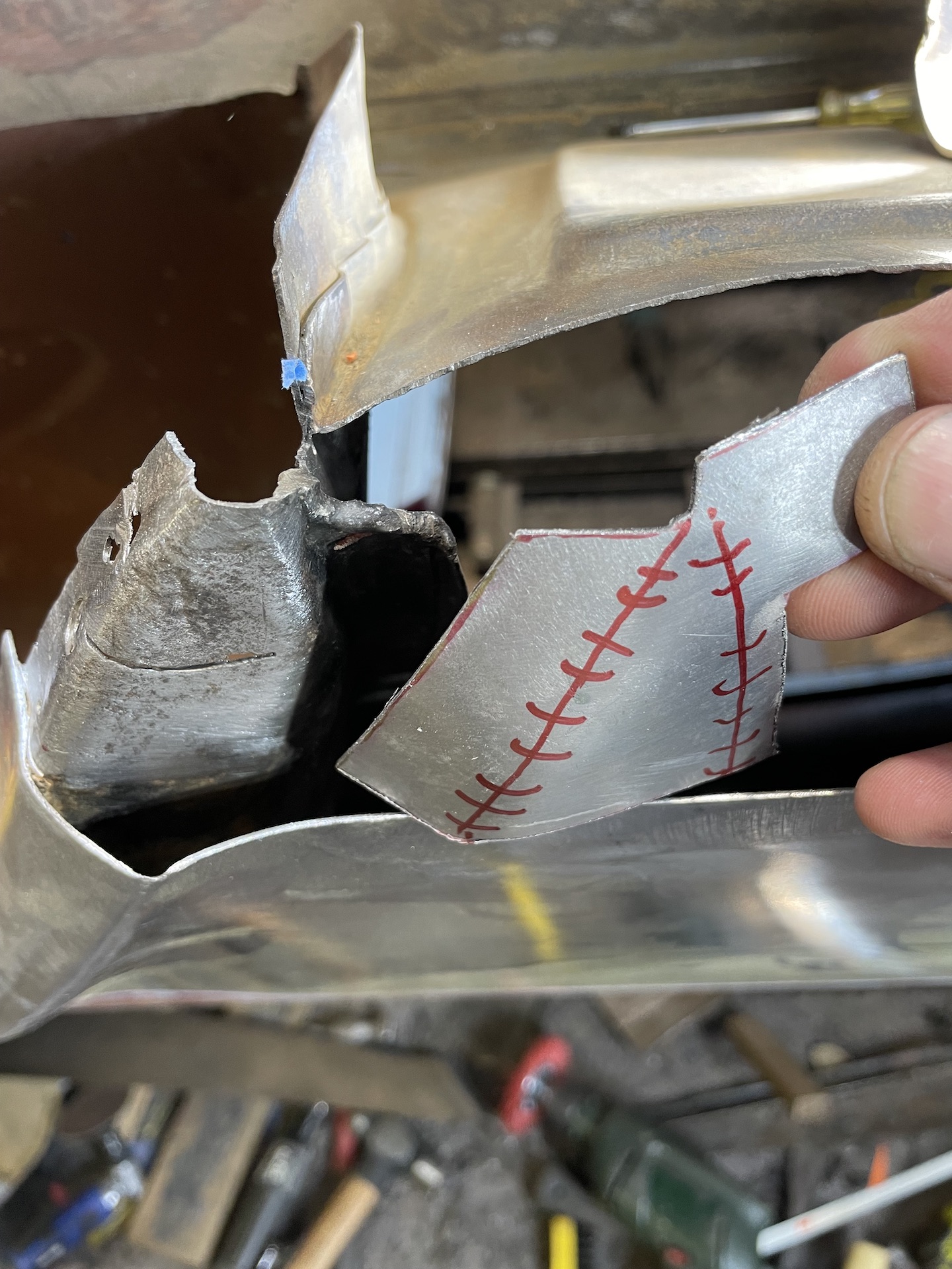

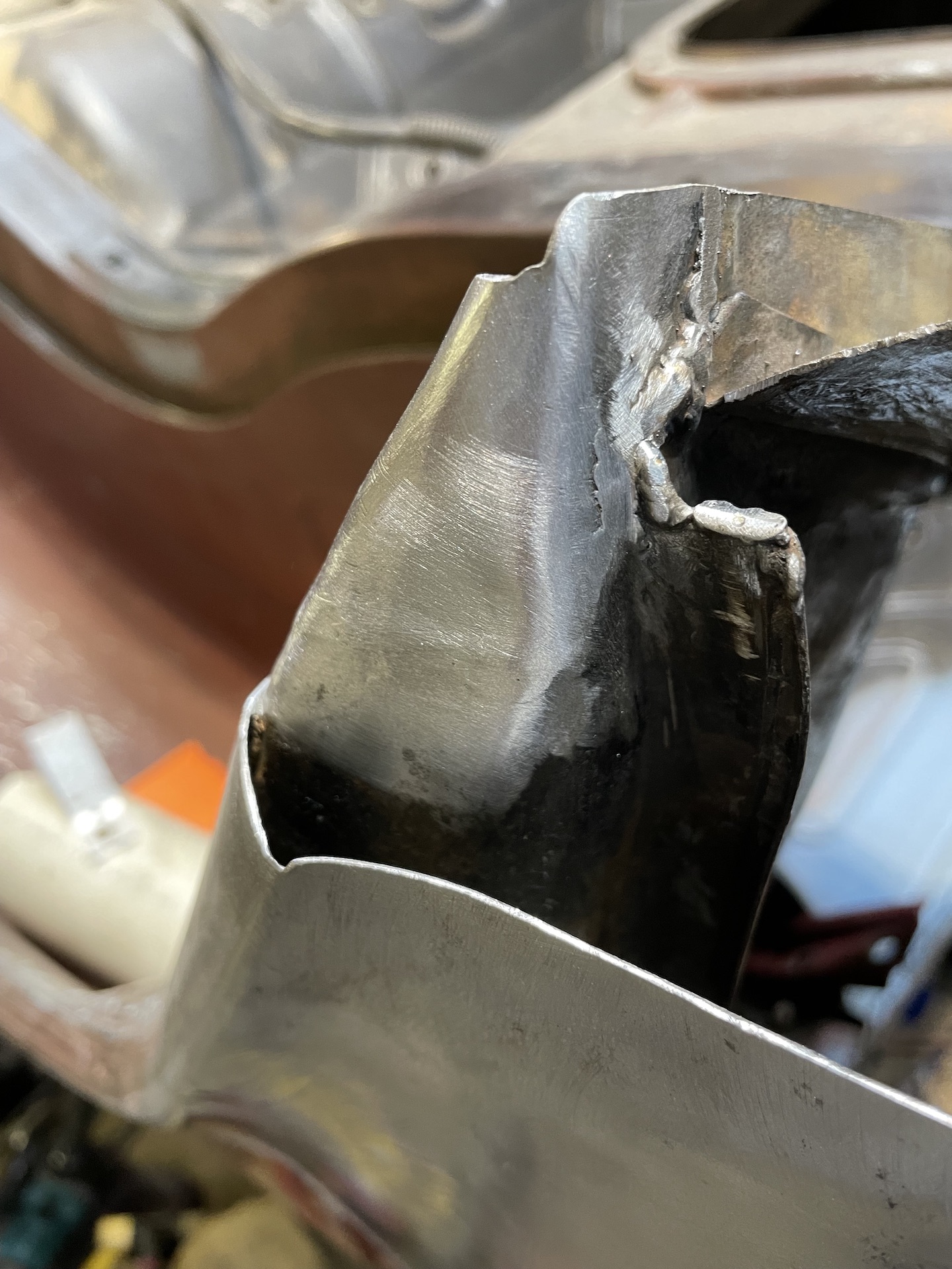

Same trick with tape for the inner repair. Transfer from the janky off cut.
Test fit and build up missing areas with more tape.
Transfer onto another 3/4 offcut, cutting away tape and marking curves.
Press out drains
Lots of test fitting twisting, shinking and stretching later.
Scott

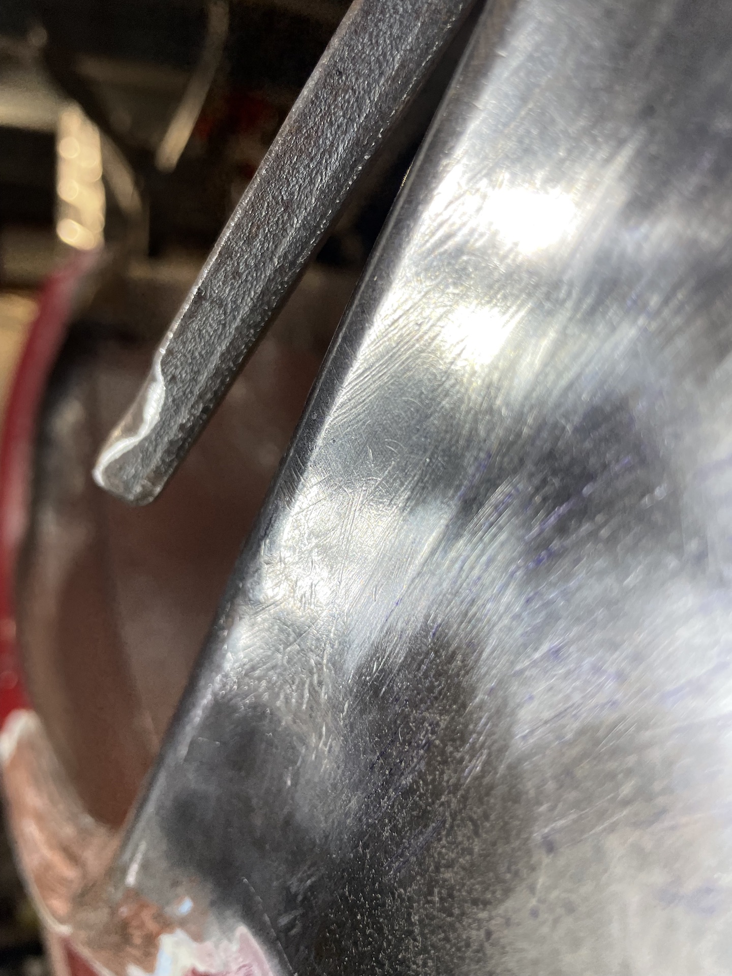

With all that test fitting and checking against the passenger side and I notice something.

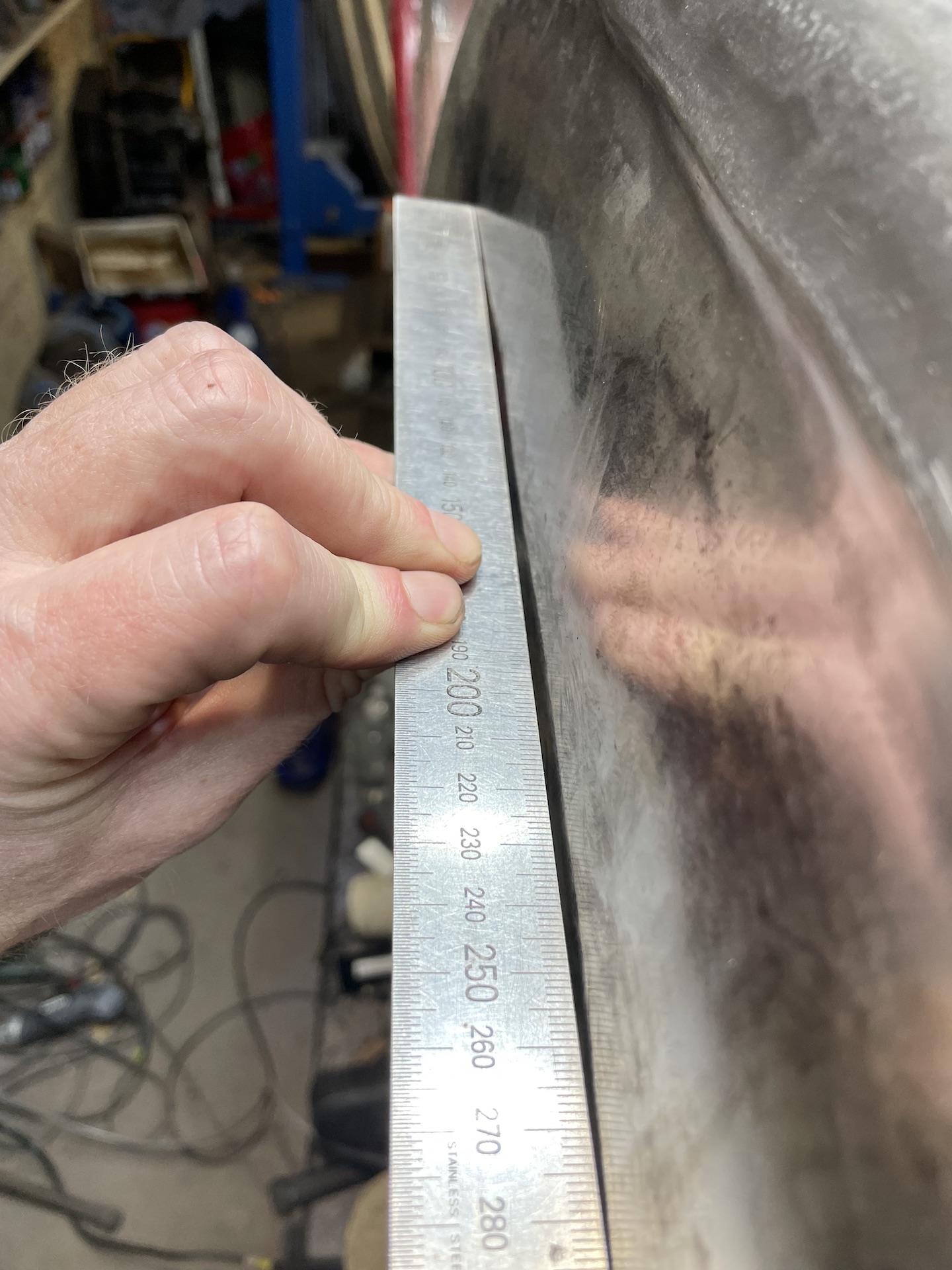

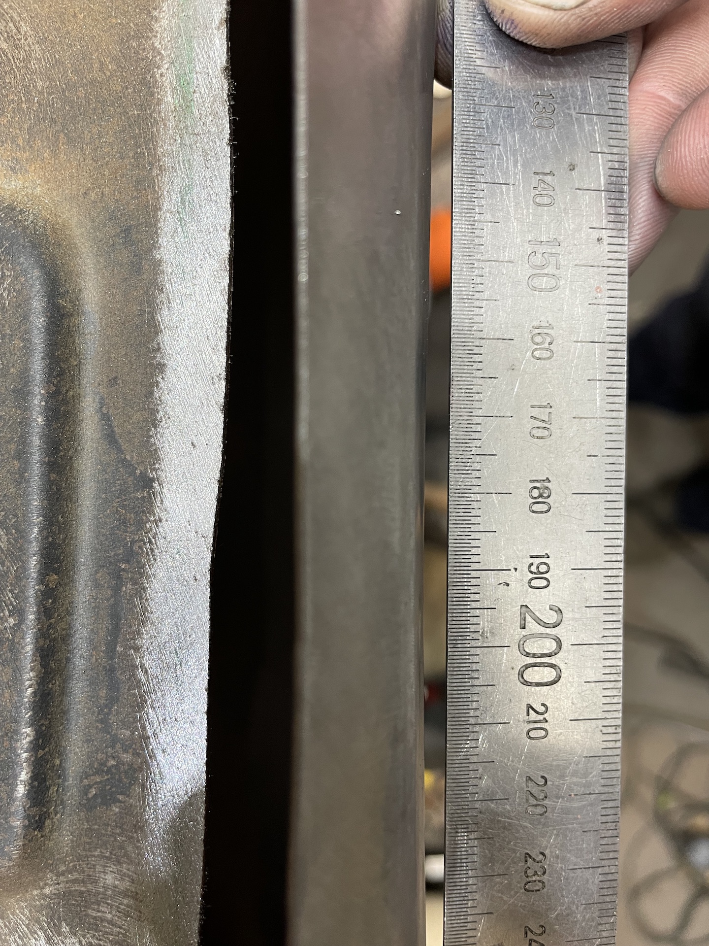

Drivers side 3/4 bows in slightly on the panel above and below the repair. The passenger side is dead straight.
Tried shrinking around the welds with the shrinking disk, because, hey it works like magic
Well not in this case
Bit of comic relief, tried to press the line outward with a clamp.
Hit it with a MAP torch to try to heat/shrink it. Nothing. In the end decided there was only one thing to do as it was going to bug the hell out of me as it was.

First, shrink the repair to get the line at the bottom straight. This I figured would help force the original panel out as it would have more bow in it at the weld line. Yes the very same bow I was trying to remove with my knee originally.
Used clamp from earlier to force to bottom out, and looks good.

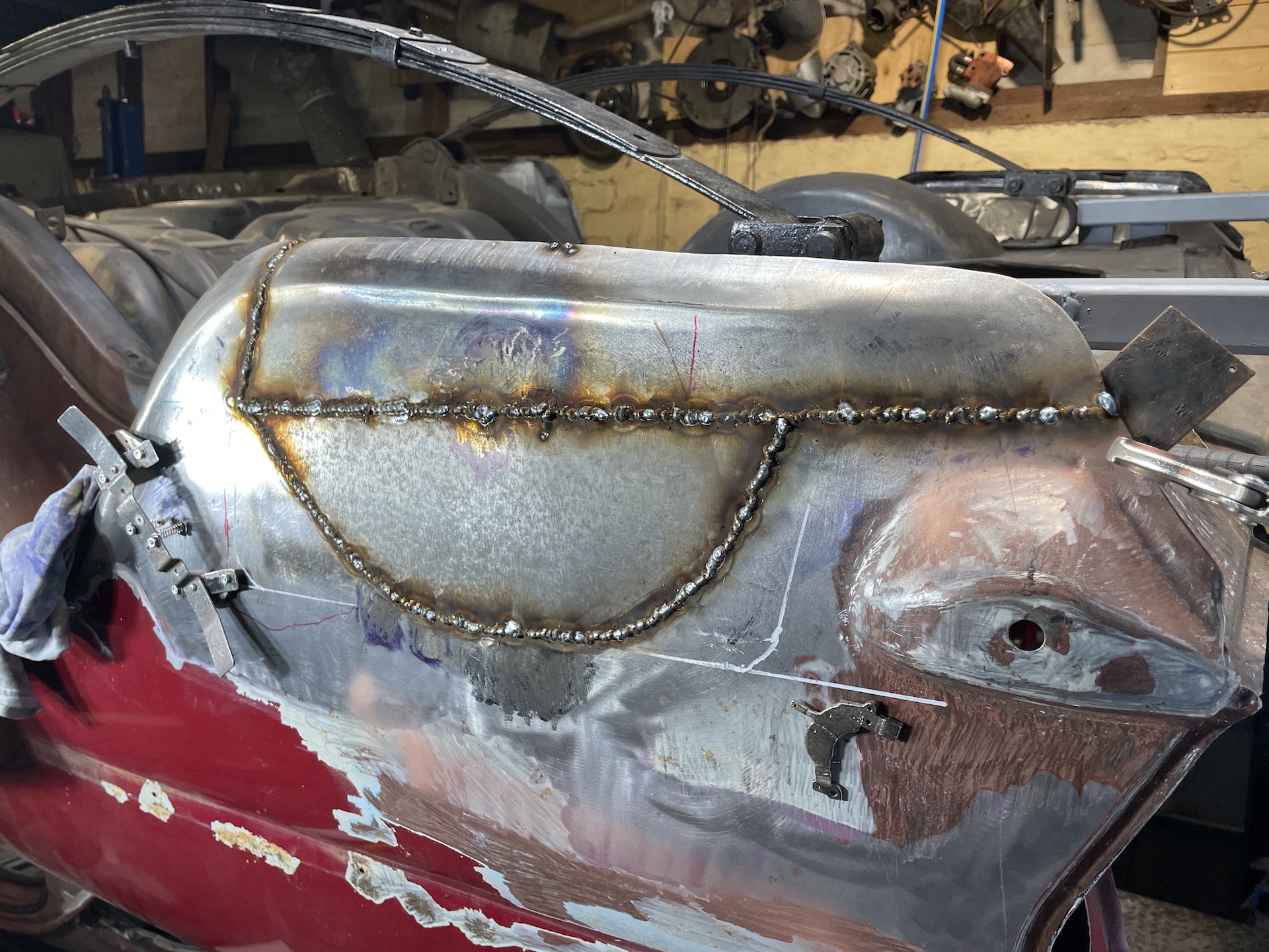

Lessons learnt, you can't shrink with a MAP torch (need more focused heat of oxy/acetylene which I don't have), and you can't force one piece of metal to behave by doing the opposite to another bit of metal. Seem to recall I learnt that on the sub frame - and then forgot.

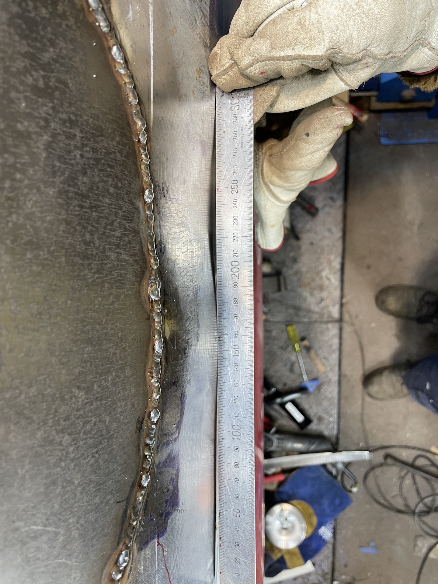

Days later, with all metal and my self in a relaxed state, time to finally tack and weld.

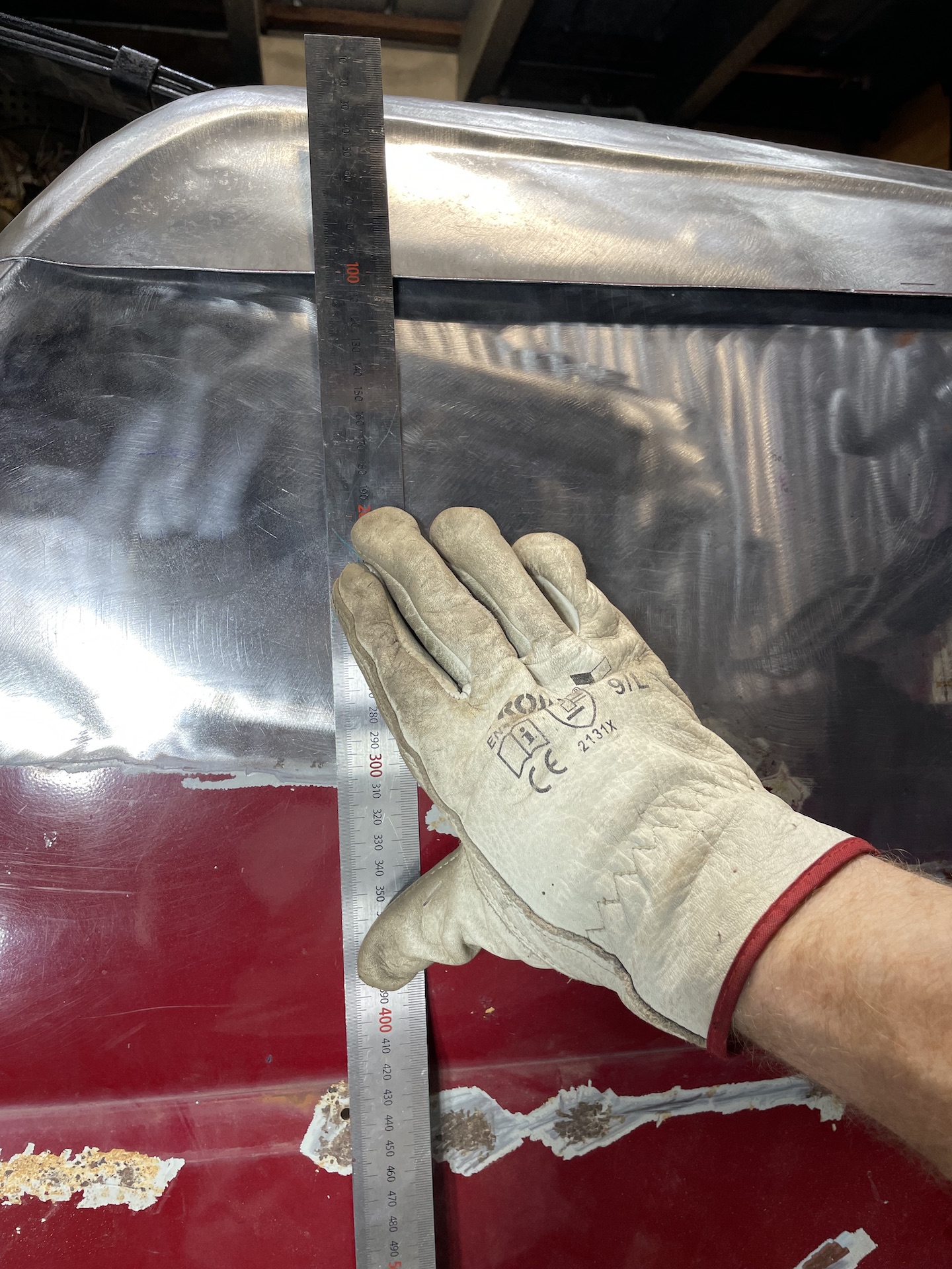

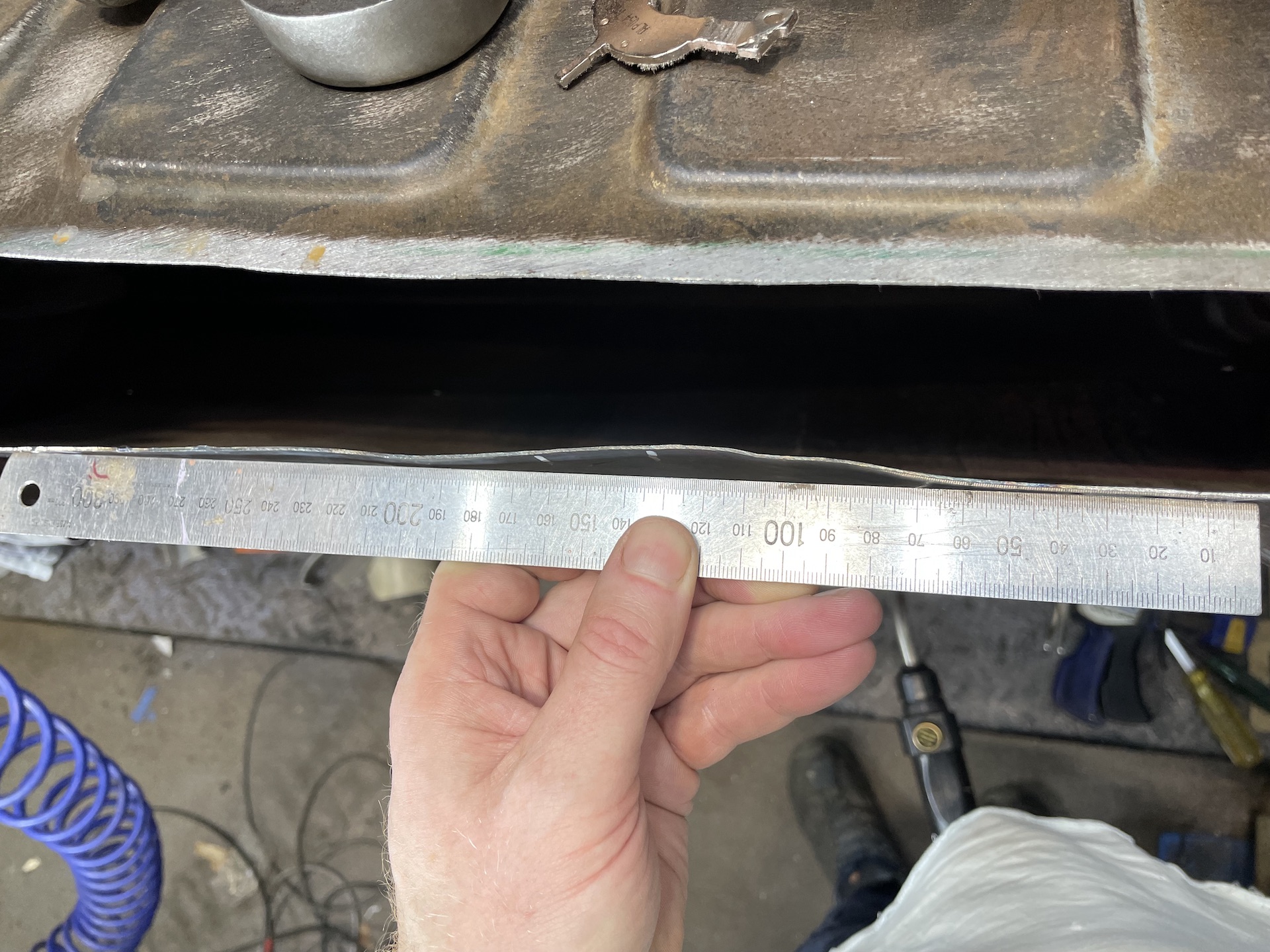

All looks good, run the ruler over it from top to bot...... muther fu@ker

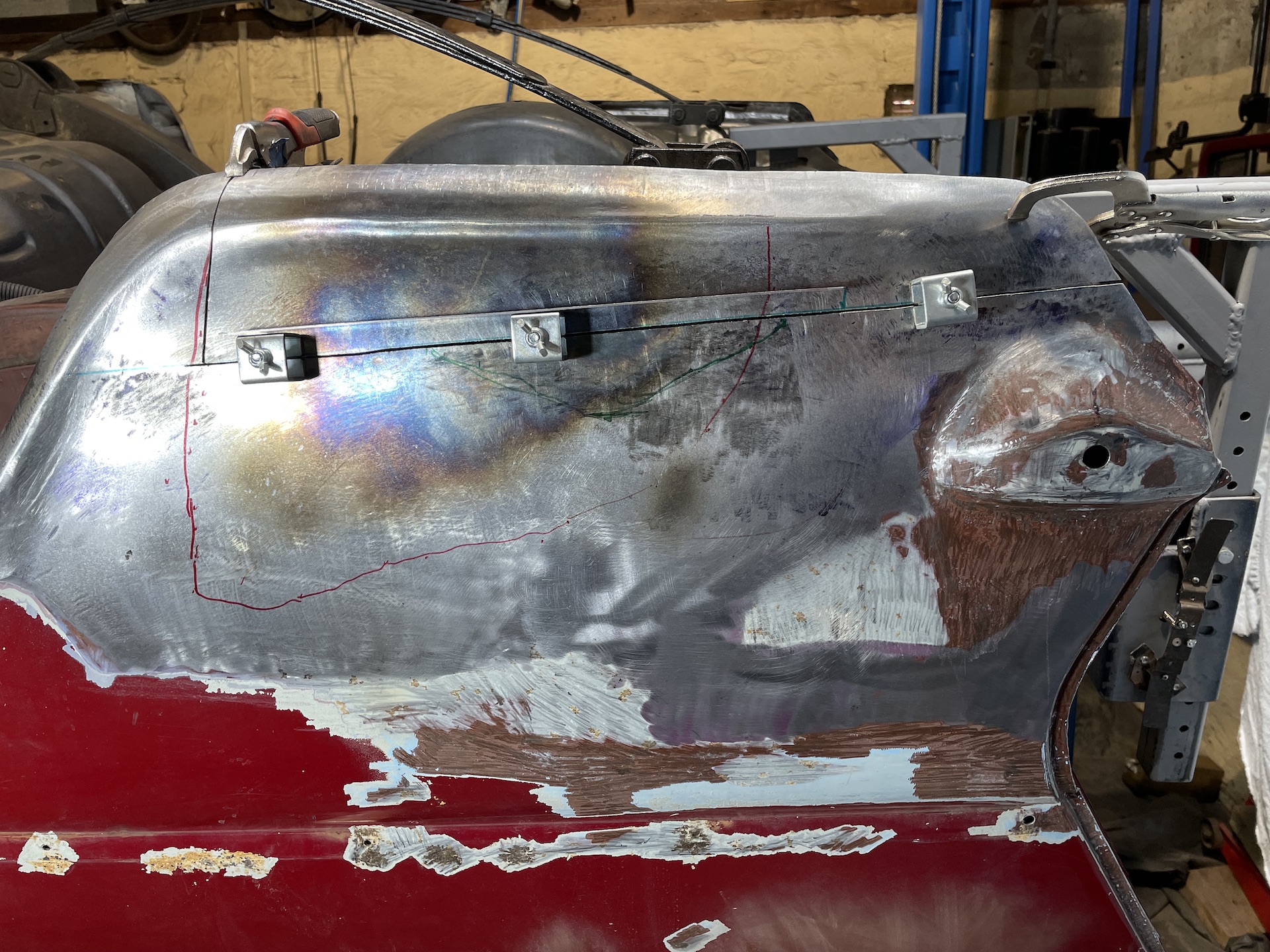

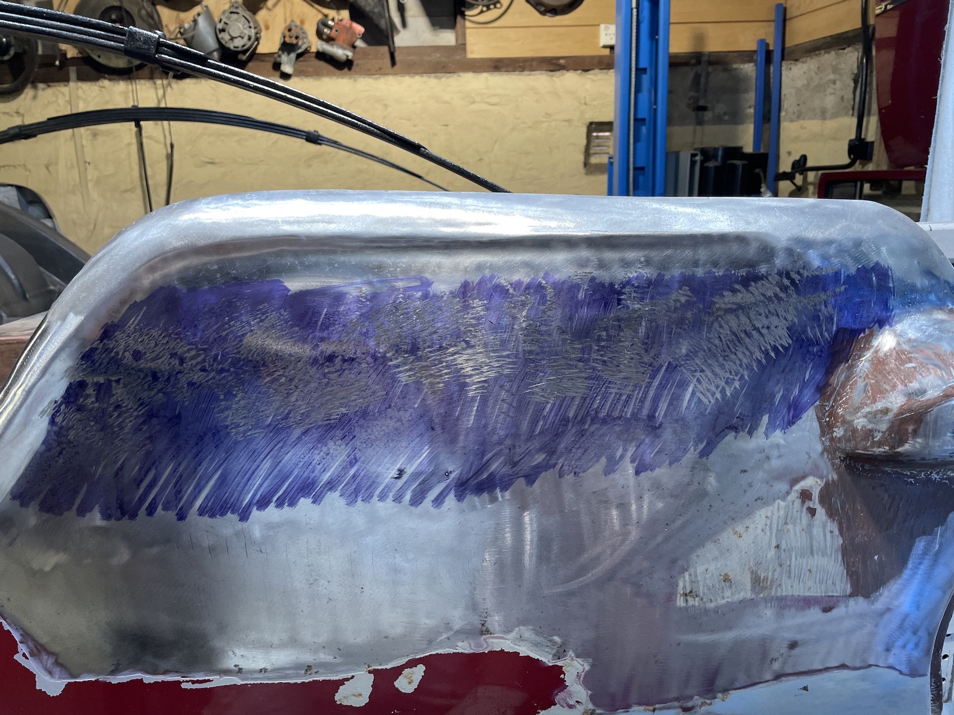

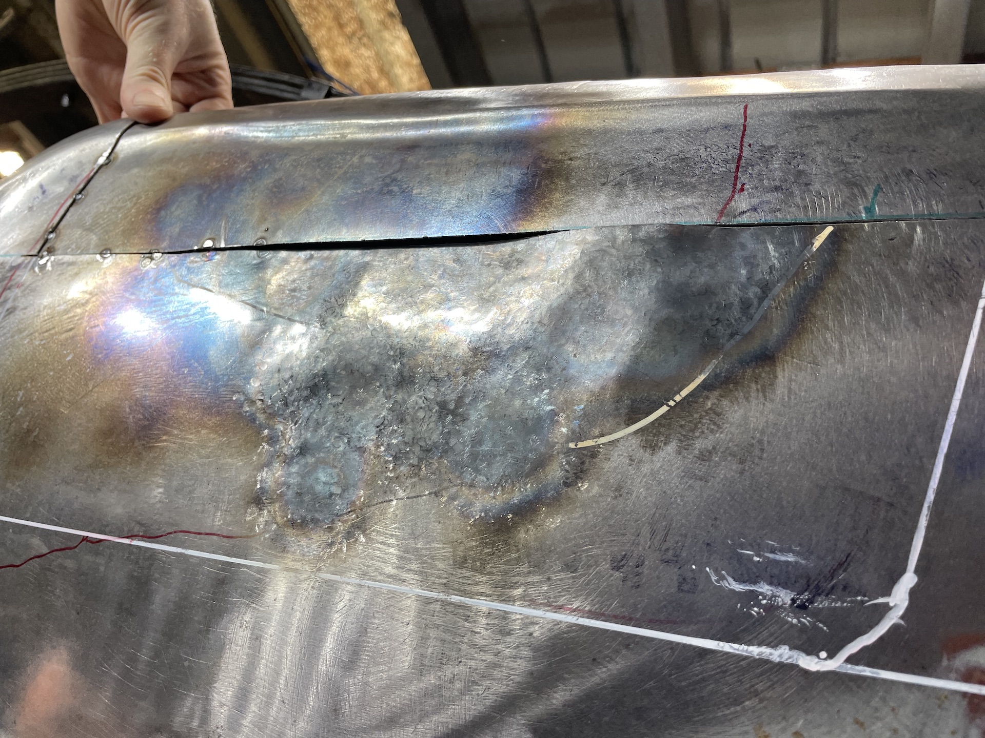

So looks like the stretch went further than I thought and was compounded by the welding which has also stretched things a bit, including in the middle of the new repair section which is visibly raised in the middle.

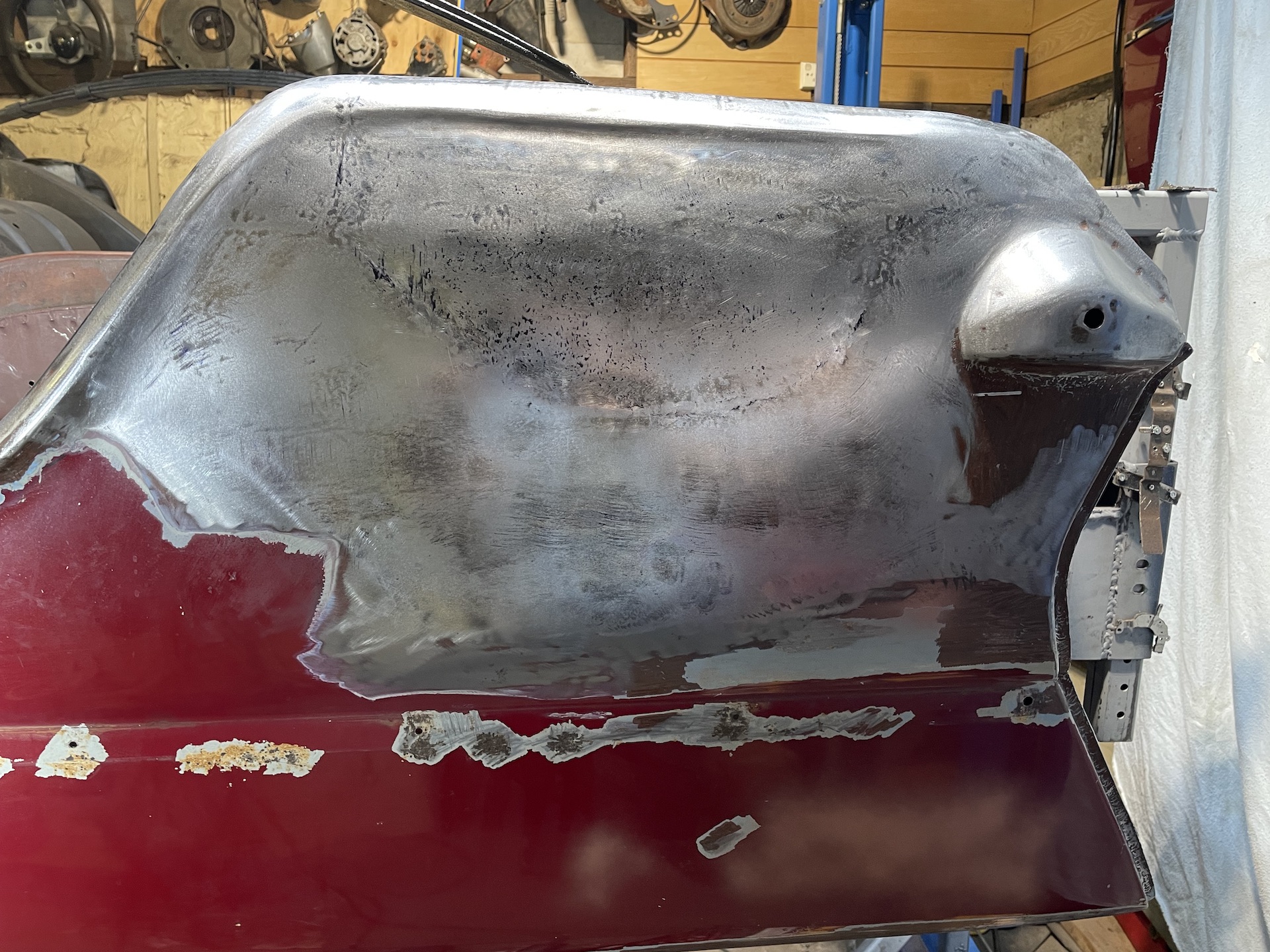

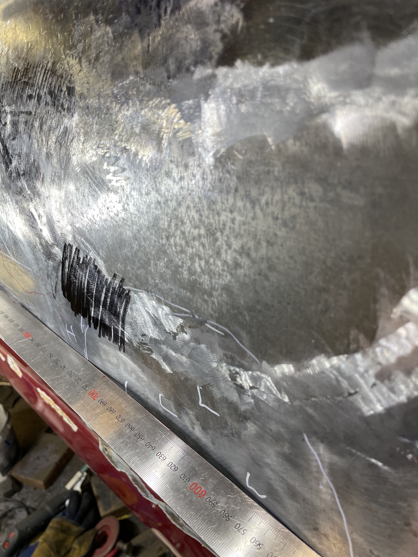

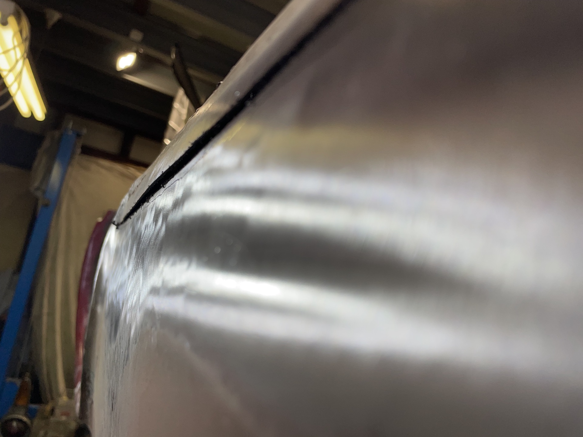

Really pissed off now - walked away, vowing to fixed something else and come back to it in the future. But next morning went out and this is the first thing I see, mocking me. So with a calm head, and a bit of patience, I started to fix this by removing the stretched metal. Figured the best way was to start shrinking from where I started welding in the top LHC and move around, alternating top and bottom weld paths.
This was all achieved with the shrinking disk, slapper and dolly. Didn't take many pics as I was in a bit of a shrinking zen space. Did get this one which shows the one on the left starting to close up a bit.

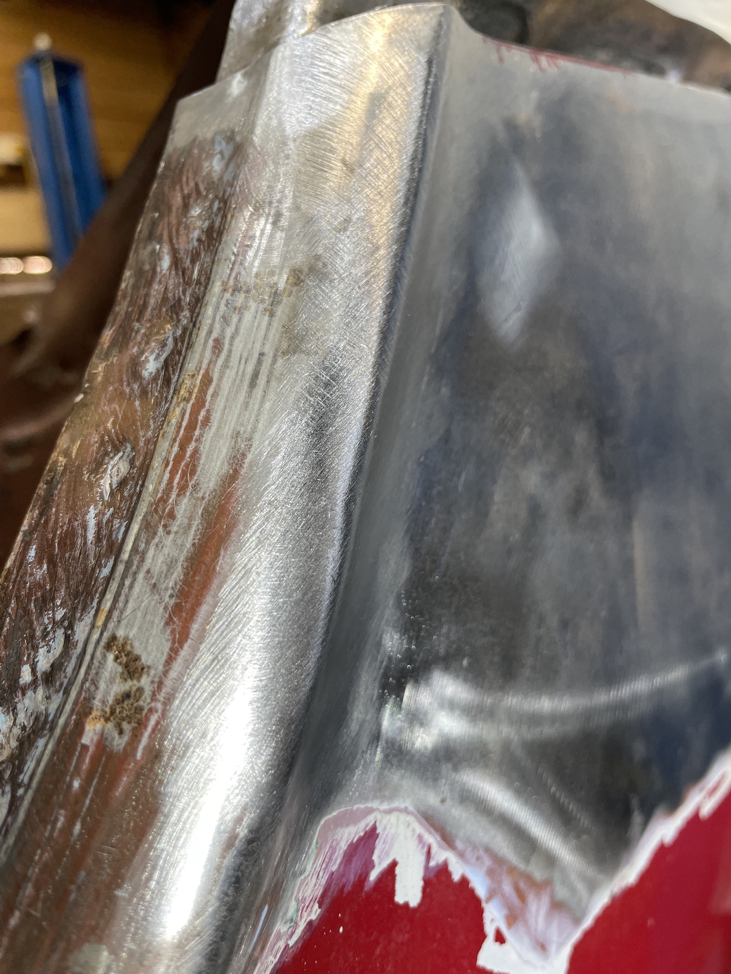

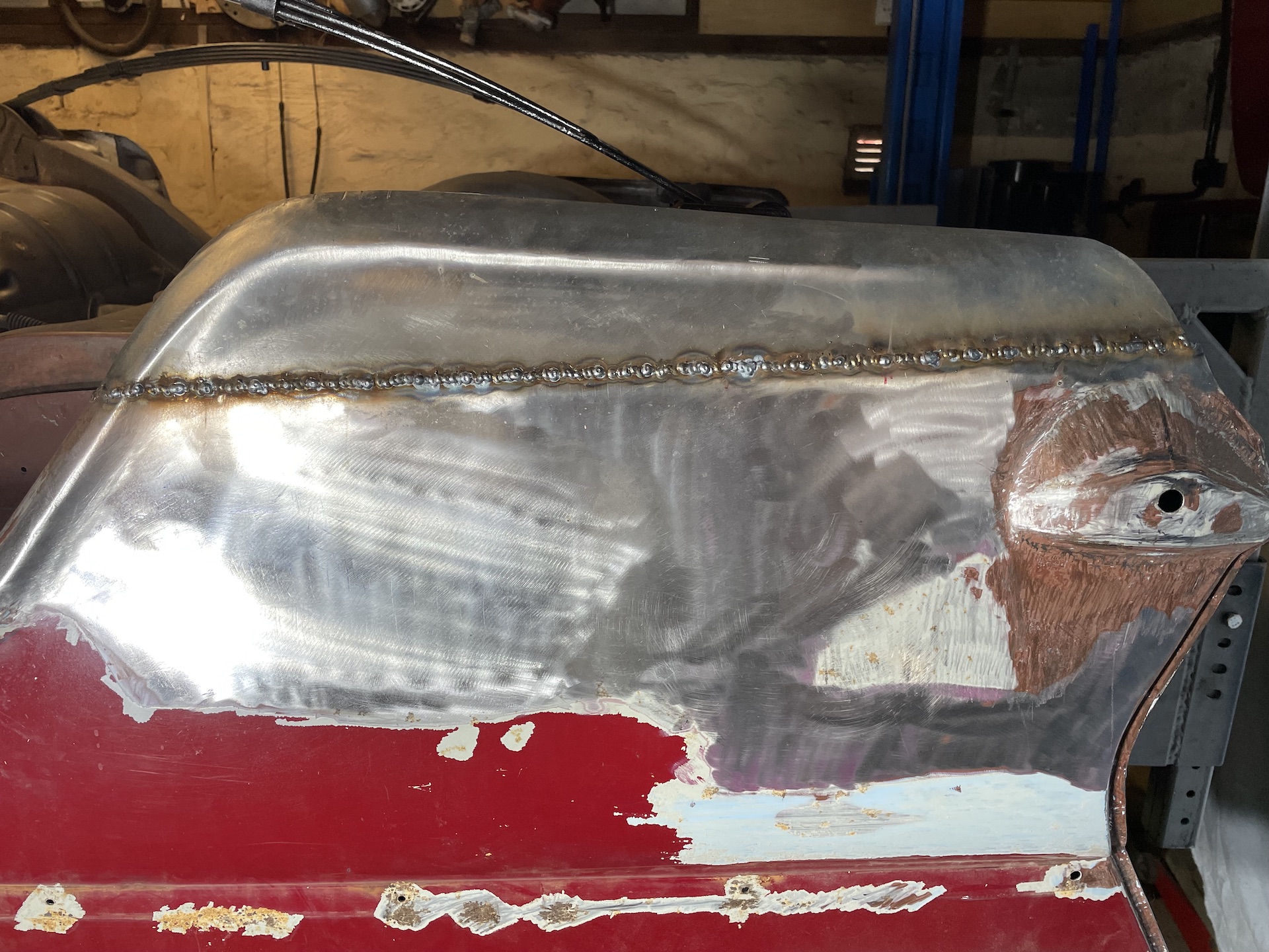

Four hours of shrinking, weld in the inner repair, grind, repair a few pin holes and this is what I ended up with.
All waves gone, no oil canning, and any ripples are visually under 1mm. Doesn't look great compared to attempt 1 but it's straight now.
Lessons learnt part 2, must try to read the panel better. There was a slight stretch in original that could have been shrunk out before attempt one was welded in. Shrinking the edge on the repair to straighten it should have also been done at that point, but didn't yet have the shrinker, and doing it manually must have been put in the too hard basket. Then repair bottom edge should have been shrunk to match original. Sounds easy in hindsight.
