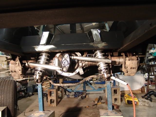

Here are some photos of how I have set up a similar rear end.
The first is in a Hot rod, with coil overs
This last one had to be designed around the minimum of space.
Allowing for over six inches of suspension movement, watts linkage and exhaust. Something that had to be designed around a lot of obstacles, and allow for a rear seat.
Sorry about the photo, but it is the only one I could find on short notice.

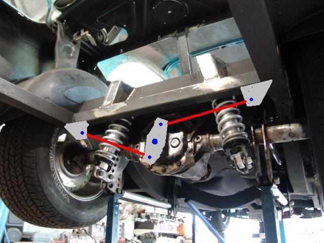

Maybe I should set it up this way, keeping both mounts at the top will allow the exhaust to be run under both brackets. There is no room to run one bracket low (as would be the prefered setup):
Unfortunatly that set up wont work, as both the arms must be parellel to
the ground at ride height, as in the photos I posted.And both move the same amount as the suspension does, this is how the diff remains centralised at all times
I thought about your exhaust going under the diff, but the tank and shocks will block it from being routed around them to the rear . As it would be too low run under the tank and not a desirable thing to do.

No good mate. The bars need to be parallel to work otherwise you will suffer from binding components. If you look at how the watts link work (on the net heaps of info ) they need to go up and down on the same plane and need to be the same length.
You could run 1 pipe over one rod and 1 under the other. If you look at smooth customs photos this is how they should be set up.
Same as the panhard the bars need to be parralel to the diff. I will get some shots of my setup just for comparison.

Might have it beat, checked the internet aswell and seems that they can be run like the pic below, same length and same angle (parallel, just not horizontal. I have to notch out the RHS above the Watts link but that's easy enough.
Brackets will be fixed to each chassis rail with the mounting holes at the same level as the mounting bolt for the watts link in the centre. I will have to fab a doubler (similar to Smooths) as the Watts link is about 45mm from the diff cover. At least this way both exhausts will exit at the same height and wont look crappy! :D :D :D :D :D :

Gary,
Your going to hate me for this, but no the link will not work like this either.
When you look at the pic imagine the diff coming down for example under braking.
The right link wants to go up with the body and because of its arc from its locating point on the center bracket will want to "push" inward.
The left link wants to go up also and because of its arc from its locating
point will want to "pull" outward. What you get is a formular from a man much smarter than me anyway, for every action there is an equal but opposite reaction. This will try and move the center plane to the left and bind the links.
In essence what we see here is the up and down planes of the links being tilted over in your case to the right, but the diff wants to go straight up and down!
To make the links work they need to be at 90 degrees to the up and down plane and parallel to each other so the arcs on both sides are equal and not fighting each other.The center bracket must also be at 90 degrees to the links for optimum travel without binding.
I have tried what you have suggested and have broken rose joints because of it and Im lucky because I have leaf springs that held the diff in. Yes and the watts link does work with leaf springs as long as you haven't got heaps of opposite end diff travel.
I know its frustrating but you need to get this right so there is no catastrophic failures ( did I spell that right ?).
