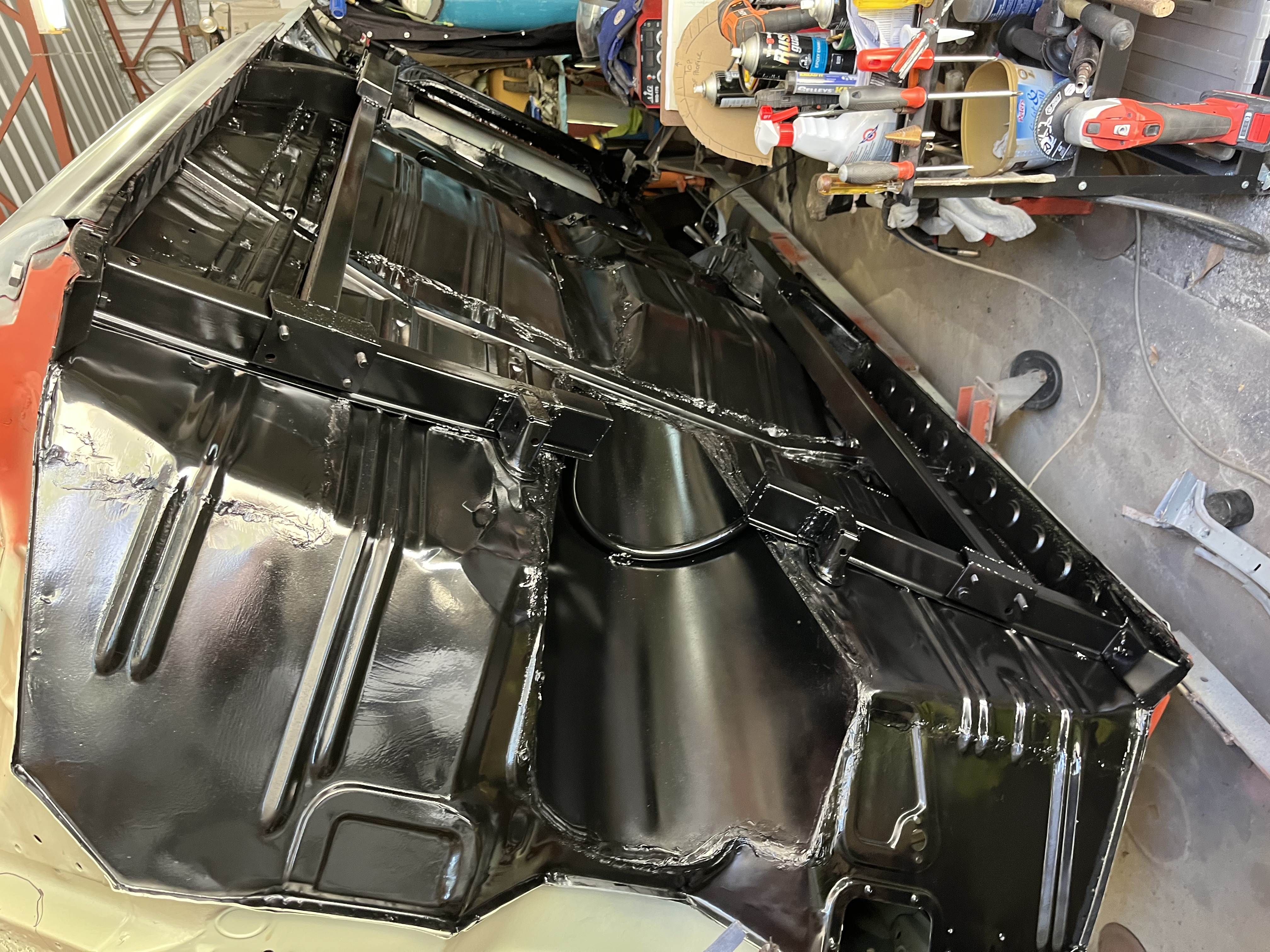

Loop in maybe not what everyone likes but it will pass muster.
Just check everywhere underneath then off the rotis tomorrow
Re: Neil's FB Station Wagon
Posted: Sun Mar 02, 2025 12:16 am
Looks very tidy mate, and it is done.

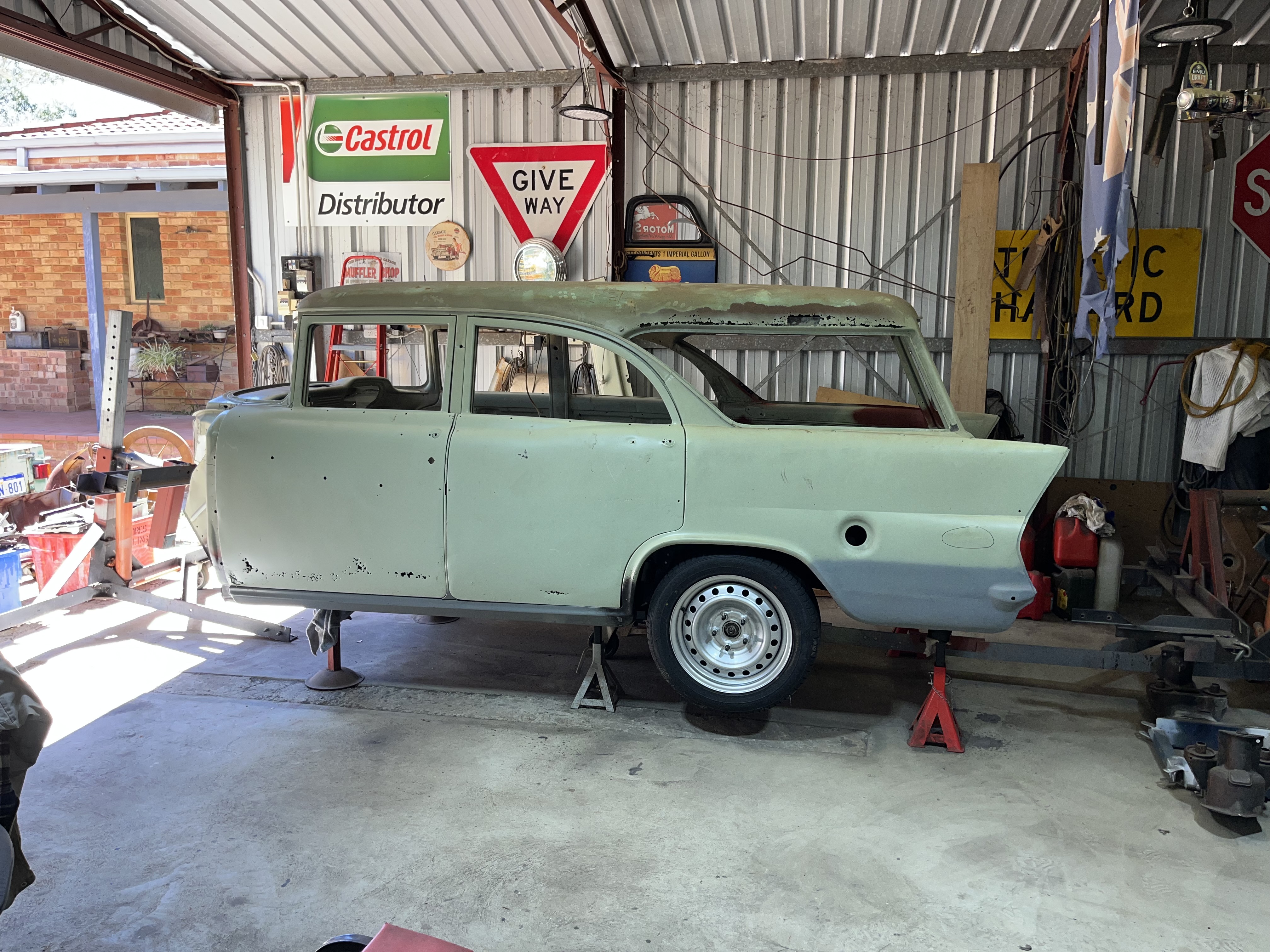

Off the rotis on car jacks, rear suspension underneath, rims and tyres look like they are going to work.
Roof soon I hope

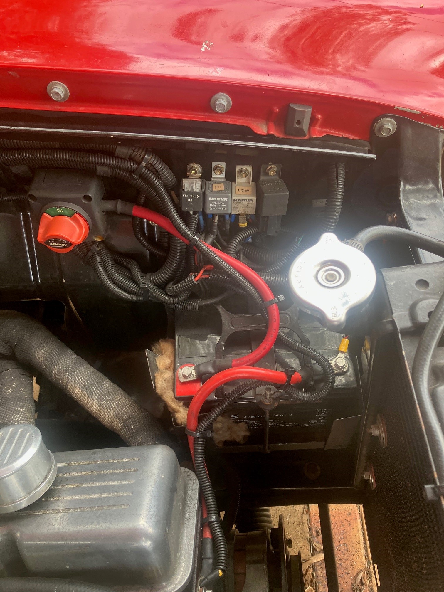

What are other Station Wagon builders doing about battery relocation????????????
Harv what type of battery did you use and where is it, same question to you BS there can't be any room in your wagon up front for a battery, I'm thinking relocation to where the spare would have gone but as small a battery as can get that can handle the voltage drop, on or to the side of the tank.
Posted: Wed Mar 05, 2025 1:34 pm
I'm running a 33Ah deep cycle sealed lead/acid battery (DC12-33) in the standard location. It raises eyebrows at the battery shop, but works.
https://www.sprintintercom.com.au/dc12-33
It cranks over a 10.5:1 V8 without a problem. I'm running a high-zap ignition box, twin thermos H4 lights, and the normal lights and radio. It's charged with a 160A alternator. I get about 5 years life out of them.
There was only about two finger widths between the battery and No. 1 header pipe. I made a simple two-sided heat shield out of scrap tin, and stuffed the space between the shield and battery with pink batt offcuts (... which I robbed from the house ceiling :oops: ). Works well.
I've got the same battery in the FED... if one craps out, grab the other.
Posted: Wed Mar 05, 2025 8:59 pm
Wondering why deep cycle Harv?
Posted: Wed Mar 05, 2025 11:15 pm
I had a very similar battery in the wifes EK V6 - was actually out of a jet ski. Bloody thing was tiny but did the job :thumbsup:
Posted: Thu Mar 06, 2025 6:51 am
Errol62 wrote: Wed Mar 05, 2025 8:59 pm Wondering why deep cycle Harv?
I put the engine and headers in, then stepped back and thought: "Ooops.... standard battery ain't going to fit". Lots of Googling. Sealed batteries were relatively new in cars, and some interesting stuff about hotrodders running batteries not much bigger than a VHS cassette (... back when VHS was a thing). Measured how much room I had, searched the catalogue until I found the biggest one that would fit. It just happened to be deep cycle.
