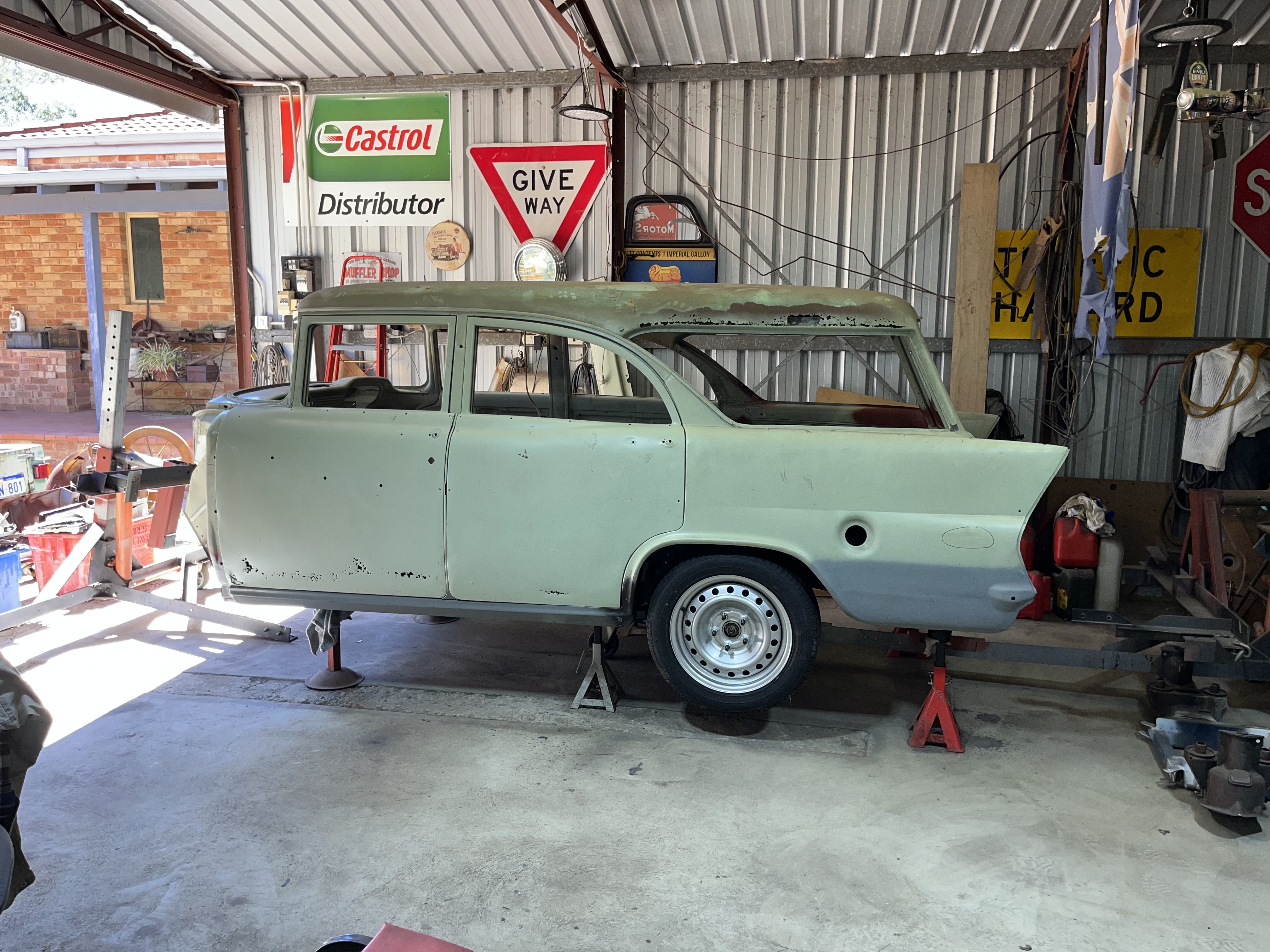

Off the rotis on car jacks, rear suspension underneath, rims and tyres look like they are going to work.
Roof soon I hope

Went looking for the shitty coilover spanner V6 Conversions sent me that they had cut out of a bit of 3mm plate and can't find it anywhere.
The advise the coilovers are supposed to be 260mm when on the ground I think they are 10-20mm high at the moment, you watch I will by another spanner and mine will show up :roll: :roll: :lol: :lol:

Should have two Neil, one to hold, the other to nip up, 10-20 will be close enough until you take it for a shake down run, they'll settle in, you might have found it by then. :lol:

Good point Briby I'm probably a year or two from shake down run so should be able to find it by then :lol: :lol: :lol:
