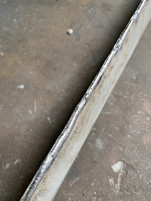

On the welding front, I have had some success with simple fusion weld but a fail when adding filler wire. :oops:
1st ally weld.JPG (48.75 KiB) Viewed 3057 times
Only doing short 20 mm welds then move on so there is less heat build up.
Resting my elbows on the bench seems to work as I can hold the arc better.
A good clean up ofthe shitty weld and try to fill tomorrow.

I have little luck using the filler wire as it either did not melt on the plate or it contaminated the electrode when I touched it.
Good old U Tube, show the removal of any anodising or oxidising then clean with acetone.
Did this and my fusion welds look good but still not luck with filler rod. More practise and more minor adjustments of the welder. :(

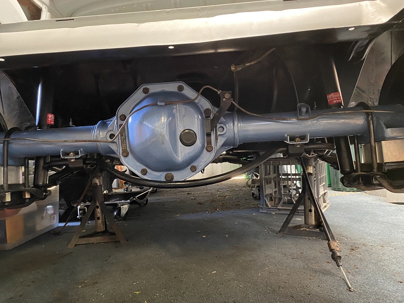

But I finished the diff and with Mitch's help put in under the ute. I may need to move the flex brake bracket.
Diff in.JPG (241.27 KiB) Viewed 2960 times
The lowering block will be painted black after I sort out the ride height.

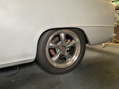

Wheels do fill the opening nicely.
Wheels on.JPG (204.29 KiB) Viewed 2960 times

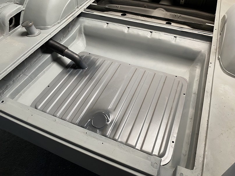

I dropped in the tank to ensure there is good clearance.
tank complete.JPG (183.58 KiB) Viewed 2960 times

Posted: Sun Feb 05, 2023 6:04 pm
Fancy wheel dollies mate and those wheels look horn. Are those stock sedan springs? Definitely could be set flatter.

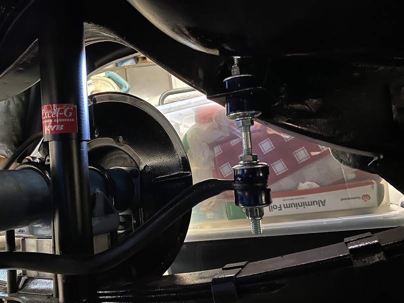

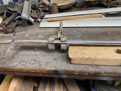

Checked out Clays sway bar mount on his ute then made a set from 50 mm angle with a couple of gussets on the sides.
sway mount 2.JPG (139.3 KiB) Viewed 2772 times
Sway bar installed with brake lines.
sawy bar.JPG (199.2 KiB) Viewed 2772 times
I got a flex hose made at Power Brakes to connect the metric VN brake lines to the imperial EK lines.
I was going to do a small line with different ends but it looked dodgy so I scrapped it.
I'm considering making a fill panel to close up the gap behind to rears wheels, similar to the sedans.

Diff looks nice. What’s the paint?
Re: Ammo's Ute
Posted: Wed Mar 15, 2023 10:31 am
by Wrongway Roger
I mixed the paint colour from blue and silver enamel. I wanted a colour that will contrast with the body colour.
Need to paint the brake lines black and straighten them a little. :lol:

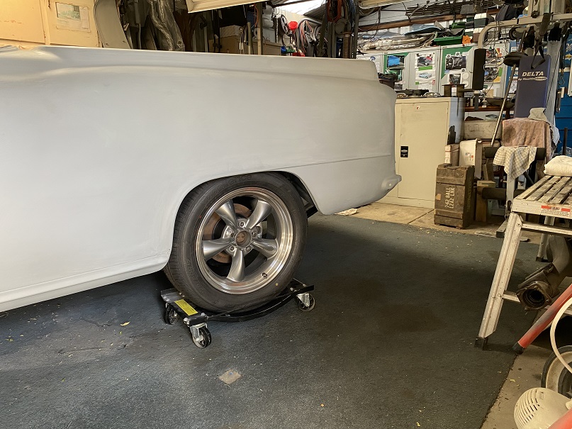

Slapped the wheels on today to check ride height and I think I will leave at this.
Still to load in the fuel tank, tail gate and hard cover so may go a little lower.
The flex brake line off of the calipers, is close the the chassis so may need to move the brake lines inbound.
