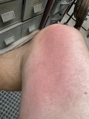

The other thing mentioned on U tube was get in a comfortable position so I did.
Sat on my stool, one leg up on the shelf, forearms on the bench.
Probably should have worn long pants. :oops:

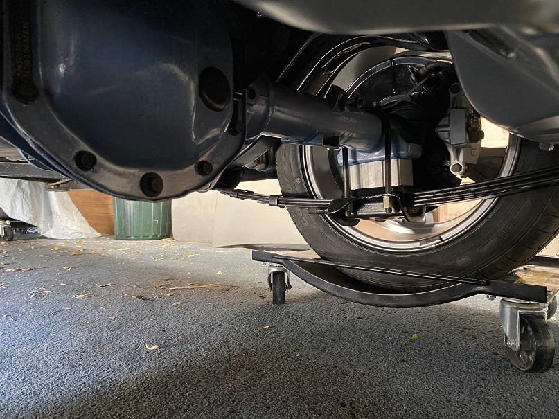

But I finished the diff and with Mitch's help put in under the ute. I may need to move the flex brake bracket.
Diff in.JPG (241.27 KiB) Viewed 2765 times
The lowering block will be painted black after I sort out the ride height.
Too high for me even with the sedan leaf springs. I did sit my fat butt on the rear of the ute as there is a tailgate , hard cover floor to instal, which moved it about 60 mm. Time to get a another set reset.
Wheels do fill the opening nicely.

Posts: 11420
Re: Ammo's Ute
Fancy wheel dollies mate and those wheels look horn. Are those stock sedan springs? Definitely could be set flatter.

I pinched the springs off of the sedan, in the hope it would be both a softer ride and a little lower.
Maybe a bag or 2 of cement in the back a a cheap lowering tool. :lol: :lol:
