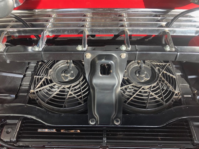

I see you are running twin fans do they run at the same time or do they cut in at different temps I am not sure how to wire mine up have you had any heating problems now that your on the road

G'day Billy,
They are a pair of Davies Craig DCSL 10 units (part number 0045), driven by one of their thermal switches and relays. I went for this size because there is no room on the engine side, and these require only moderate butchery of the bonnet catch. I had the Davies Craig thermal sensor that squeezes under the top radiator hose, but it had a real tendency to leak. Swapped it out for a screw-in type, and used a fitting that goes in the radiator hose (like a hose joiner). They both come on at the same time, with the sensor having an adjustment knob.
So far so good on the heating. Will have to see what it is like in summer though - aiming to tow all the camping gear up to Harrington with it this Christmas.

I have 2 x 12" a bit more modification to bonnet catch but I am happy with that part. Would it be possible to get a photo of the set up I googled the sensor but haven't fond anything as yet, I intend to run my fans to come on together at this stage but the internet is confusing as some say to run them at different temp setting and others don't, My best bet is to ask someone with simpler setup .

Posted: Sun Sep 13, 2020 1:39 pm
No need for a two-step controller.... too difficult. A simple thermoswitch with both on, or both off, is all you need.
Photo below shows the two fans in place, and the bonnet catch mildly butchered:

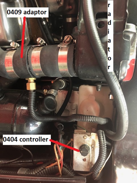

The next photo shows the controller arrangement. There is a simple 12V relay over near the fan that the controller drives.

The controller is a Davies Craig 0404: https://daviescraig.com.au/product/mech ... v-24v-0404

That rubber sleeve taught me many new swear words. No matter what I did, I could not get the damn thing to seal. In the end, I stumbled across the 0409 adaptor kit that prevents the need for the sleeve: https://daviescraig.com.au/product/temp ... r-kit-0409
Wiring is pretty simple, and there is a half decent wiring diagram that comes with the controller. If you are a moron like me, you wire them up backwards so they suck air from the engine bay through the radiator. When you go for a drive, the fans fight the incoming natural draft, and the engine boils over. Swap the wires over so they blow instead of suck and the problem goes away. Don't ask me how I know :oops: :roll: .
