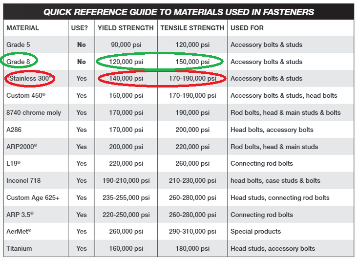

Them ARP bolts are spendy, but damn good quality.
Growing up, every magazine car seemed to have "ARP bolts". I'd never used them, but figured I would for the FED. The grey is being screwed together with them (black oxide for inside bolts, stainless 12-pointers for outside), with stainless 12-pointers being used on the chassis. The kids tease me when "the little blue and yellow packets" arrive in the post.
The chassis builder was a little leery of using them when he saw them on the diff mounts. Suggested I should swap them out for good Grade 8 bolts. Did my homework, and managed to convince him that they are better than Grade 8.
