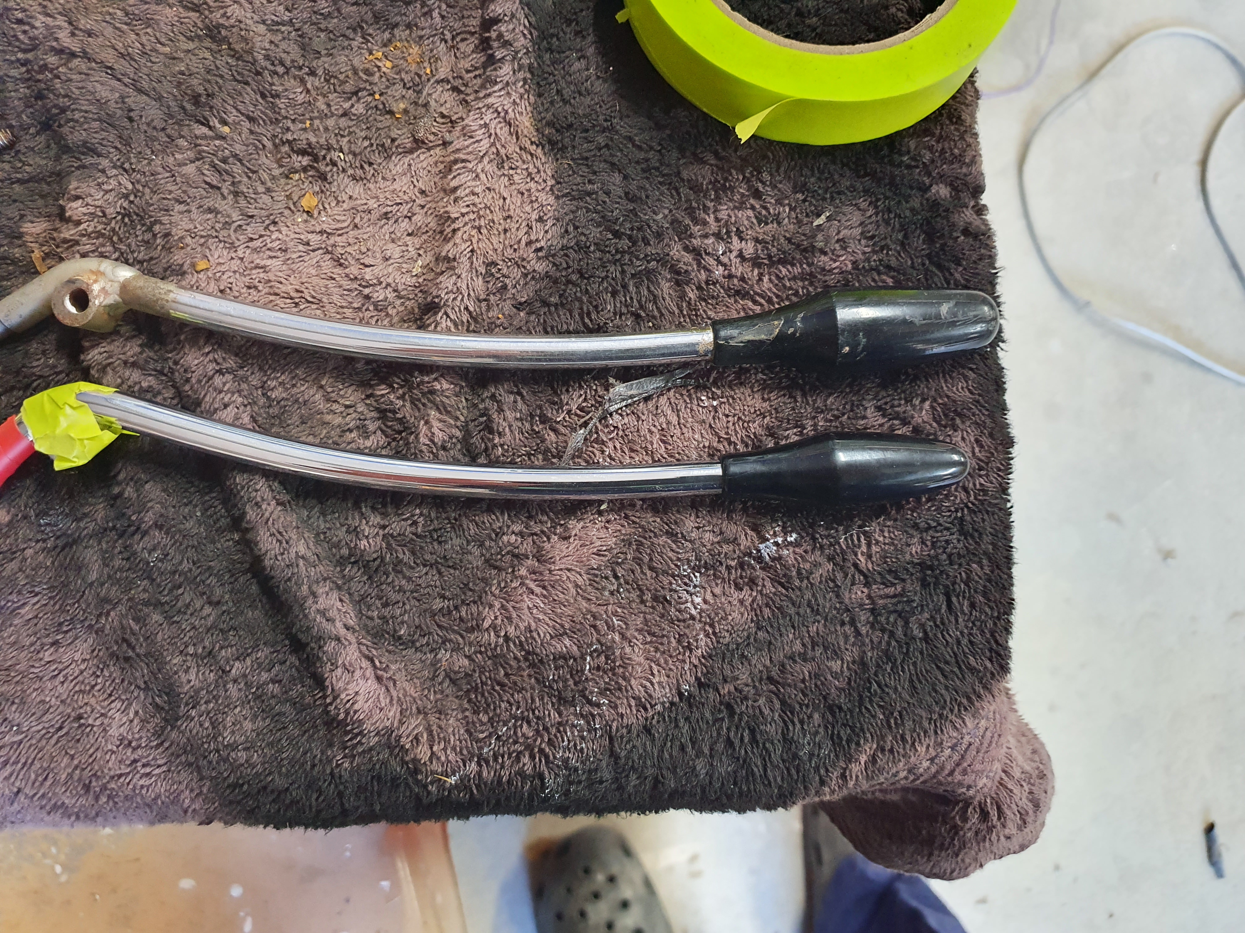

Yes Harv, Clay has a way with words 🙂. Question 606: I have two types of gear lever knobs- one is bigger than the other. Which one belongs on FB ?
Knobs
Knobs
