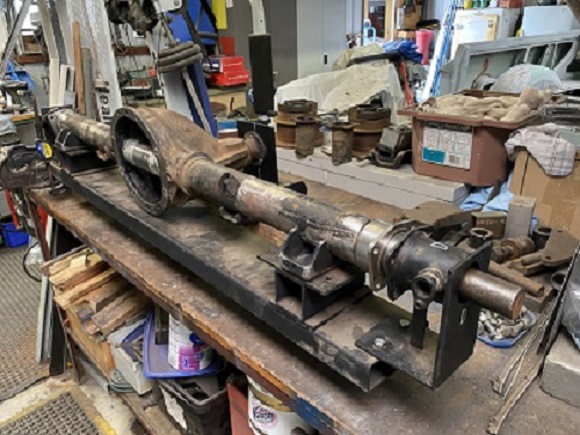

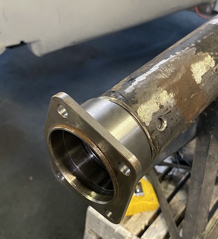

All ready to weld so I asked my neighbour to check my calculations.
Diff housing.jpg (76.48 KiB) Viewed 3684 times
All good until I remembered the disc mounts over the studs against the axle face.
Disc thickness.jpg (215.26 KiB) Viewed 3684 times
Now I have the re-cut the diff tubes by 6.3mm per side to achieve the desired width of 1370mm.
That's why we measure and longer then check and recut. :oops:

Located in the jig and all ready to weld, thanks again Gledge.
I will weld the bearing housing and spring pads, let it cool before removing it from the jig.

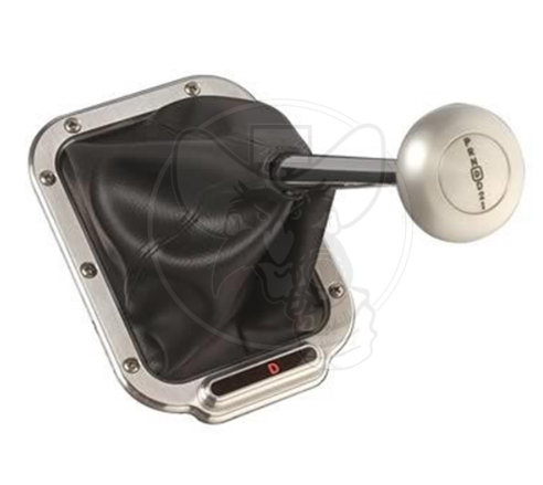

I was keen of a Lokar shifter but at nearly a grand, too much coin for me.
Lokart shifter.PNG (160.82 KiB) Viewed 3469 times
So now I'm leaning towards a T bar trimatic shifter from early commodore but these are scarce as I have found out.
Will possible combine with the top section on the centre console.
I did see this set up that looks ok but as 3 speed.
Ratchet shitfer.PNG (170.58 KiB) Viewed 3469 times
All thoughts welcomed.

Yeah the lokar is expensive and to the unweary, like myself doesn't have the ability to ratchet.
So that means select D and drive letting the tranny do the shifting.
Its all show and no go !!
