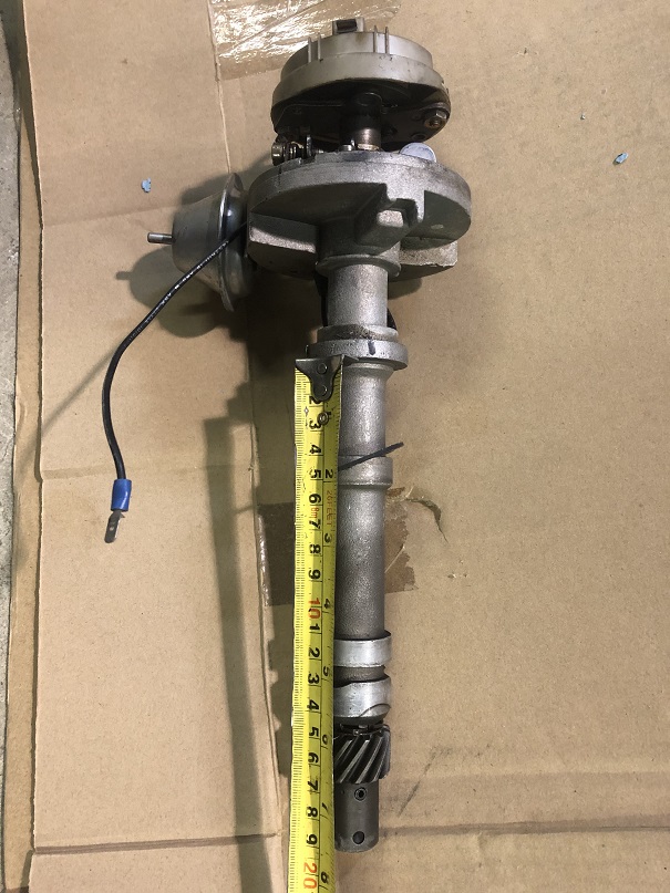

Question please: does anyone have a SBC dizzy to hand, and can measure for me from the block (deck) mounting down to the bottom of the oil pump drive (i.e. the length of dizzy that is buried inside the block, not the bit that is visible)? Want to get a feel for how hard it is going to be to get the MSD dizzy out.

I have a ready to run dizzy in my 283 chev, it runs great ! I used to get points fail and spark issues at high revs. The new dizzy solved all these problems. What exactly is unreliable about the ready to runs ?
I will measure a stock dizzy for you later tonight.

by EK283
Ok Harv,
its approximately 195mm long.

Beautiful - many thanks for the measurement.
Some quick tape-measure work in the dark shows that I've got almost exactly 195mm of clearance once the cap and rotor are off. It is going to be tight, but with a few expletives it should come out... just. May have to massage the cowl drain floor with the BFH.
