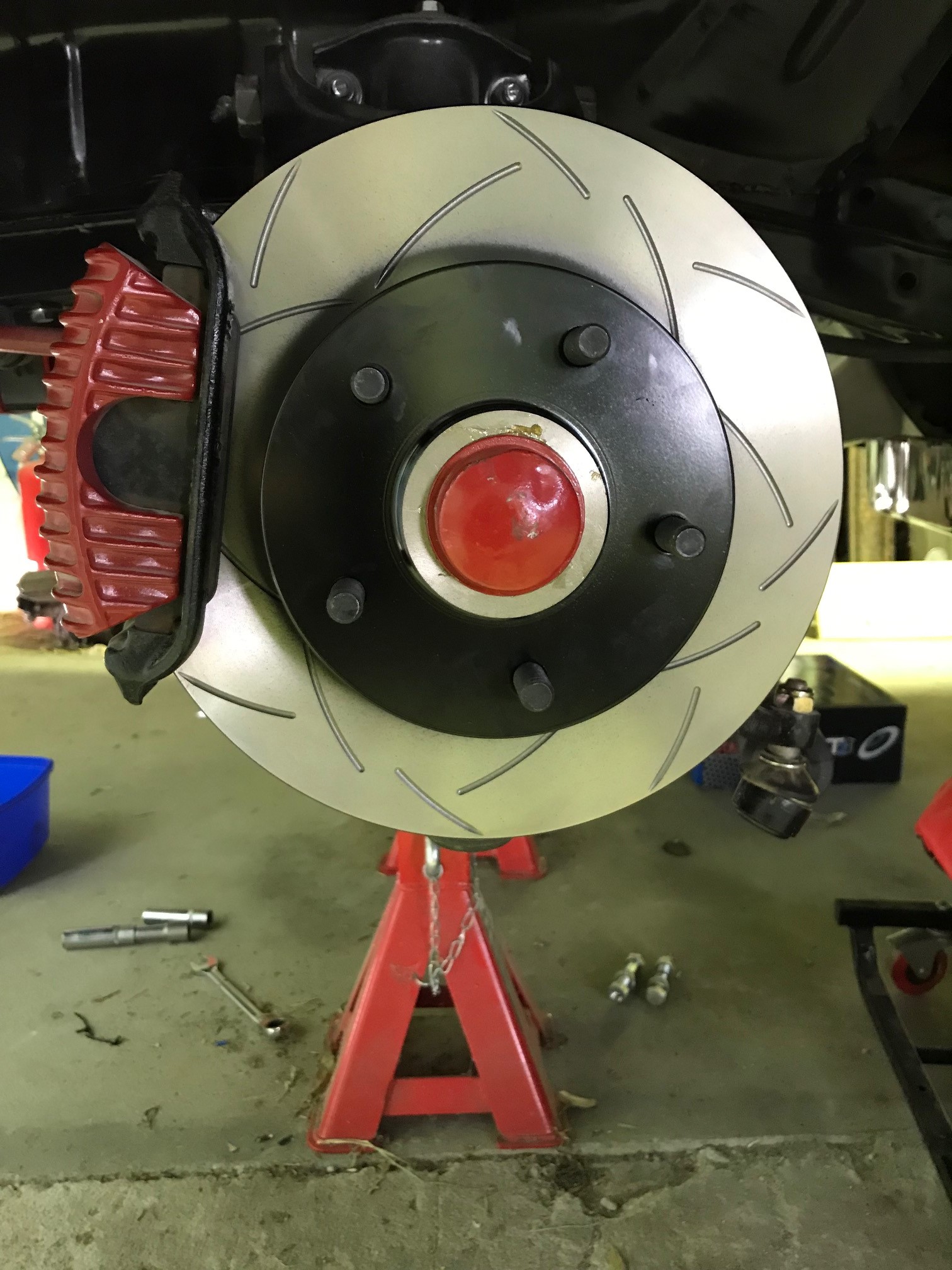

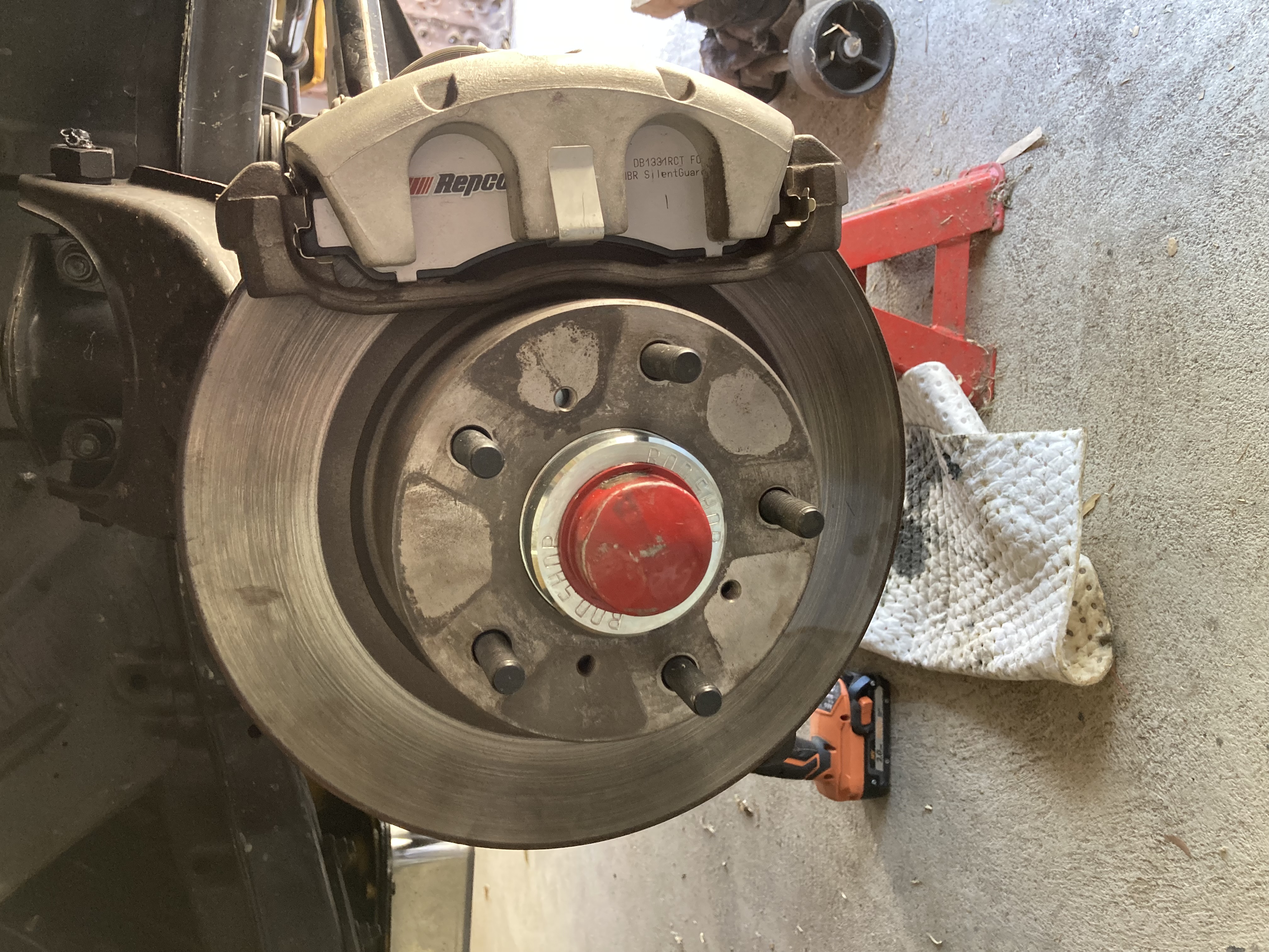

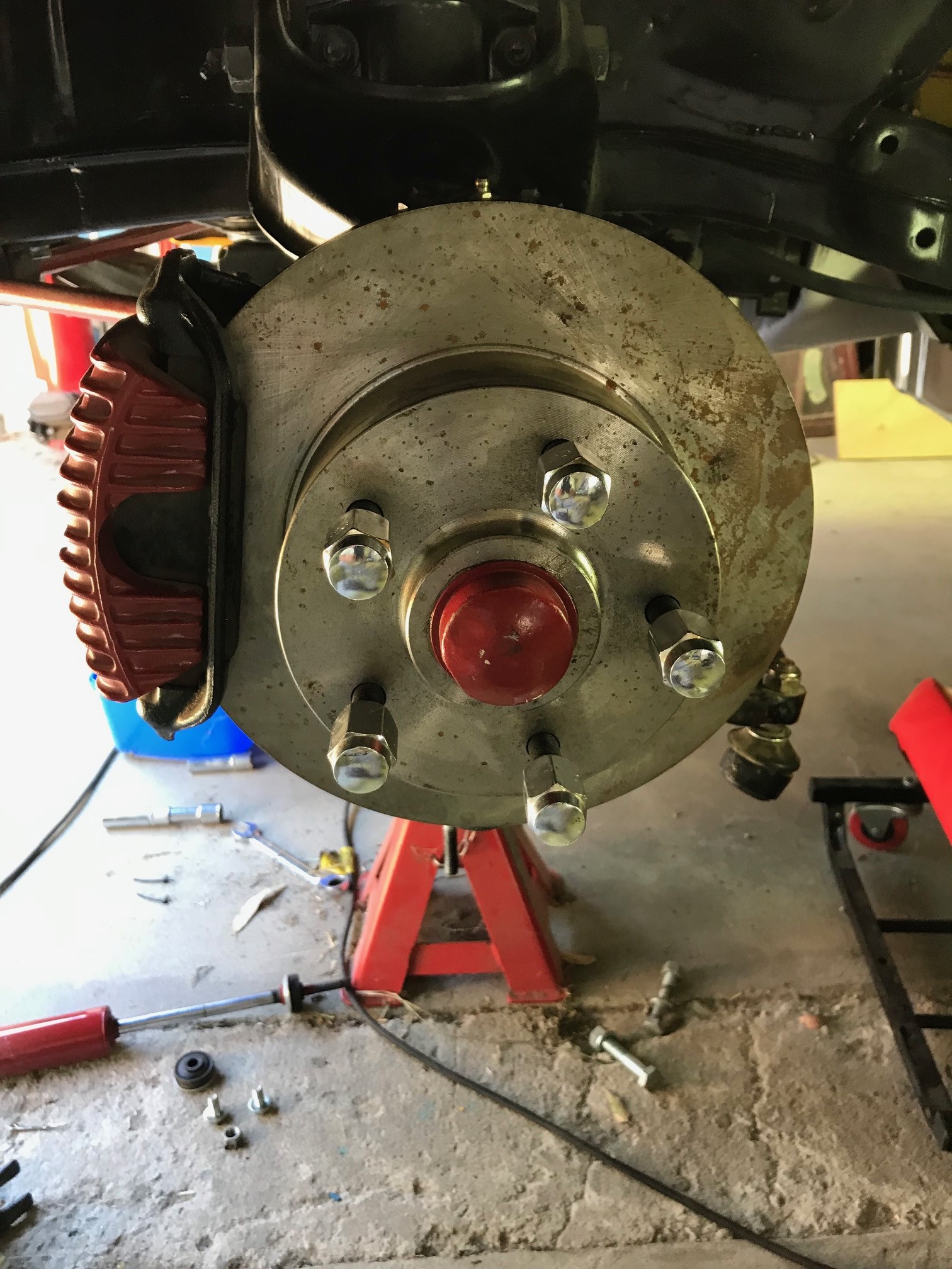

Yes you are right I had an issue with rotors as you say, this was before I did the VT twin piston caliper conversion, I was running VP calipers and standard rotors, when I bought the drop spindles I had that issue of not enough contact area, when I did some checking I found that the Calais had a slightly larger diameter rotor to standard so I changed to them and it sorted it out, when I rand CRS to find out what was going on they had no idea :roll: :roll:
I run 16" commodore rims as you know and found that I had to run HR steering arms but I also needed to rebend them slightly inwards to get enough clearance.
My rims/tyres are 195x50x16 front
205x50x16 rear
Hope it helps Roger let me know if you want me to get the rotor size for you that I changed to.
What they were like to start with
With new rotors
VT Upgrade

Thanks Neil forthe refresh on the disc size. It seems the V6 were 270 mm and the V8 were 290mm.
All sorted with front brakes other than the steering arms.

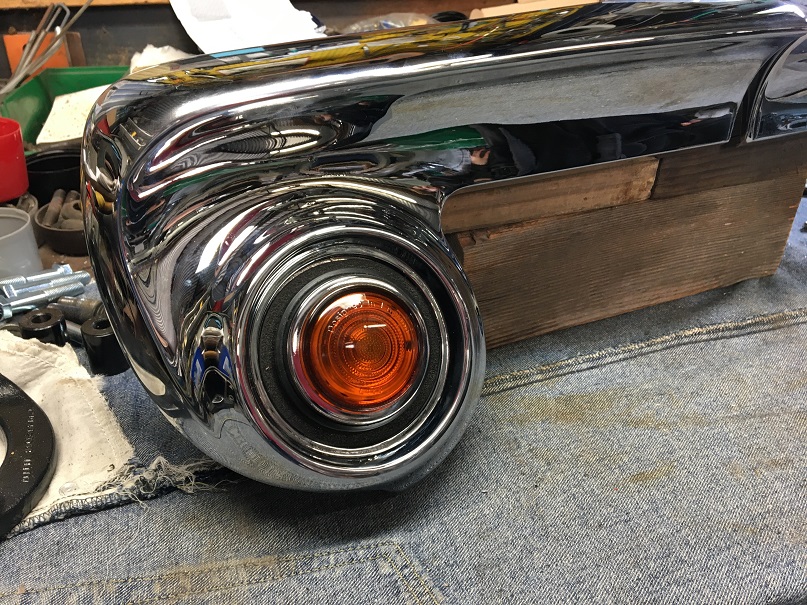

I have changed the front indicator to Morris Minor.
Nice glass and smaller.

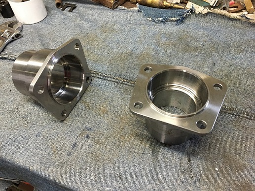

I purchase these from Rod Tech from the VN diff.
Bearing carriers.JPG (134.24 KiB) Viewed 2790 times
Gledge suggested these as they are far superior than the factory ones.
With the jig from Gledge, all should line up and be perfect. :lol: :lol:

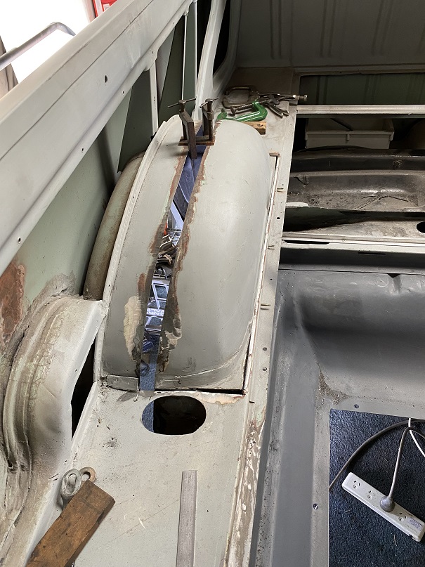

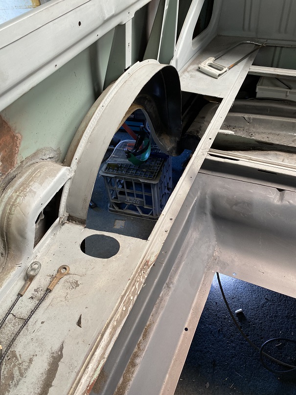

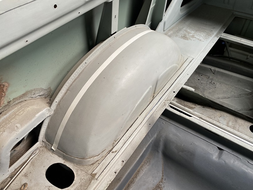

Well the wheel have arrived so now I need to narrow the VN diff.
I should have jumped on it quickly before I had time to think about tyres.
I have now decided to go with 17 x 235 wide tyres on the rear so hence the drive to Clay's for some a quick " mini tubbing meeting".
I was fairly sure I had worked out where to cut but seeing someone else's, just confirmed it.
Started on the hard side due to the fuel filler.
wheel tub LH.jpg (182.16 KiB) Viewed 2730 times
No turning back now.
wheel tub 2.jpg (206.34 KiB) Viewed 2730 times
Now need to cut a strip and weld in the tub
wheel tub 3.jpg (199.73 KiB) Viewed 2730 times
Prenty much a full days work to get it to this stage. RH side will be easier. :lol:
Oh, the hand hack saw is only for show as a 4" and 9" angle grinder does the job. :ewink:
