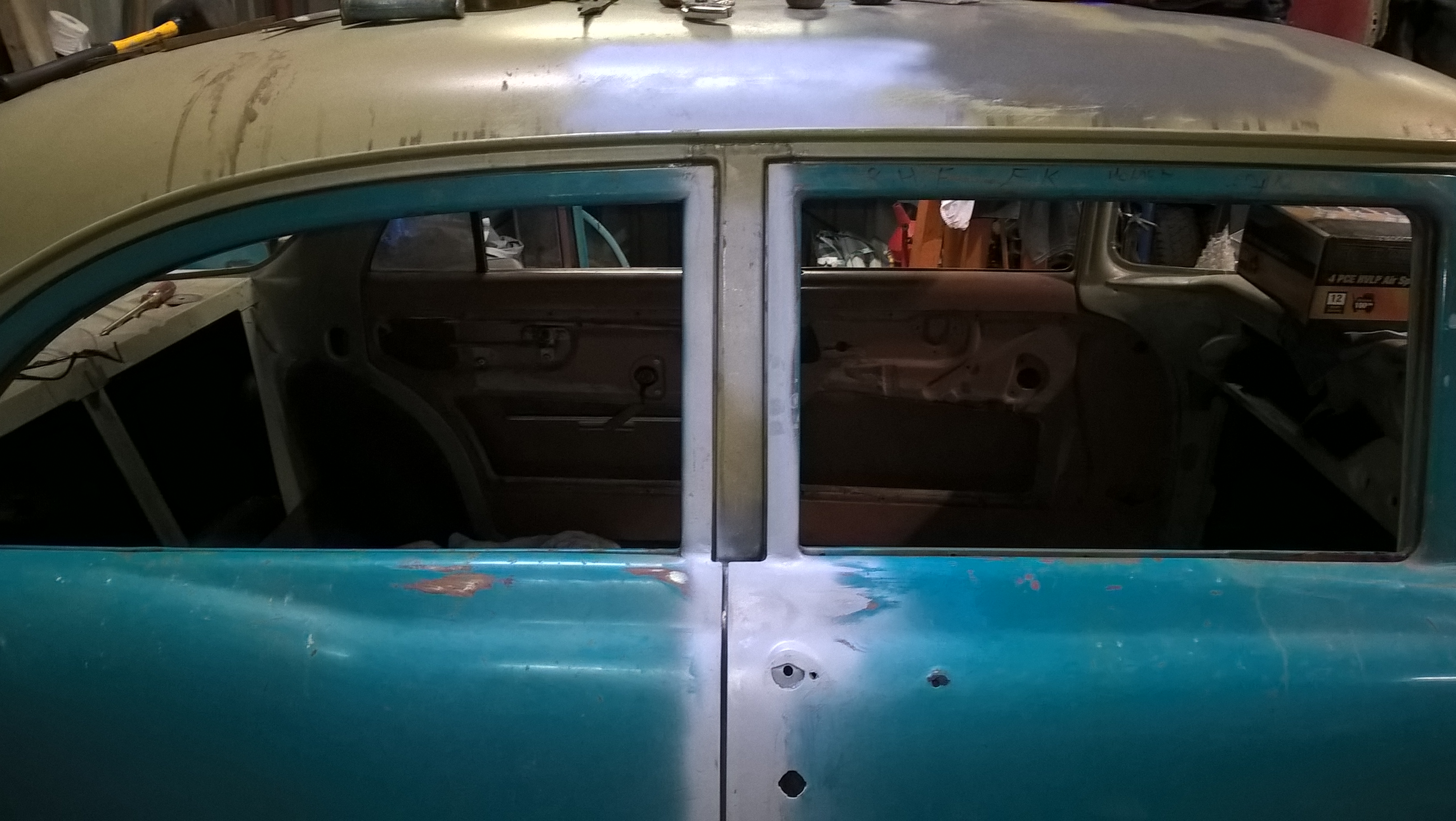

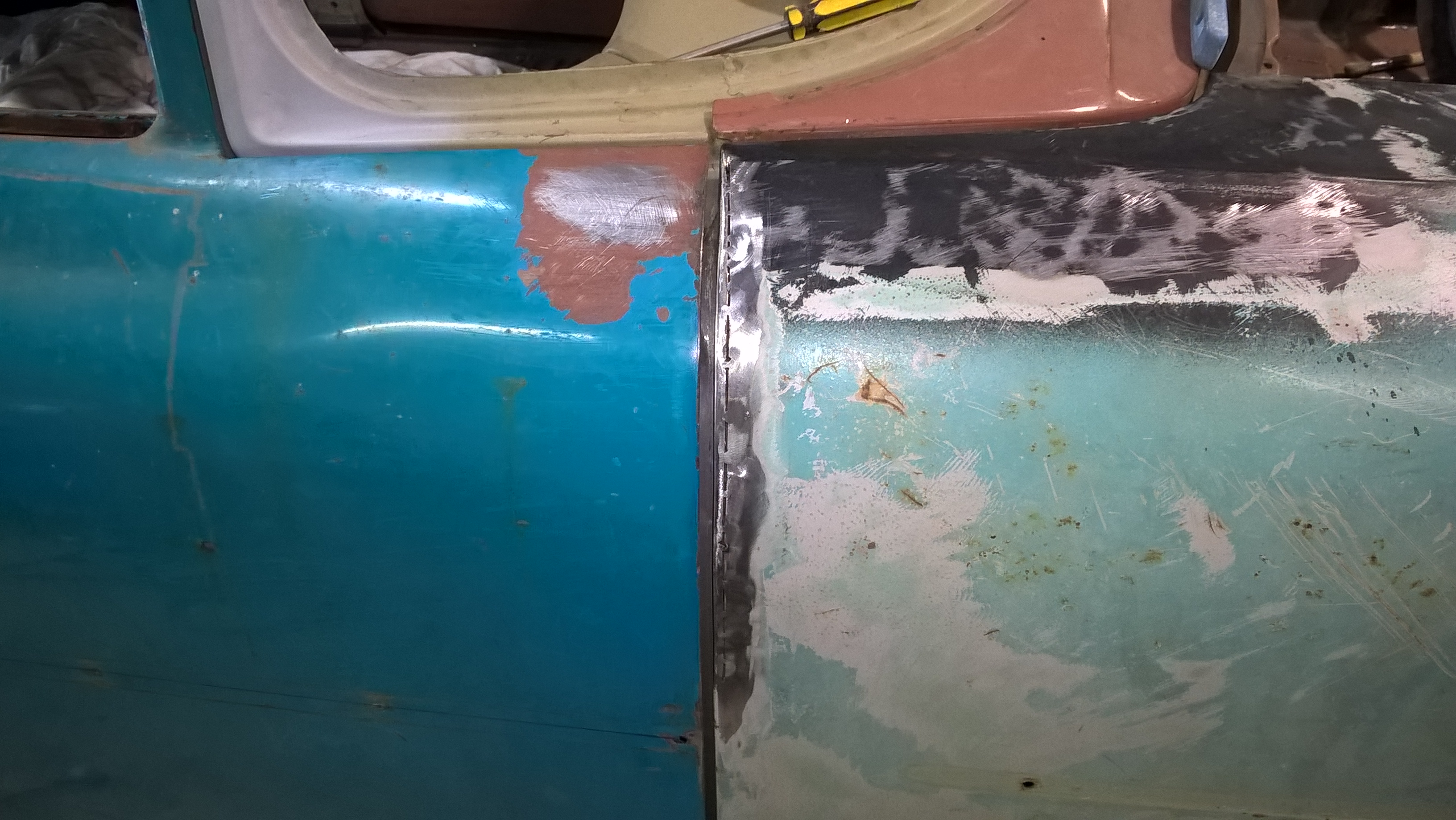

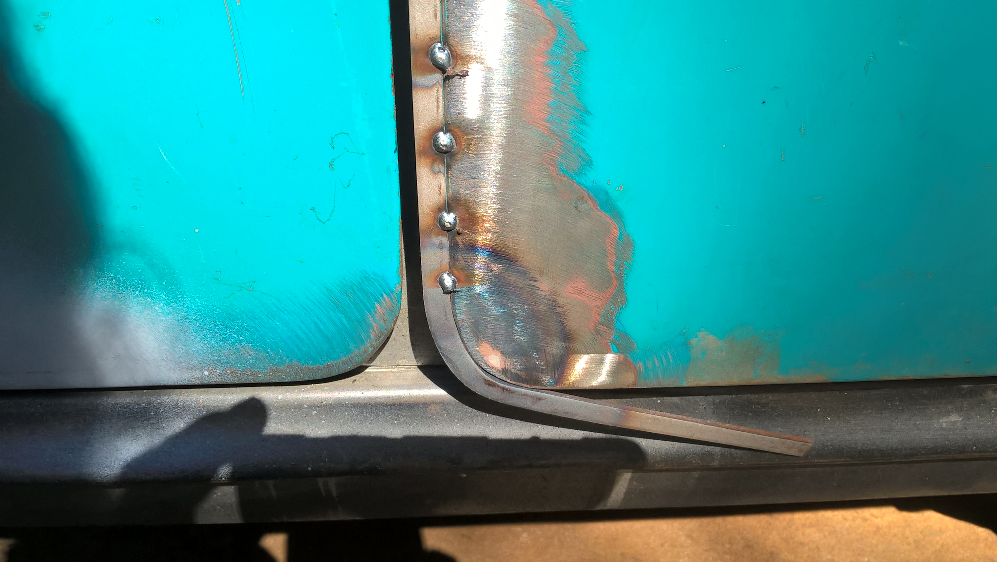

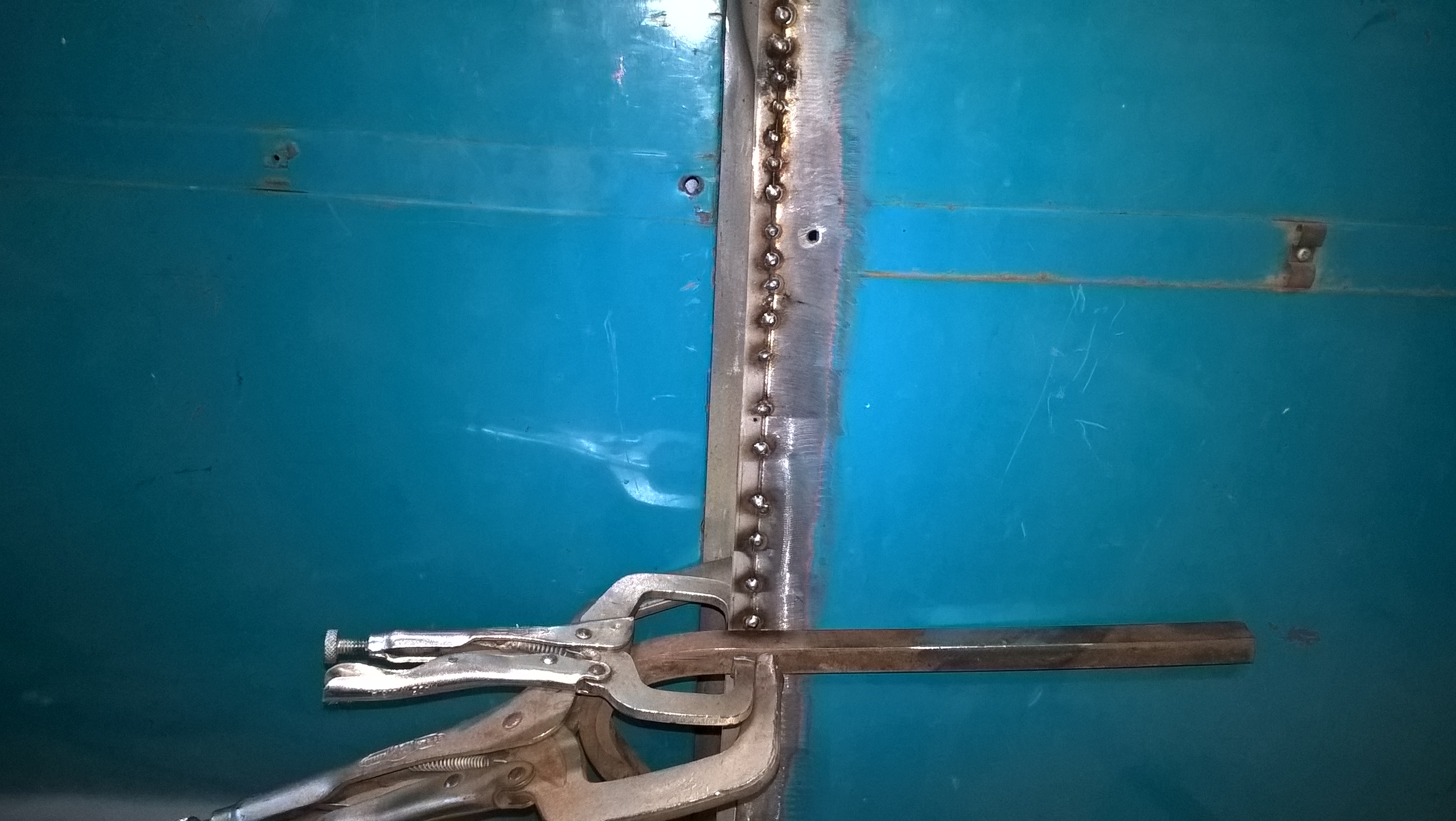

So what seems to be way to much time spent on door gaps, I'm almost finished the damn things !
My wife goes what have you done all day ? I look at her with disbelief !! Look at the doors and the alignment, she goes look where !!!! :roll: :roll: :roll:
Anyway hours of fun to be had fixing door gaps on an EK holden what can I say.
I had to cut the rear window frame down and extend the front frame, 1mm makes all the difference.
I also started the front guard, originally I thought it may have been damaged in a prang and the sub frame was out but after looking at the pressing on this particular guard it is easy to see where its just not quite right, anyway chop chop weld weld grind grind !!

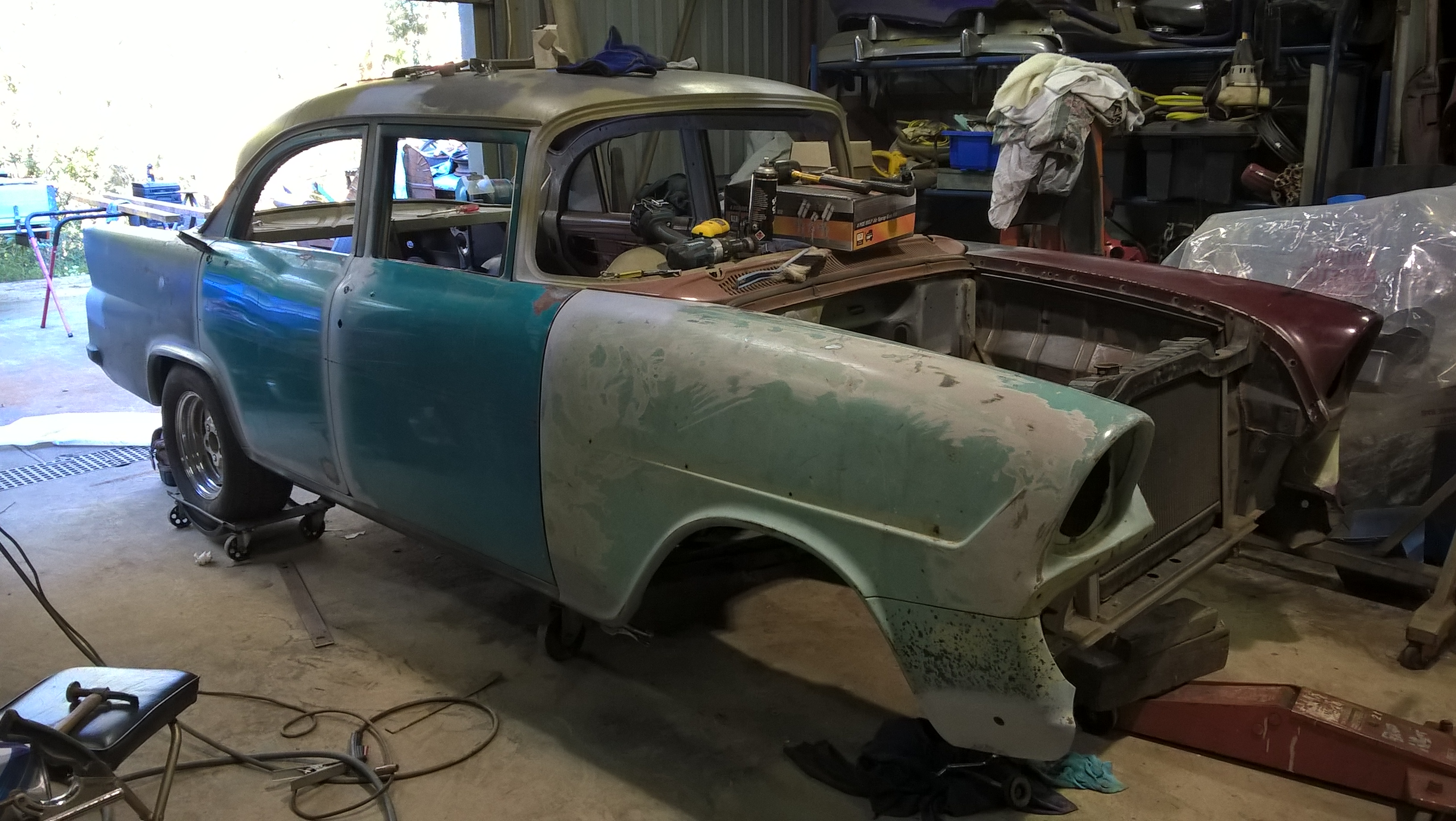

A bit more done today, the last panel I need to check is the bonnet and then that's it !!!!
So I did the front guard gapping ( you all know how much I love doing this )
I'm really not sure what way to go yet , run back and forth 80k's to the nearest spray booth or bite the bullet and build a temp one as I do have the room.
Anyway enjoy
