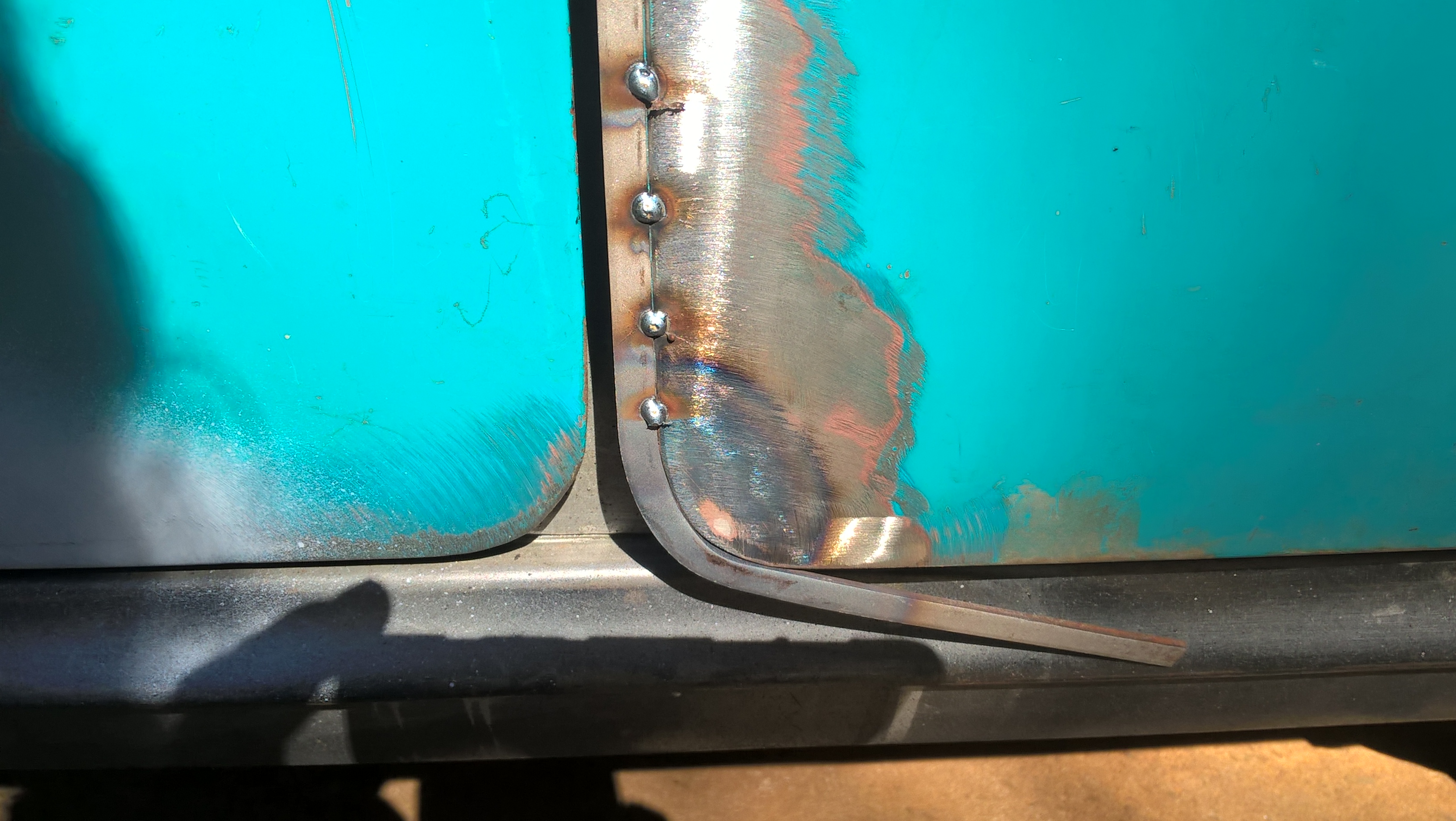

Well another cold day and I didn't start till about 11am (soft).
Got a bit done
Finished the top of the drivers guard today
Tacked in then ground back
Fully welded then ground back, turned out really good !!
Bottom still to do and the brace needs rebuilding, always tomorrow !!!!

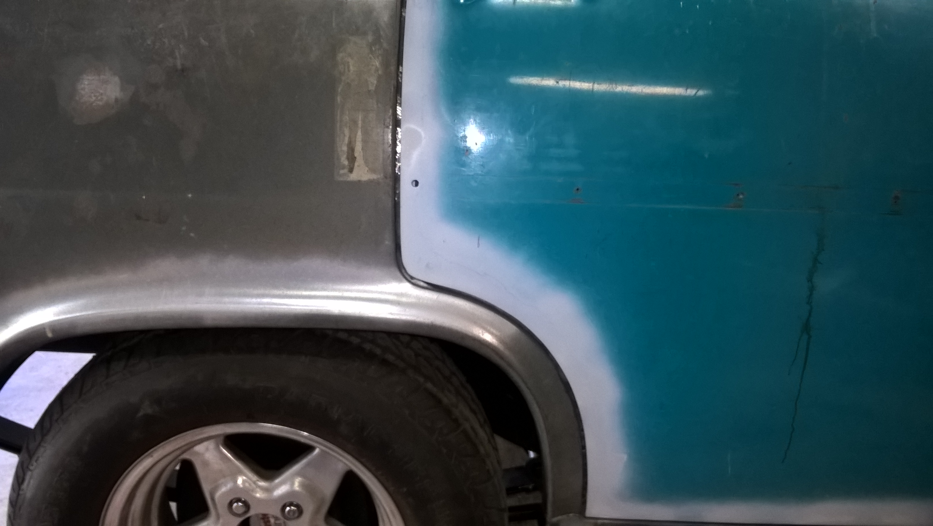

Bloody door gaps !!!!!
I'm just over it at this stage, they are the worst car for alignment of the doors, some fit and some don't !!!
Anyway the last of the body work, one more fit up and then start thinking of getting the spray gun out.

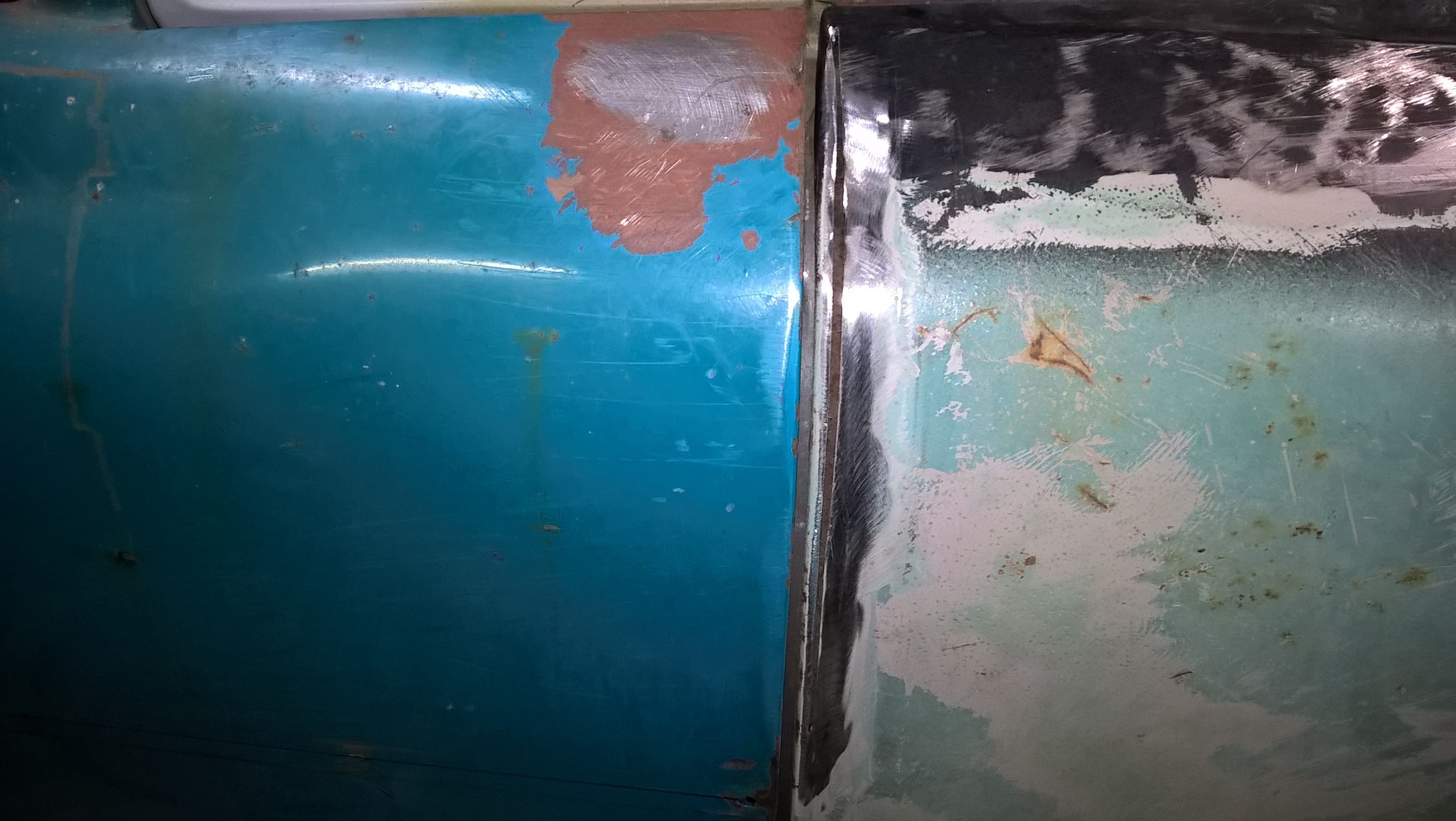

Posts: 2709
Re: Chev EK
So what seems to be way to much time spent on door gaps, I'm almost finished the damn things !
My wife goes what have you done all day ? I look at her with disbelief !! Look at the doors and the alignment, she goes look where !!!! :roll: :roll: :roll:
Anyway hours of fun to be had fixing door gaps on an EK holden what can I say.
I had to cut the rear window frame down and extend the front frame, 1mm makes all the difference.
I also started the front guard, originally I thought it may have been damaged in a prang and the sub frame was out but after looking at the pressing on this particular guard it is easy to see where its just not quite right, anyway chop chop weld weld grind grind !!

Re: Chev EK
Post by Rusty EK »
Gee Greg that back door gap still looks a bit crook , you're not going to leave it like that are you , just kidding , paint it already :)
