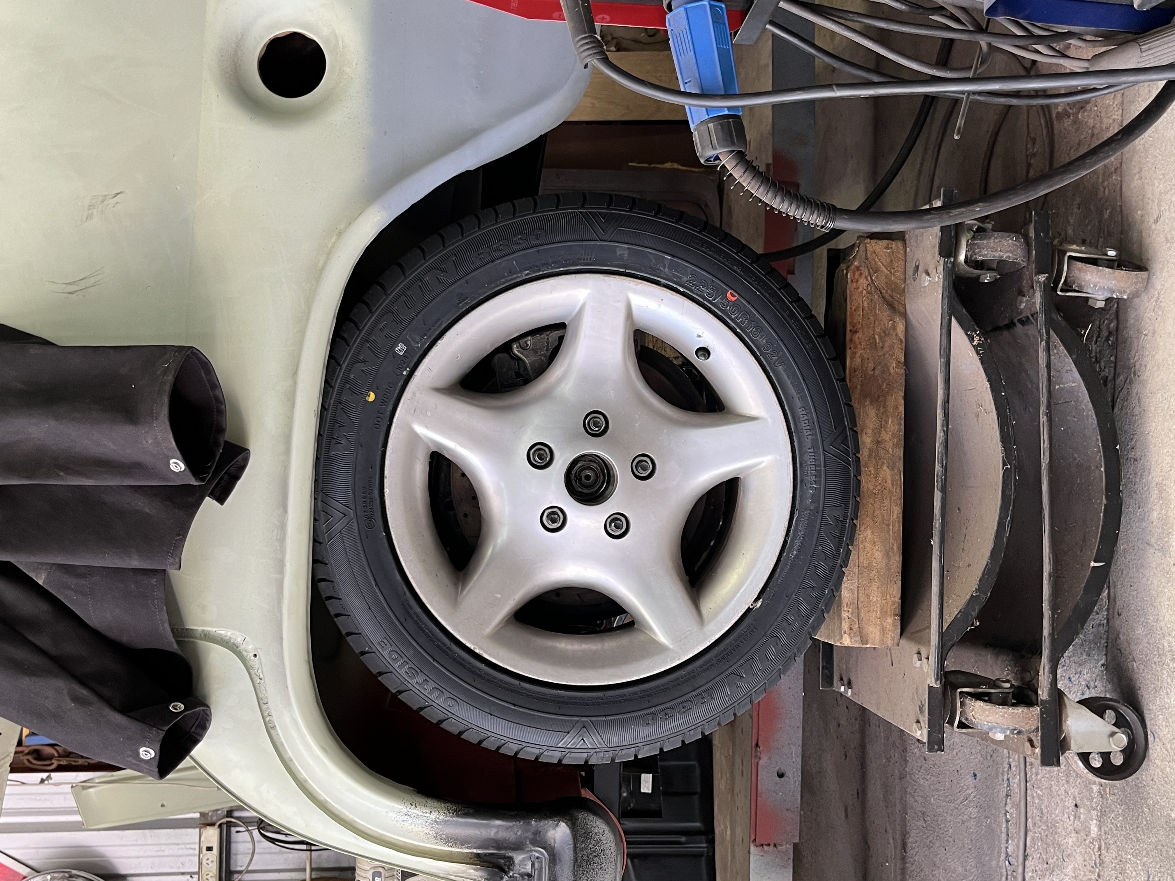

So after fixing other vehicles on the weekend :roll: :roll: I lowered the wagon down to put some weight on the rear end.
Definitely going to have to roll the lip if I want to put the 225's under there and maybe even a bit of the outer inner wheel well (if that makes sense) :lol: either that or go with a 205 maybe :thumbsdown:
Measured the coilover and they are at 280 mm, instruction say to set them at 260 mm, so not having dealt with coilovers before I am assuming that I take pressure off of the spring to allow the shock to compress more :eh: :eh: assistance from the brains trust please.

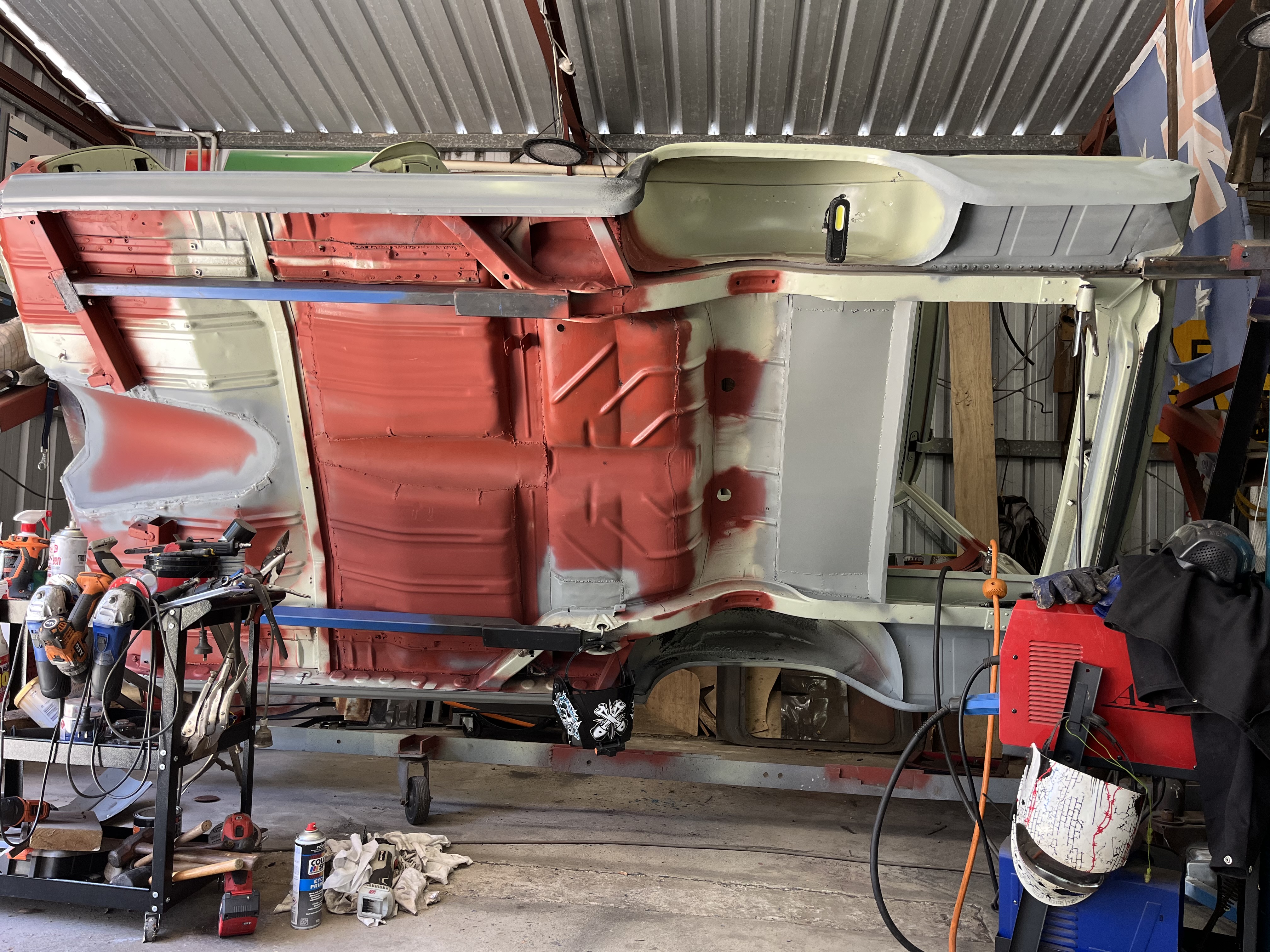

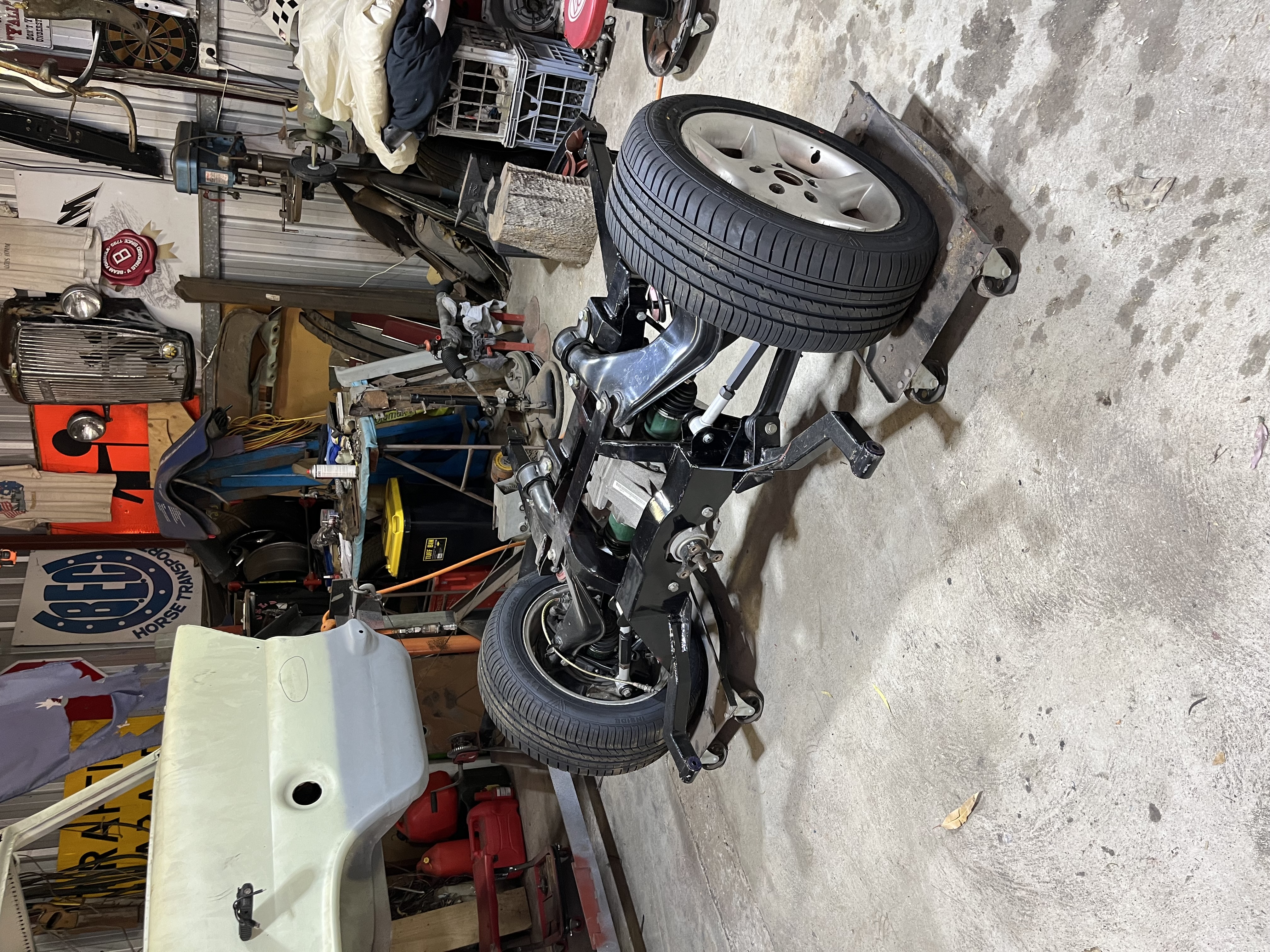

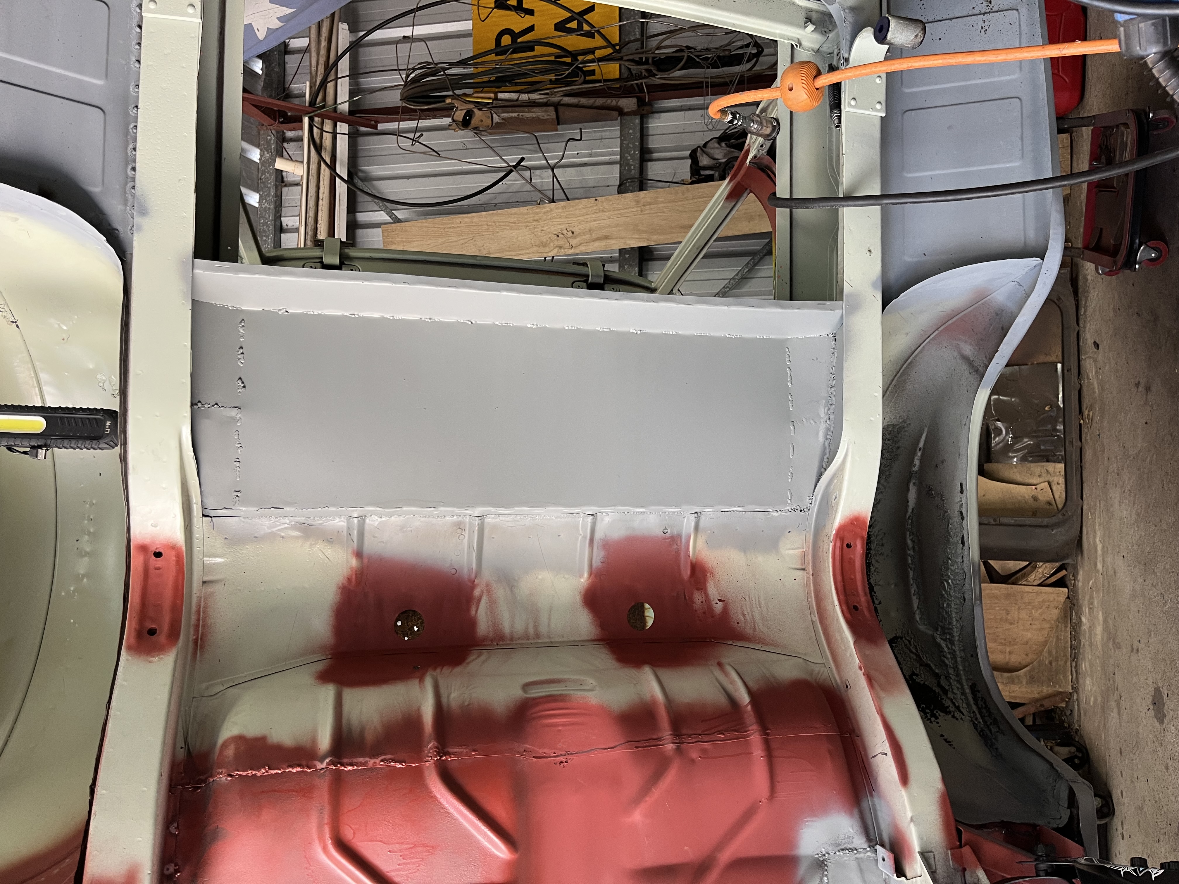

Sooooo :crazy: rear end out again :roll:
Finished off the weld in of the plate that gives clearance for the suspension cradle.
You can see in this photo how much of the floor area I have replaced, sometimes wonder if I should have cut the whole thing out and started again, wish somebody would make full floor pans like they do in the states :crazy: :crazy: :crazy: :crazy:
