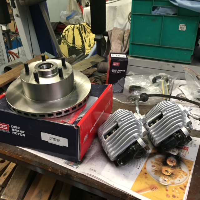

I purchased more jewellery for Anne-Marie. I know will like as they are shiney :lol: :lol:
I even got new pads and calipers painted reassembled.
Just need the spindle nuts to arrive from Stub Tech. They are a 3/4" x 20 TPI :o

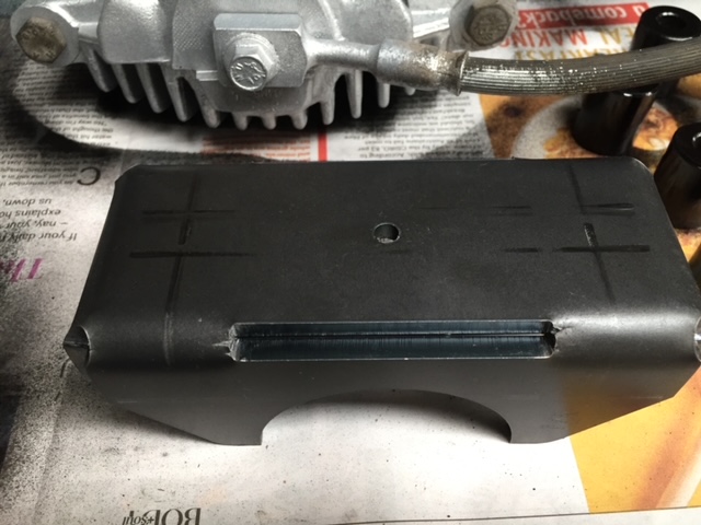

These are the spring saddles I purchased from Kustom Blitz

Laser cut and bent in a brake press all for $54 each. Not sure if I could do this to quality and they match.
Met Gledge at the Willunga Swap meet and he has lent me his diff jig so I can align the axle tubes before welding.

Rotors and callipers look the goods Roger. Even if they aren’t rocket red….

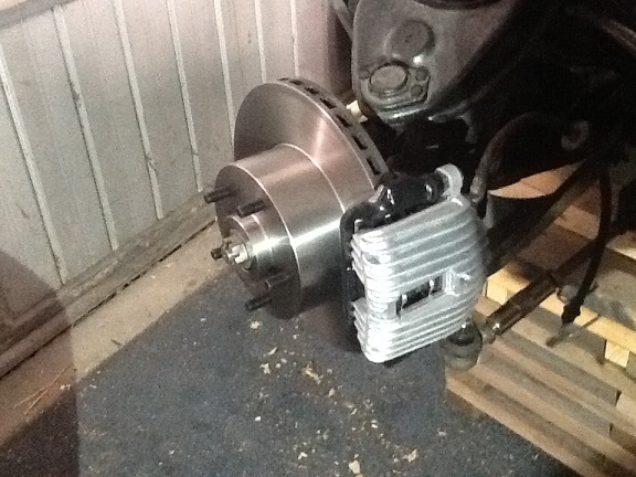

As seems per normal with me on this build, it has taken longer than I thought but front brake set up complete.
Previous purchase on the VN disc were 270 mm which is too small as only 60% of pad in contact with disc.
I did follow FireKraka's upgrade but did not connect the dots as he was using VT.
VN disc.JPG (108.29 KiB) Viewed 3168 times
I'm awaiting a couple of queries on the wheels as this will determine the steering arms and/or the need for spacers.
I have several sets of arms collected over the years.
A 15" wheel clears the caliper just but I would prefer a 16" rim or even a 17" on rear.

They look nice Roger. This is where mixing components gets tricky I suppose but at least it has been done many times before. I don't uppise HD HR ones will fit.
Do you know what you have? Image
