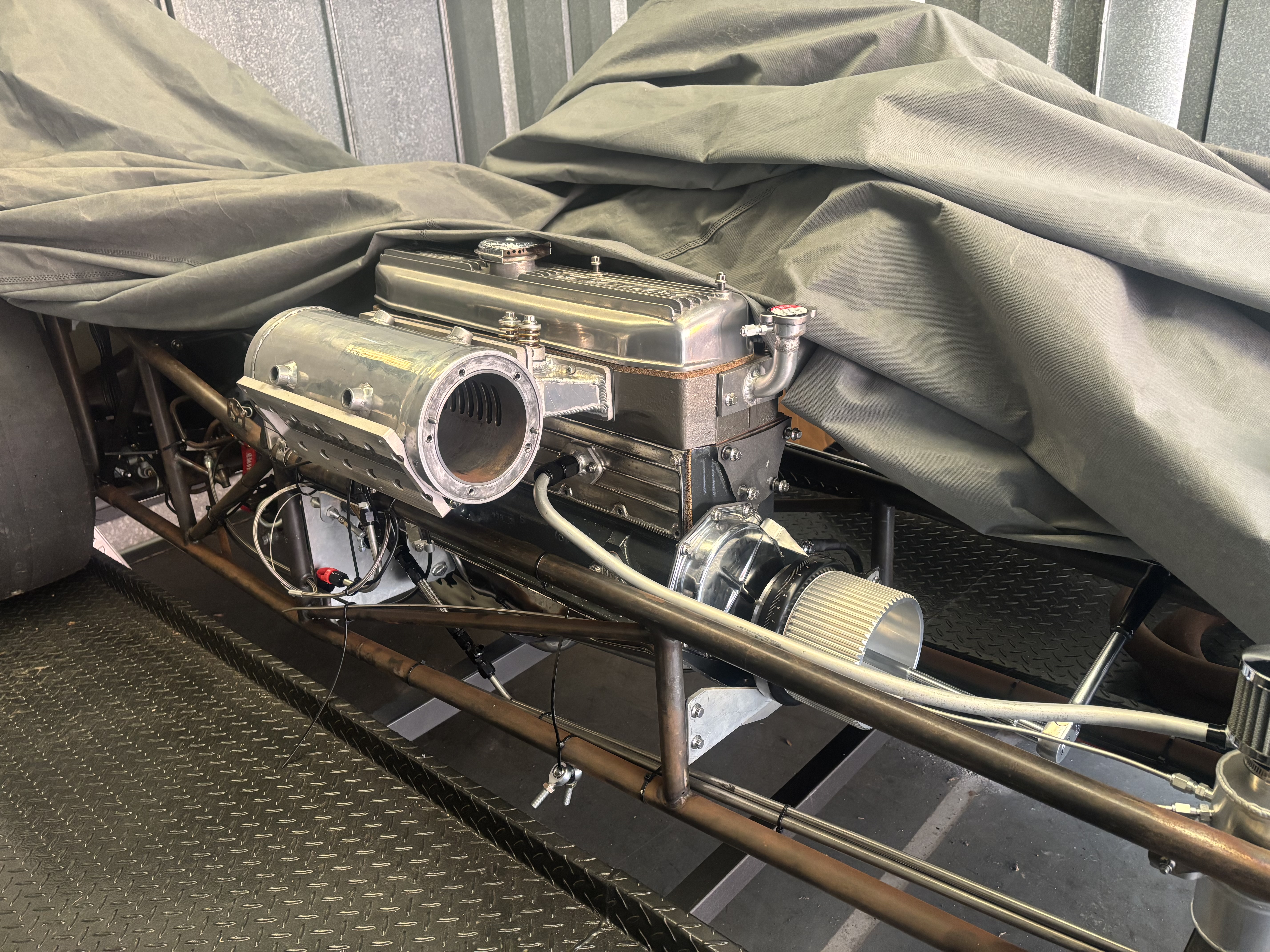

Home again. Plan of attack:
SUs off and put the Norman on so Mr Ramsay can measure up for the snout extension:
Once that’s done, head off and clearance for the pushrods.

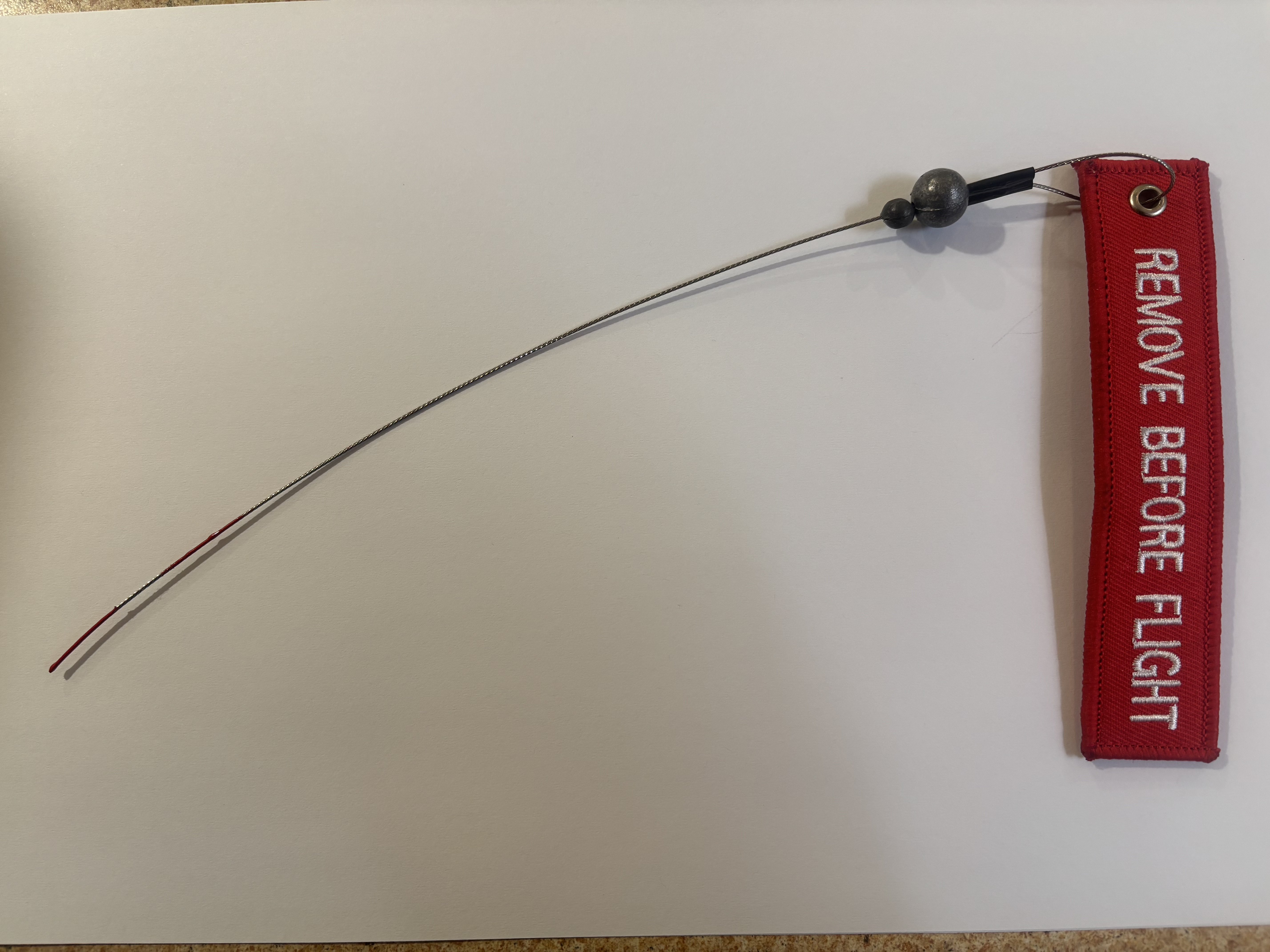

In the mean time, I figured I'd do something useful, and give it it's first fill of oil. 4-odd litres of Helix's finest, and nothing came out the bottom. Happy days. Realised that the dipstick is never going to go back in again with the magneto in place, so made up a flexible one similar to Lokar's versions using some fishing wire lead/trace. Looks good, pack up tools.

Random photo of the flexible oil dipstick to let me get in under the various stuff that now lives under the inlet manifold. When it’s not in use, the dipstick hole in the block has a 1/8NPT plug in it. Fun fact: the dipstick hole is almost perfect diameter to tap to 1/8NPT. No need to drill first.

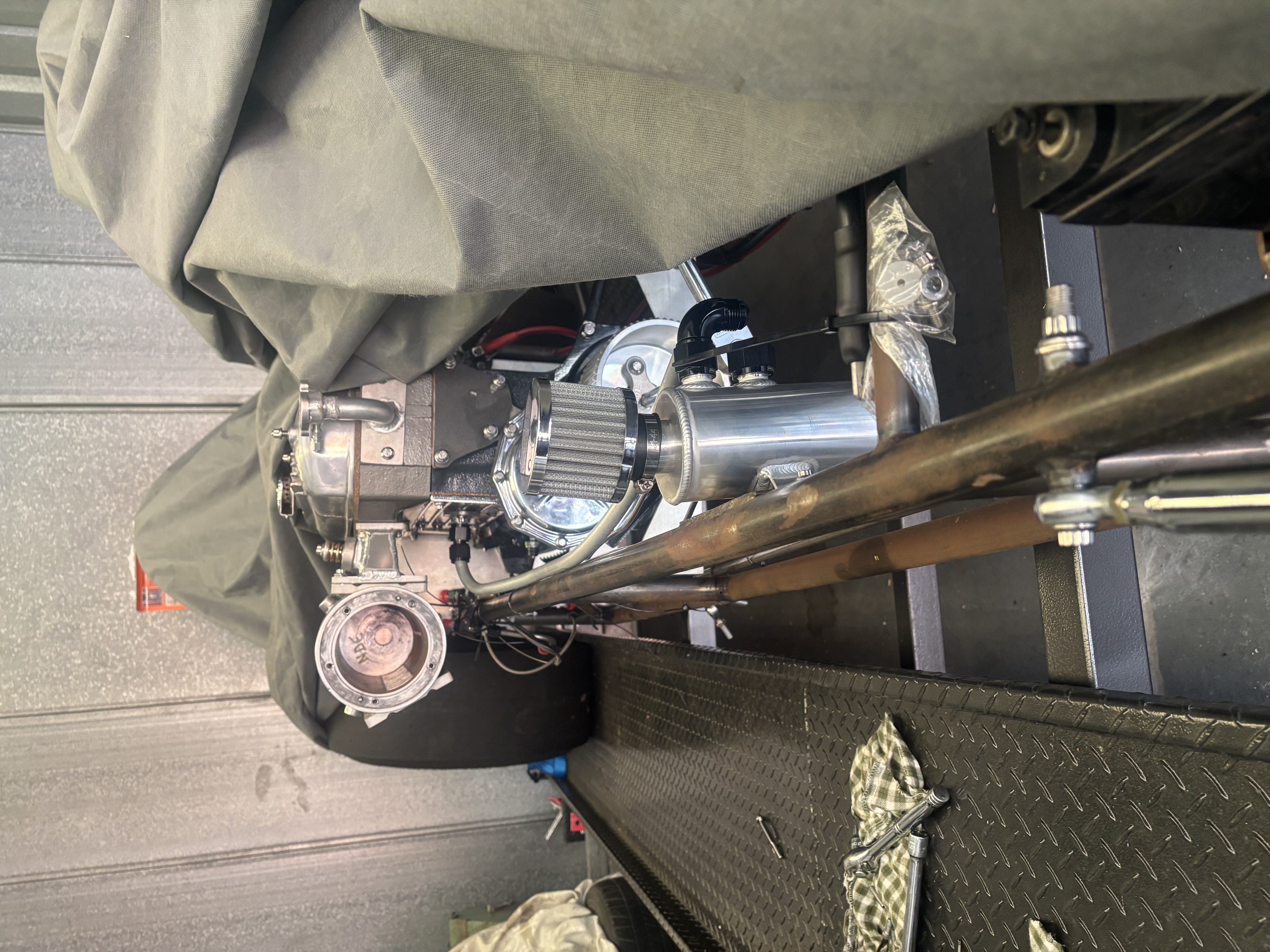

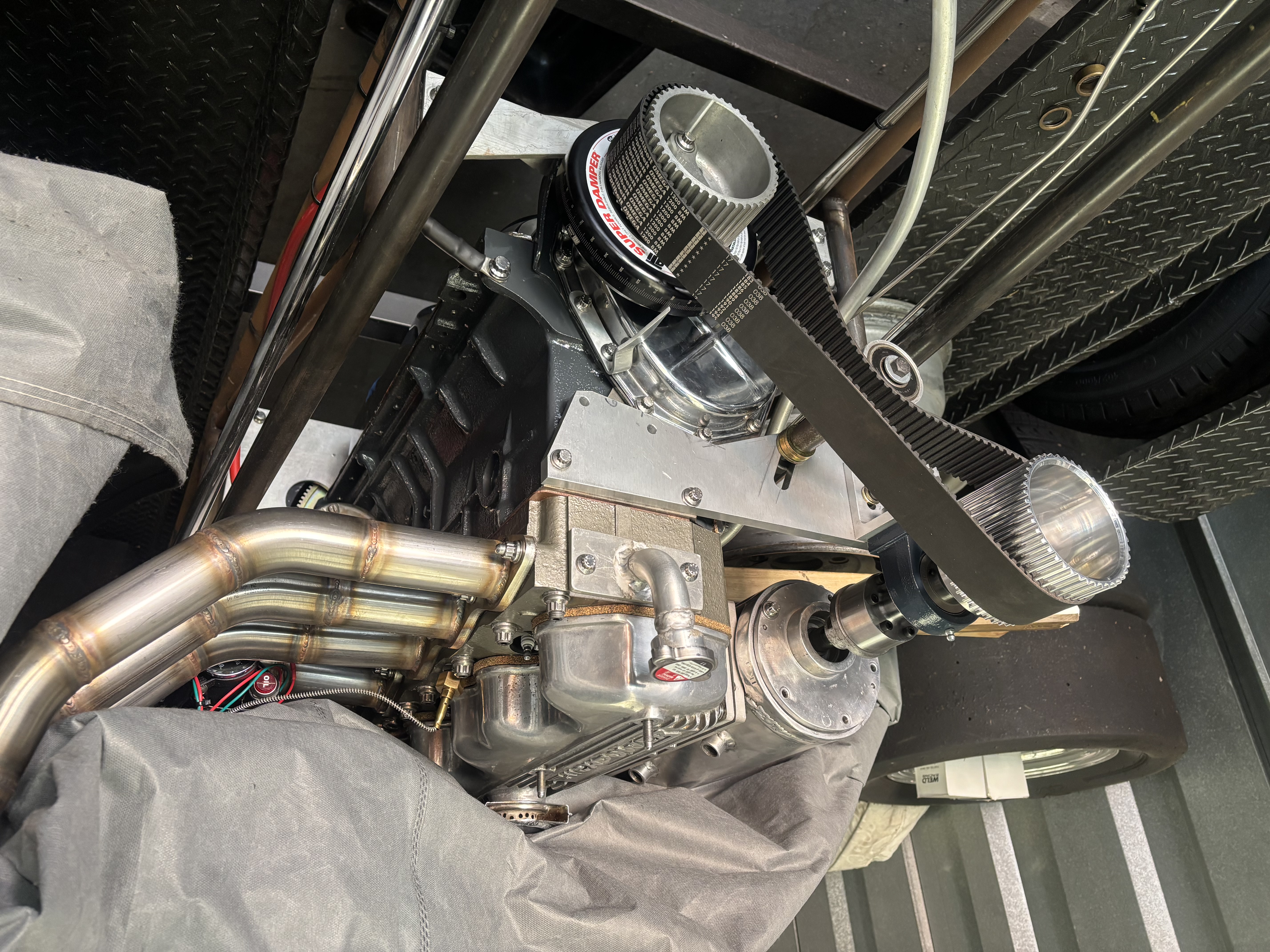

Dummy up for the supercharger snout support
Re: Harv's FED thread
Posted: Fri Nov 07, 2025 3:28 pm
Sexy 8) 8)
Is there room in there for a second pillow block to take any side load off the Norman driveshaft ??

The ball bearing block should take up a lot of the side load, though you are right, it will turn the shaft into a lever. The Norman bearings will take the remaining load... probably no worse than an original setup.
What does worry me though is the heavy steel rotor trying to tear the manifold off the engine. I need to fit some form of brace under the casing, back down to the chassis to provide vertical support. In true bogan style, the supercharger is currently supported on two Sampson rims and a block of timber :mrgreen:
