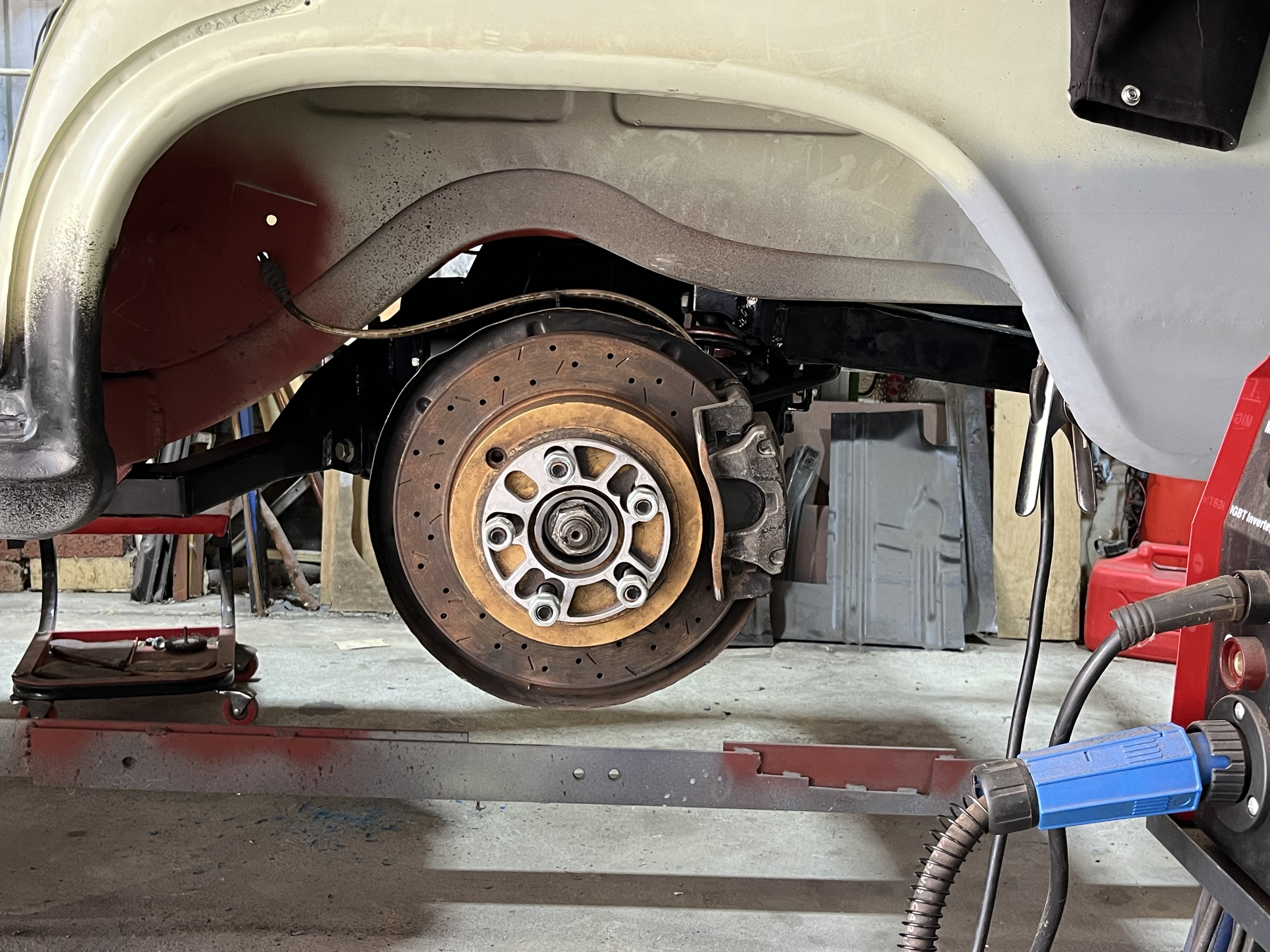

Finished the passenger side bottom of the dog leg on Sunday
Now I need to weld in the clearance plate for the independent rear suspension so I have moved the suspension under the back end, get it into the hangers then I can make sure I have enough clearance and also check tyre clearance.
It isn't in the hangers yet that's why it doesn't look centered under the diff hump :roll:

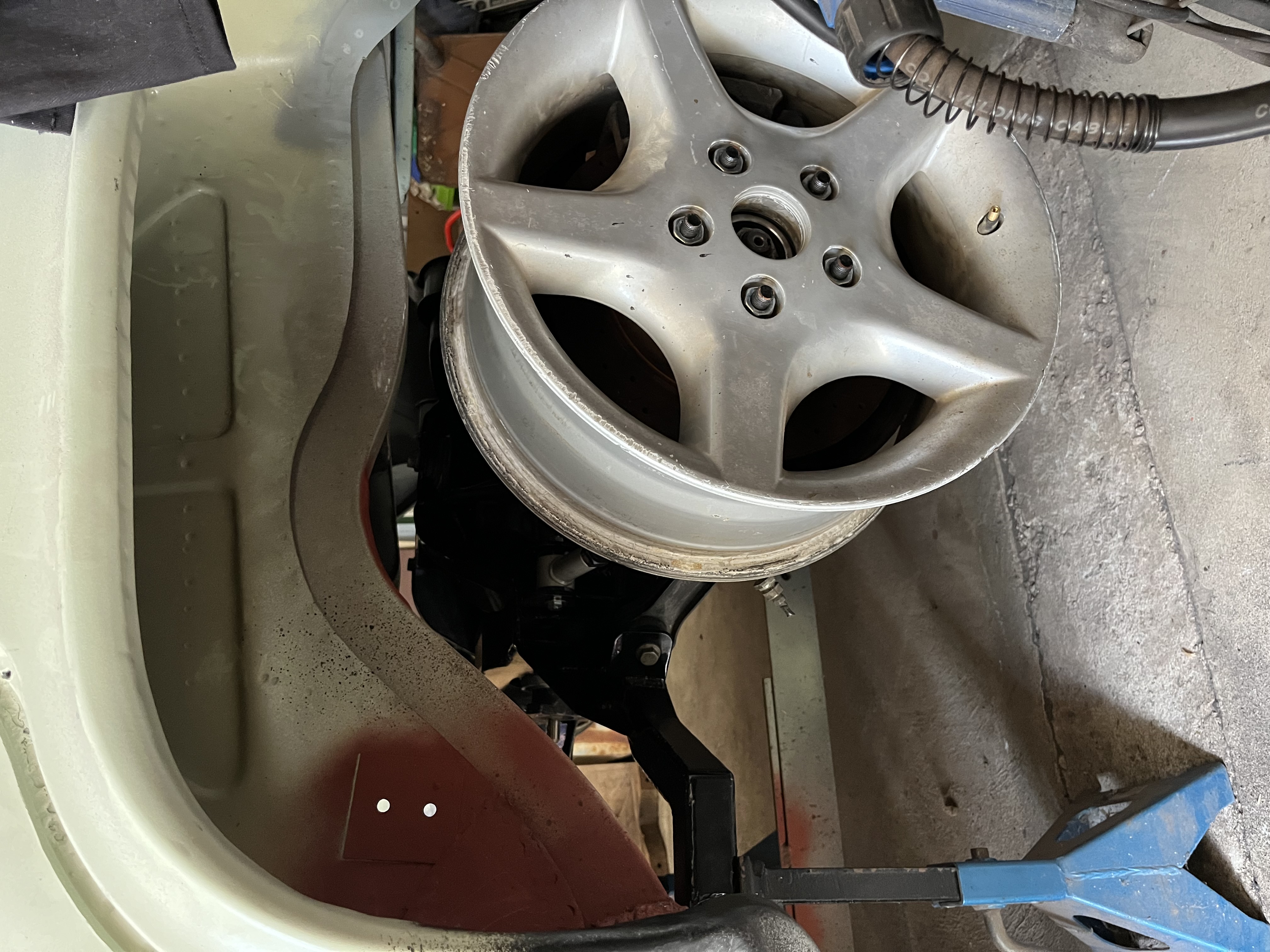

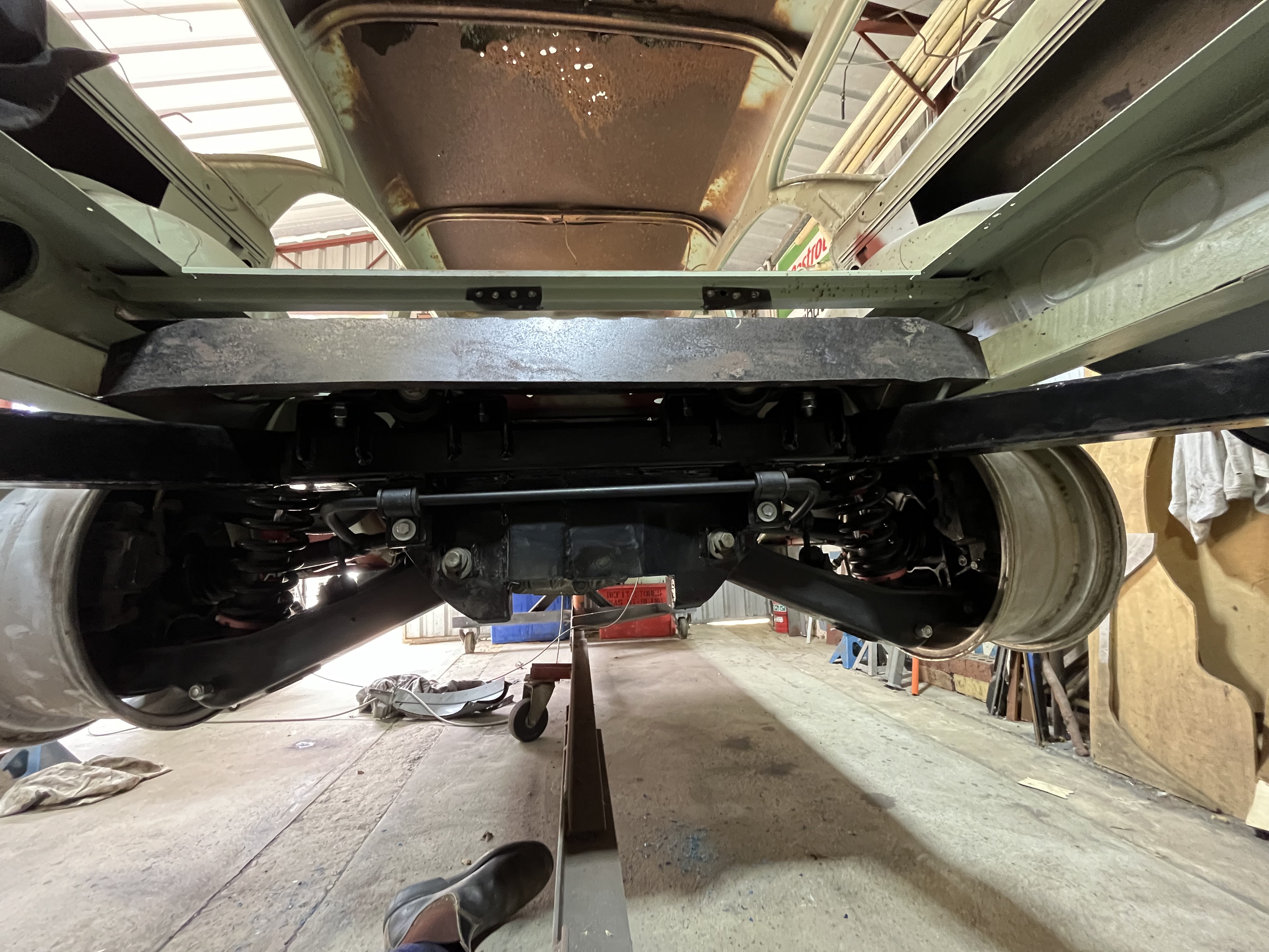

Posted: Sat Nov 09, 2024 10:35 pm
by FireKraka
After struggling with a couple of jacks and some strong words I was able to get the rear end into the wagon, I have room around the suspension so will be able to weld the plate in.
Wheels are in the centre of the wheel arch
Once I get some tyres on it I can lower it onto the ground and set the shock height.

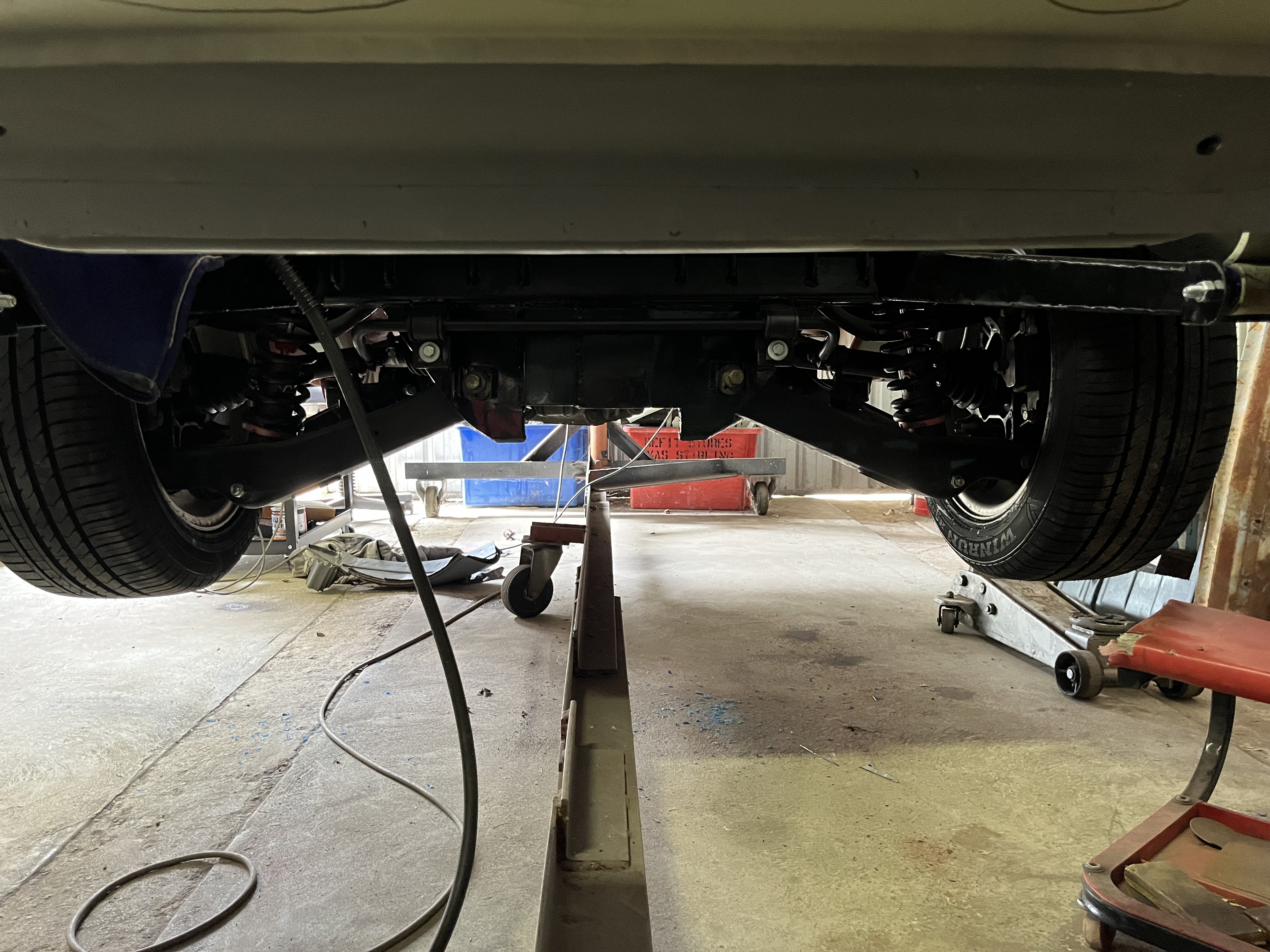

by FireKraka
Looking at tyre spacing had a couple of 225/50/16’s fitted to rims and put them on this afternoon when I got home, have room but may need to roll the wheel arch a little.
Obviously it is not on the ground yet, have set the coil over shock height once I have weight on it but pretty happy with it at the moment. :esmile:
Re: Neil's FB Station Wagon
Posted: Fri Nov 15, 2024 8:08 pm
can ya pull the coilovers out and put a jack under the tyre to get it up into the wheel tub ?
