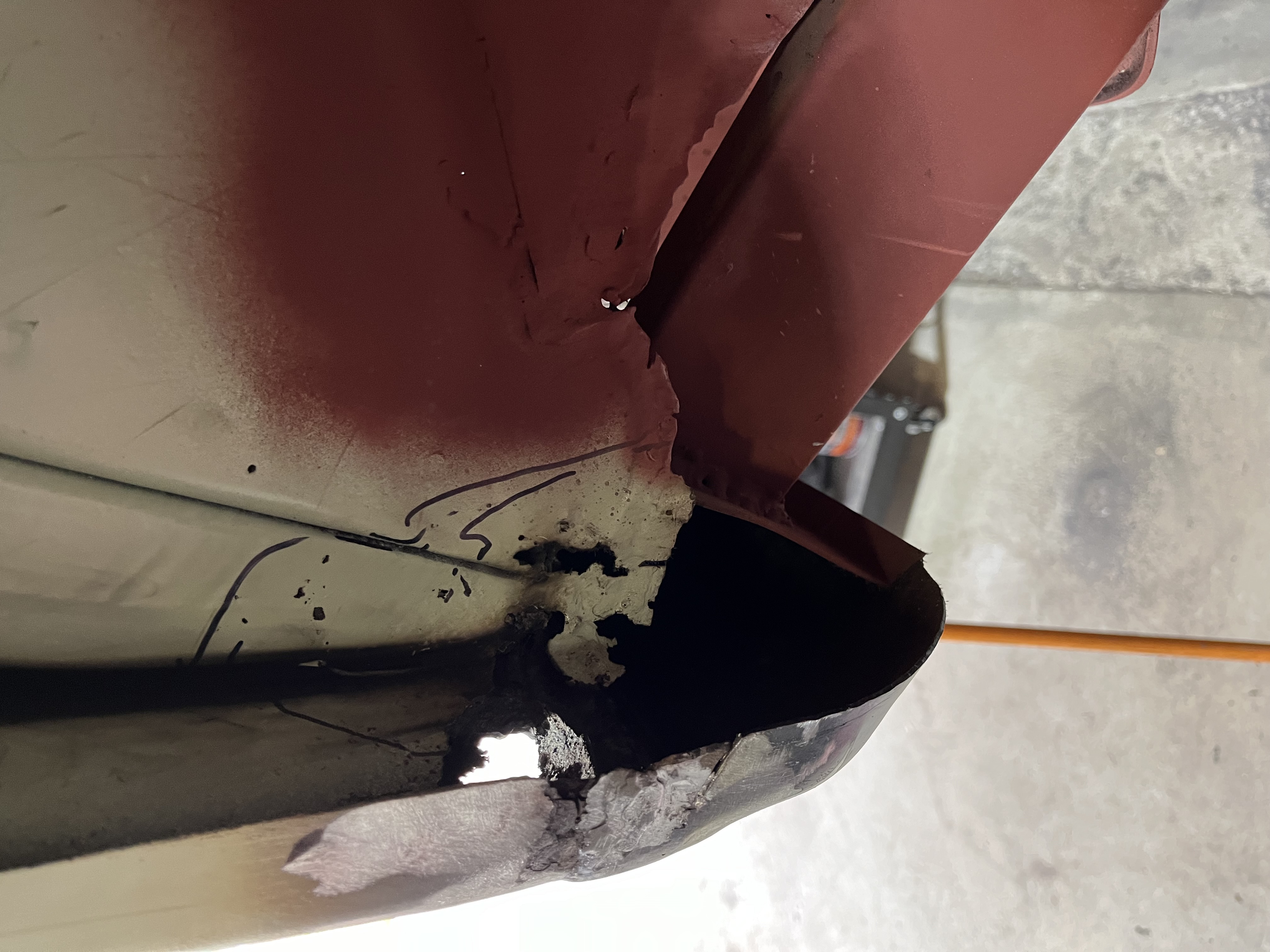

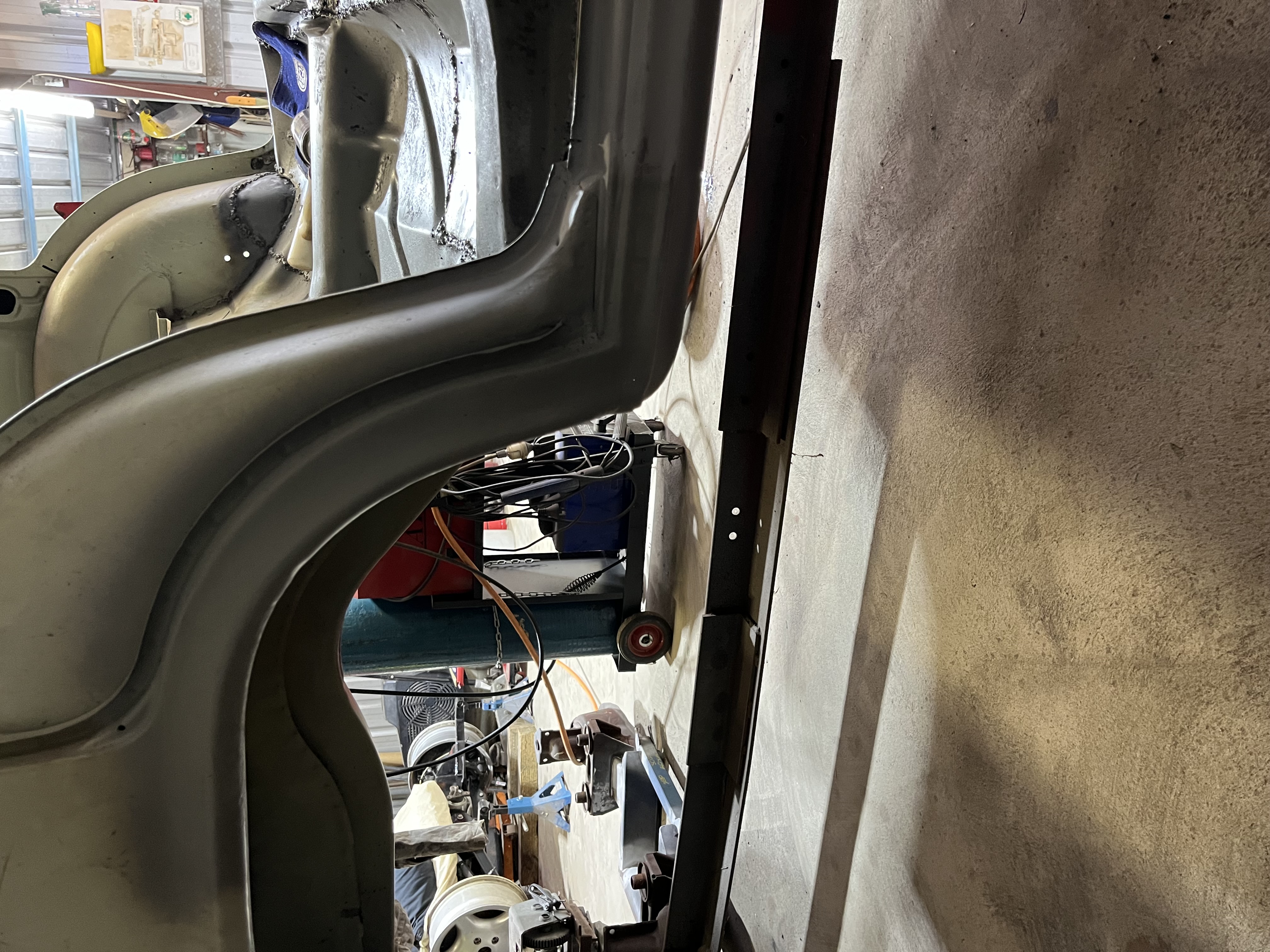

So a little time in the shed yesterday after assembling a small shed for the mother in law on Saturday :ebiggrin:
Driver dog leg finally finished, had to do another small repair inside the wheel well in behind the dog leg, tidied it up some and then moved over to the other horror show, melted the lead out of it and will attack it next. :roll: :roll:

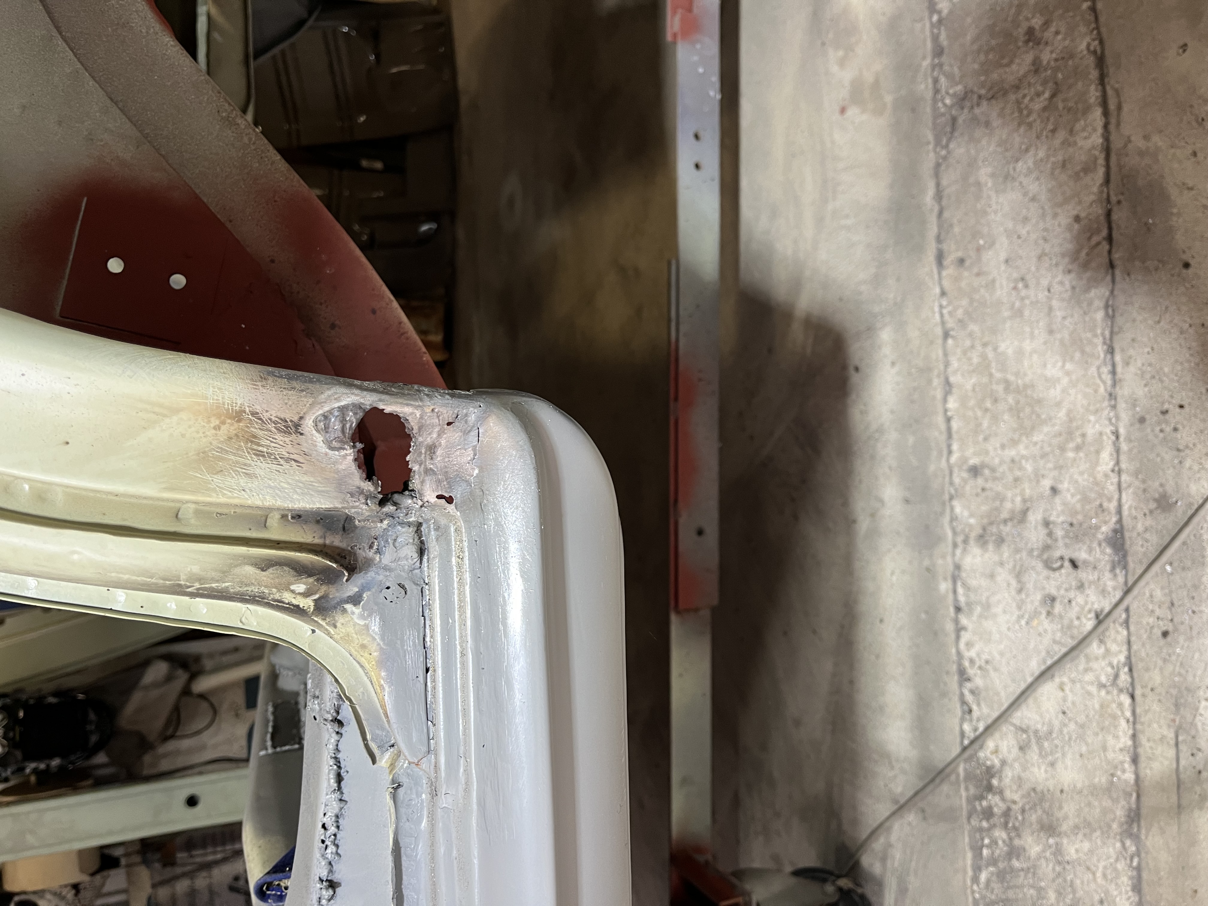

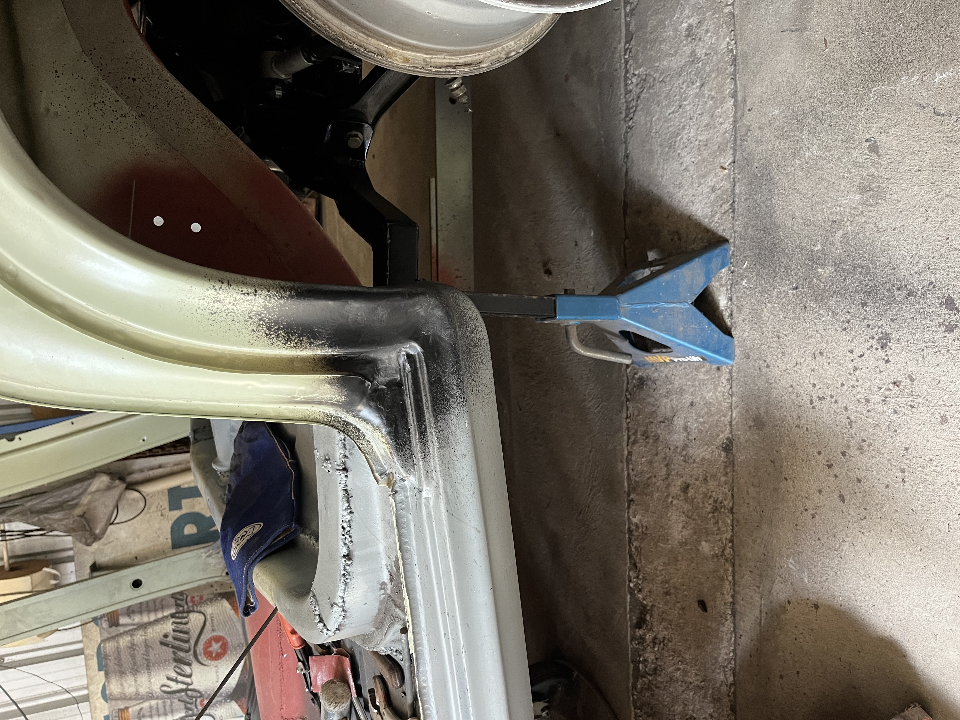

Got a bit of time yesterday on the passenger side dog leg, think I have all the big patches in, bit more of a clean up inside the wheel arch and have to chase some pin holes.

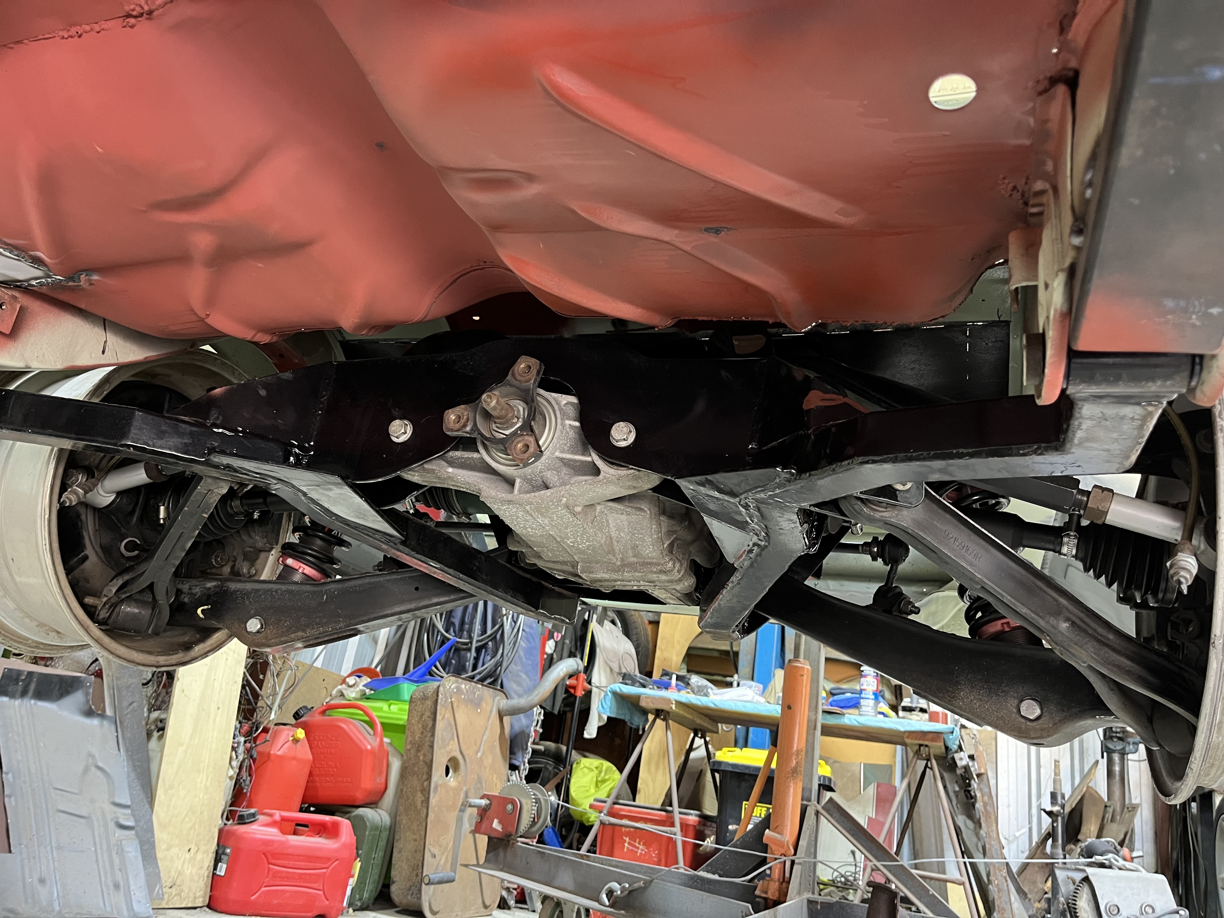

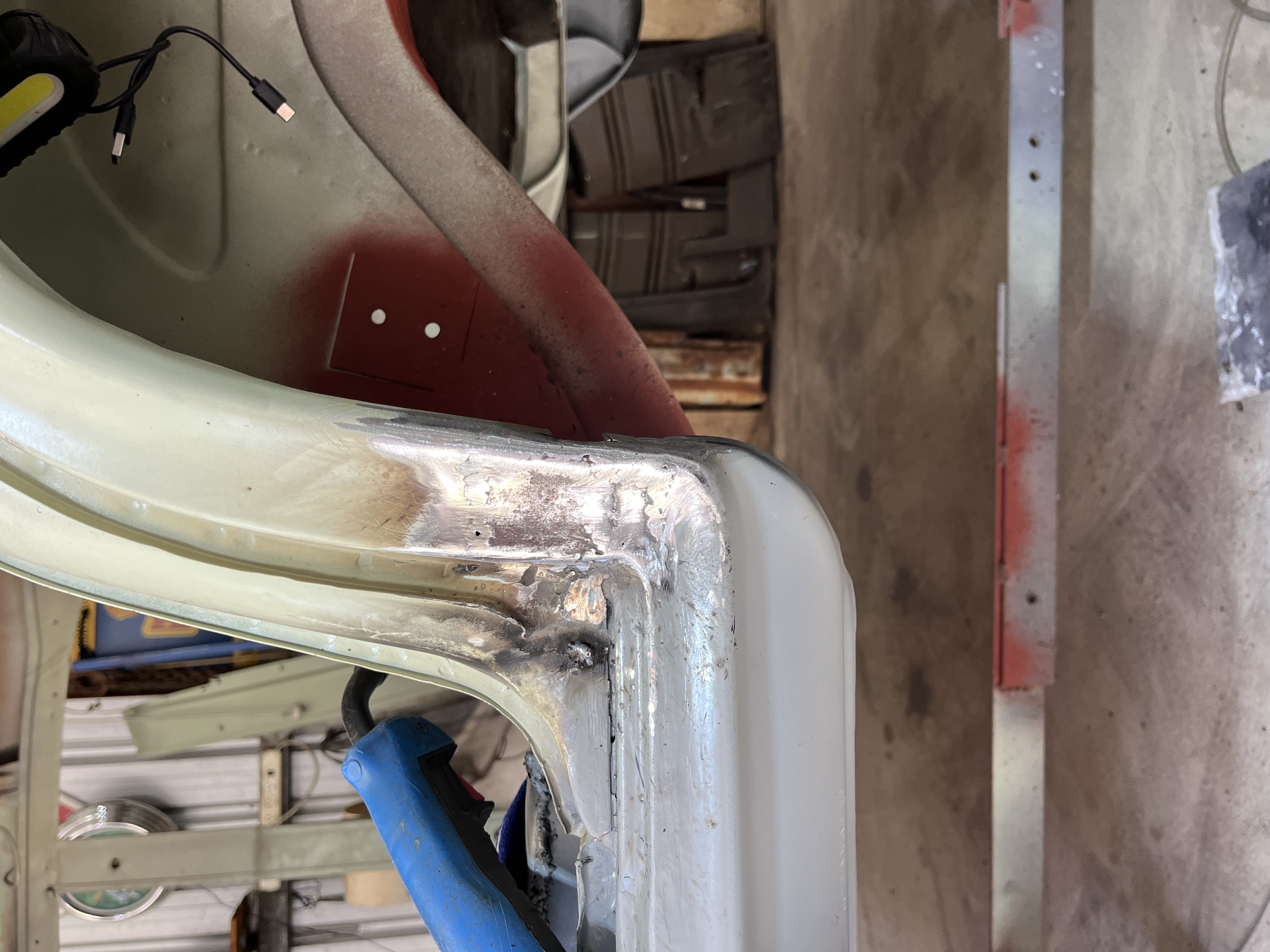

Finished the passenger side bottom of the dog leg on Sunday

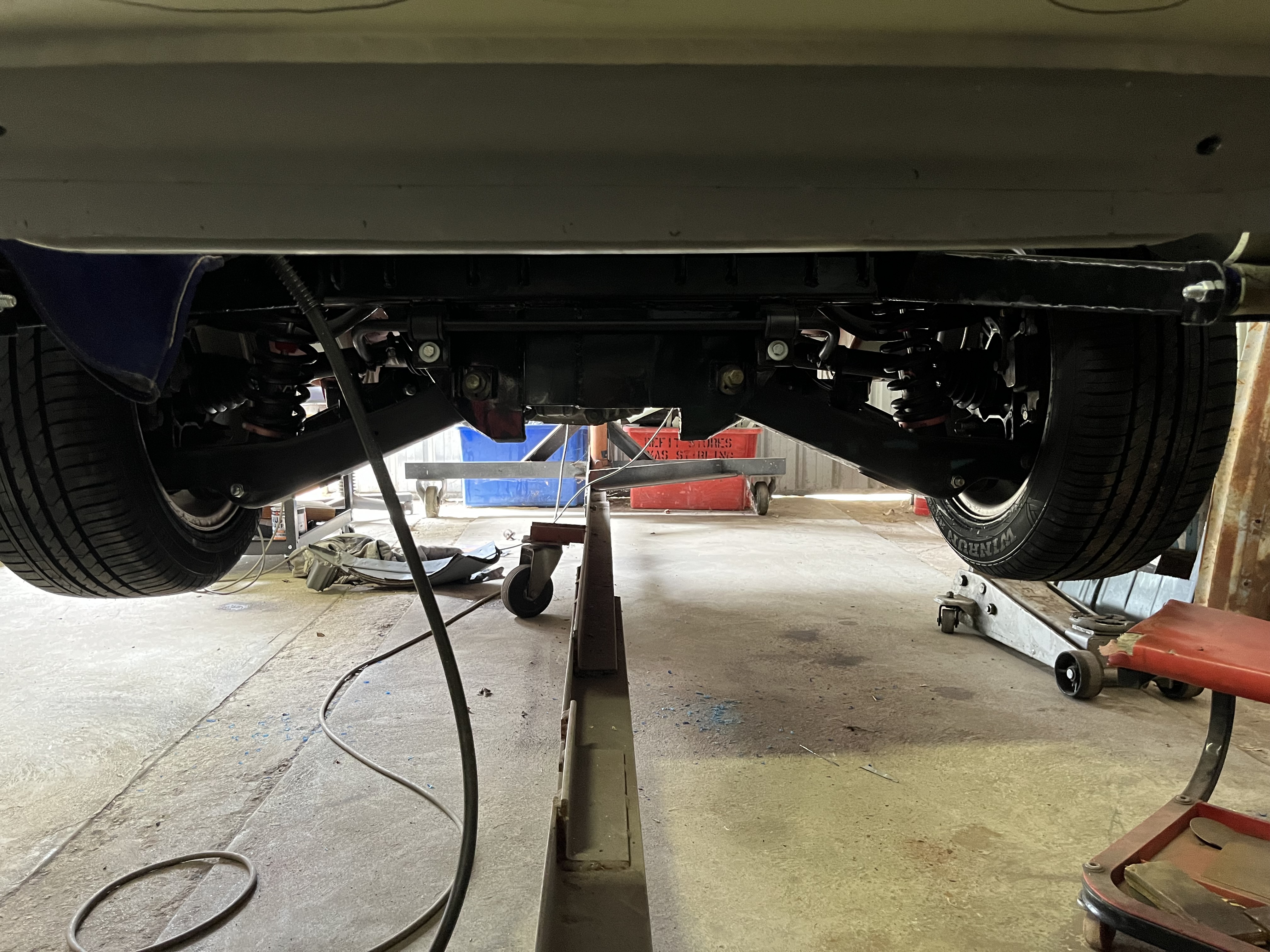

Now I need to weld in the clearance plate for the independent rear suspension so I have moved the suspension under the back end, get it into the hangers then I can make sure I have enough clearance and also check tyre clearance.
It isn't in the hangers yet that's why it doesn't look centered under the diff hump :roll:

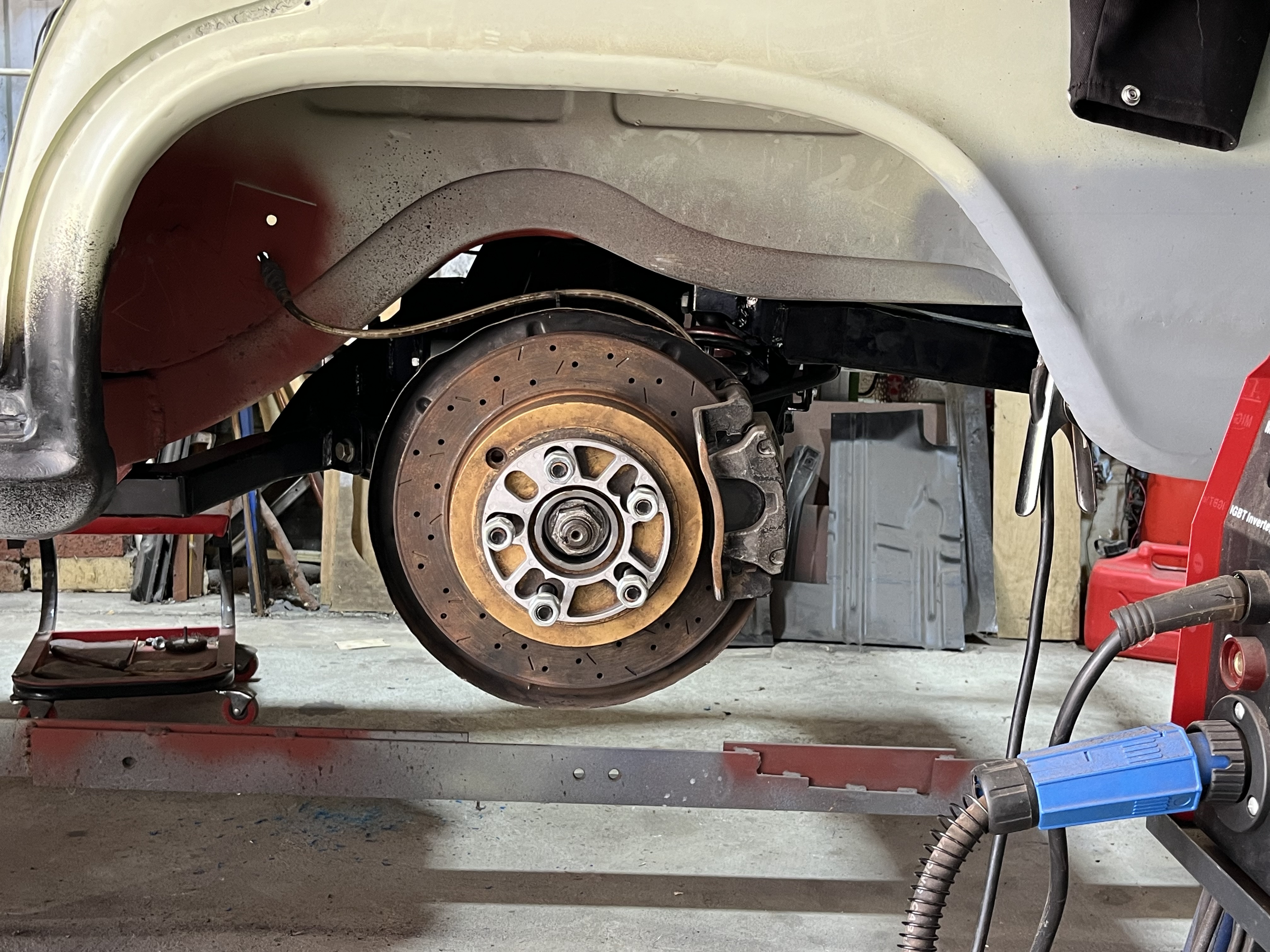

After struggling with a couple of jacks and some strong words I was able to get the rear end into the wagon, I have room around the suspension so will be able to weld the plate in.
Wheels are in the centre of the wheel arch
Once I get some tyres on it I can lower it onto the ground and set the shock height.

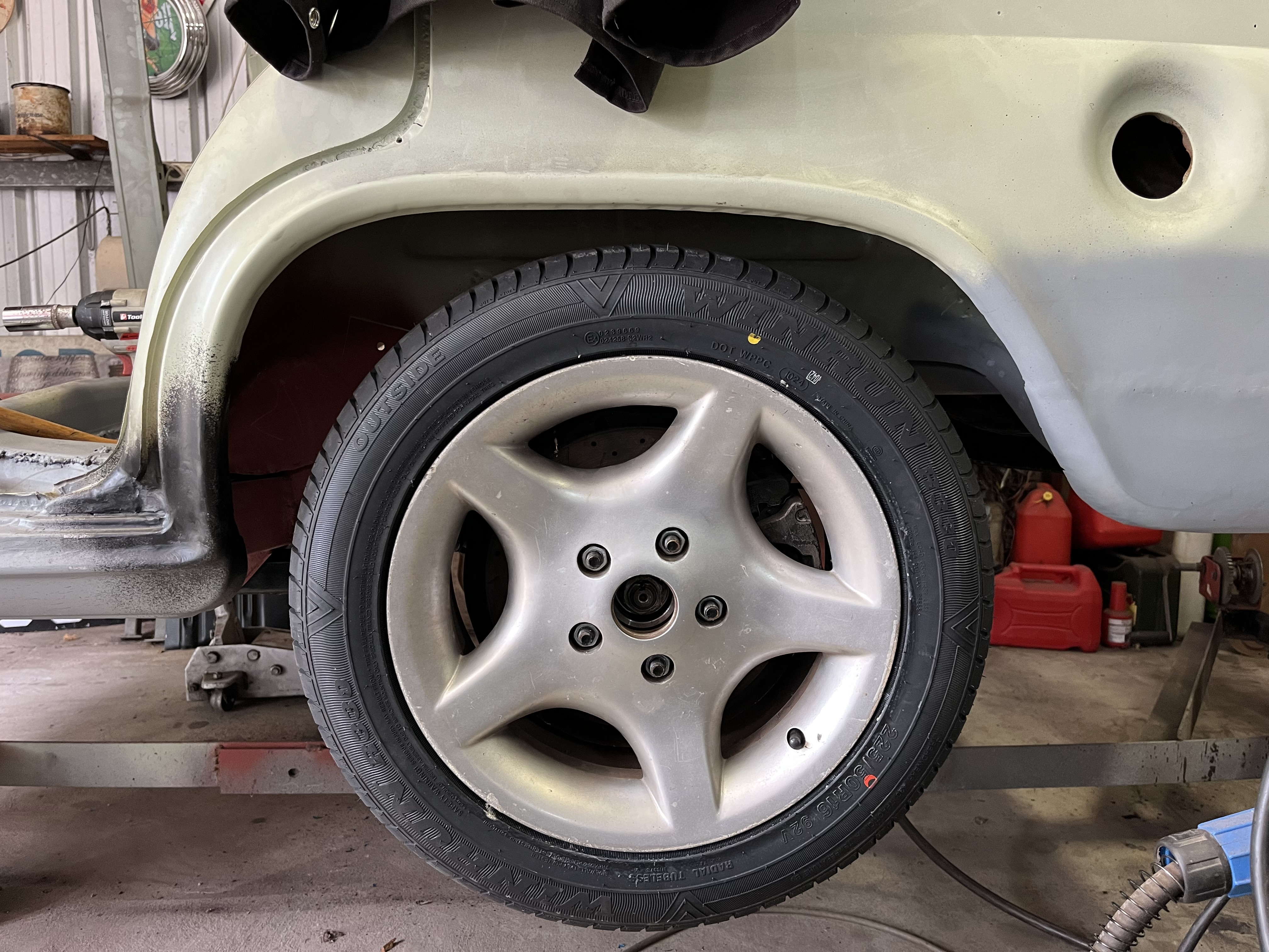

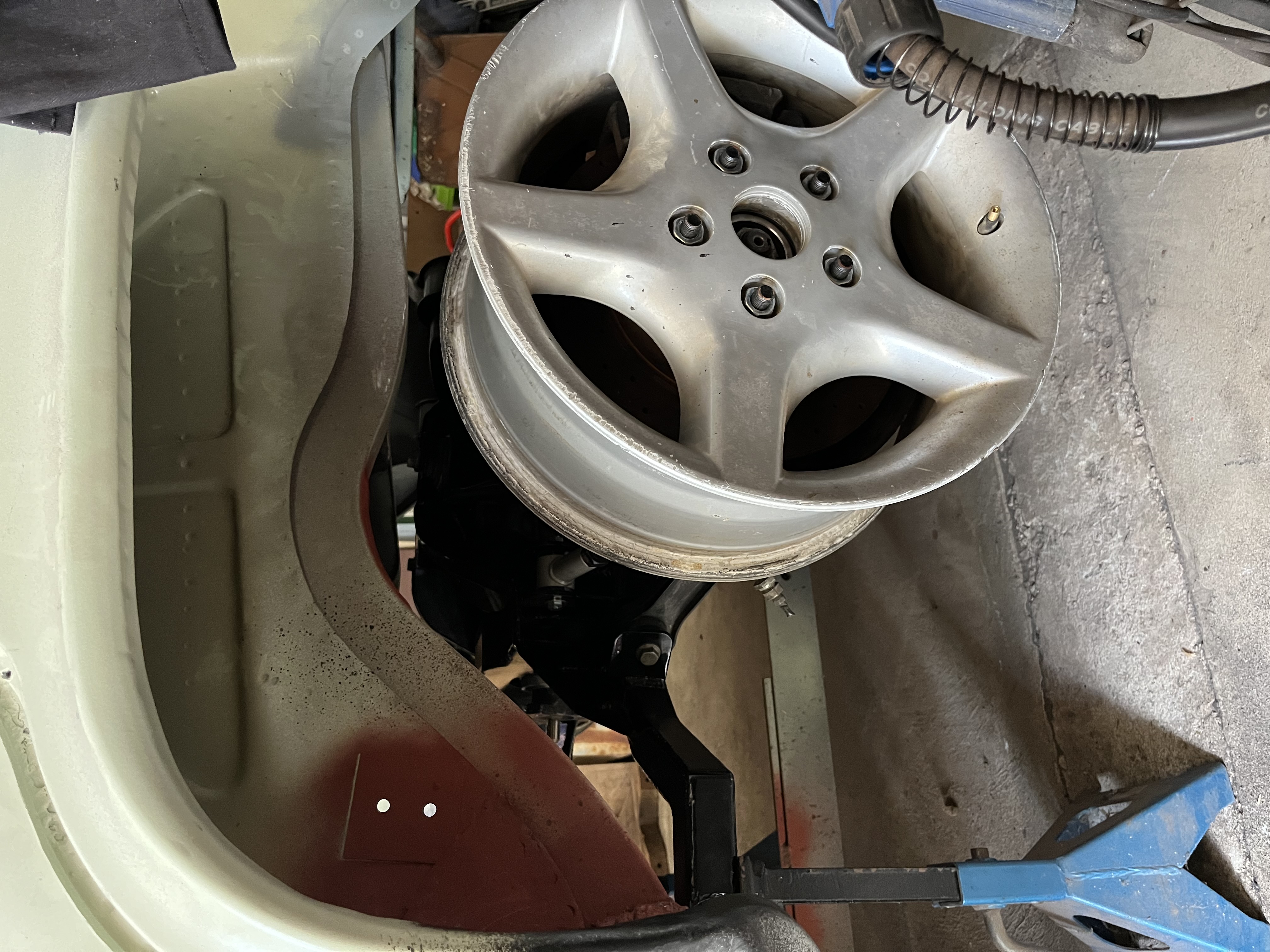

Looking at tyre spacing had a couple of 225/50/16’s fitted to rims and put them on this afternoon when I got home, have room but may need to roll the wheel arch a little.
Obviously it is not on the ground yet, have set the coil over shock height once I have weight on it but pretty happy with it at the moment. :esmile:

can ya pull the coilovers out and put a jack under the tyre to get it up into the wheel tub ?
