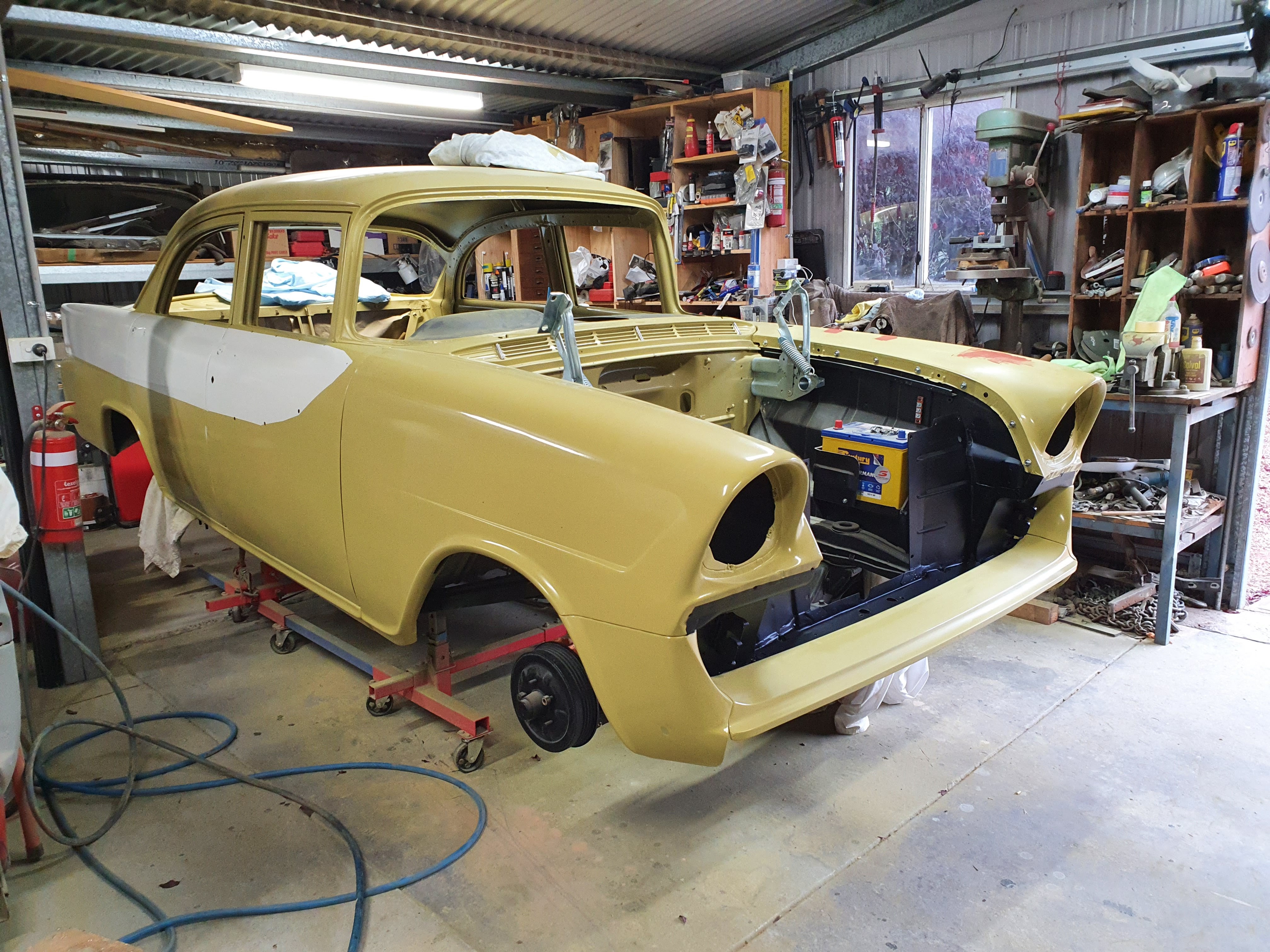

Lots of panel adjustments and tidy-ups yet to do but something that looks like a car to paint now. Image

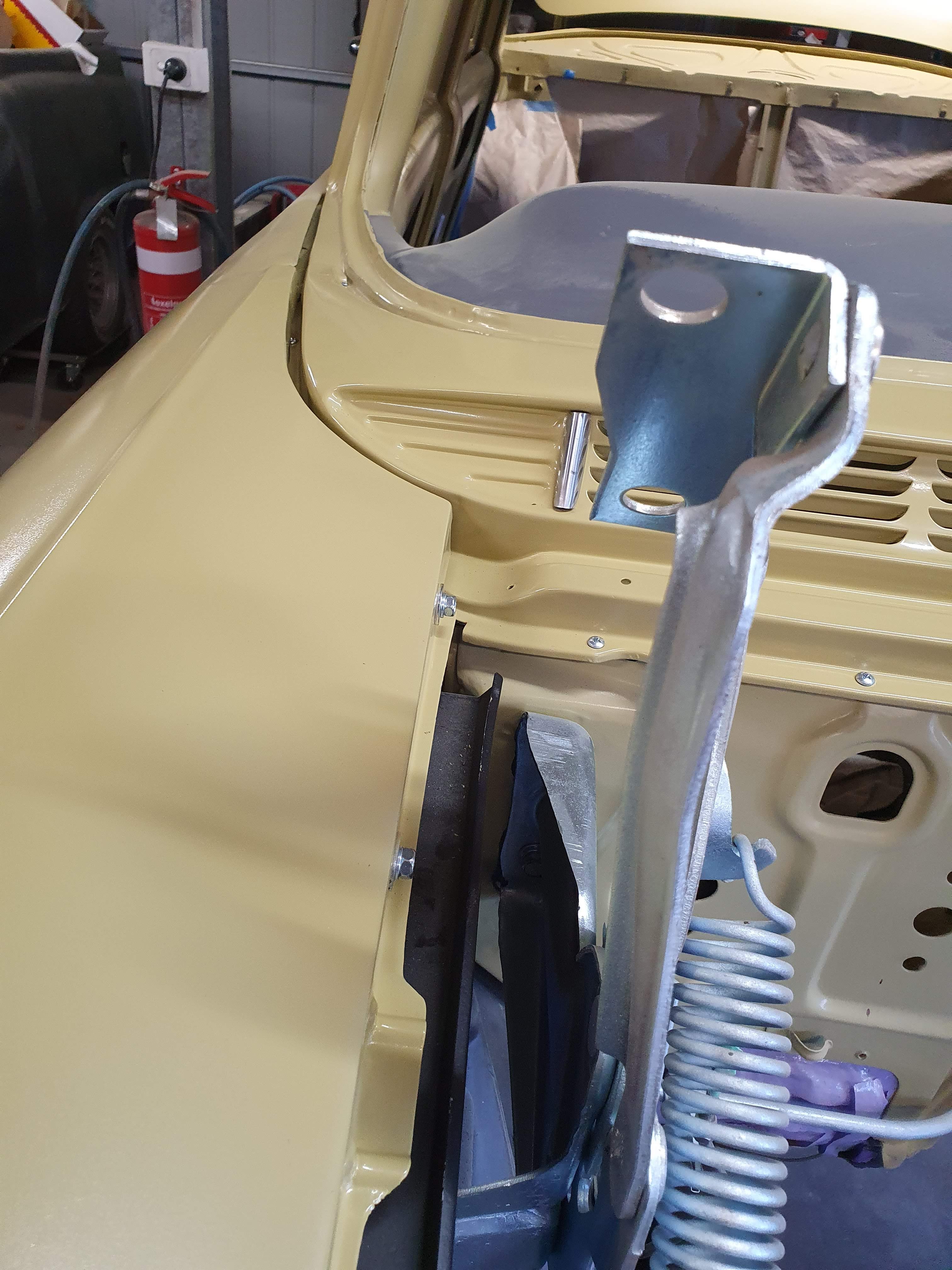

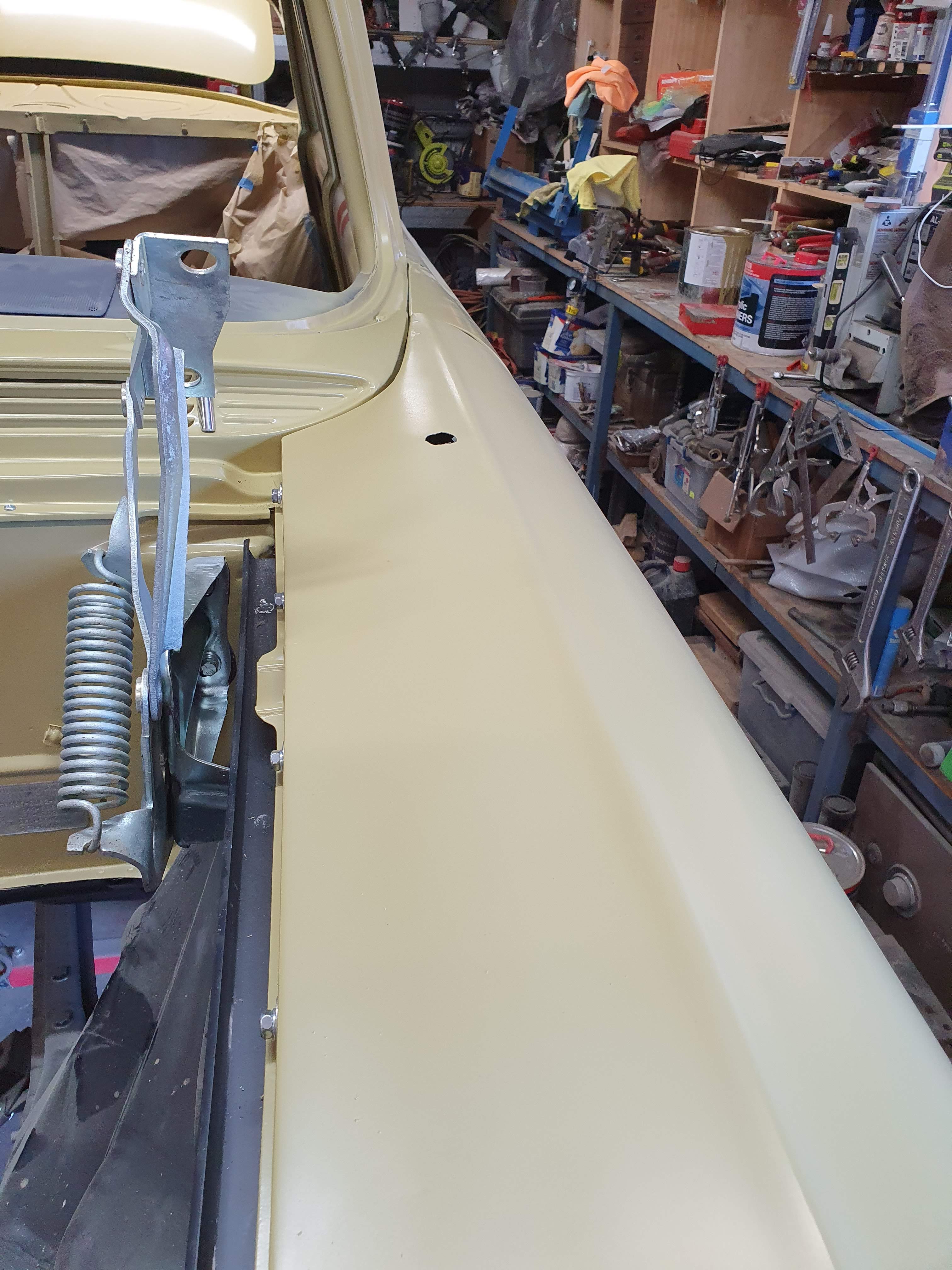

Not happy with plenum grill / guard clearances but nothing much I can do about them. Driver side is about 10mm (photo looks worse than real) the other side is neater, at about 7mm. The larger gap is the original guard and is line with the door, the smaller a donor guard is also in line with top of door. Door gaps and other alignments are good. Sunny Tim was kind enough to send some photos of original cars that showed similar gaps and my 3 utes are all over the shop too, but I was hoping for at least a similar gap on each side. 😒. I think I'll just have to accept it because, other than welding on a strip on the guard (and then the door will be out) or moving the plenum grill (and then I'll have spare screw holes everywhere), I can't think of an answer.

No one else will notice 8)

It's annoying the c@$p out of me thoughImage.
