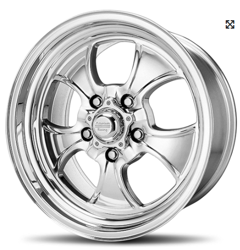

I may be changing directions with the diff in the Ute as the availability of wheels to suit the early holden stud pattern are limited.
Although Ammo and I have selected the same wheel, it is a compromise but it should suit.
Also, the options on size are limited.

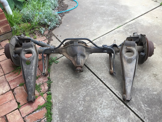

So, I purchased a VN diff with the view to shortening to suit and then grabbing the drop stub axles and hubs that I have for the sedan to give me an all-round commodore stud pattern.

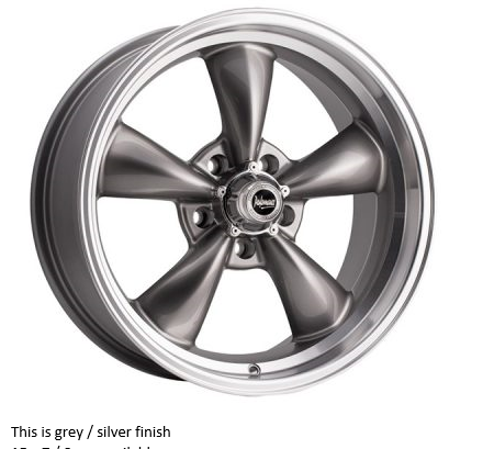

This give a better range of wheels to choose from. A couple of potential options

Hey Rog they are a good diff and pretty easy to shorten to match the rims you want to use and as you say you get a far bigger range of rims to choose from.

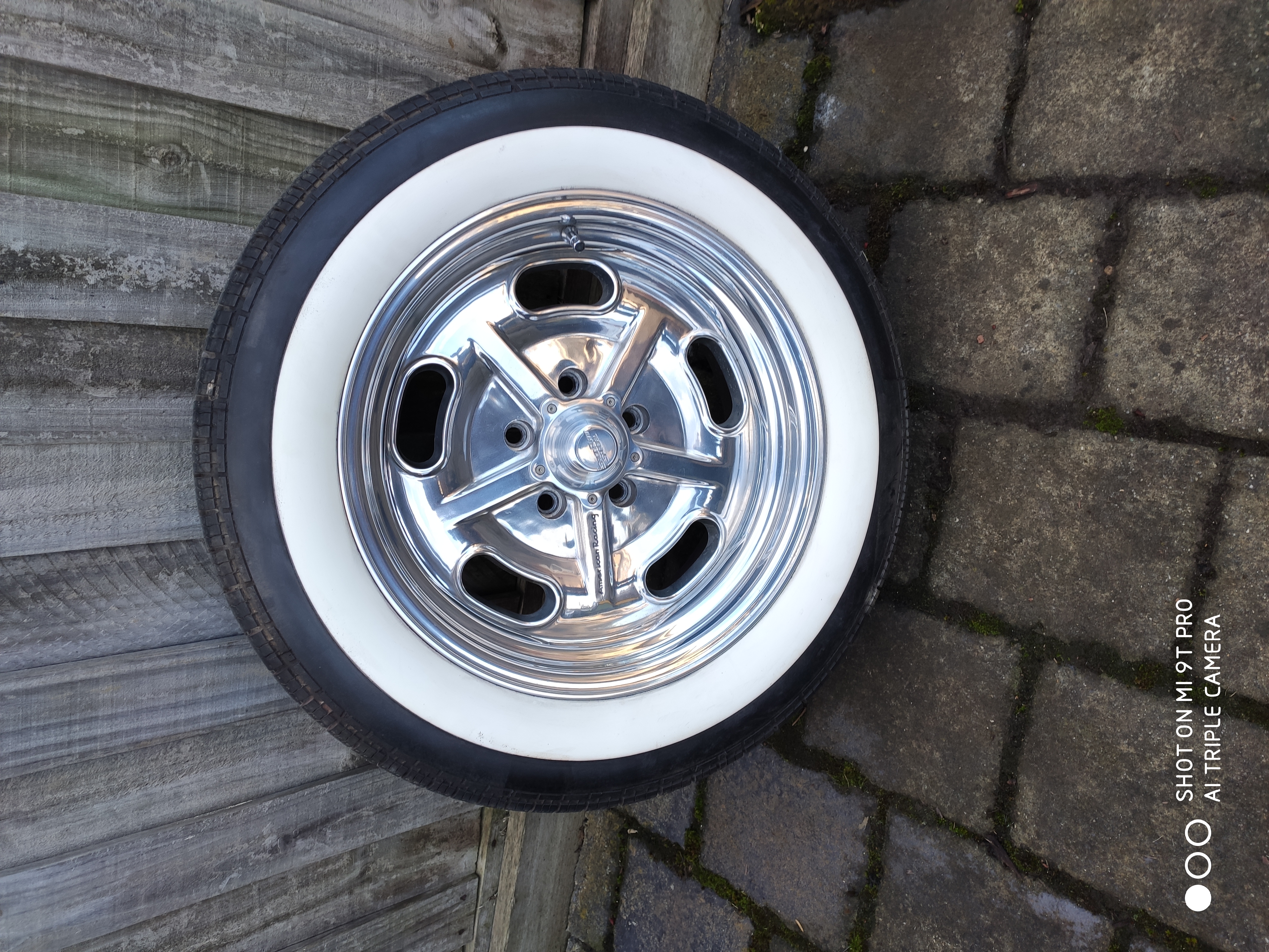

i believe the salt flat may be available in early holden pattern i have seen a HR with them on it and the person said they were early holden pattern, the top pic you have are available in early holden

Ammo and I picked the top photo, with the grey centre in 15" x 7.
As the ute is Amoo's ride the steering needs to be lighter so she can drive it.

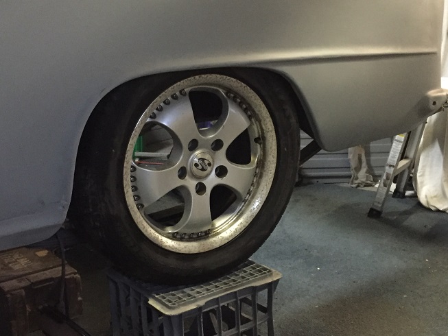

These are wheels I purchase way back, that fill the wheel arch nicely and are Commodore pattern, 16 x 7 with 225/ 50 tyre.
There is little wiggle room inside the wheel arch so either reduce tyre size or do the slice and dice to the wheel tub.
16 x 7.JPG (96.28 KiB) Viewed 1065 times
Using these wheel my diff needs to be 1425mm. So I think I will select the wheels then narrow the VN diff to suit.

Hey Rog really like the way the wheels fill the arch and yes I agree as I said above better to select rims and narrow to them just really important that you get the pinion in the centre of the tunnel too, but I’m sure you are all over it looking forward to seeing the outcome.

I did find a thread on this forum VN Diff Shortening by Ben, that I found useful.
Quick measure of the old EK diff, it is off centre by 38 mm and as I will likely be cutting both side I will ensure it is centred.

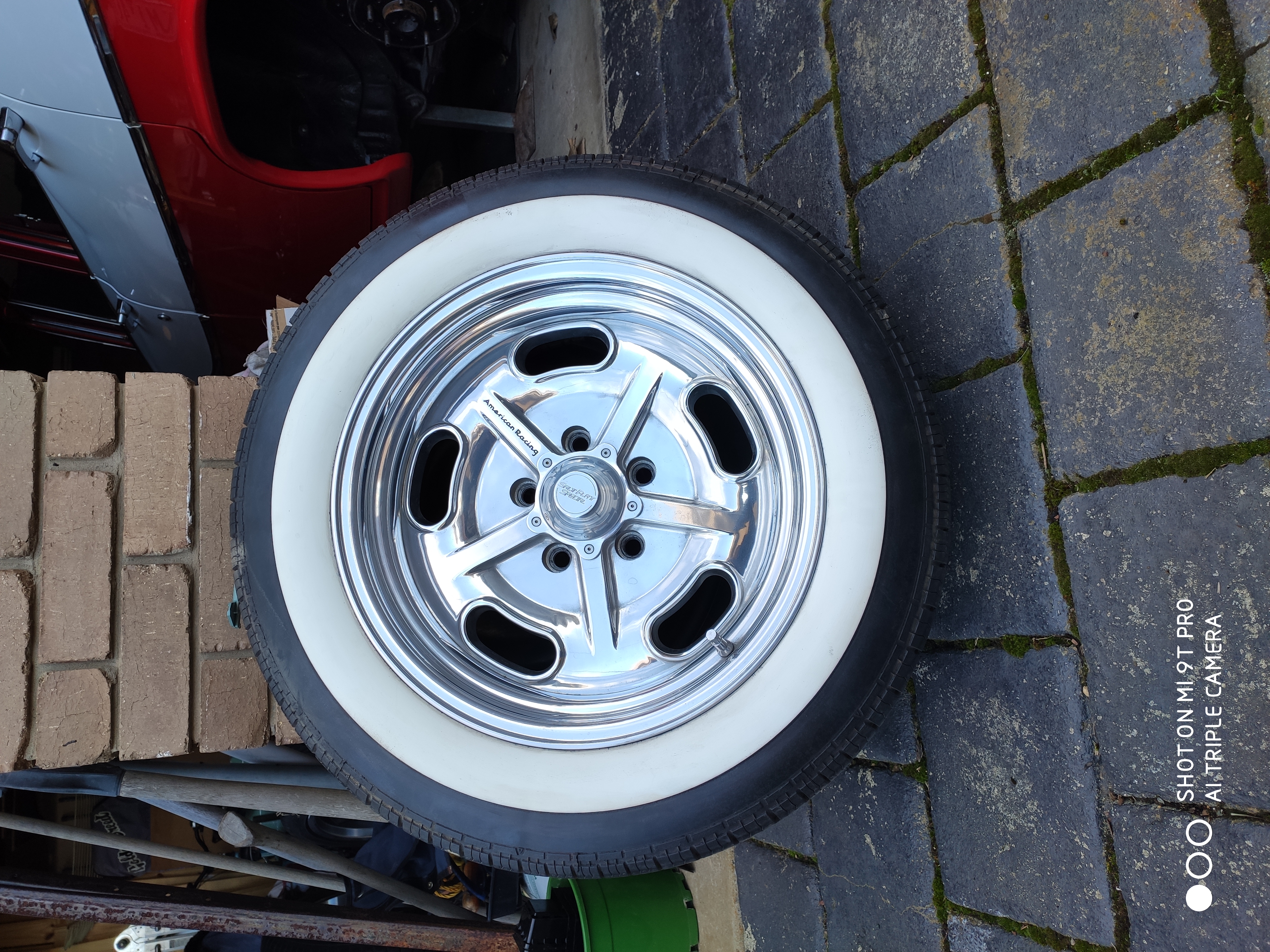

Hey Roger, these will be up for sale soon, or now if you want.
5.5"x16" & 7"x16" both -12 offset, 175/60/16 & 215/60/16.
Damn just remembered they are Chev/HQ stud pattern, but i'll put em up in case others might be interested.
White walls might be a bit fancy for a ute.

Thanks Bridy for the offer as they would cool on the ute but Ammo not so keen.
Have now tidied up the front calipers with the 2" drop spindles, it will be Commodore pattern now.
I will be speak to the wheels guys tomorrow about the these.
Hopster VN550.PNG (214.97 KiB) Viewed 940 times
I know not everyone will like or approve but Ammo and I do.
Hoping for 15 x 6" for the front and 16x7" for the rear
