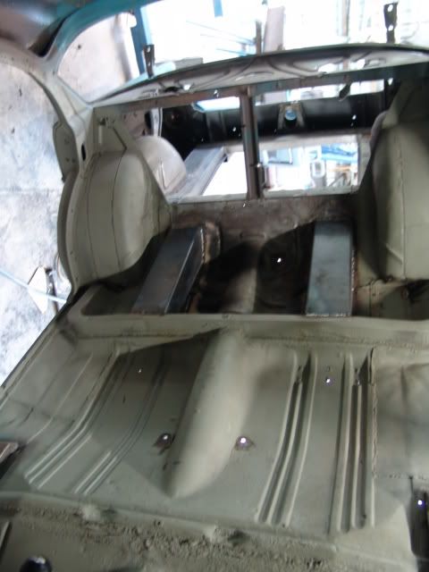

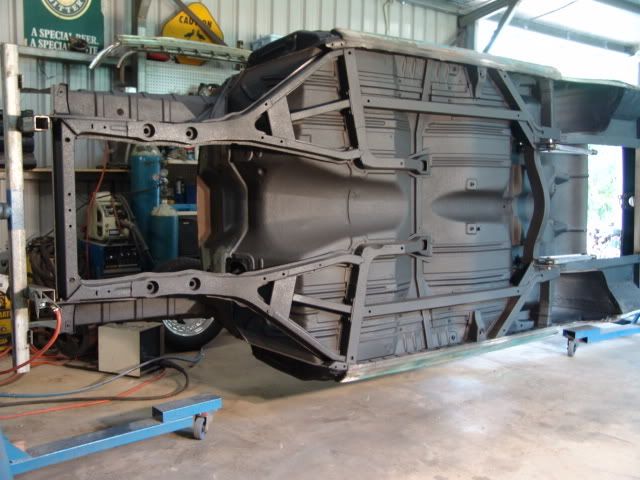

Here is a pic of the 4 link covers under the rear seat area. The rear seat spring fouls on the rear of the cover, the seat frame will be modified to clear it by about 10mm. This is actually under the backsupport, so it shouldn't effect the comfort or apperance of the seat.

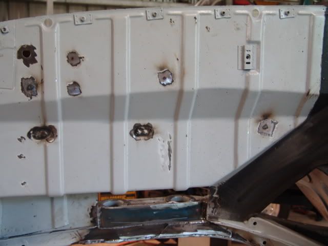

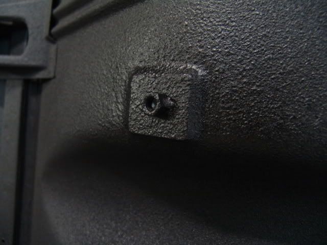

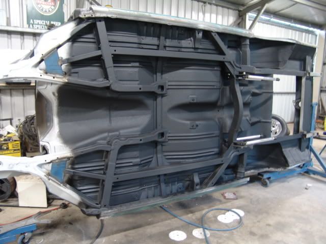

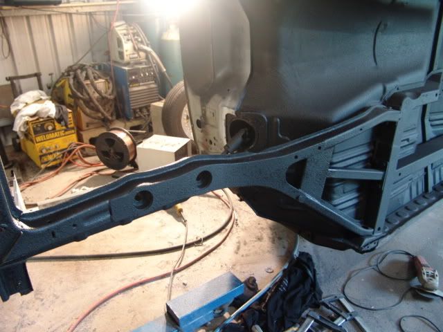

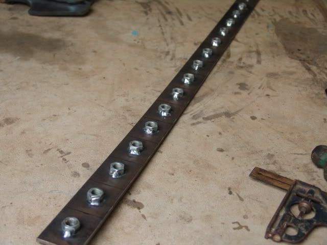

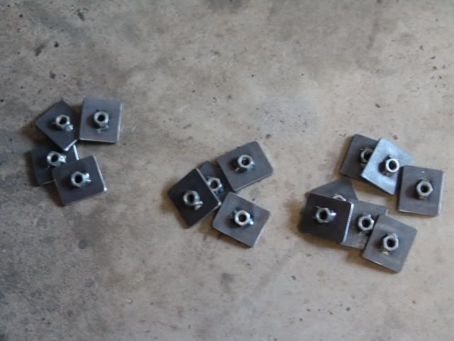

Made up some seat belt mount plates, started the sub-frame beef up to mount the rear section of the Torana K frame to and made up the sections to join the sill to the relocated chassis rails (just in front of the back wheels) at last.
Seat belt doubler plates welded and painted.
These are the sections for the Torana mount (base only) slots are to fit over the original pressings in the sub frame. Material is 100 x 50 x 3 RHS. I still have to fab the brackets to locate the Torana bushes in (will post pics when done).
Sill to chassis section - made from 1.6mm black steel sheet.

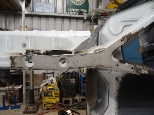

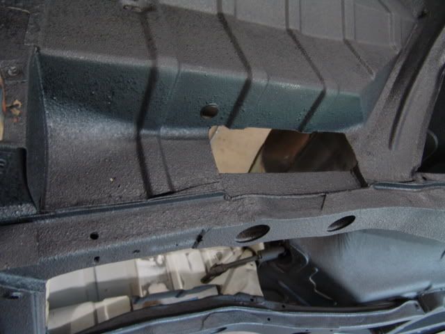

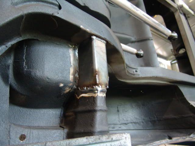

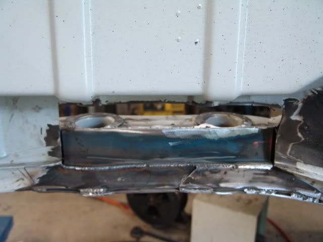

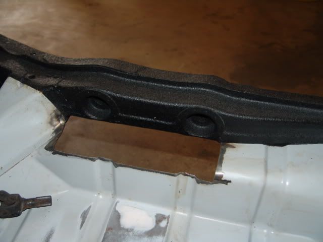

The main mounts for the torana (LH-LX) frontend are finished (still have rear outrigger mounts to do - will post pics when these are done). I have notched out the top section of the frame to give more clearance for the Torana upper wishbone, also done this so the guy (a good mate) doing the wheel alignment doesn't belt the crap out of me for making it too difficult to adjust :lol: . Only the top section is notched and it basically only removes the "humps" and the "pressed flange" from the pressings around the mounts, the wheel alignment shim bolts are very close and would cause problems for anyone doing the wheel alignment in the future if this area is not notched out.
I will make some covers to go over the cutouts. Also welded up the holes on the inner guards. I have posted pics from different angles to help if anyone else is thinking about the torana frontend graft :wink: .

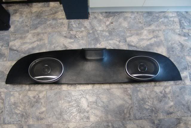

I have attached a pic of the rear parcel shelf covered and speakers fitted, doors and console are being done at the moment.
Cutouts for Torana frontend (not totally necessary but makes it all fit better and easier for grumpy wheel aligners :lol: :lol: ).
Section of 3mm RHS welded in:
CRS chassis plates stiched in place:
Fully welded:
Rear parcel shelf:
